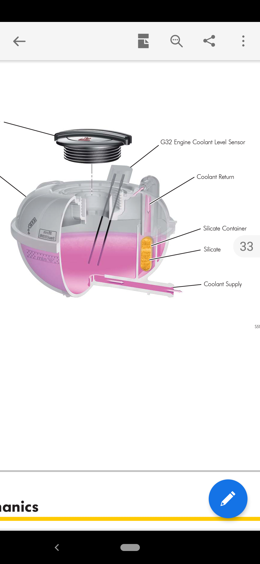

I'm pretty sure I have the built in silikat supply expansion vessel although not certain how it is contained. You I'm sure have the same.

Great info thank you. Benterrier's and my car do not have a bag but some entirely different silicate delivery system. That is the mystery we are trying to solve. Whether or not this system is prone to failure (one that the bag is infamous for).

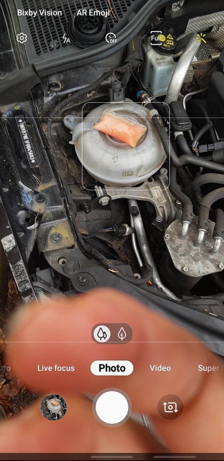

After reading how easy it is to take out the "silikat" bag, I have just taken mine out. A few minutes using nothing but fingers, bit fiddly but easy enough.
Saves on the cost of failure I suppose.

Have you checked for a bag and if so is it ok or bust
no visible bag
1 minute ago, Dellbert said:
no visible bag
I think I need to change the tank ASAP. As I stated, there is no bag, the tank has "Mit Silikat" stamp and the coolant is no longer purple. I have nothing to take out and my only option appears to be brand new tank installation followed by coolant change. The heater still works. The question is why is Skoda allowed to get away with this. I am out of warranty but the car has only 40,000km on the clock. This issue and Haldex pump clogging and failing on 4x4 cars, are major manufacturing defects on this car.

Not Visible, you say your coolant is very dirty, have a fish round with a blunt pencil or similar, it my be hiding in the depths!
Sorry for any inconvenience.
no bag mate  nothing at all even remnants ..

Is there a VAG Tech on here that can confirm it is only the tanks with a bag that are the potential problem and that the dual wall 'mit silicat' tanks are burst proof so have no danger of clogging the heating system
The term dual wall, not sure about this. I have a MIT silikat vessel on my car but wouldn't describe it that way. Unless you're referring to the bit inside holding the later silikat holder.
Yes, my understanding is that there are tanks with a 'free floating' bag in them and this type which has a semi dual wall and captive silicon, perhaps I misunderstood but I thought this later type could not cause the problem.
Yes the silikat container certainly has a better chance of staying in tact than the bag.
My tank had the little walled compartment, which made it an absolute pig to get out.
