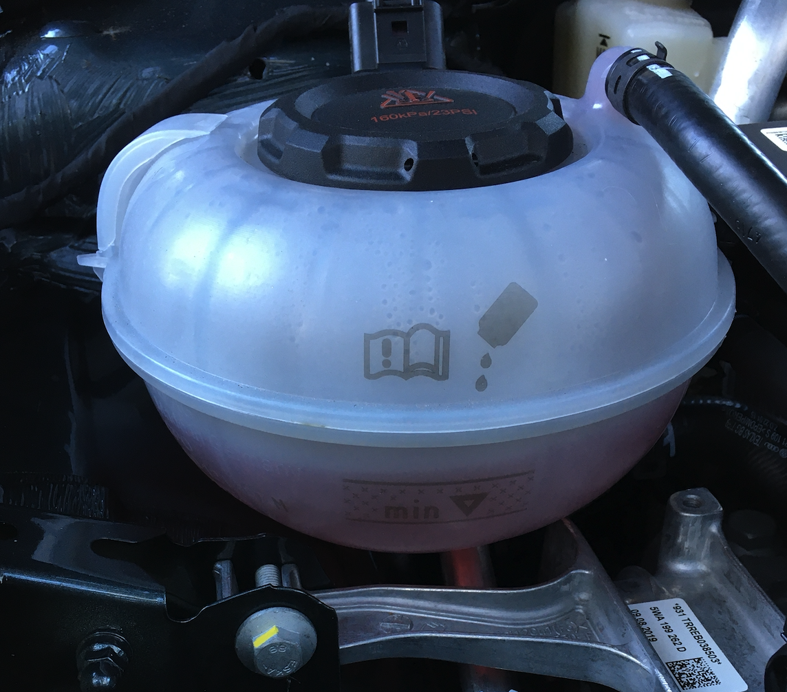

Pic of tank fitted to my carEB.png.ef84dae20fa5d5cfc17a1e838fde40b2.thumb.png.76d8c369dedbfd50c5cf4a3ea6e315d9.png
That's the new tank that's fitted now, it doesn't have the bag or the container so it will be fine 👍

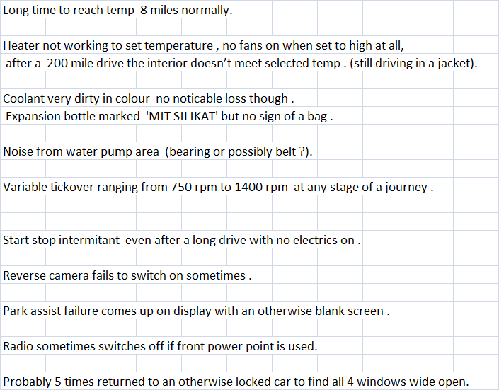

well mines in a dealership tomorrow who said theres no silik in my vehicle enen though it says it on the expansion bottle ..  kick off tomorrow at 8 am

 If thats the case whats dis coloured the coolant from July to now ?   water pump issue  headgasket (no other symptoms) and whats causing a crap heater ......

 Well if not they will have an ornament with a sign on it outside their showroom  ...  ive allready spoken to a service advisor and told him of the faults
Did offer my opinion as to the faults and got the might need a new battery for the electrical faults  (silly thing to say as i fix cars for a living )
still we will see ...

 so if your battery goes flat your cars insecure  nice idea     on drop off they said it had been reported by others before .......
second owner but if someone removed the bag whats discoloured the coolant in  5 months (actually it was ok 2 months ago )

Skoda have just phoned to say the matrix is blocked and the coolant is contaminated  and they agree a replacement expansion bottle would not contain silika (they agreed reluctantly) . The service guy worked previously at Audi and agreed there had been problems there ..  It would apear that Skoda were late to change  maybe.
The coolant colour rapidly changed from  normal g13 to a brown colour probably over a 2 week perion  , there was no oil loss or coolant loss in this time ..
17 hours ago, bigjohn said:
Hmm,  some of these faults point to a cream crackered battery
Apparently the electrical faults will be cured with a software update     we will see ....
