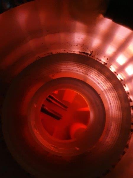

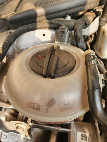

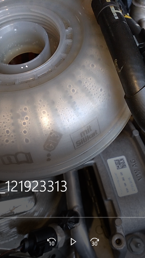

I have a Scout 1.8 TSI made in June 2015. The expansion tank has "Mit Silikat" sign on it. However, I cannot locate the bag with silica in the tank. Please see the video attached. I was wondering if anybody can clarify what different versions of the tank are out there. My thank appears to be double walled. The inner chamber is quite small and there is no way the bag that was pulled out in Youtube video (further up in the thread) would fit in this small space. The outer chamber cannot be accessed from the inner chamber and the silica bag might be in there. Is this the standard design of "Mit Silikat" tank? Or, is this something newer? Is it perhaps, that this setup is 'safer" than the single chamber tank (with the bag placed on the bottom as in the video referenced above)? I would like to get rid of the tank only if it isn't safe. Any help will be appreciated.

I think this is the style of tank I have in my 2015 VRS TDI. I have the silica bag mark on the tank so I went for a poke and can't find a bag - the hole on the top is very small, so much so that I can barely fit two fingers inside. It also appears the inside of the tank is much smaller in terms of volume than the outside. I went with the back of a pen and hit nothing but solid plastic.
The question is - does this type of silica simply dissolve over time or can it rupture and result in complete heating system failure like the bag-type?

Same in my case. The picture you supplied does not look like my tank. Yes there are two chambers, but the inside chamber wall goes right to the bottom of the tank which is not the case in the picture above.  I also wonder if the silica has dissolved completely. I checked the tank by shining a very strong light from all sides apart from the far back and there is nothing in there that resembles the bag or anything else. The fact that my coolant has changed colour could mean that the corrosion inhibitors have been depleted and the coolant is due to be changed (and G13 is no longer maintenance free).

Mate's AUDI S3 has "Mit Silikat" stamp on the tank but no bag inside. He bought it new in 2014. Same expansion tank as mine. On a side note, I went to local VW dealership today to purchase a bottle of G13 ($34 for 1,5 L). I was told by two people there that if I am topping up the coolant, I need to use it undiluted. Why did they tell me this, I was not asking any questions? This is new to me. Previous advice was to always use 50:50 solution and never undiluted coolant when topping up. This goes in line with the theory that G13 really deteriorates without silica in the cooling system. Another word, the cars without the silicate bag are no longer maintenance free as far as the coolant is concerned (and topping  up with undiluted G13 may extend the life of coolant).

That's the shape and design of my tank and I see the same when I look in.
It's puzzling to say the least.
