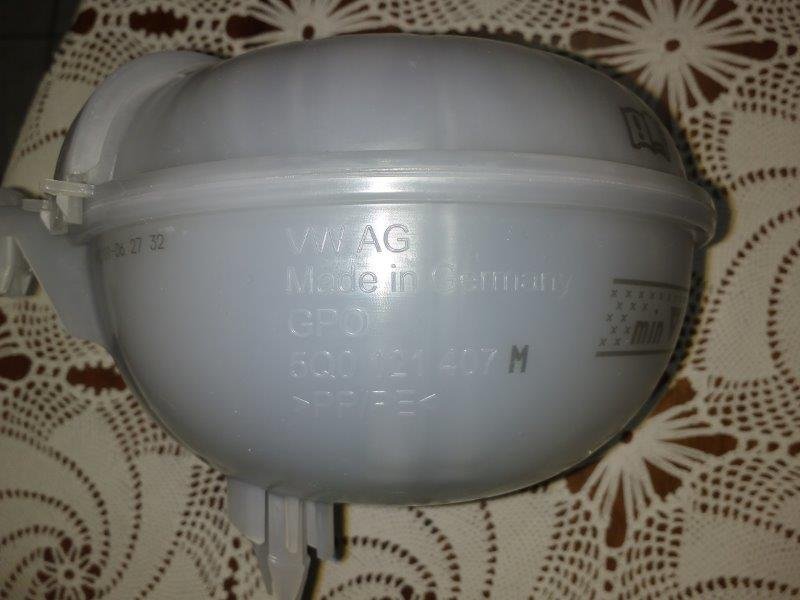

You want 5Q0121407M

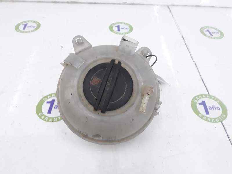

That's the old one I took out...
You don't wan't another one of those if you want to remove the silicate completely, although if a genuine A, it seems on casual observation to be a bit better engineered than a teabag.
I have a feeling most will be just replacements for the a varient, eg a tea bag version.

You want 5Q0121407M
Indeed this is the part number I have.

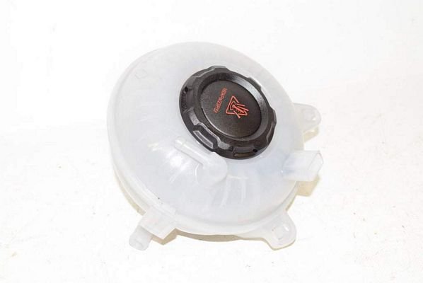

The "M" part has arrived. No bag, no walls inside the tank. Original VW part made in Germany. Hopefully, I am not late.....IMG_20200217_174010758.jpg.8db21e383aab6faa5fd91f9d7a3d99f6.jpgIMG_20200217_174155885.jpg.be8a896f19b0f6624bd5d35b21517a21.jpg

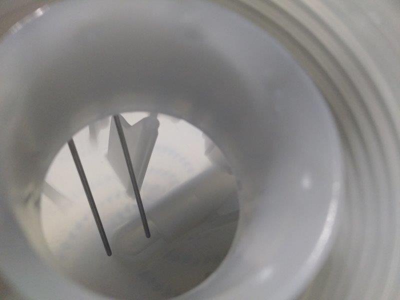

If you look at the second picture, you can see the inlet at the bottom and the prongs.
Put a teabag between those and you can see how regular, light movement against those could cause very slight abrasion or slight piercing that with time could degrade.
Here’s hoping for g13+ with additional protectant in it and a 5 or so year service interval so it can just be done with the cam belt.

I have changed the tank. Easy job. The coolant I extracted from the tank was clear and not contaminated. However, the colour was not pink as I posted earlier. I don't have a name for it. It is between pink and orange. Added about 800mls of 50/50 G13. The heating works. I will change the coolant when my next service comes up.
