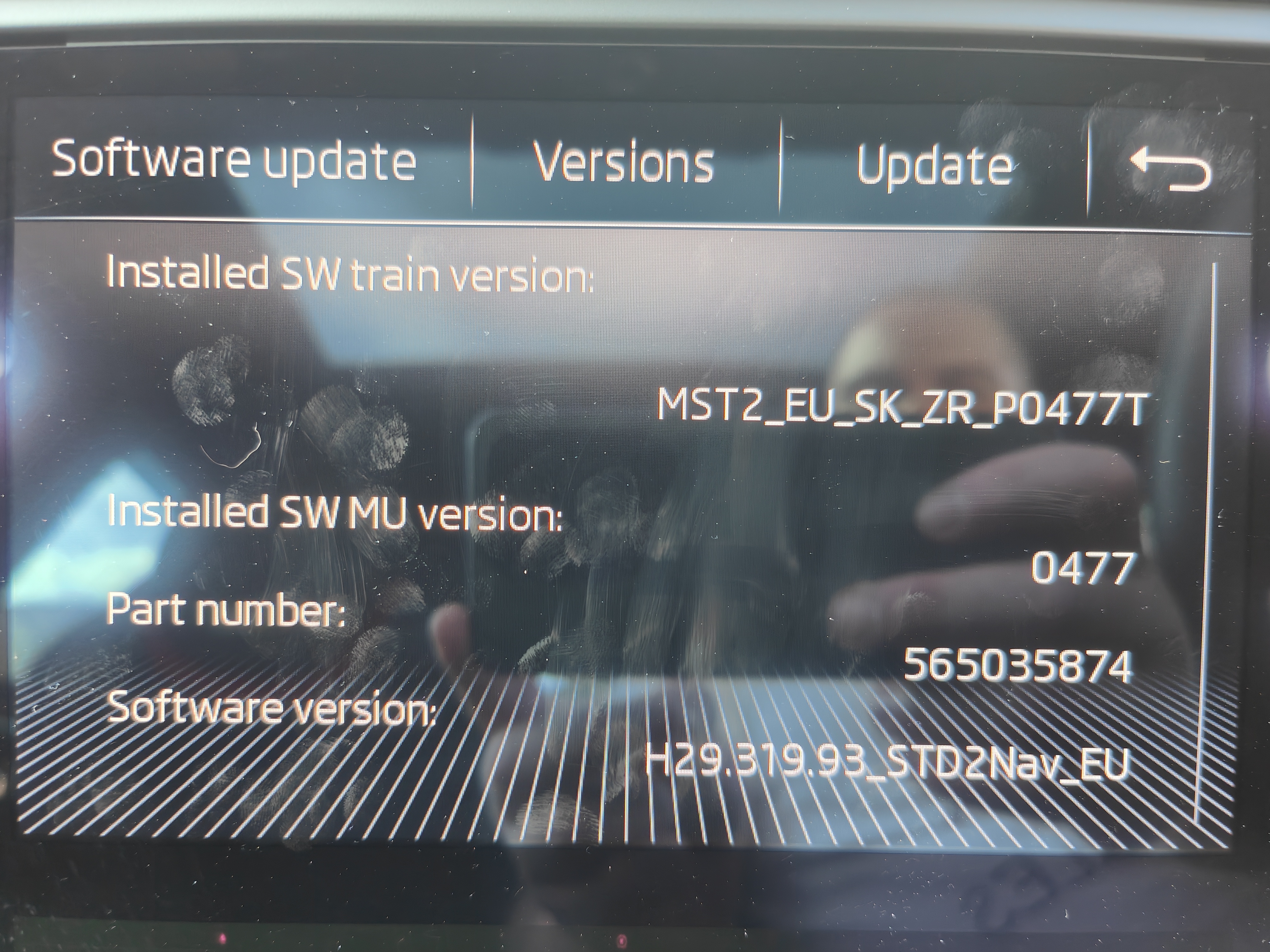

Hello Guys,
1st of all Happt Easter for all catolics!
2nd issue.
I have a skoda octavia III 2016, but i dont have car play, i have only mirror link and its not working with my iphone 13. Also sometimes the bluetooth loosing the connection and dont show the call log.
I have uploaded my version of 5Q0 035 864 - MIB2 Skoda Amundsen
Can I get a newer update?
Manny thanks ! 😇
@RaoulE & @myxw0rld Check your PM's in next few minutes.

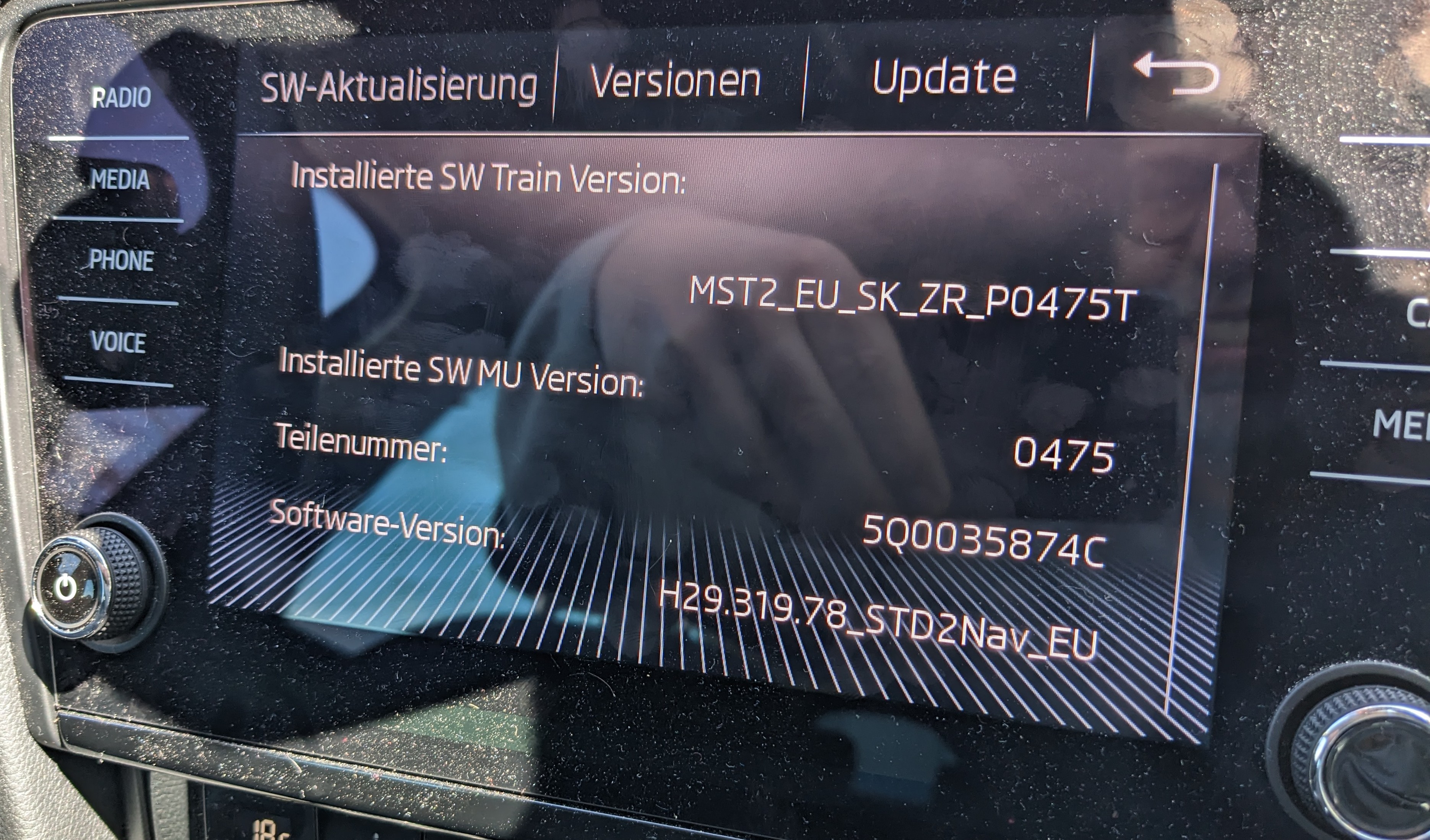

Dear experts, I'm also looking for latest firmware update. Having currently version 0475 (MIB2 Amundsen in an Octavia III) - see attached picture for details.
Background: I tried out a sw update with a wrong source and the update failed. Since that time I get every 10, 15 or sometimes 20 minutes a strange notification sound during driving. I don't know what triggers this and couldn't find any reason.
It sounds like a message notification sound and I don't know how to get rid of it.
My hope is that an update to latest firmware version could fix this.
Or any other idea or proposal?
Would be really happy to get rid of this nasty thing...
Thanks a lot in advance for any help!
Hi, could I also please ask for MST2_EU_SK_ZR_P0480T ?
I am currently running MST2_EU_SK_ZR_P0475T.
Thank you
@paperbrd @adikovec You both have PM's for 0480 version

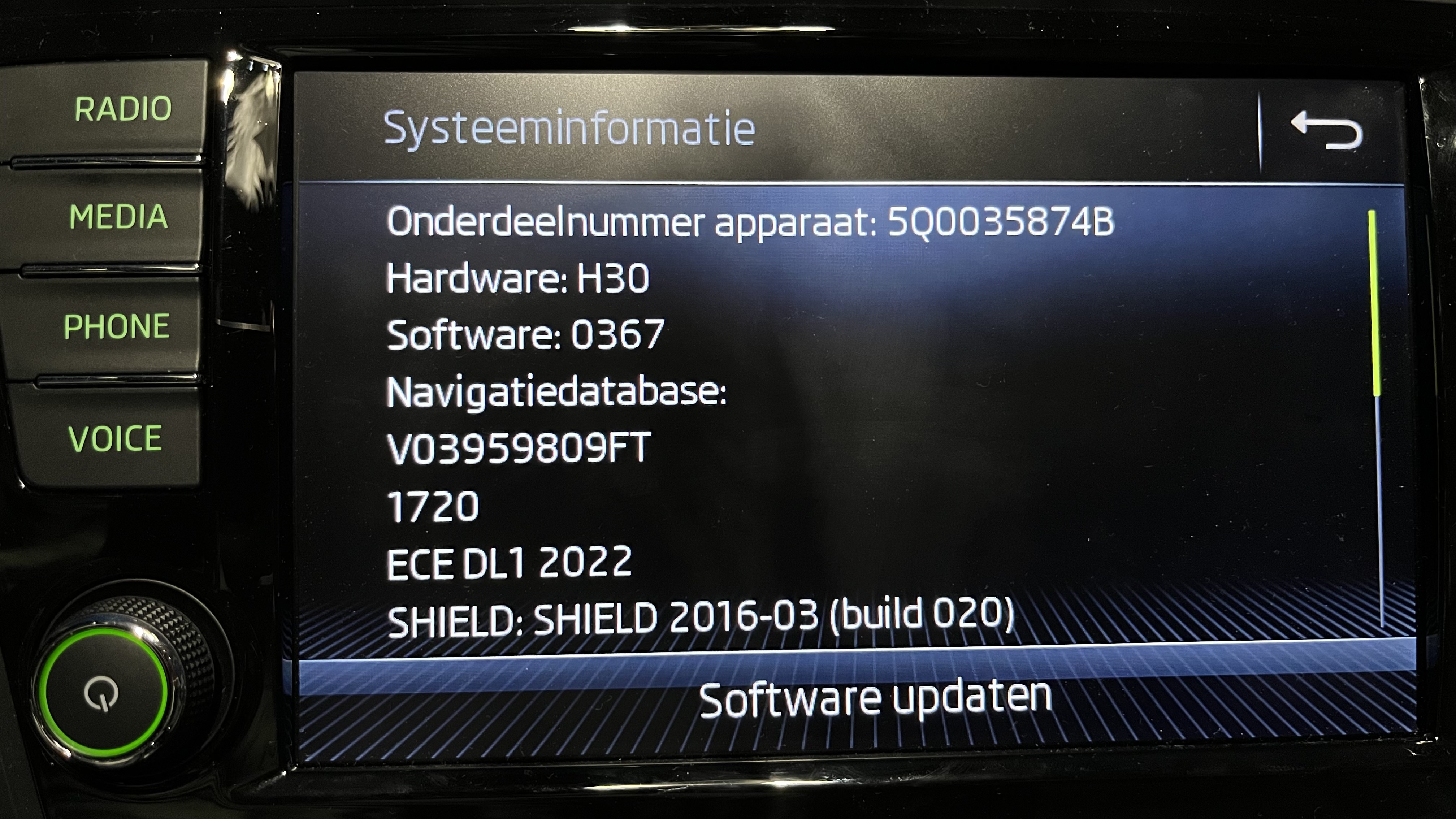

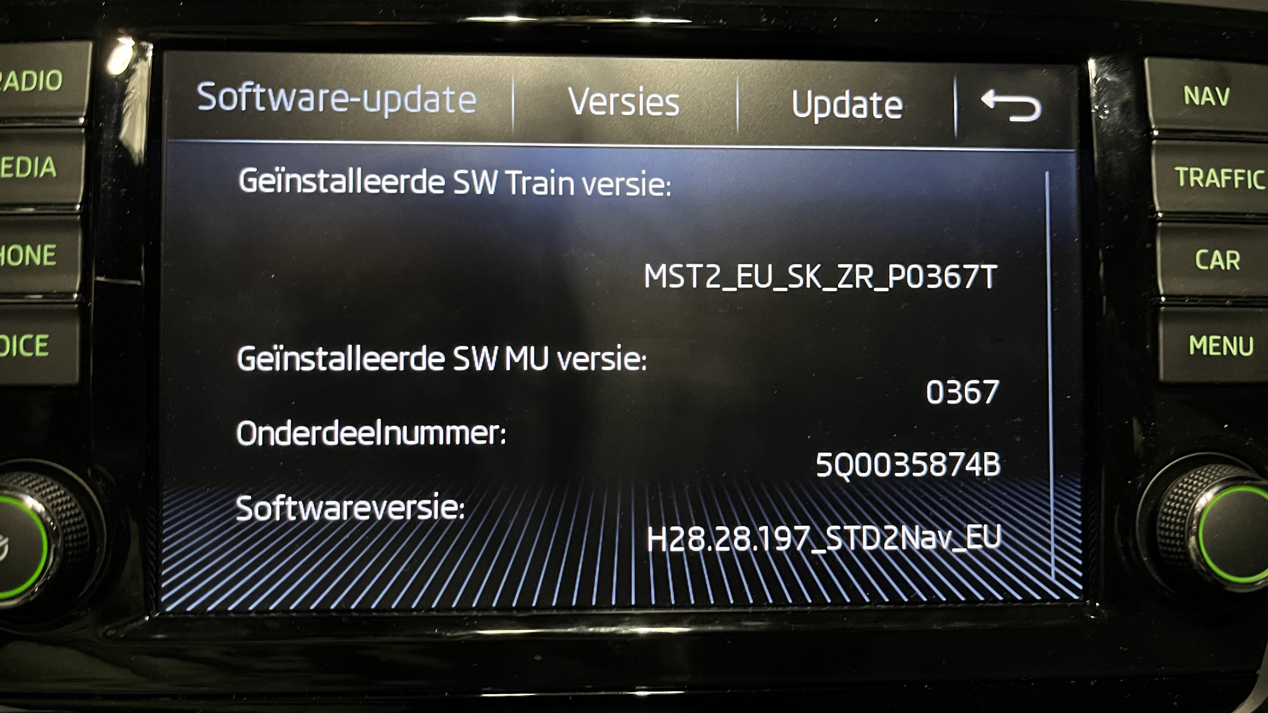

On 05/04/2023 at 11:00, varooom said:
@krisopl @omide Sorry I missed your posts, did you still need firmware updates?
I have already updated my unit to 0363, thanks!
Now I'm trying to figure out if I can unlock any features, which require codes, which require MIB STD Toolbox installed, which requires soldering in a one-slot unit - as far as I am aware... Is it correct?
I see "Latest possible firmware: MST2_EU_SK_ZR_P0480T" at mib-helper. Is it worth it? Anything I need to know before upgrading?
21 minutes ago, krisopl said:
.. to 0367, the latest I've found

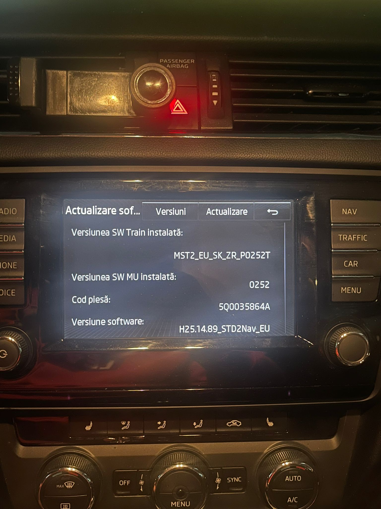

Hi Everyone,
Any new update for this hardware:
Device part number: 5Q0035864A
Hardware: H24
Software: 0253
I have    MST2_EU_SK_ZR_P0253T
Thanks
0369 is current version for your Software Train
1 hour ago, Baltazar said:
Hi Everyone,
Hardware: H24
Software: 0253
Thanks
No, 0253 is still current latest 02xx version
