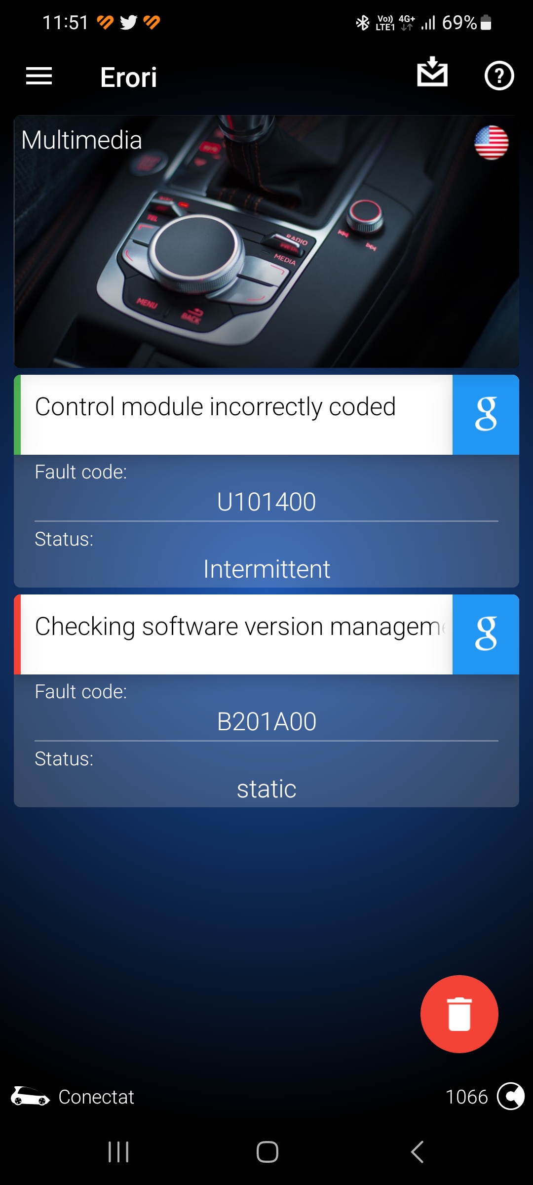

After the firmware update i have the following erori on obdeleven, yet the navigation seems to work ok. Is there any conflict with the New firmware?
The 2nd fault code is the very common one that occurs when you do not have online connection to factory.
Easily fixed, https://forums.ross-tech.com/index.php?threads/18798/
The 1st fault code might sadly need you to go online to make a possible new coding of the unit (though so far no one has complained of loosing function!)
So you maybe wise to test all things on the system to check out each function is intact, and maybe no physical errors are seen, so you can then ignore the coding change.

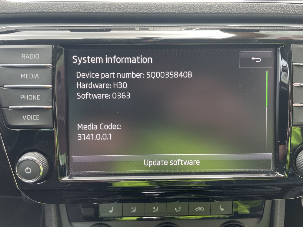

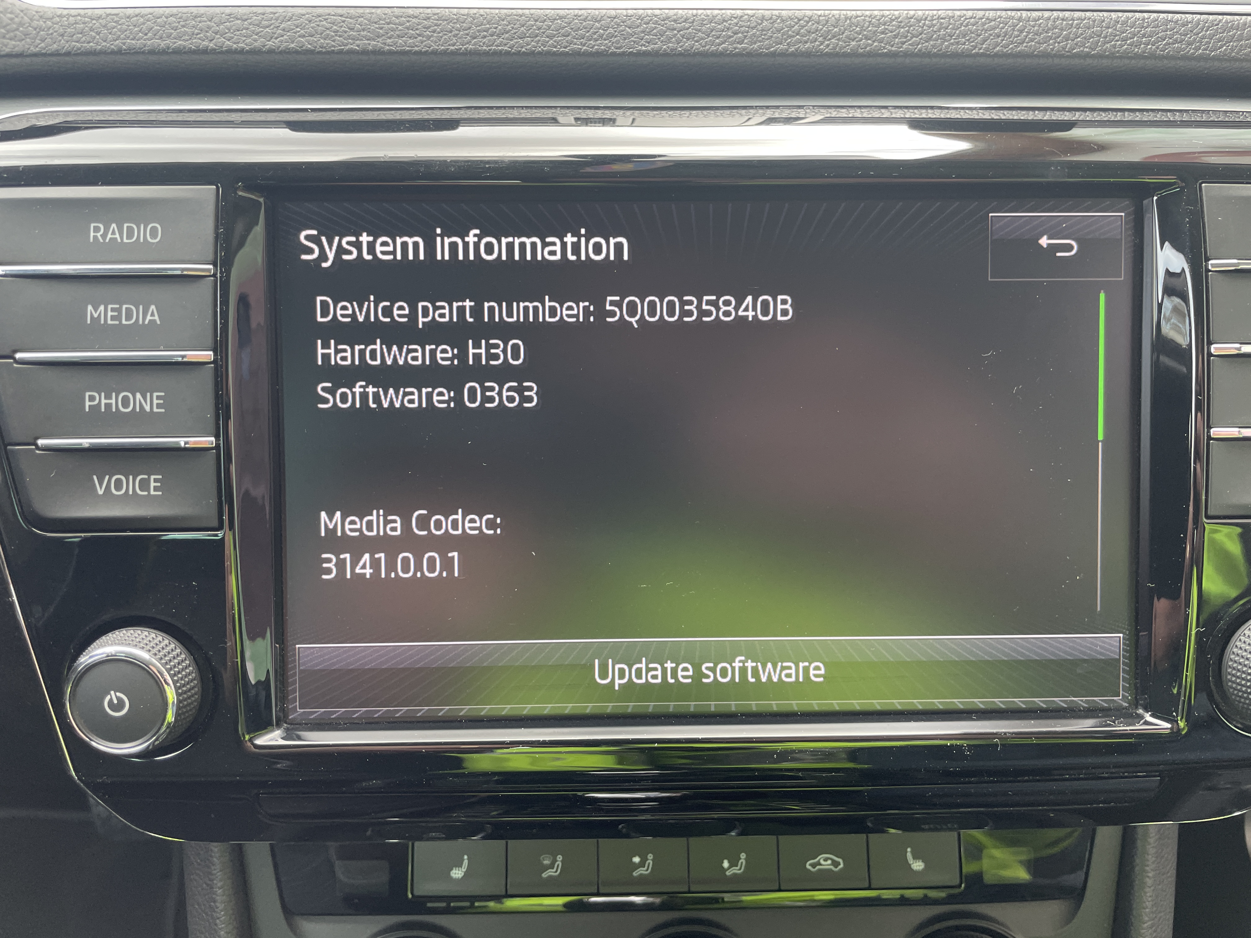

Hello everyone,
I'm having multiple issues with my unit (not) connecting to the iPhone at all, or apps freezing. I suppose my software version is quite old.
Where can I get a firmware update? What is the latest firmware version?
Hardware H30
Firmware 0363
