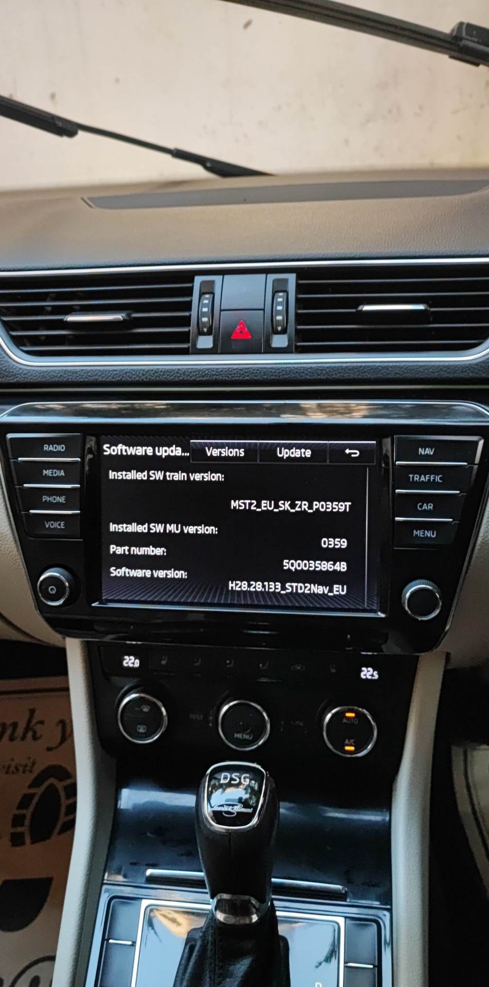

Hello,
Mine is Ambudsen MIB 2 Unit.. Can someone recommend me firmware update?
Installed SW train version: MST2_EU_SK_ZR_PO359T
Installed SW MU version: 0359
Part number: 5000358648
Software version: H28.28.133_STD2Nav_EU
I am looking to upgrade to virtual cockpit on my Skoda Superb MK3 2017 and thinking of ways to display maps and someone advised me to upgrade to 480 but not sure if it involves any problems.

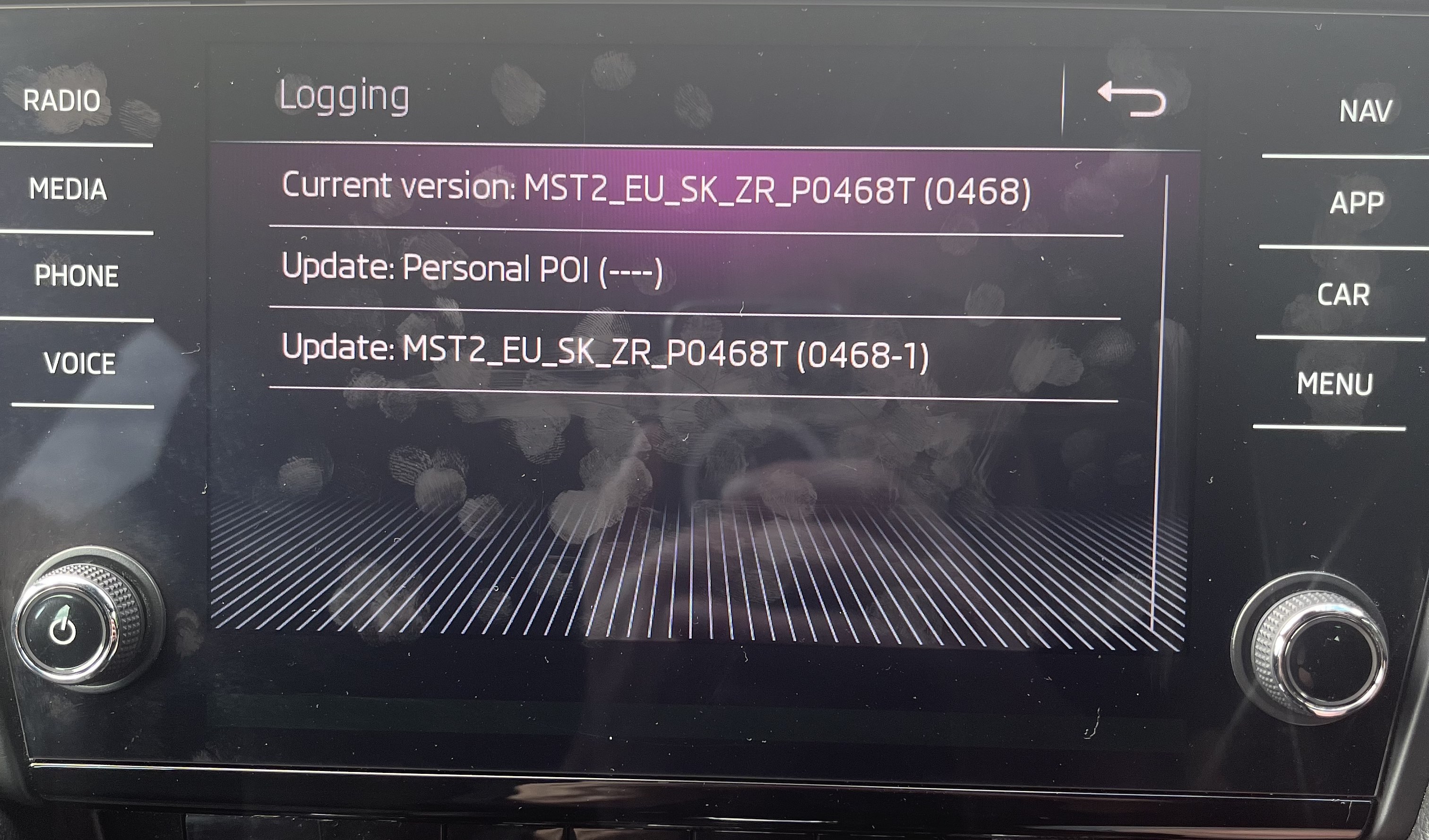

Work done!!!!
   During the installation there have been three failures, but it has continued and everything has gone well.

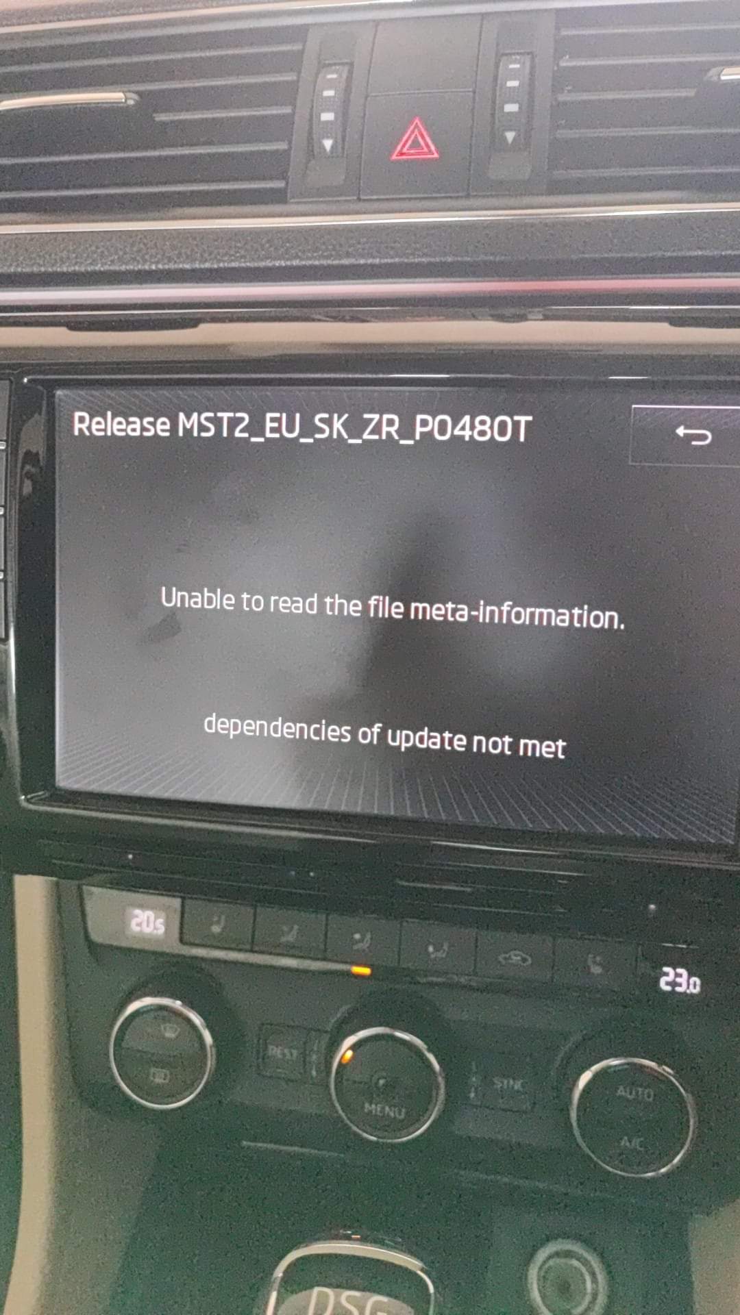

@pab567 Need your help with MIB2 Ambudsen STD FW upgrade. I currently have fw 359 and wish to upgrade to latest i.e 480 in the process getting error. Attaching my device details and error. I am planning to retrofit virtual cockpit on my superb mk3 2017 and need to be able to display maps but do not wish to upgrade my headunit. I downloaded fw from link provided in this video
Going from SOp3 frimware (03xx) to SOP4 (04xx) is not a piece of cake. First you have to flash th eunit with patched swdownload and then flash with 04xx firmware with especially modified metainfo2.txt.
Any instructions on how to do this?
If you are fimilar with QNX and software reerse engineering then I believe you can do it.

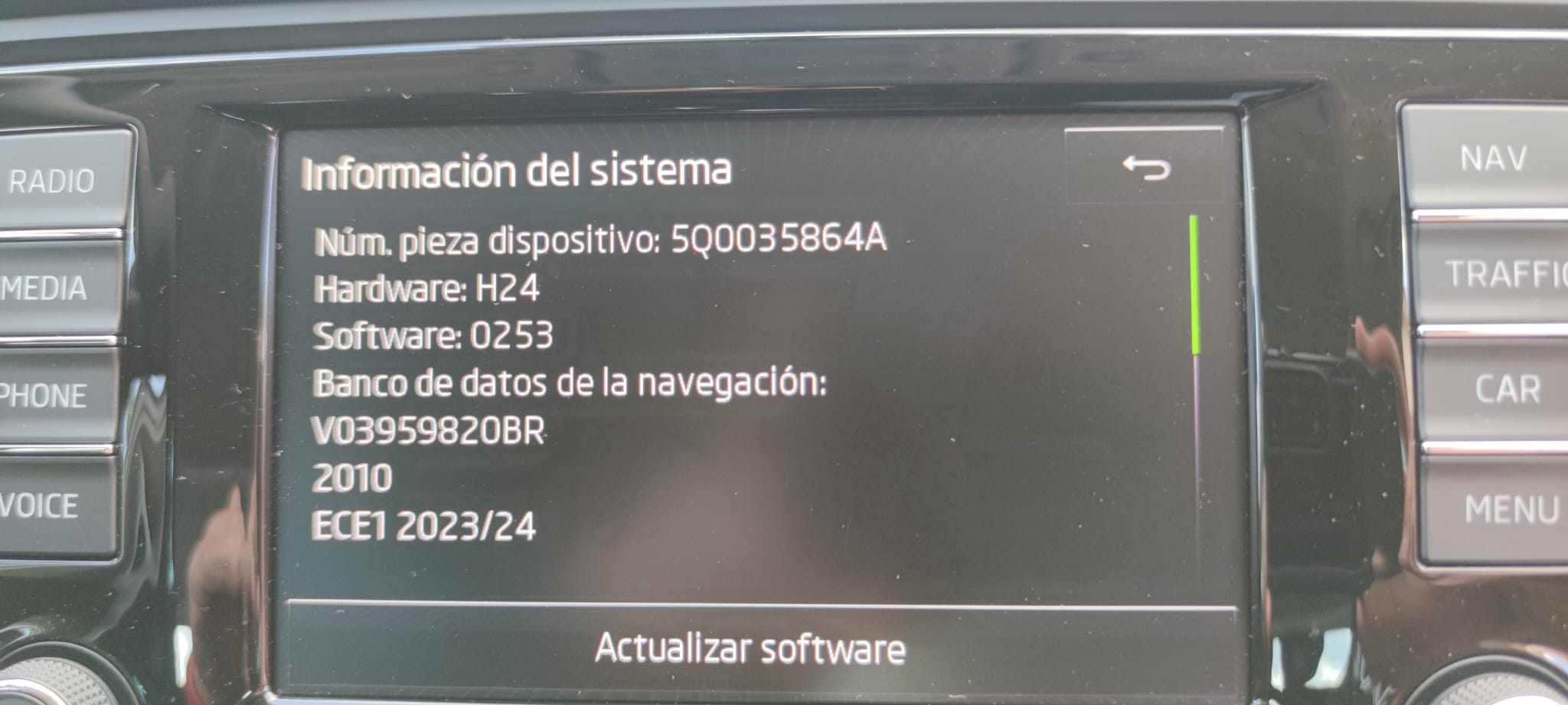

Can you specify exact firmware please?
Press and hold down your menu button for about 10 seconds, locate Software Train value
Thanks for the quick reply
The installed SW Train Version is  MST2_EU_SK_ZR_P024ST
Installed SW MU version   0245
Hope this is useful if there is an update.
Kind  Regards
Terry
The installed SW Train Version is  MST2_EU_SK_ZR_P0245T
Kind  Regards
Terry
Yes, I can send you 0253 version
Thank you for your knowledge and help.
I would appreciate SW version 0253 :thumbup:
Terry (London)
Terry (London)
Already done, top right if screen for private message.
