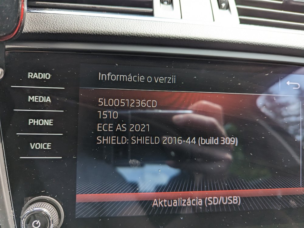

Hi there. By any chance, is there any update for my Octavia 2014?
Tahnk you.

Yes there is update to 0490 version

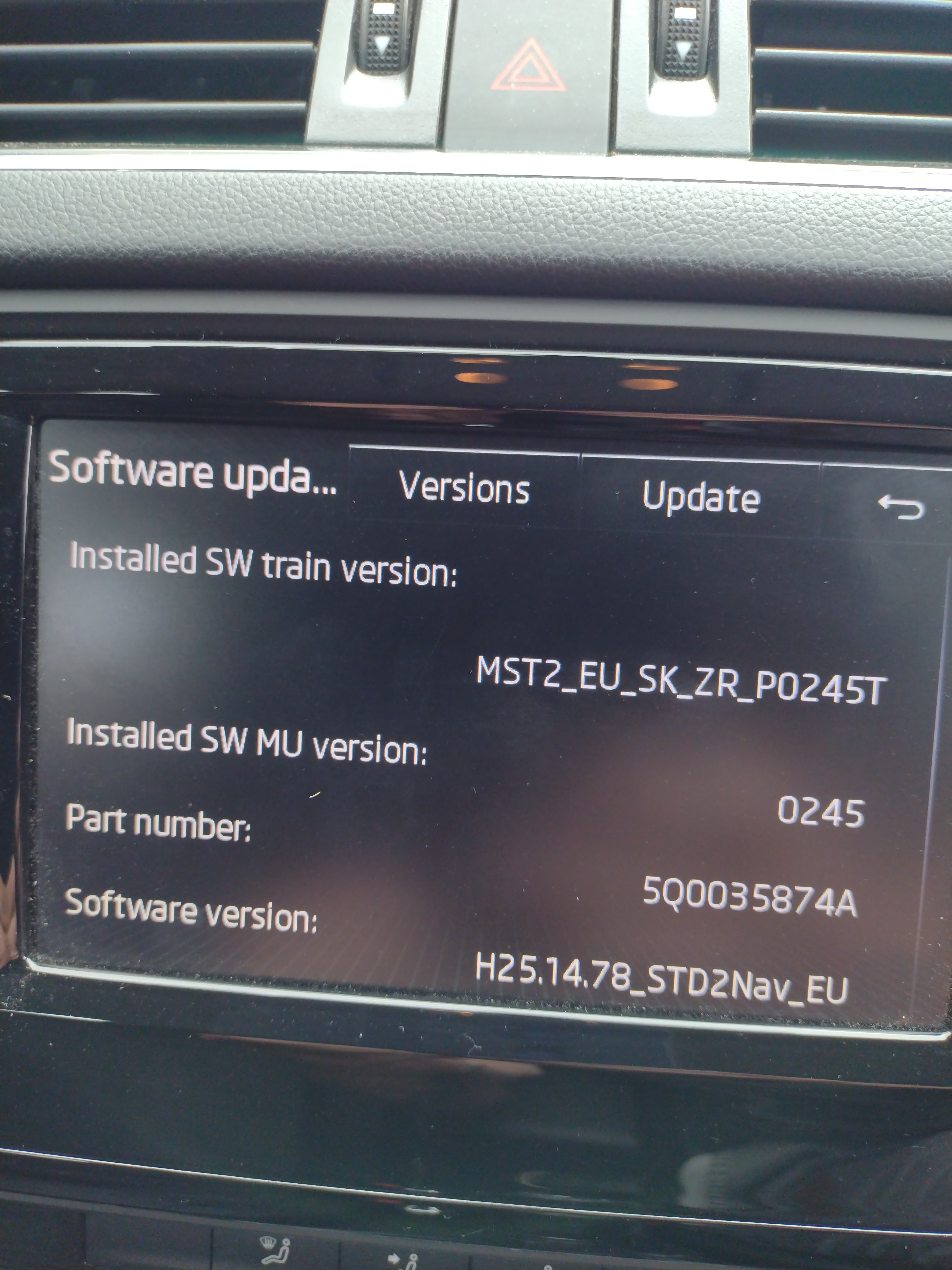

Would greatly appreciate an update and instructions please. Tia.

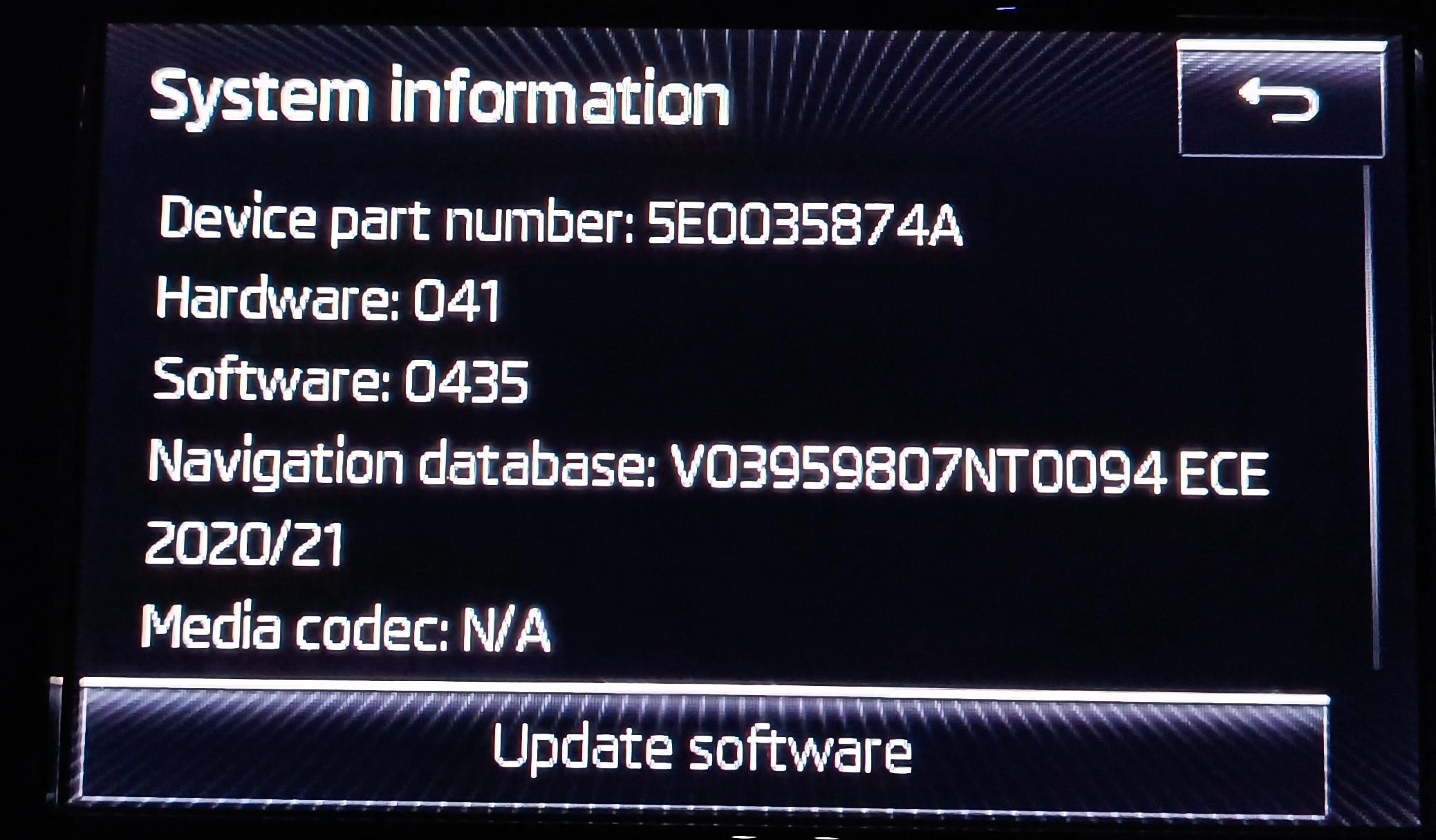

Thanks varooom for 480. Posting here in case it helps others. When upgr5ade attempted using SD card with exploded 480 I get:

Sorry, had a busy day and you fell through the cracks.
Will send you update to 0253.

Does this mean mine can't be upgraded for some reason or any tips to get aorund this please?

Have you tried to hold down the Menu button for 10 seconds to see what software train is already installed?

I have the factory version installed and then you gave me the latest appicable is my understanding.

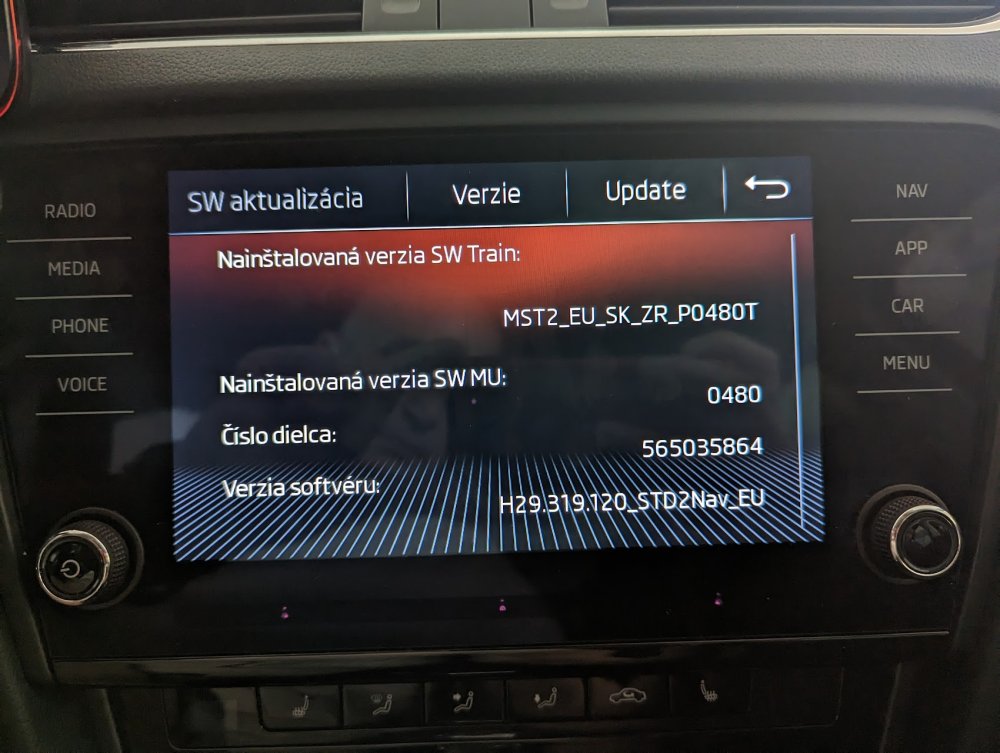

Hi,
Please, is this the latest version ?

Aha, this is your first post where you mentioned about trying to download 0480, without a screenshot if your existing Software Train.
So I supplied 0480, when you needed 0369 as seen from your latest posting.
I will send the correct firmware now, and you will be able to load.

Yes for 04xx versions
Thanks, And is there any difference in this, or for this radio is this the latest version?

Show a Software Train value
@varooom
The previous post was my. That is, if this is what I should have sent. But I understand already that I have the last version. Thank you very much.

MST2_EU_SK_ZR_P0480T is the current 04xx version.
Have a good day
