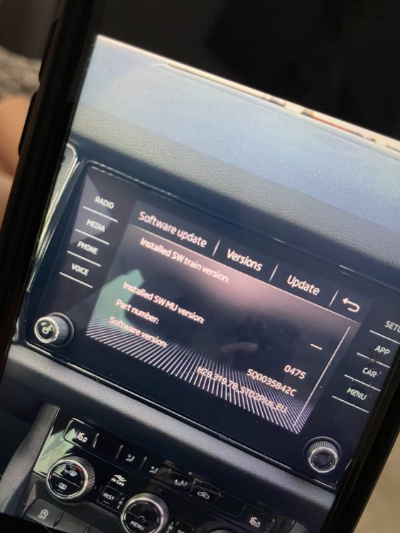

Hi, just seeing if my Skoda Kodiaq 2019 has the latest software. If not how and what do I need to update to the latest. Thank you for any help
That sreen looks interesting, missing SW Train version.
I have sent you 0480 version to load.

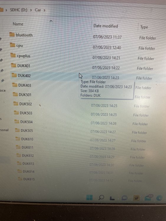

3 minutes ago, Cherry182 said:
As mentioned in PM
Take all the files and folders in D:\Car, and move to D:\ which is called the "root" 📂

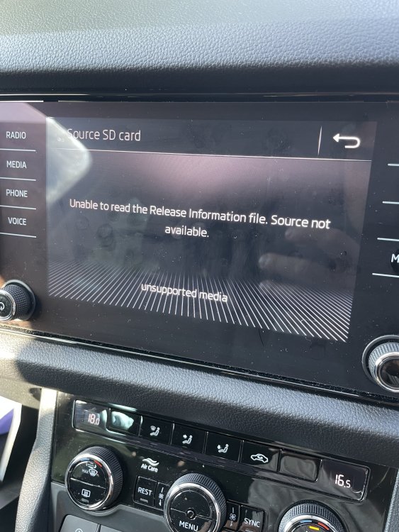

I downloaded the file... I unzipped it, uploaded the file folder to a card, inserted it into the Skoda slot... and it tells me that the data is not valid... or something like that
Show image of Software Train, and also contents of you SD Card.

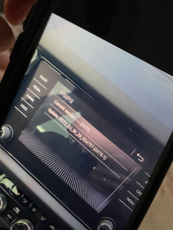

@Cherry182 I am glad you got the new 0480 loaded now, just for my own curiousity, does the page in Engineering mode now show the value "MST2_EU_SK_ZR_P0480T" that was just "---" before on 0475?
