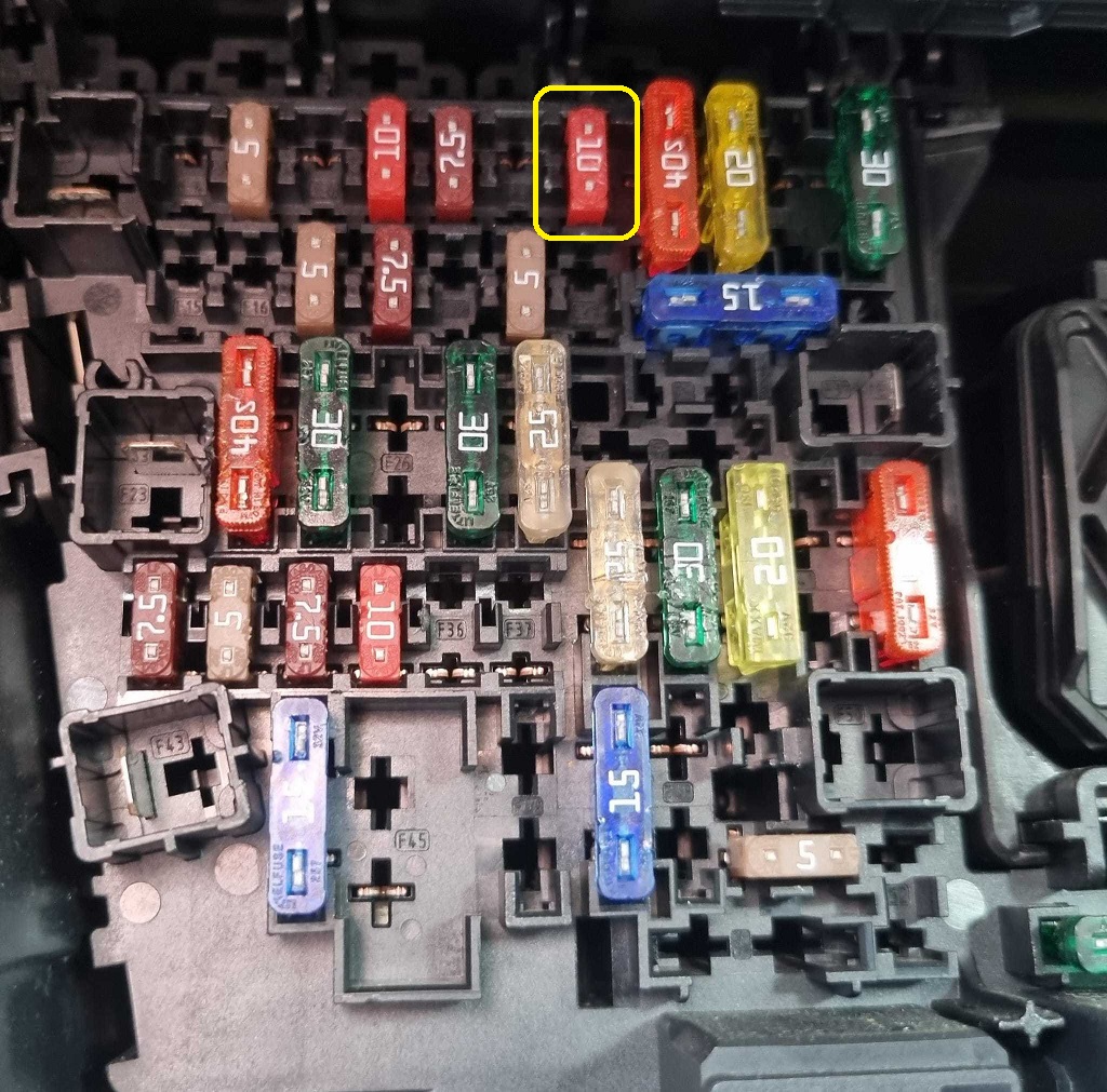

I managed to get fuse box open. The pdf manual i downloaded (none came with car) says radiosystem is #12, can't see that. This is what I see:spacer.png
Quick educated guess is 30Amp top right green.
I would need to lookup to be 💯 %
Actually the manual days infotainment 12,infotainment screen 10. Here's manual, turning 90 degrees seems to be what I'm looking at in fusebox.spacer.png

You have not killed it, you just cannot see correct fuse (I have laptop open now)
Pull this mini 10Amp fuse, the 30Amp is on the right should be for the blower motor
Edited by varooom
Additional Information
Yes!! My key in behind that and popped it out. Screen dead. Thanks so much for having my ass!
