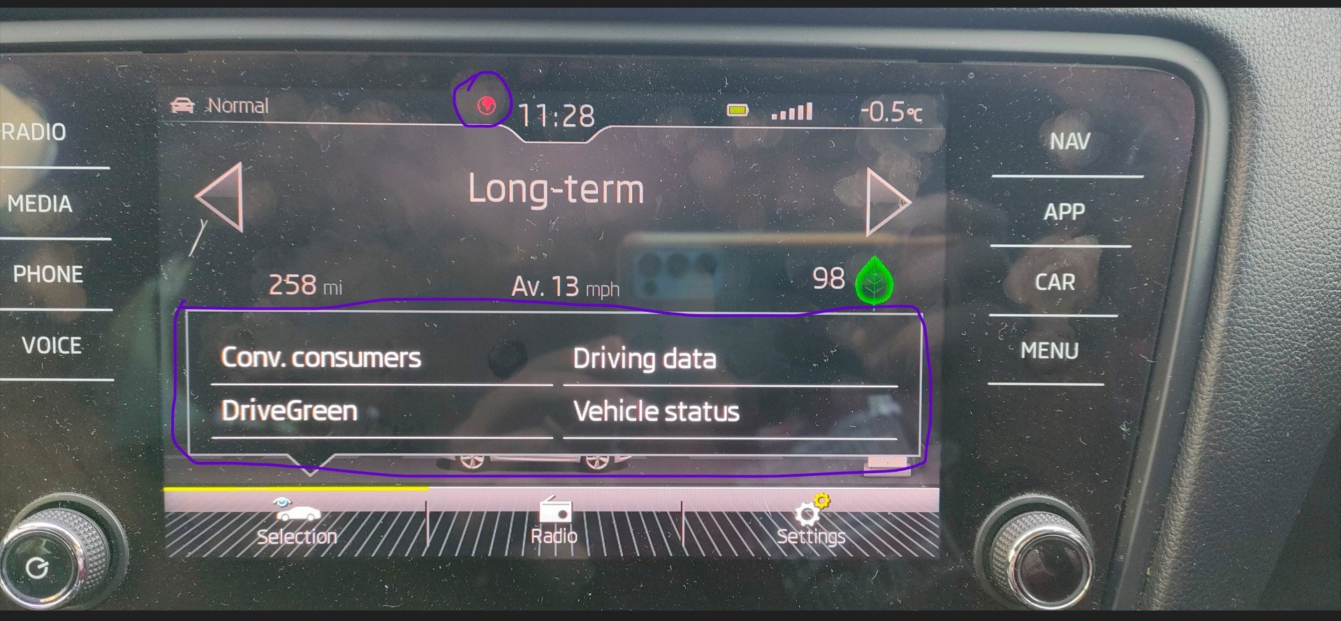

Just wondering if my update went well. I can see little changes on the interface. like map (circled) was green previously and now it is always red. Also functions option were horizontal instead of vertical. Is there any options to revert these changes. i like the way there previously.

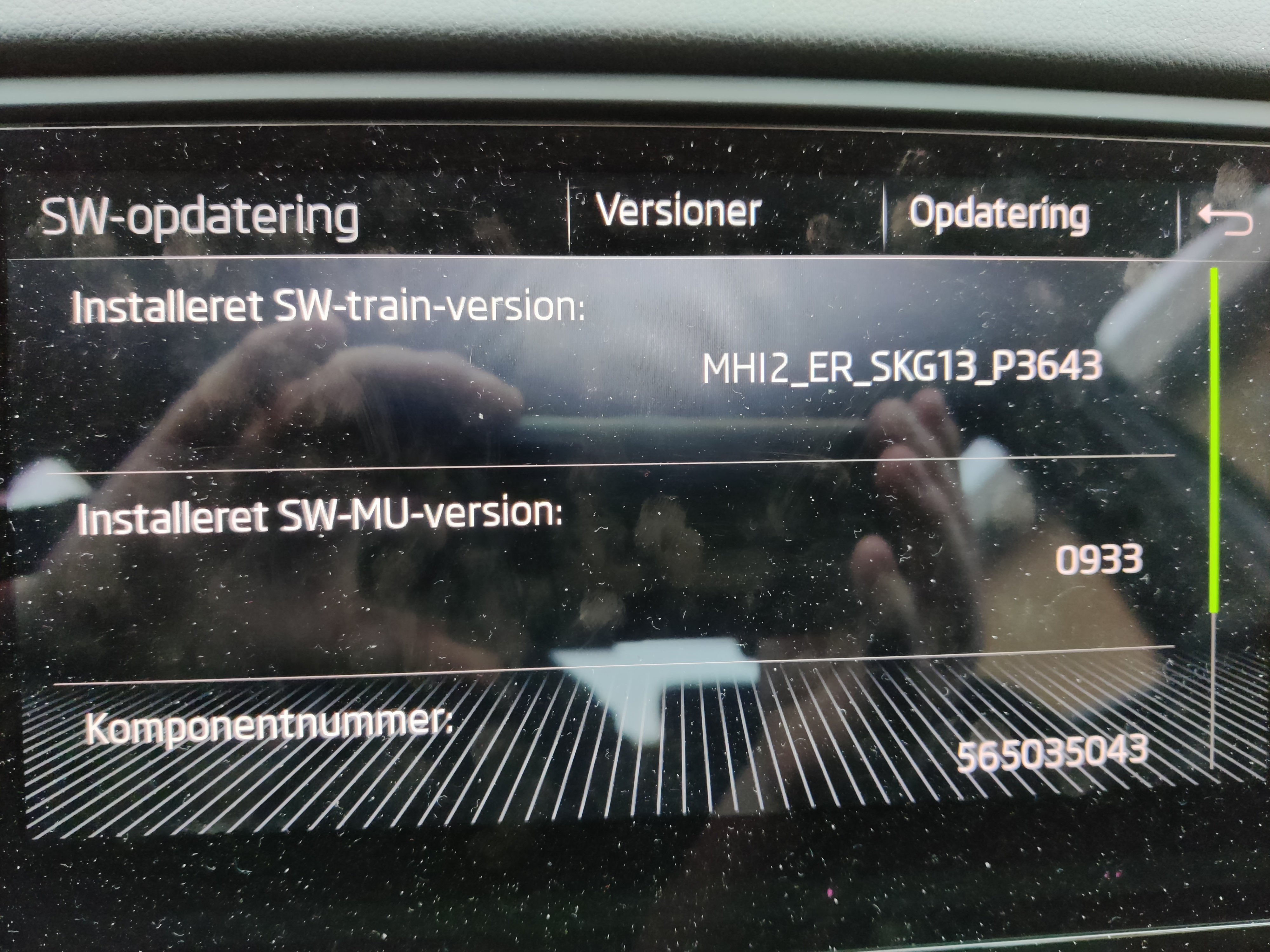

Anyhow, you have MHI2_ER_SKG13_P4526
Version 1440
Will be sent to you in a few moments

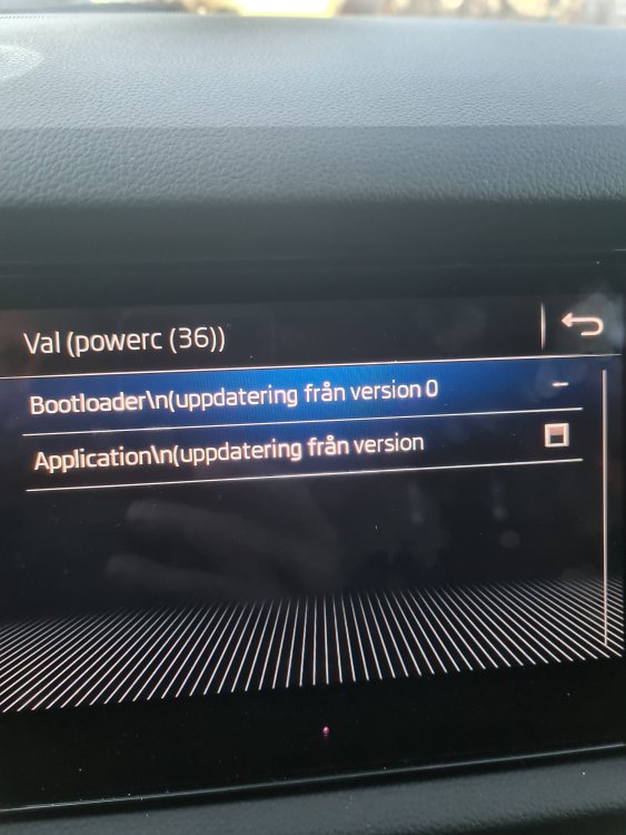

You will need to use this screen to perform update, file link via PM in next few moments.

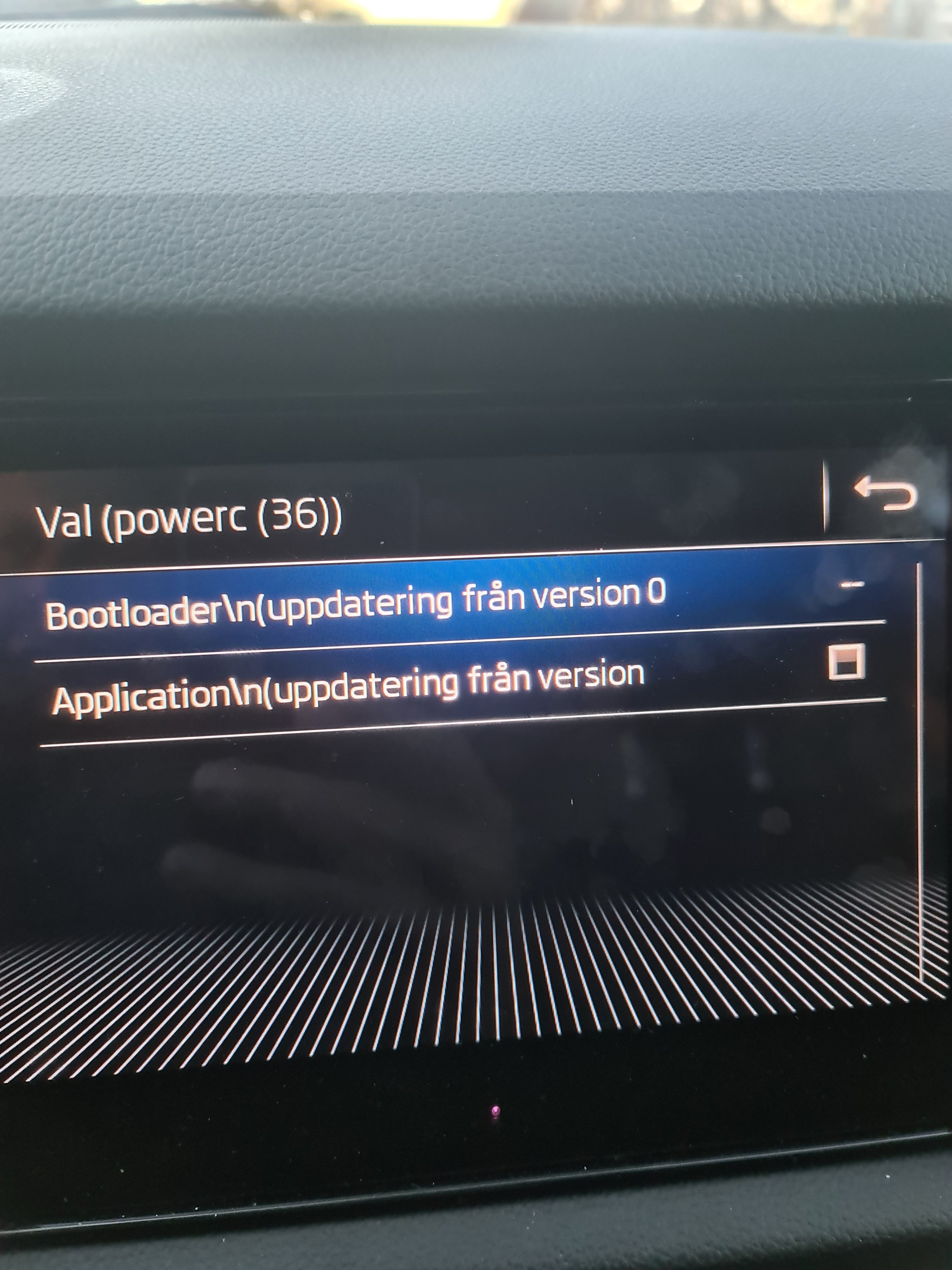

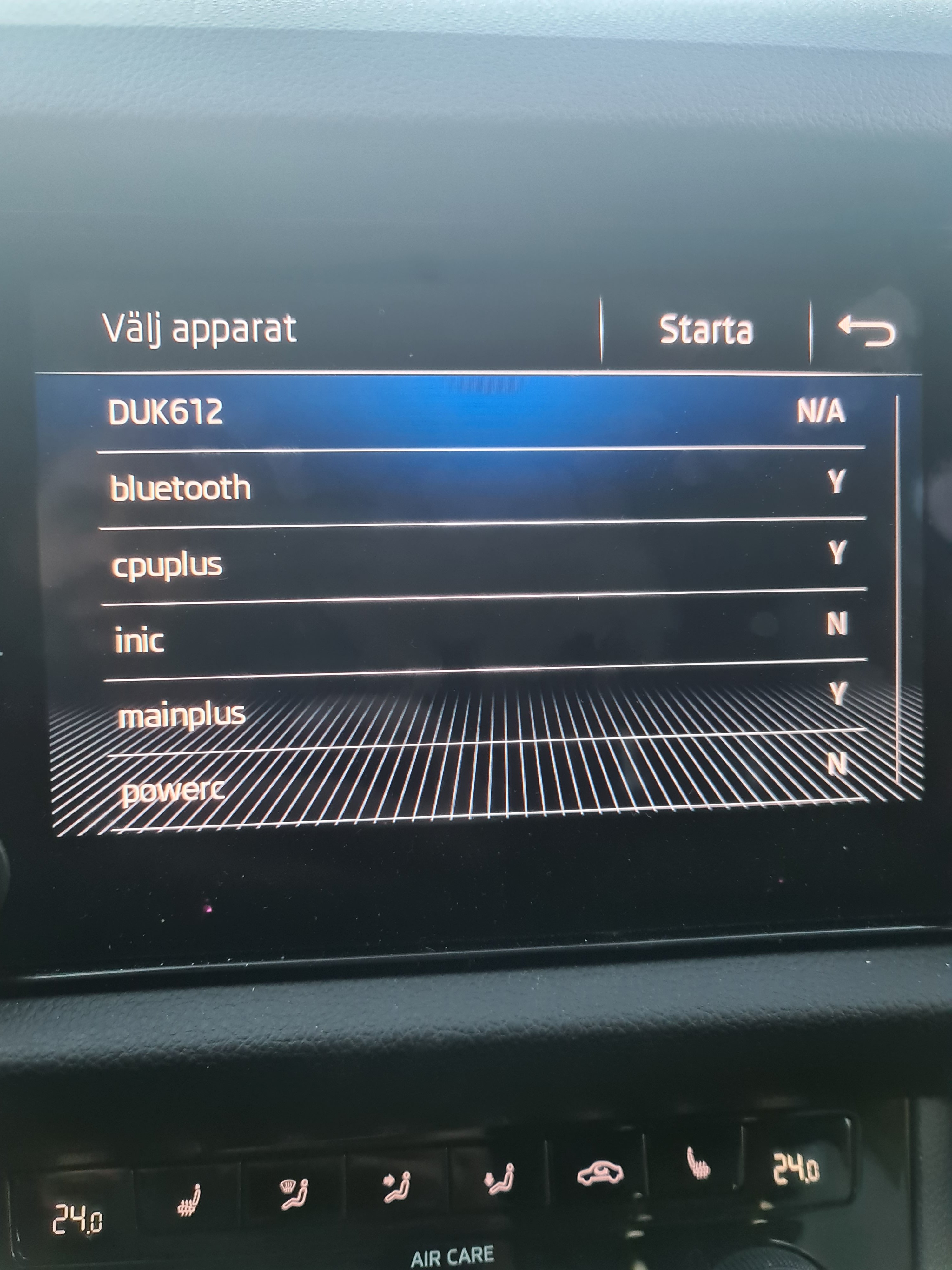

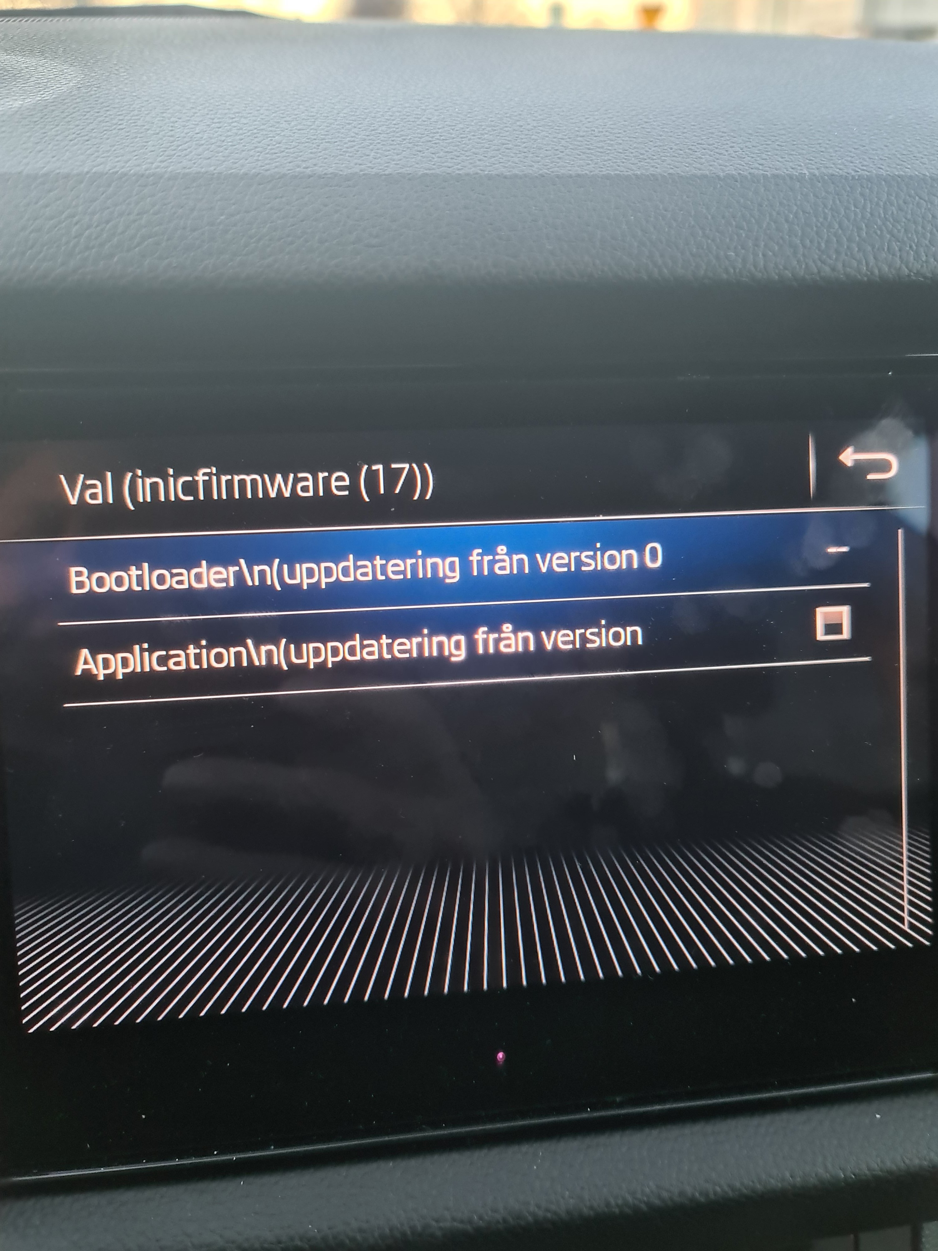

Should I put Y(yes) on section inic and powerc when I update?
I left all the settings alone, it should check version in the car, and then compare version available in update.... and then it chooses Y/N as needed.
So to also make things safe, leave all values alone (as default)

Thanks guys. What about the red globe sign with key underneath. what is that for? previously it was either green or white.

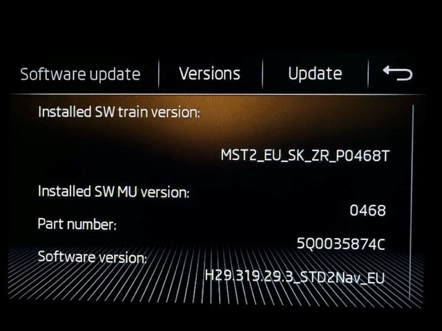

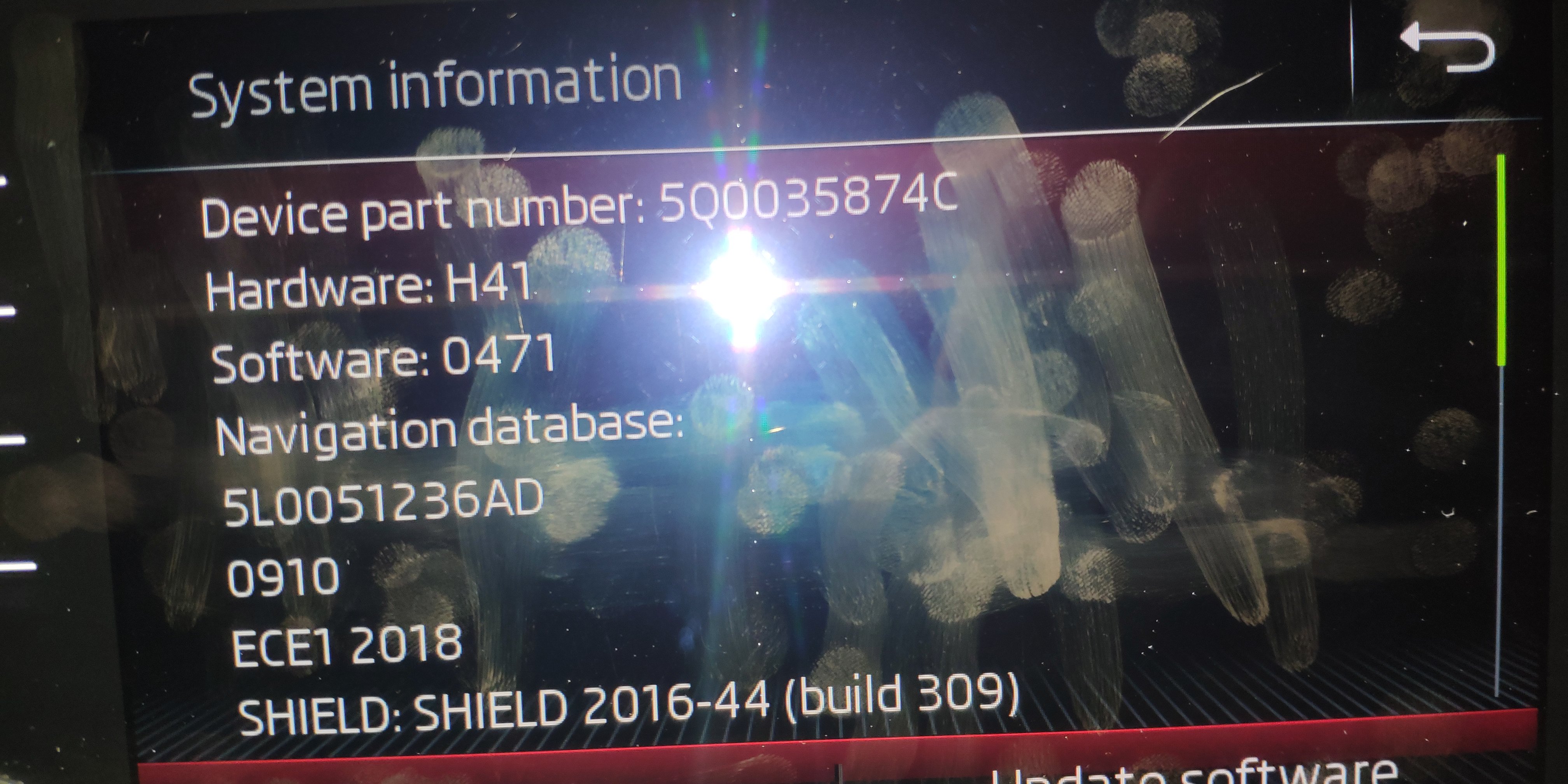

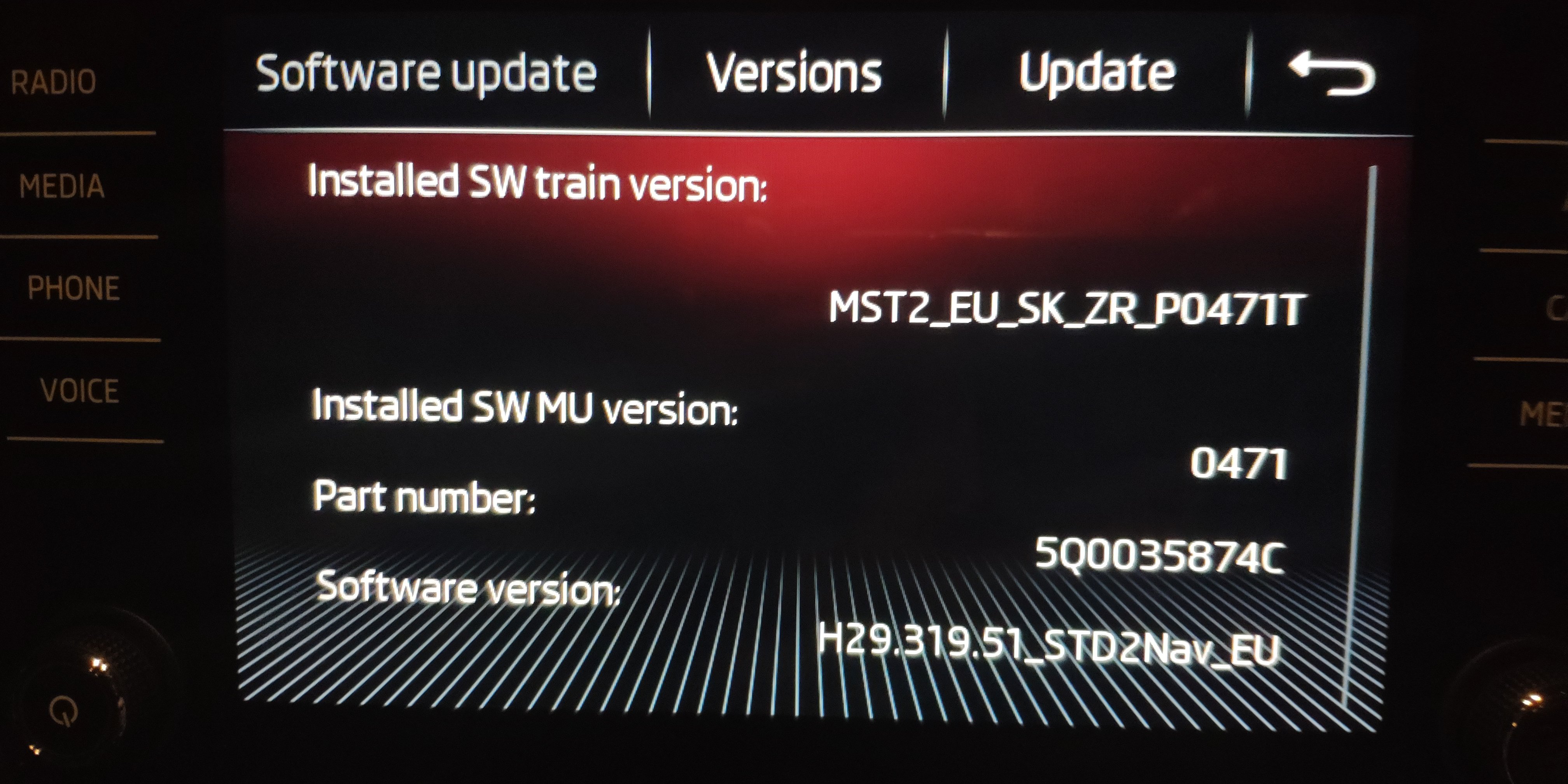

Hi,
Is there an updated firmware for my Octavia VRS MK3 MY2018, which has the following hardware/software versions
Part Number: 5Q0035874C
Software: 0471
Train Version: MST2_EU_SK_ZR_P0471T
If yes, please could someone send me a link and some foolproof instructions on how to update it (can it be done via USB ? SD card ?)
(Pictures attached)
It will be some form of online connection, but I don't use, so not sure how you will fix.
16 minutes ago, Moorwen said:
Hi,
Software: 0471
(Pictures attached)
/cdn-cgi/mirage/7f3a4109b7c9db5275ba0696e58b3cb7d9ae65c743ad6ace706caf7e66e199cc/1280/https://www.briskoda.net/forums/uploads/monthly_2022_12/IMG_20221215_211700.thumb.jpg.3e2dcae59b8d82741527ca6a1dc73cb5.jpg
/cdn-cgi/mirage/7f3a4109b7c9db5275ba0696e58b3cb7d9ae65c743ad6ace706caf7e66e199cc/1280/https://www.briskoda.net/forums/uploads/monthly_2022_12/IMG_20221214_175339.thumb.jpg.7aabda097b7ca62ba74daf906602eede.jpg
I can send 0480, and some destructions with it.
Firmware & instructions worked great ! Took 15 mins or so.
Thanks a lot !
(Used a microSD with a SD card adapter, the USB while it said it detected an update, did not enable the USB option in the engineering menu.)
