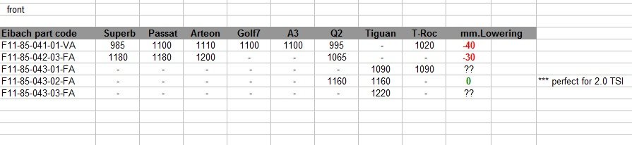

I was just trying to highlight that Passat B8 and Superb 3 basically have the same springs.
The sets I quoted above list both cars with varying engine and drive configs on both sets. So yes they are definitely close. It's just frustrating that it's hard to find actual specs for the springs.

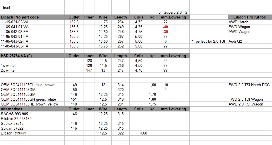

  • So, first thing: JR RS is absolutely right. There are two Eibach Pro-Kits for the Superb, one for the liftback and one for the wagon, with the numbers as he says. I bought the wagon version (for my li
  • As you are running Skoda "lowered ride height" springs, ie. 5Q0411105HE front and 3Q0511115AC rear, you could change to the slightly stiffer 5Q0411105HF (about 5% stiffer) or 5Q0411105HG (about 10% st
  • I suspect you're right. There are a lot of people who set something just as they like it, then can't bear the idea of it being adjusted. Mirrors, seat position, steering wheel. I switch driving m

The 5Q0411105GM front spring is listed for the Superb MK3 2.0TDI 190PS FWD
The 5Q0411105GN front spring is listed for the Superb MK3 2.0TDI 190PS 4x4
From the specification below, 5Q0411105GM is about 5% softer than the 5Q0411105GN and is 3mm shorter in uncompressed length. However, if you fitted it to your 4x4 it would lower the unladen front ride height by about 6mm because the softer spring compresses more under the weight of the vehicle.
Notice in the photos below that both springs have about the same number of coil turns, ie. about 4.6 coil turns. This is important to check when comparing the stiffness of two different springs because more coil turns will make the spring softer with all other things being equal.
Specification of 5Q0411105GM according to gknautomotive.com
Spring Design Coil spring with constant wire diameter
Fitting Position Front Axle
Colour Coding Blue, Grey
Wire Diameter 12.25 mm
Length 315 mm
Outer diameter 146 mm
Weight 1.7 kg

Specification of 5Q0411105GN according to gknautomotive.com
Colour Coding Green, White
Wire Diameter 12.5 mm
Length 318 mm
Outer diameter 151 mm
Weight 1.8 kg

my guess, these will be lower and softer than 11-85-043-02-FA Eibach Pro
1 minute ago, MartiniB said:
Supongo que serán más bajos y suaves que 11-85-043-02-FA Eibach Pro
I don't think they are lower than the EIbach's as they are the OEM Sportline's. As far as hardness, I don't know.
I am asking for budgets to install the Koni Special Active.
What seems curious to me is that the Lesjofors online catalog indicates that for my car the rear is 3Q0511115M of rank 5 and I have installed a 3Q0511115AS with rank 6.
missing info about Coils can't give full picture, but 1 mm thinner Wire says they are softer
Edited by MartiniB
5 minutes ago, MartiniB said:
la información faltante sobre las bobinas no puede dar una imagen completa, pero el cable 1 mm más delgado dice que son más suaves
Following your table I see that the GN and the HE are "same" but with different height? Where can I decipher the PR code of the front springs?
Being Sportline springs, the stops would be 55mm and 112mm, right?
