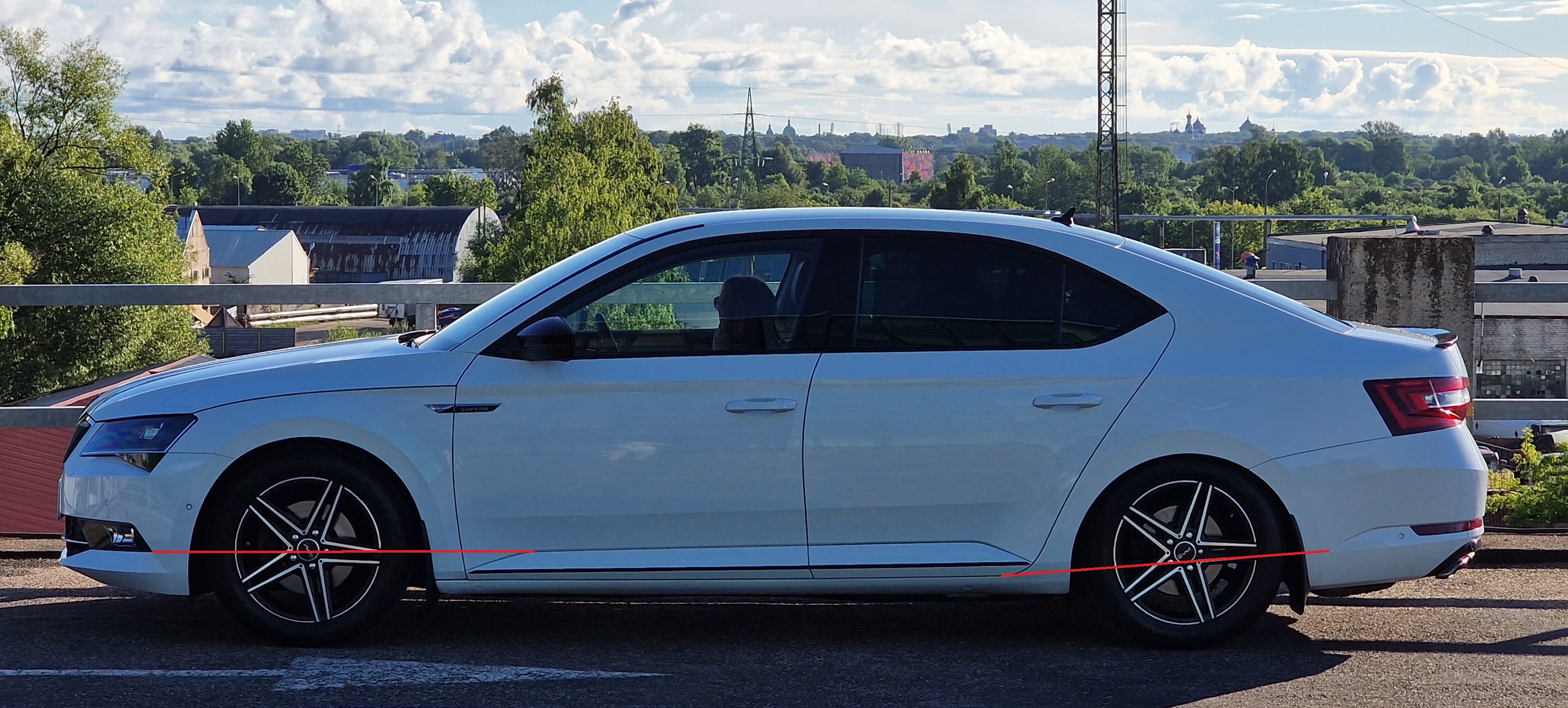

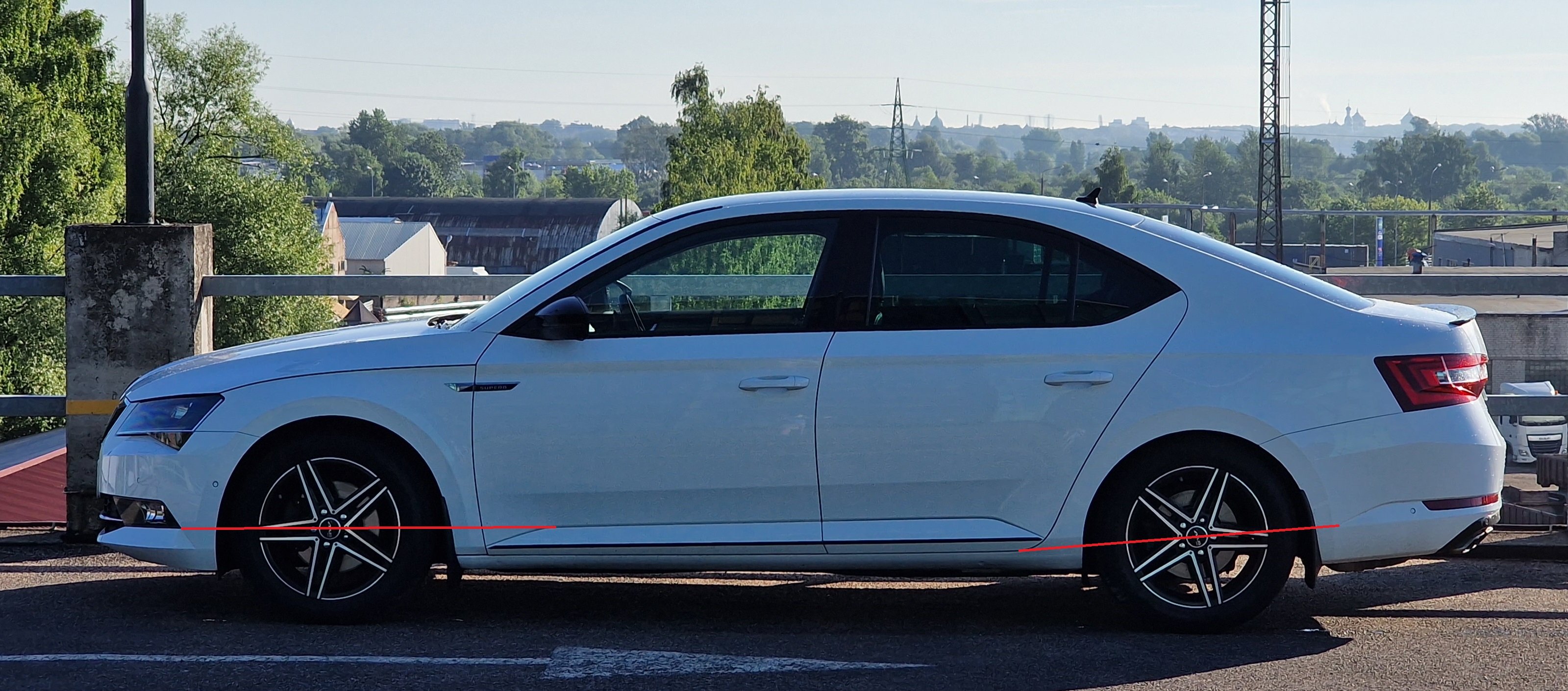

7 hours ago, MICKSVRS said:
Eibach springs plus spacers.
221026_BriSkoda_MICKSVRS_EibachPro_ED.thumb.jpeg.fa35eab809552ef9ad4731f4ffefe2cd.jpeg
crazy low :)
interesting, how this will look with passengers?
and what exact specs:
engine? i can guess it's not 280ps
DCC, no?
part numbers of OE springs?
part number of Eibach Pro springs?
still searching for Eibach Pro stiffness with zero lowering for my next 280ps AWD
for current 220ps FWD have found
Eibach Pro F11-85-043-02-FA front (from weightier Audi Q2)
Eibach Pro F11-79-008-01-HA rear (from weightier Superb 4x4)
-> https://www.briskoda.net/forums/topic/485647-bilstein-b6-dcc-shock-absorbers-available-at-last/?do=findComment&comment=5625462
empty car:
643341971_20220711_01_Eibach_Pro_frontrear_ED.thumb.jpg.b7cffa3f33407550183c8da00109dc7b.jpg

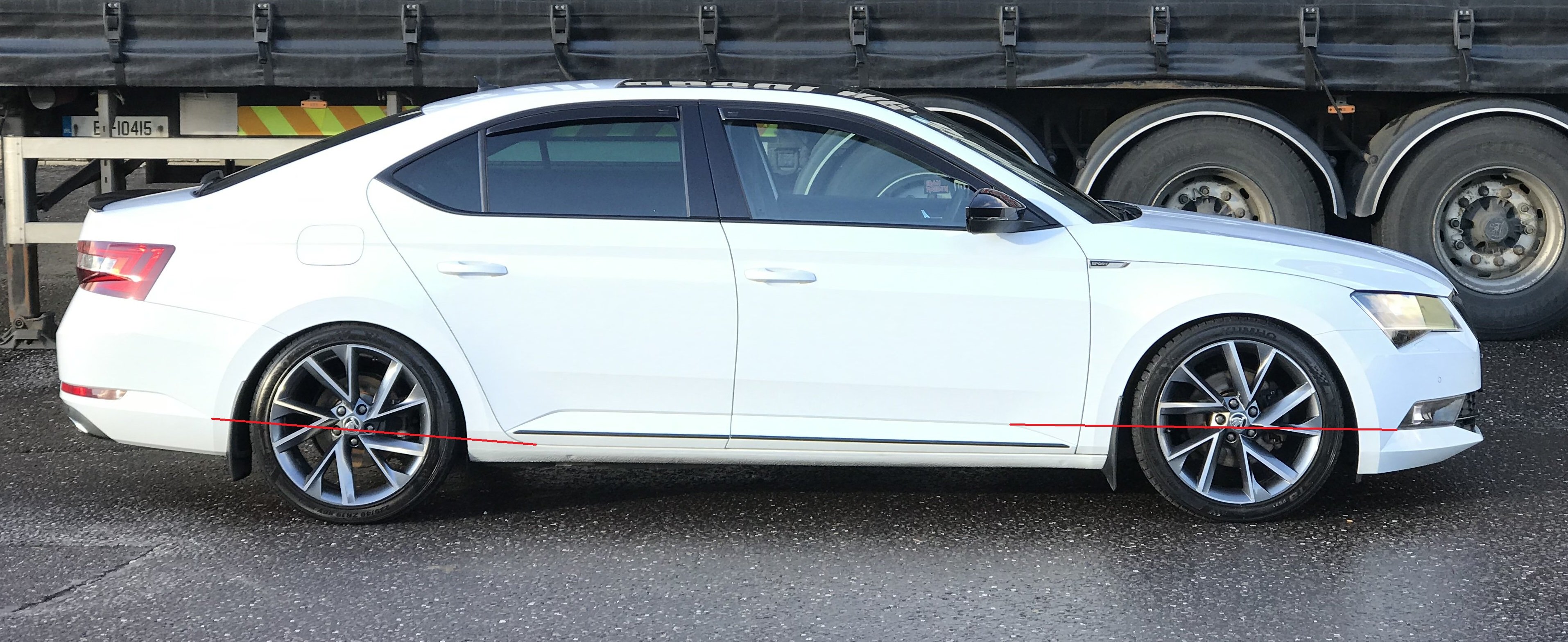

with four passengers, without pilot:
1402287797_220717_Eibach_Pro_frontrear_4passengers_ED.thumb.jpg.51d8a934683c928e347404c21b18d3cc.jpg

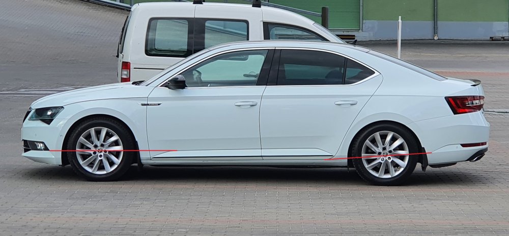

standard springs after 4 years:

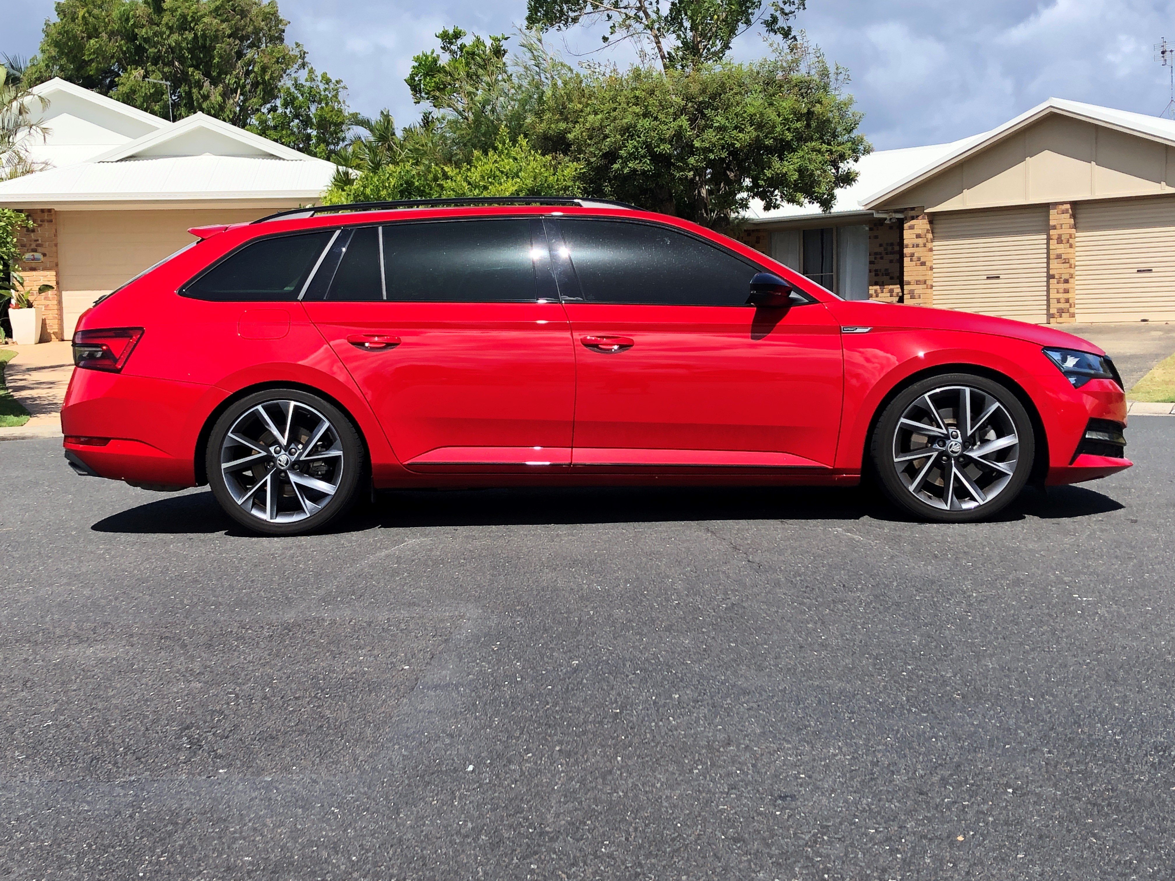

So new Eibachs are in.  Haven't been able to measure the drop yet as away from my garage where it's relatively flat.  Few noticeable changes:
  • gap between arch and top of tyre in the rears looks a lot less than the fronts?  rears almost look recessed into the arch, whilst fronts still appear to have a slight gap (which is fine).
  • DCC "Normal" setting I still find a little floaty over bumps at high speed.  But "Sport" is very stiff/firm and a little harsh for our Aussie roads now so I'm in a little quandry now
  • Headlights on normal beam less lighting distance, which seems odd given my first dot point above (implies car is lower in the rear than the front)
But I definitely prefer the stance now.  And it's opened my eyes to probably not going so drastic in the rears for my offset on my new rims I'm eyeing off.
BTW - I have a MY21 Sportline Wagon with DCC FYI.

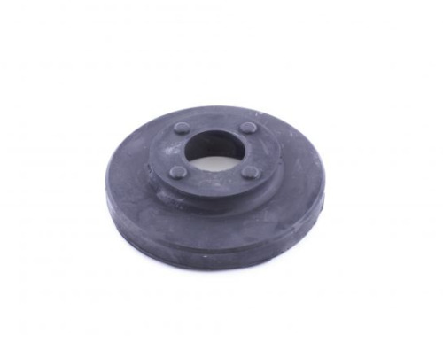

Also if you want your rear to sit a little higher you can fit these apparently. Should give you about 6.5mm extra height in the rears. Audi TT rear spring seat 8J0512149.
Do you happen to have a photo of how this looks and the model of the springs you installed? I have the opposite issue and rear is much higher than the front. Eibach have confirmed this is normal though after providing the measurements from hub to arch.
For reference, the springs I have are: E10-79-012-04-22
I don’t have a photo yet as it’s been torrential rain from the day I got them installed. I’ll see what I can do once the rain goes away. Will also take some measurements once my car is back in my garage next week.
yes I got the E10-79-012-04-22. Yours is a Sportline wagon?
what are your measurements from hub to arch?  Has your headlight distance been affected?
Edited by Donweather
According to eibach.de the E10-79-012-04-22 kit has the following rear springs:
Eibach F11-79-008-01-HA Pro-Kit rear springs
Length: 327mm
Wire Diameter: 13.75mm
https://www.autodoc.co.uk/eibach/7518932?search=EIBACH Coil Spring (F11-79-008-01-HA)
Eibach online spring catalogue
https://web2.carparts-cat.com/default.aspx?11=279&14=4&1115=1&1281=17=0&10=E49EFADE6E4E41D9A67E8C79E22375BF279004&12=100
Edited by Carlston
Mine is a Sportline hatch but according to Eibach they are compatible with both. With yours being a wagon, that might account for why the rear sits lower. The additional weight might be pushing it down a bit.
Measurements were 350mm front and 356mm rear. Unfortunately, I don't do much night driving so couldn't tell you if there was any range difference. Haven't noticed anything significant though.
If yours is a FWD hatch and not a 4x4 hatch, you've got the wrong rear springs...at least according to the engine variant that I looked at. And being rear springs they generally vary according to whether it's either hatch or wagon and either FWD or 4x4...and not so much the engine/transmission variant although there may be exceptions.
Eibach list the 303mm rear springs with part number F11-15-007-04-HA for the FWD hatch, not the much longer 327mm rear springs with part number F11-79-008-01-HA...which could explain why your rear ride height is too high.
Edited by Carlston
I could have sworn there was different rear springs for a hatch vs wagon to account for the issue the wagon would likely have more loaded weight.  Let me check what I have from Eibach.
I checked my parts before they were installed:
Eibach F11-79-012-04-22 Pro-Kit
Rear springs F11-79-008-01-HA
Front Springs F11-85-042-03-FA
The Eibach information I have doesn't distinguish between wagon or estate in the above, but I do note from the information I have that if your's isn't the 4*4 then you should have E10-79-012-03-22 (which has rears F11-79-008-01-HA and fronts F11-85-041-01-VA which are different).
Here's a pic of mine.  If you look closely you can see the gap in the wheel arch from the top of the tyre is less in the rear that the front.  It's a little harder to see the full gap due to the shadow, but you can see some difference.
