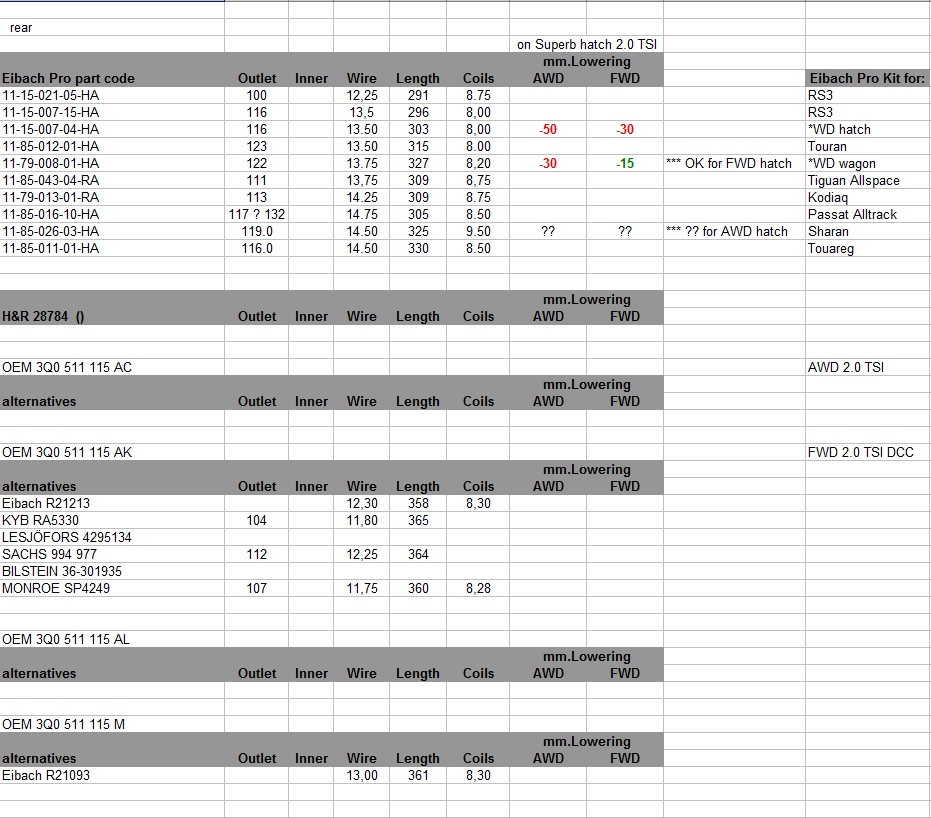

Hello. I welcome all forum members. i'm new here. I have a skoda superb style 2.0tdi 190 dsg, wagon and year 2020 with standard suspension without dcc. I would like to replace the standard springs from the sportline. if anyone knows the catalog numbers for the front and rear sportline springs for such a superb model i would be very happy. now I have the following springs installed. front: 5Q0 411 105 GN, rear: 3Q0 511 115 AL. I would be most happy if someone can find a similar car with a sports chassis and entrust me with the chassis number, through which I can immediately find the appropriate springs.
@MartiniB
I think that the car will be too stiff with such a spring setting. In combination with the original shock absorbers, the ride will be bouncy. I'm still looking for someone who has the same car, i.e. station wagon, 2.0tdi 190KM dsg with original sports springs
any of OEM springs will be too bouncy, as result annoying waterbed.
and note, "Sportline" springs aren't the same as springs from optional "Sport suspension"
i can promise, these(fronts F11-85-043-02-FA) Eibach Pro won't be too hard, just stiffer without lowering.
for double check, ask to @fencer
-> https://www.briskoda.net/forums/topic/478335-does-the-sportline-have-stiffer-suspension/?do=findComment&comment=5713073
for wagons or AWD hatchs rear, maybe these will be better 11-85-016-10-HA or 11-85-026-03-HA
not tested, guessing just by looking on springs specs

I have chosen eibach front F11-85-043-02-FA , but i cant decide which rears to choose, as i do a bit of towing. I am after stiffening up, that's all.
I've narrowed it down to eibach R10828 or F11-79-008-01-HA.
Which would be the best?
I mistakenly bought a pair of R21706, and these are good 30mm too tall for me, so if anyone wants to make me an offer........
Thanks
perfect!
11-79-008-01-HA
is little bit low even on FWD Hatch, check pictures few posts above
i can suggest four lottery tickets :)
11-79-013-01-RA
11-85-016-10-HA
11-85-026-03-HA
11-85-011-01-HA

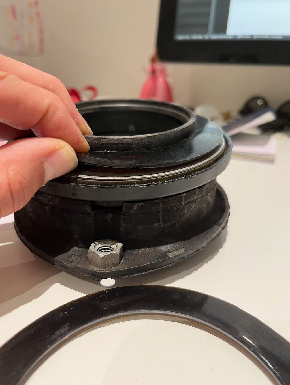

Hello
This is my first post here...
I have a 2020 Superb Combi Sportline 2,0 TDI 190PS DSG with 19’s no DCC, no trailer hitch. I want to get rid of the softnes and stiffer it. The car fels like a big boat and the suspension travels to much on the speed bumps.
Sportline setup. means Standard shocks + sport springs. But way to soft.
Now is fitted with the original spring colis, the front have a brown and yellow dot. I found this info:
5Q0411105HE Coil spring
1 paint mark
1 paint mark
brown
yellow
2 PR-L18
But now how to proced? I will prefer not to lower the car to much, it is already 15mm lower than a standard one. Maybe 30mm lower than standard will be ok.
I supose I need new coil springs, to firm the stiffer the car suspension. But when I look at the Eibach spring I got lost. There are a lot of options, I need to figured out what is fitted now on the car.
Do I need also new shock absorbers such as Bilstein B6?
I found also some advice to fit a Passat B8 Anti-roll bar or a new eibach Sway Bar?
I am open to some advice how to proced.

that gave me conclusion, the most, 65% of performance improvement, came from stiffer Eibach Pro springs
-> https://www.briskoda.net/forums/topic/485647-bilstein-b6-dcc-shock-absorbers-available-at-last/page/4/#comment-5697843
for 2.0 T*I front axle Eibach Pro F11-85-043-02-FA springs(Pro kit for Audi Q2) will add stiffness without lowering
for 4x4 rear axle i can suggest four Eibach Pro lottery tickets:
11-79-013-01-RA
11-85-016-10-HA
11-85-026-03-HA
11-85-011-01-HA
21 minutes ago, A7AS said:
So with sports suspension, which is 15 mm lower as I understand, should I go with B6 or B8? Or maybe choosing Eibach just absorbers, not the kit with springs? If so - which absorbers would be right option? Confused 😕
Cant remember the exact fgures and I'm fairly certain it changes between models, but, the B8 is roughly 30mm shorter so I would say you need a drop of at least that to make them work correctly.  Otherwise the springs would be preloaded too much.
Short answer, go with B6 for 15mm sport height.
2 hours ago, MartiniB said:
@A7AS
copy-paste from another tread:
due Bilstein parts shortage in 2021.
i had to install Eibach Pro springs on the rear axle few months earlier than Bilstein B6 DampTronic shocks
11-79-013-01-RA
11-85-016-10-HA
11-85-026-03-HA
11-85-011-01-HA
Thanks, but I have no luck with lottery :D
