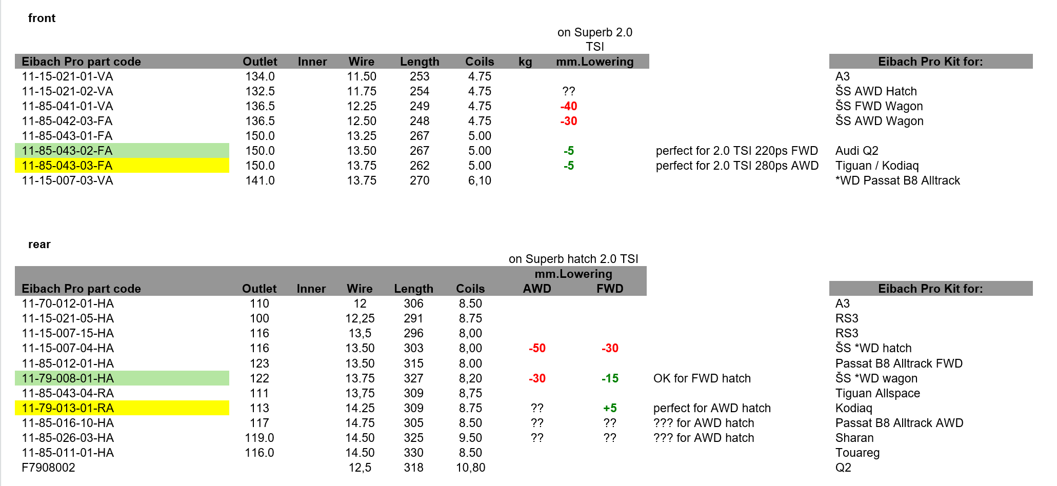

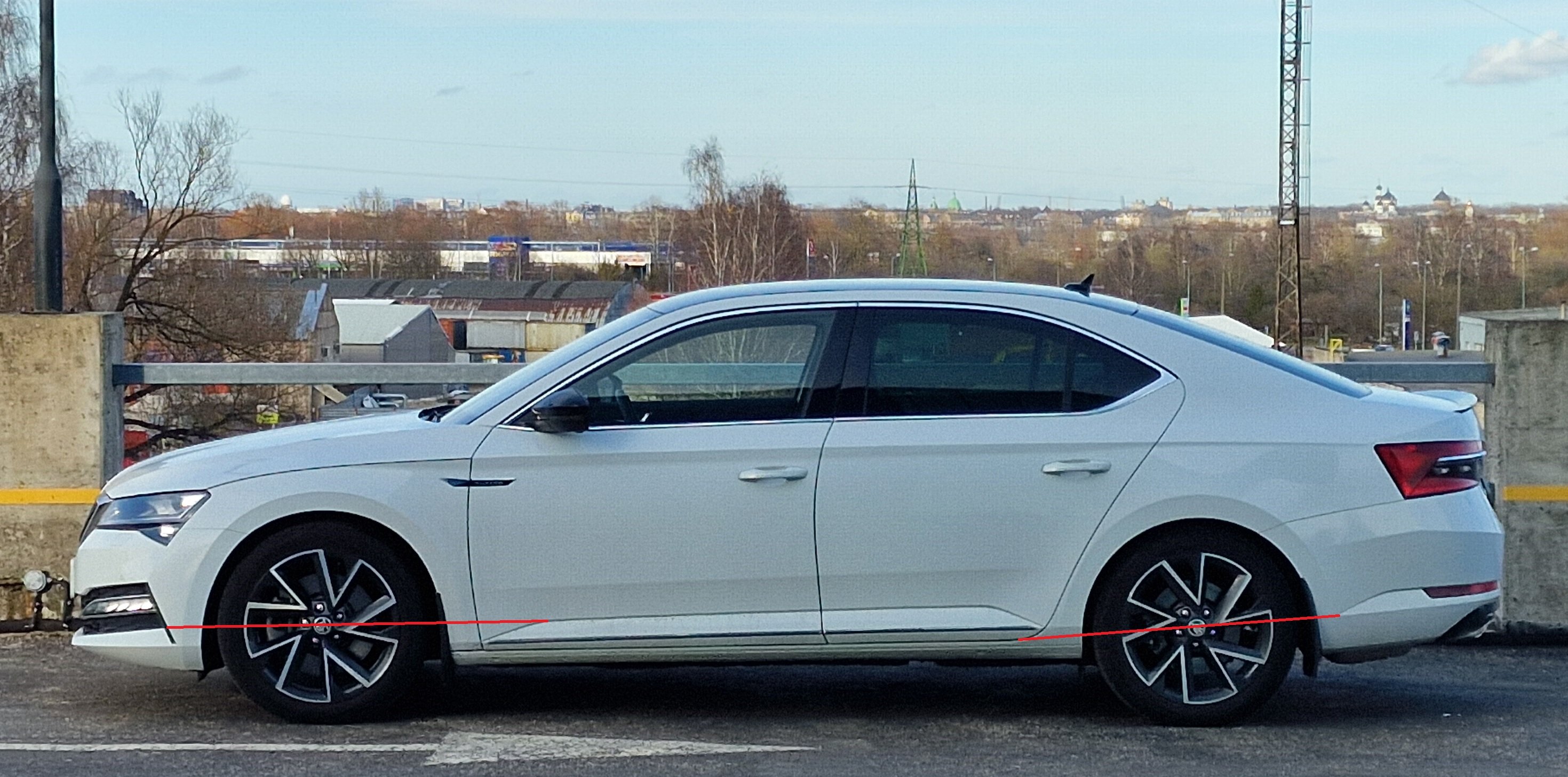

2023. Mk3.FL 2.0 TSI 280ps AWD
challenge, stiffness without lowering, succeed
front
Eibach F11-85-043-03-FA + Bilstein B6 DampTronic 23-254343
rear

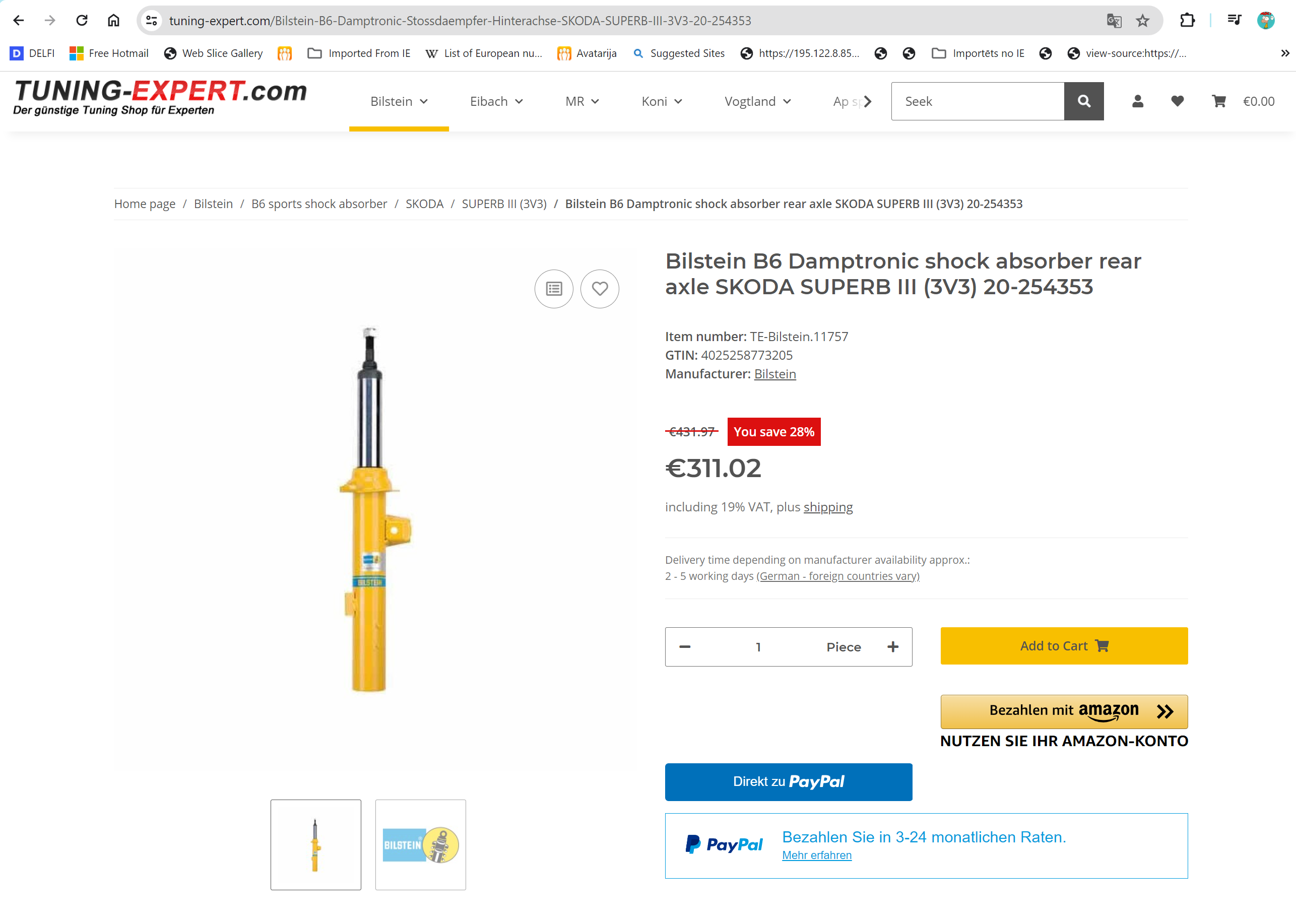

Eibach F11-79-013-01-RA + WRONG Bilstein B6 DampTronic 20-254353 (correct part code would be 20-267537)
OEM DCC
front
3Q0 413 031 AK + 5Q0 411 105 GN
rear
3Q0 513 045 AD + 3Q0 511 115 AL
played lottery also on front axle because
a) rear axle had it in any case
b) four springs set, Eibach Pro-Kit from Kodiaq E10-79-013-03-22, priced €193 while four separate springs €265
c) front of 280ps, in theory, has extra weight from bigger turbine and DSG radiator
choice table (green 2.0 FWD / yellow 2.0 AWD)

i were too much focused on springs parameters as result i didn't double checked what b-šhit is on sellers page
such small mistake, minus €700+ (seller already rejected, crossing fingers on PayPal)

You are the man! 😀
The unsettling body movement given by the original suspension setting on uneven roads is a real disappointment on the handling.
Thanks for making the effort (physical and economical!) to achieve better solutions!
