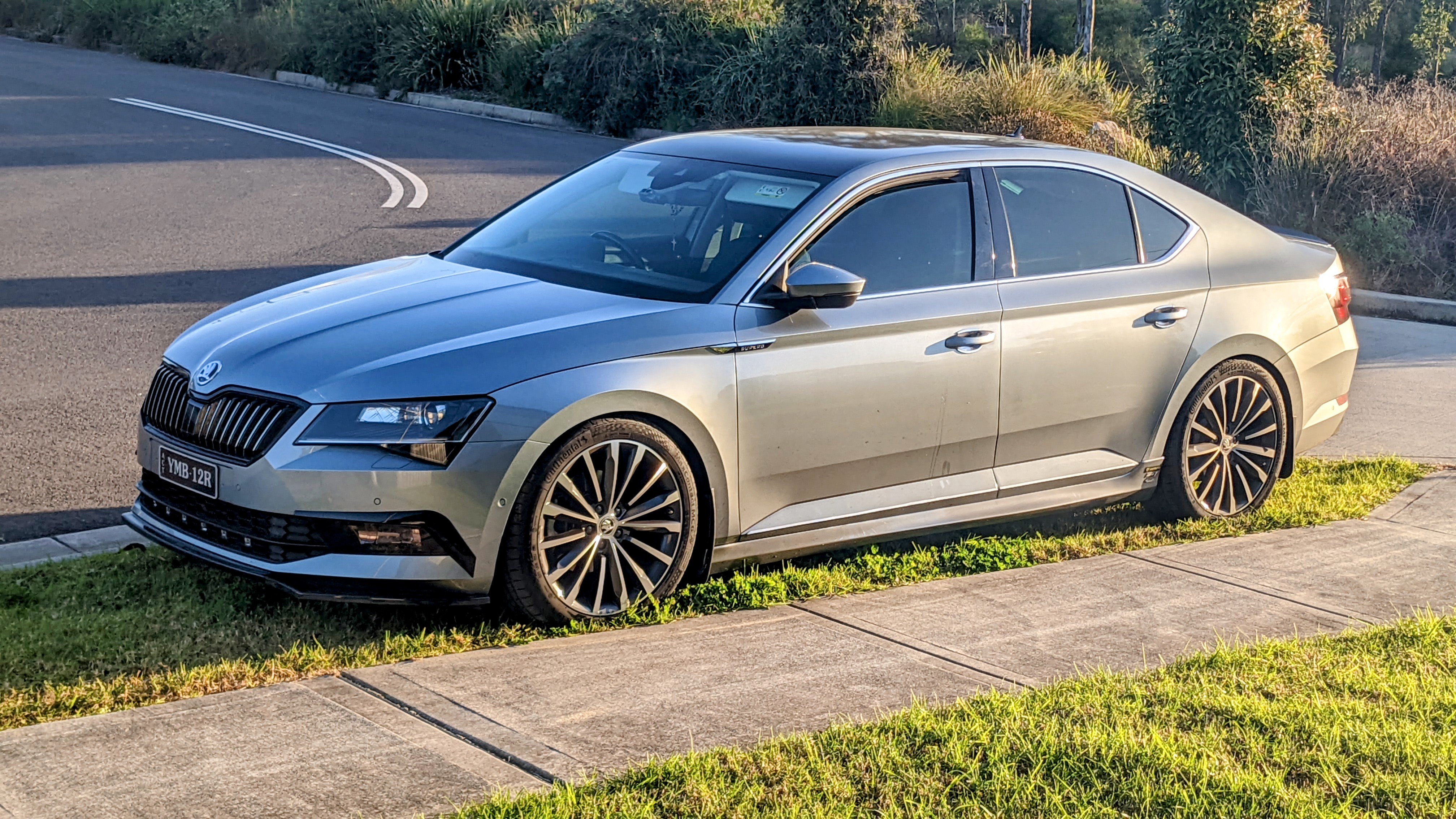

I've been using Eibach springs for a Passat B8 in my Superb 220.
Edited by JR RS
1 hour ago, JR RS said:
I using Eibach springs for a Passat B8 in my Superb 220.
Eibach lowering springs or standard height?
Lowering springs - E10-85-042-02-22
Car dropped 20mm.
I have factory DCC shocks.
Car dropped 20mm.
