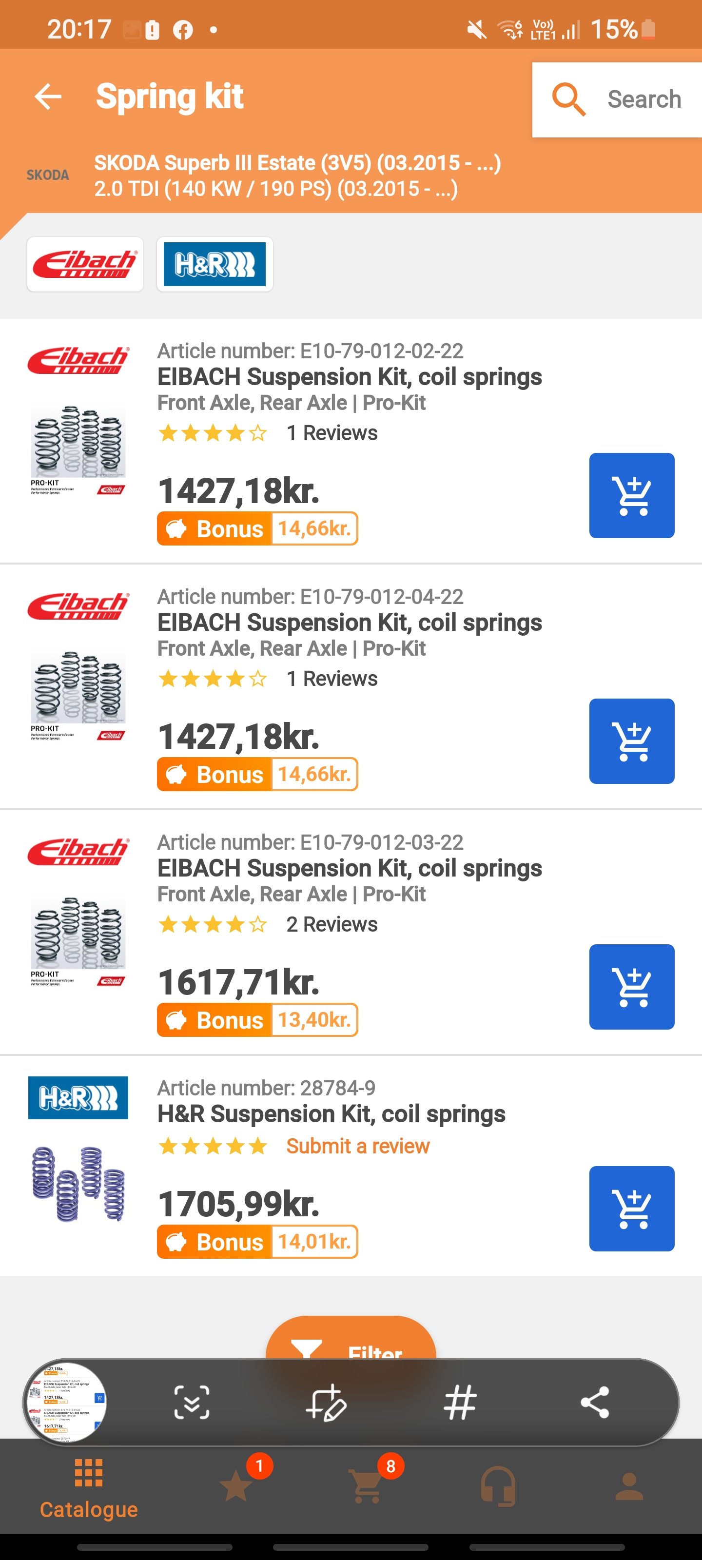

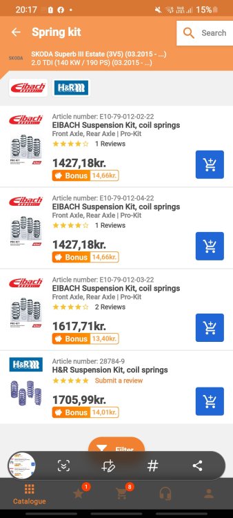

On autodoc there are 3 sets from eibach. On the eibach homepage, all of them said 30mm lowering... what's the difference between them;)
By default Ebach and H&R ofers only lowering sets 😞

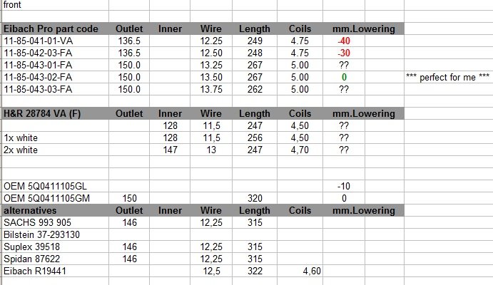

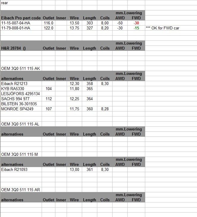

that which i found were guesed by compare different wights
Audi Q2 1.5 has same Eibach springs as Superb 2.0
and i chose from Audi Q2 2.0, what gave stiffnes whitout lowernig.
for front axle this will be good, but for rear axle you have to make your own calculation and guess.
with AWDs rear springs on my FWD Supereb i'm not satisfied for 100%
ride condition is perfect, but it is lower for 12mm than OEM DCC springs, whic were lower 10mm than standart suspension

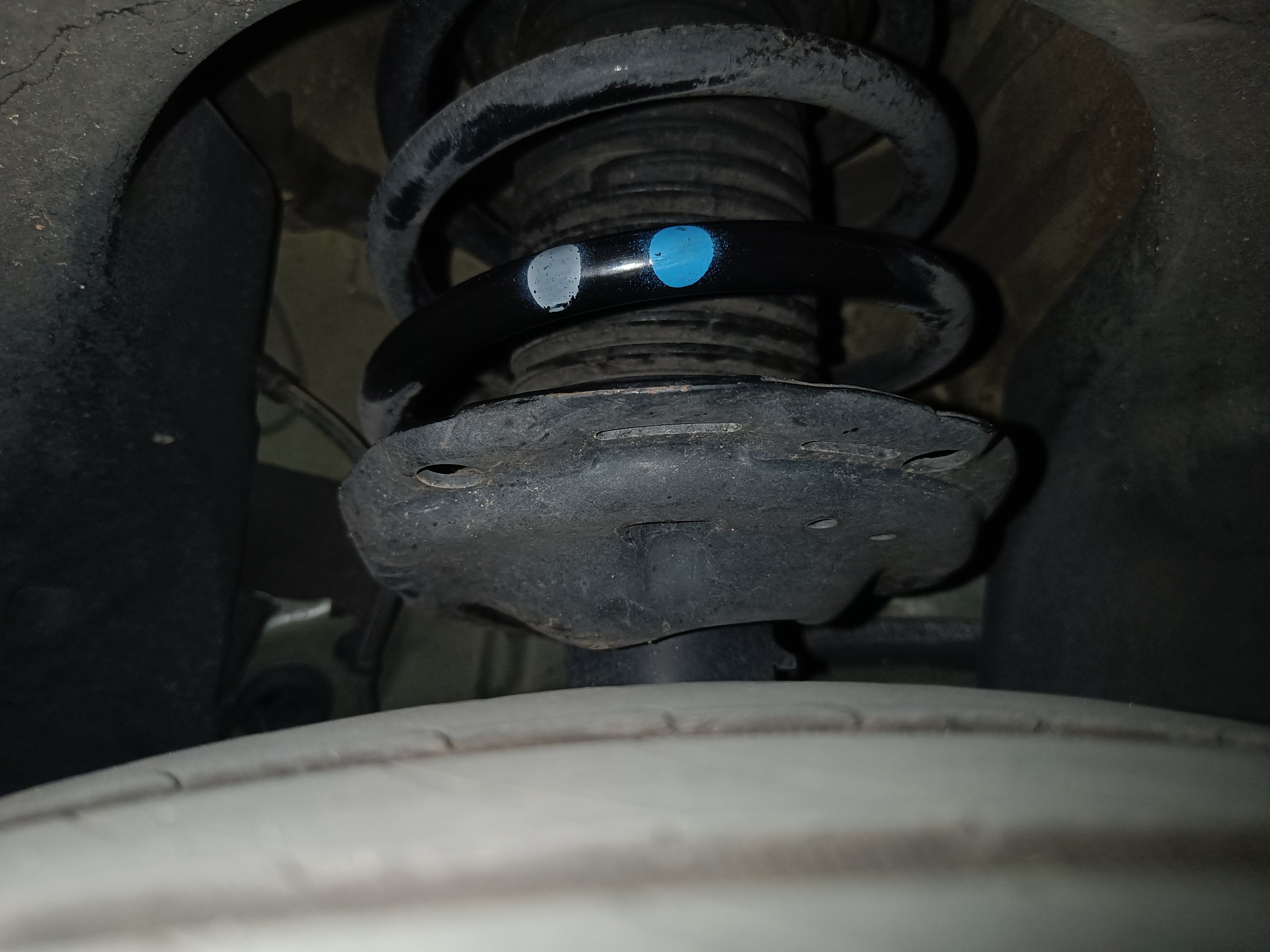

If you check your car's build codes, you can find out what the standard springs are.
For the Superb MK3 2.0TDI 190HP FWD estate, these might be (according to the Kilen/Lesjofors spring catalogues):
5Q0411105GM Front coil spring L07
1 blue dot, 1 grey dot
https://www.autodoc.co.uk/car-parts/oem/5q0411105gm?search=OEN+5Q0411105GM&supplier[0]=112&supplier[1]=246&supplier[2]=32&supplier[3]=253&supplier[4]=112&supplier[5]=246&supplier[6]=32&supplier[7]=253
3Q0511115AK Rear coil spring 1JA+0YC
https://www.autodoc.co.uk/car-parts/oem/3q0511115ak?search=OEN+3Q0511115AK&supplier[0]=32&supplier[1]=112&supplier[2]=253&supplier[3]=246

if care about driving conditions, i can say only one -
standard springs are too soft, but lowering sets from Eibach / H&R are too short
even when install rear Eibach's AWD springs on rear axle of FWD car i would prefer 20mm higher rear

6 hours ago, MartiniB said:
Si me preocupan las condiciones de manejo, solo puedo decir una:
los resortes estándar son demasiado blandos, pero los juegos de descenso de Eibach / H&R son demasiado cortos
incluso cuando instale los resortes AWD traseros de Eibach en el eje trasero del automóvil FWD, preferiría una parte trasera 20 mm más alta
- >  https://www.briskoda.net/forums/topic/485647-bilstein-b6-dcc-shock-absorbers-disponible-al-final/?do=findComment&comment=5620484 _
resortes delanteros que "supuse" al primer intento, Eibach Pro de Audi Q2
coche vacio:
643341971_20220711_01_Eibach_Pro_frontrear_ED.thumb.jpg.b7cffa3f33407550183c8da00109dc7b.jpg
con cuatro pasajeros, sin piloto:
1402287797_220717_Eibach_Pro_frontrear_4passengers_ED.thumb.jpg.51d8a934683c928e347404c21b18d3cc.jpg
resortes estándar después de 4 años:

I just saw the docks that I have installed and these are.  I swear it's gray and blue.
5Q0411105HS front spring
1 grey paint mark and 1 blue paint mark
https://www.lllparts.co.uk/catalogs/skoda/CZ/SUP/851/4/411/411000
5Q0411105HS is used on the Octavia MK3 Scout, so is an increased ride height front spring, at least when used on the Octavia MK3.
You can see the specification of both the 5Q0411105GN front spring and the 5Q0411105HS front spring on gknautomotive.com
https://web.tecalliance.net/gkn/en/parts/1/87623/detail?query=5Q0411105GN&numberType=1&oe=5Q0411105GN&groups=188#@brc/search:Search%20by%20any%20number%205Q0411105GN;query:5Q0411105GN;page:0/detail:87623;brandId:1;articleNo:87623;query:5Q0411105GN;numberType:1;oe:5Q0411105GN;groups:188
https://web.tecalliance.net/gkn/en/parts/1/87966/detail?query=5Q0411105HS&numberType=1&oe=5Q0411105HS&groups=188#@brc/search:Search%20by%20any%20number%205Q0411105HS;query:5Q0411105HS;page:0/detail:87966;brandId:1;articleNo:87966;query:5Q0411105HS;numberType:1;oe:5Q0411105HS;groups:188
Edited by Carlston
