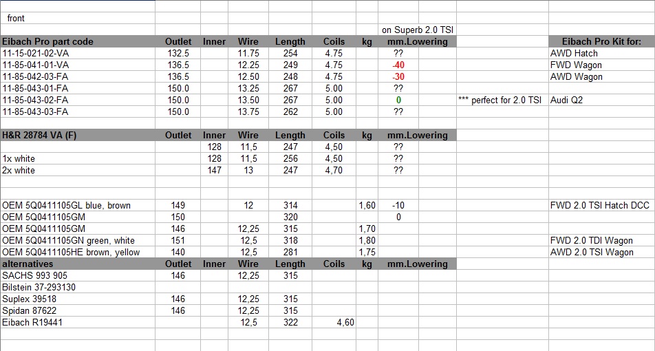

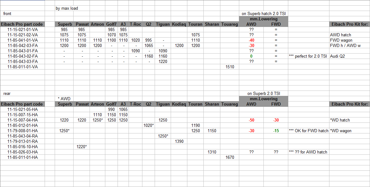

why limit yourself by kits, when Eibach Pro springs can be ordered separately?

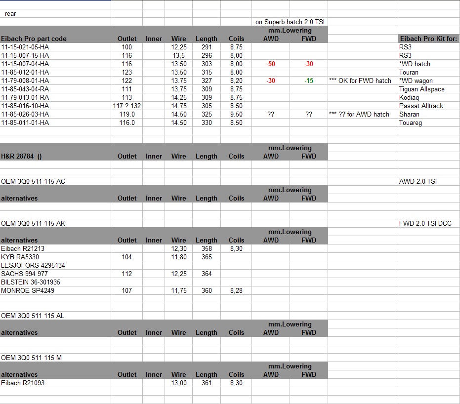

00_Springs_table_Front-Rear_Eibach_by_Max_Load.thumb.jpg.e35a569a8e2f25dda81d173fb1a7fa6f.jpg

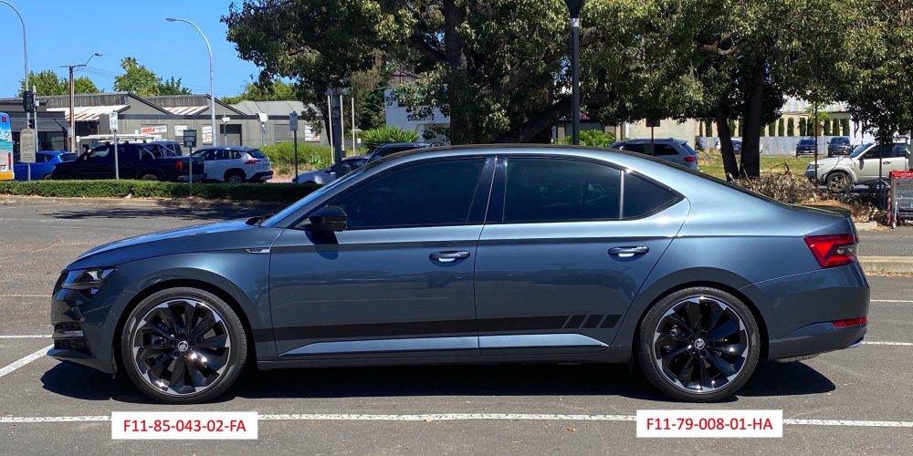

interesting, with same springs 280ps AWD's front dropped more than on my 220ps FWD,
but rear less, more over, mine got Audi pads on the top of rear springs

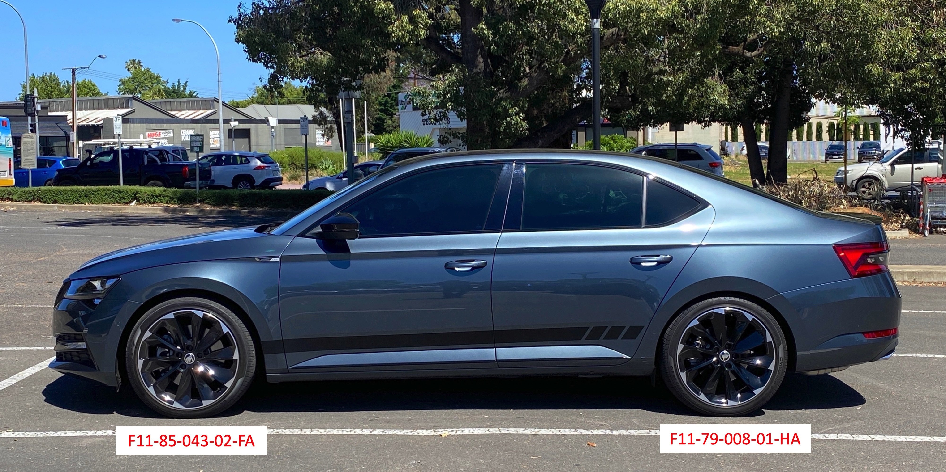

On 15/07/2022 at 12:27, MartiniB said:
distance between wheel center and arch corner
front F11-85-043-02-FA (from Audi Q2):
L. 376mm
R. 378mm
+ ~2mm if compare to stock
rear F11-79-008-01-HA (from 4x4):
L. 354mm
R. 354mm
- ~12mm if compare to stock
please add some day pictures how your looks with passengers or rear seat
Weird why ur 220 dropped more with AWD springs.
R they AWD wagon version or AWD hatch version springs?
AWD is much heavier than FWD.
There r different set of springs for AWD vs FWD.
In theory, if u use AWD springs in a FWD Superb - it won't drop as much compared to using the correct FWD springs.
...and vice-versa - if u use FWD springs in a AWD Superb, it will drop more than if it had the correct AWD springs.
Need to get the combo right, in addition to wagon / hatch.
i.e. body shape + drive type = spring set

springs were ordered separately, not whole kit.
Eibach doesn't offer ZERO Lowering kits 😞, i were interested on add stiffness.
by part codes must be identical
on rear i expected extra +10 mm to OEM DCC
as in this example, same rear springs on 2.0 FWD hatch
-> https://www.briskoda.net/forums/topic/478335-does-the-sportline-have-stiffer-suspension/?do=findComment&comment=5573227
but on rear got -12mm, acceptable, but why . .

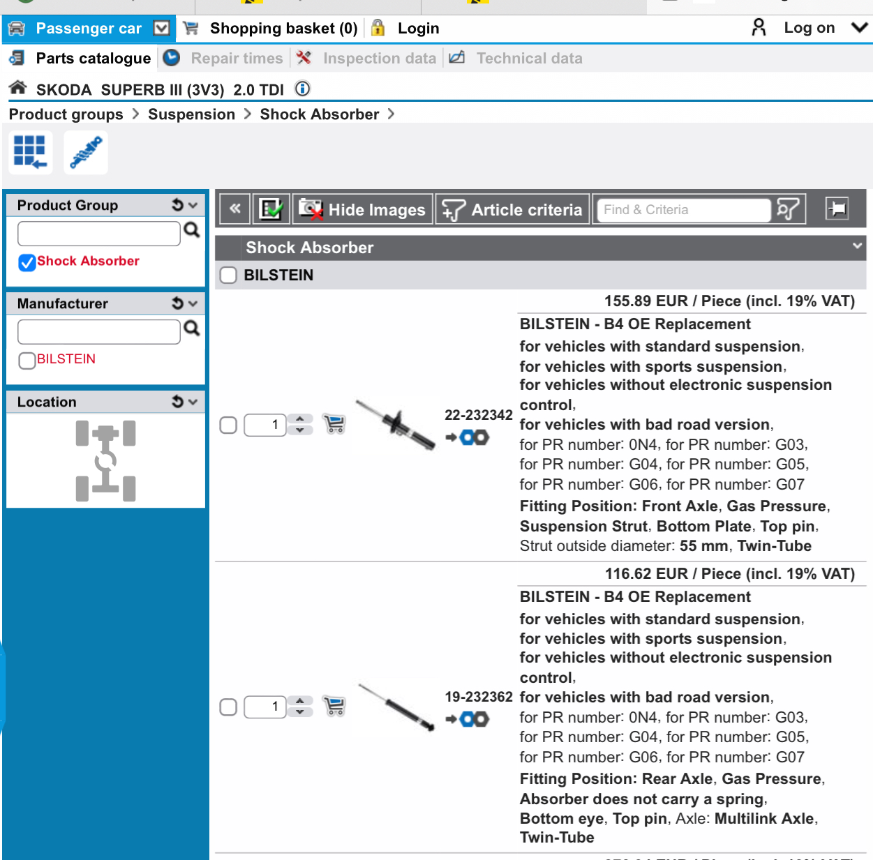

Hi Folks,
Wonder if any of you can point me in the right direction....
I have a 2017 150 diesel Sportline, have recently replaced the shocks with B4 replacements. The car is at 60k, and the handling was becoming dangerous!! The shocks have now been fitted for ~600 miles, but the feel is not 100%. I had the alignment checked in the first instance... but it was just needing one minor adjustment to correct.
Feels like the car is not as planted as it should be, still bounces uncomfortably at slow speeds through town/rough roads. Country roads the car feels much better with the new shocks at 40-60 mph, through a rough bend is not such a concern anymore, the support is greatly improved....
The slow speed discomfort is now the issue... I feel my rear springs may need replaced. The crashy/unspottedness seems to be from the rear more than the front. Struggling to nail down how to confirm the springs I need. This seems like it would be the next step to try and improve the ride....
On a side note, I have fitted a towbar to the car when bought at 45k, so the rear has had more load for around 5/600 miles of the last 15k. Wouldn't have expected that to cause issues with the springs, but maybe the standard ones aren't capable enough of the extra load. (Although just occasional use - with a 1-1.5t trailer (60/70kg nose weight)) I note reading some posts with regards cars with factory towbar's possibly having uprated springs.
If anyone can point me in the right direction to confirm standard replacement springs, or alternatively a more suitable spring to compensate for the occasional towing? I don't believe I need a hugely stronger spring, as the car spends most of its time lightly loaded.... Just the 5/6 times away with family in the year full with gear (often with bikes on the towbar) and occasional towing single axle trailer at 1.5t max.
Many thanks for any help
Marc

Which Bilstein B4 front shock absorbers did you fit?
You may have accidentally fitted front shock absorbers for increased ride height, which is the complete opposite of what you want for the sportline with its presumably lowered ride height.
To avoid this kind of mistake, it's important to match the OEM part number of your factory shock absorbers with the list of OEM part numbers that the particular Bilstein B4 shock absorber is sold to replace.
Edited by Carlston

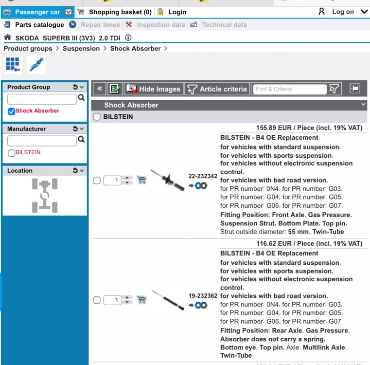

thanks @Carlston, for the detailed response. I’ve purchased a vin decoder.. so see what that comes back with. Assume this is more info than the sticker in the boot?
regards the B4 shocks, I have read your post within this thread on this… last night before posting my query today. The shocks I purchased are the only B4 standard shocks offered on Bilsteins website….
so, once I have the info to identify standard shocks, I will review the post you had up. Bit worried/confused why Bilstein wouldn’t offer the Passat shocks you identified as a fitment against the superb. Looking like this is going to be a costly issue if it is the shocks that are an issue /mis-fitment…
I checked these shocks against Bilstein, autodoc, and a post on the forum that stated them as a fitment for the superb….
I’ll update post with anything found out… resolution for my dodgy handling… 🙈 fitting B4’s was supposed to be the more cost efficient/sensible ‘it’s just a box for getting A to B’  option, rather than paying twice the price for B6’s or konis!
The Bilstein B4 front 22-232342 and rear 19-232362 shock absorbers that you list are the only Bilstein B4 shock absorbers that are listed on autodoc that cover some of the OEM part numbers for the Superb MK3 FWD without electronic suspension control.

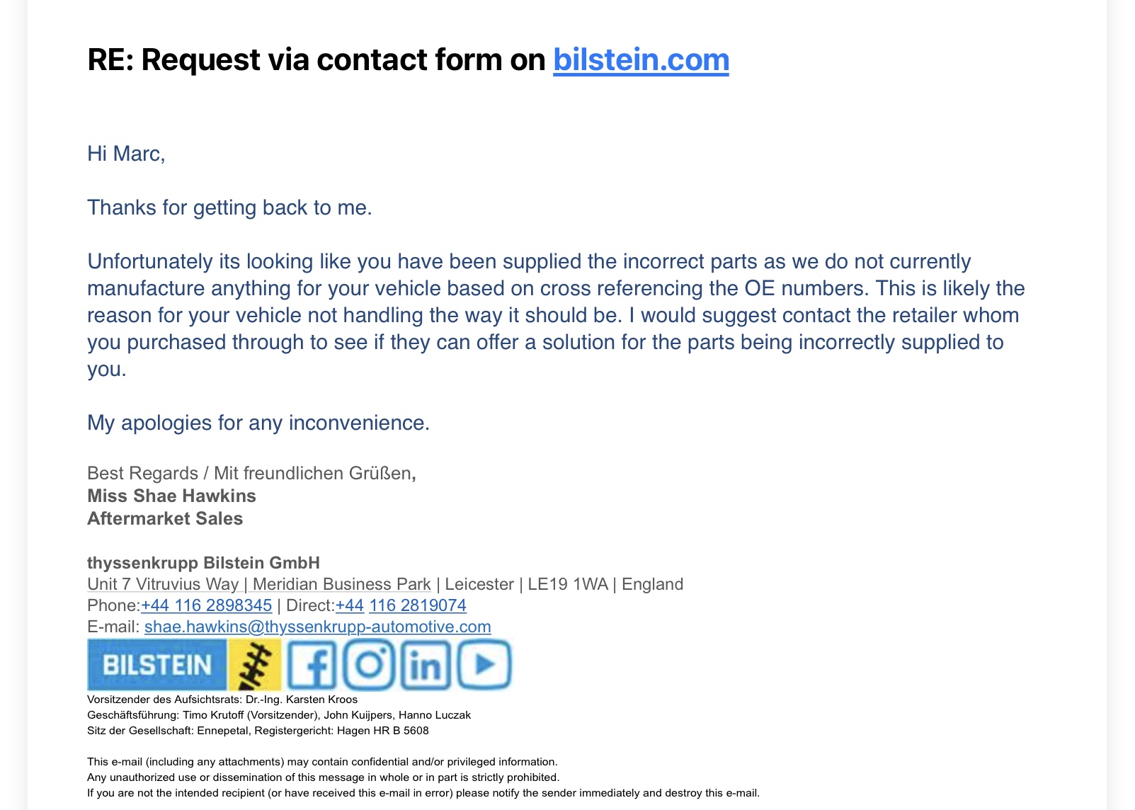

Yes, the rear shock absorbers could be either 3Q0513049FN or 3Q0513049FP. The KYB and Sachs rear shock absorbers listed on autodoc cover both of these OEM part numbers, so if you were going for these aftermarket shock absorbers it wouldn't matter which OEM part number your car originally came with out of those two OEM part numbers.
The rear Bilstein shock absorbers that you purchased are only listed against the increased ride height part number, which is the complete opposite of the sports/lowered ride height that you have. Saying that, many of the rear aftermarket shock absorbers use a one size fits all approach, so sell just one rear shock absorber to cover sports/lowered suspension, standard ride height suspension, and increased ride height suspension (sometime called off-road suspension and/or heavy-duty suspension).
Anyhow, because of this discrepancy with the Bilstein rear shock absorbers, I would have probably gone for either Sachs or KYB rear shock absorbers. The Sachs and KYB are both sold to replace all three OEM part numbers. Maybe the Bilstein will be fine with all three ride heights, but maybe not.

Well heard back from Bilstein this last couple of days…
strange response, I’m sure there has to be a few people on here with sportline model that have fitted B6’s or B8’s… I’m lost as what direction to head in… approaching the supplier of the shocks appears like a poss non-starter especially as they are advertised on Bilstein as fitting all models!
my current plan is to see if I can find a matching set of OE shocks from a Passat, or something else similar as a possible way to matching up to a more suitable set of B4’s.
