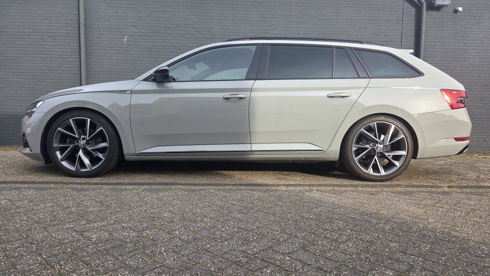

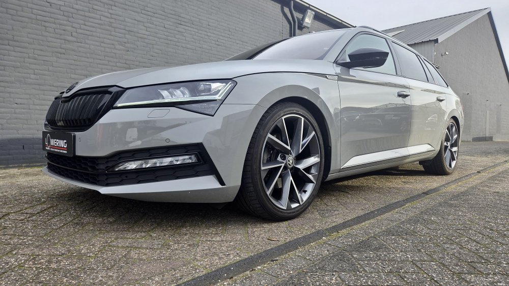

  • Many Superb owners here in Oz have made the switch from 235/40/19 to 245/40/19 with no issues, even with lowering springs. It's cheaper n a more popular size. I'll b making the switch too fr

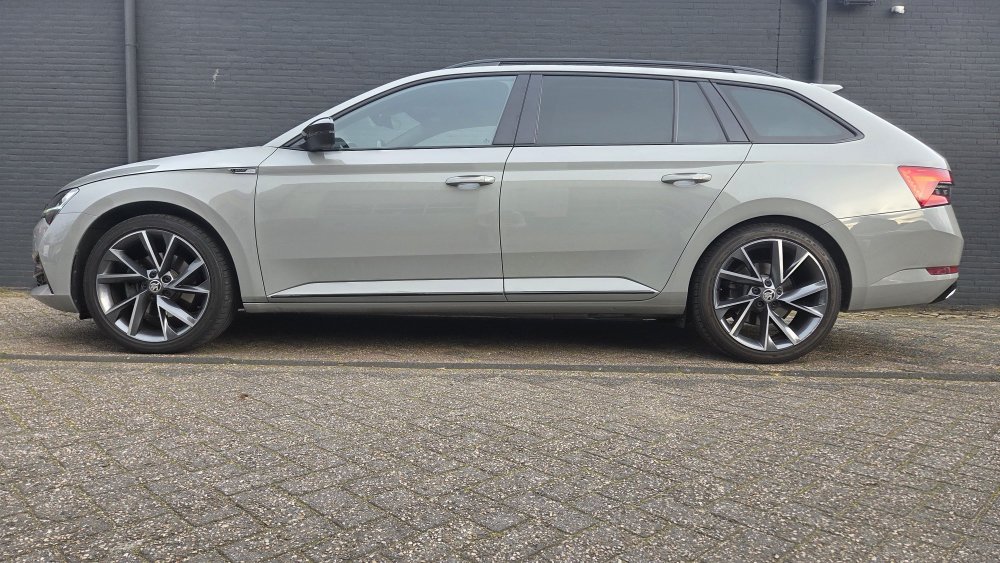

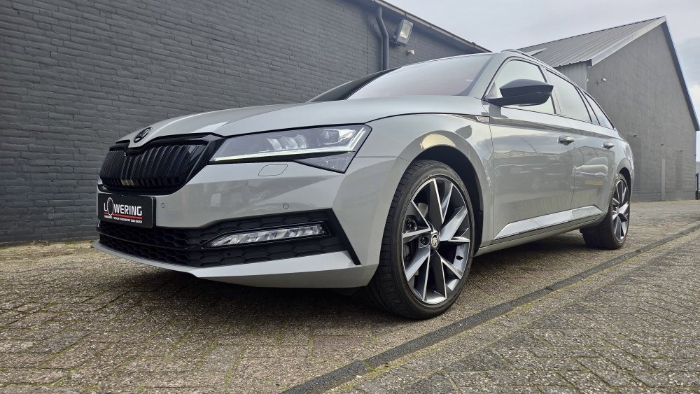

  • Now new set is in place. Size is 245/40R19. ET35.   Car needs wash&wax.
  • 245/45R18 on standard 8Jx18 ET44 rims is a good choice for looks and comfort. 245/45R18 is a more popular and economical size than 245/40R19. 245/45 on 8J rims better protect the rims from kerbing dam

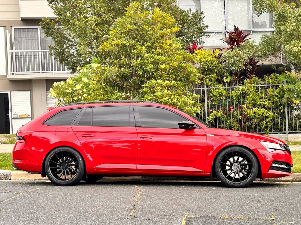

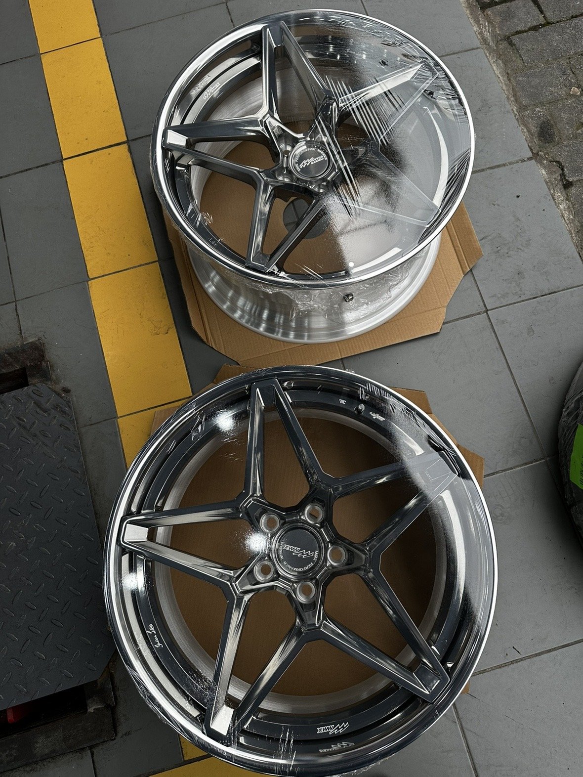

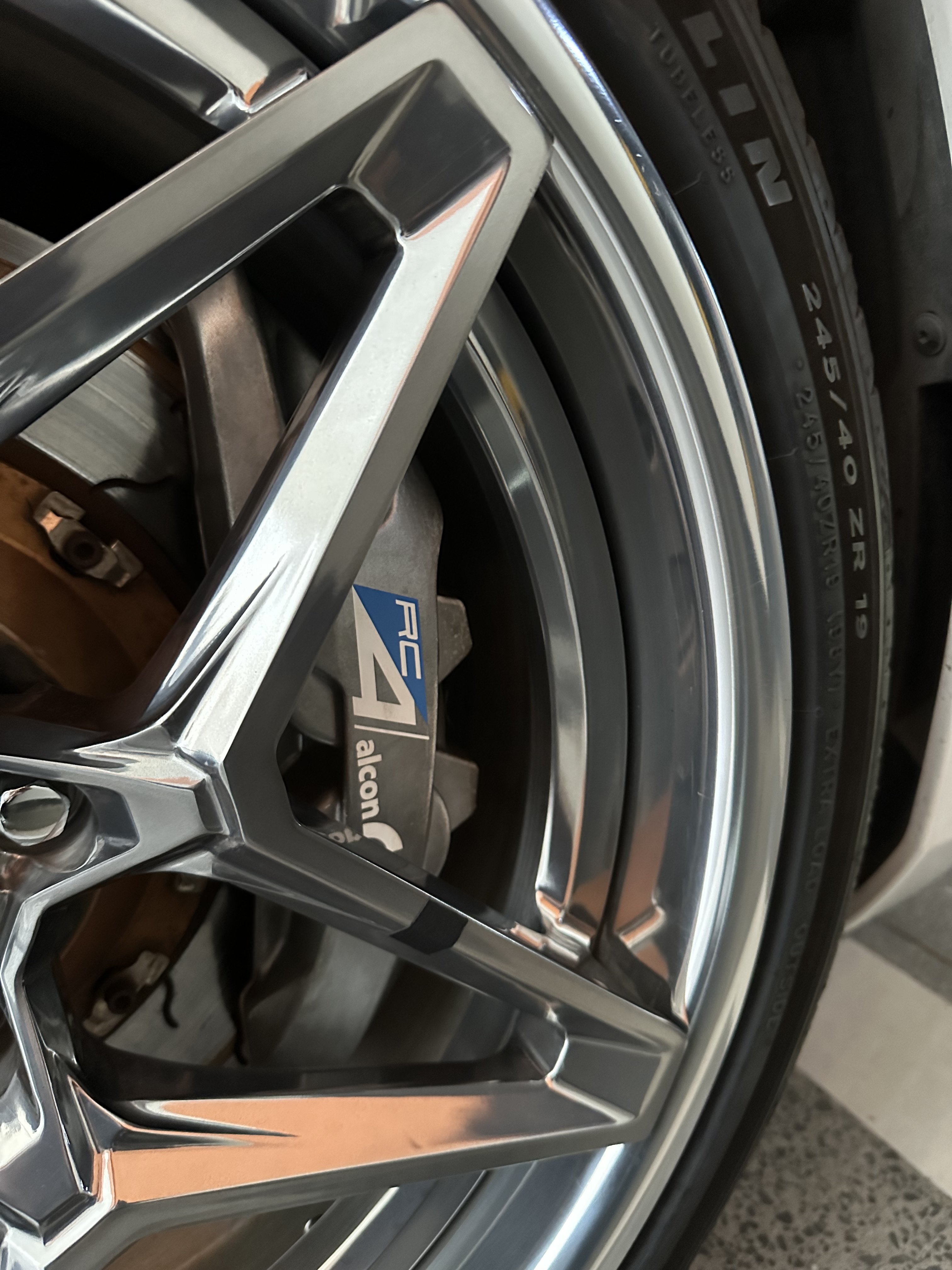

245 40/R19, ET35*9.5J, this is my current data, it is almost flush with the body, it feels pretty good.
those rims look nice 😍

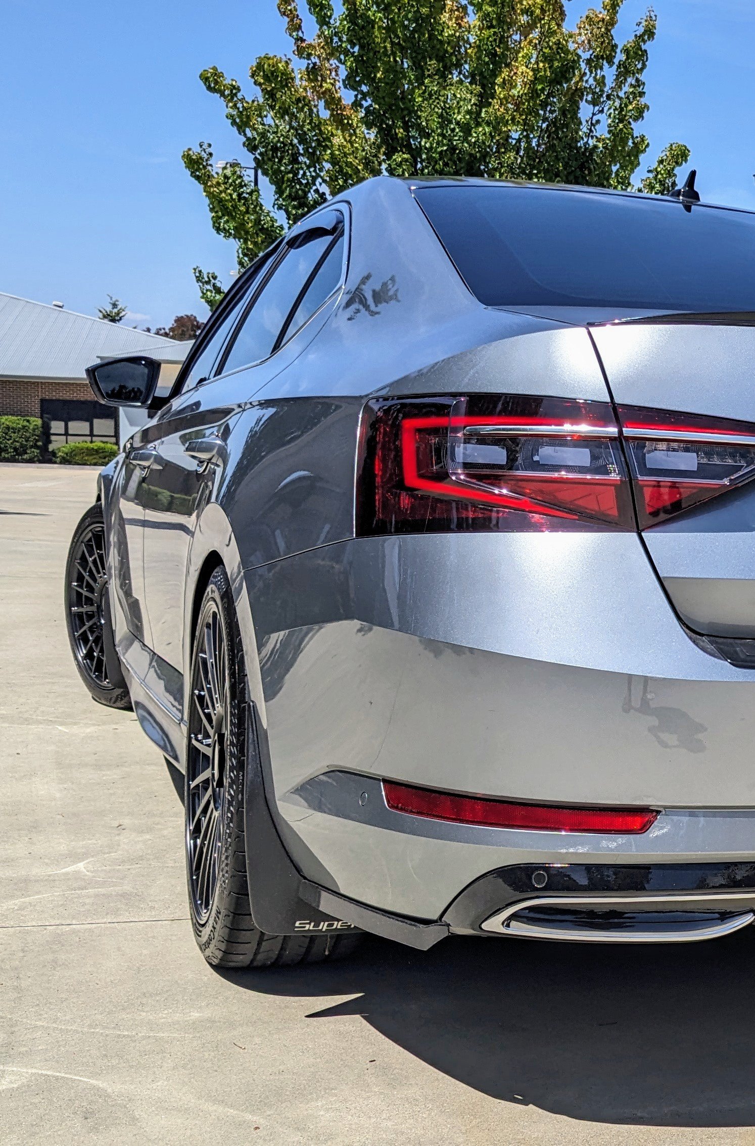

i'm also running 245/40R19 tyres, on Rotiform 19x8.5 ET35.  sits nicely with the body too 🙂
Can you show us how they look on your car?

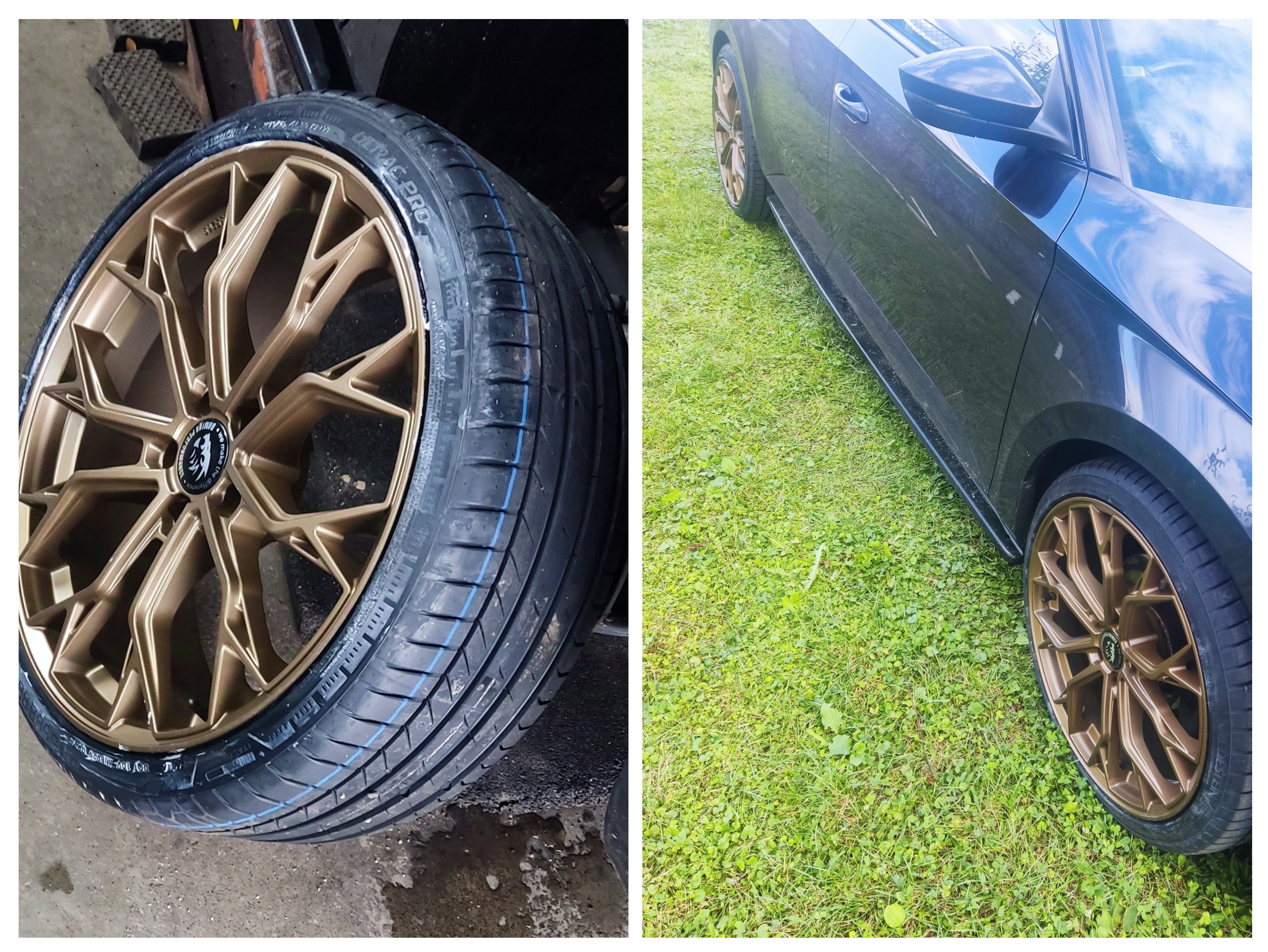

Hi all.
I have these 8,5x20 5x112 ET30 Bronze with 235/35/20 tyres on them (on a picture) They are nice, I really like them but I think I'd like to go bigger so I would like to ask you guys who obviously know more if there is any chance for me to fit 9x21 5x120 ET30 allloys with 245/35 R21 tyres on them?
These would go wider from 8.5 to 9, tyres from 235 to 245, same ET30 and obviously an ich bigger wheels with the same tyre profile of 35. Is that possible on prre-facelift MK3?
As you can see in the chart below, the 245/35R21 tyre size has an outside diameter between 5.1% and 6.1% bigger than the standard tyre sizes.
If you want a 9" rim width, perhaps look at something like 255/30R21 fitted to a 9Jx21 ET42...although that might rub on the inside. Fitting this tyre size to a narrower 8.5Jx21 ET40 rim would free up an extra 5mm on the inside reducing the chance of rubbing on the inside. You get an extra 2mm on inside clearance because of the different offset, ie. ET40 instead of ET42...and an extra 3mm of inside clearance because of the 0.5" narrower rim, which squeezes the sidewalls together more.
Note that there's always a risk of rubbing or the tyre sticking too far out when you start pushing the limits, and it's possible that even a 255/30R21 fitted to a 8.5Jx21 ET40 rim could rub or stick out from the wheelarch.

This is exactly the setup I went with on my new rims.  Still could have gone a little more aggressive, around the ET35-ET33 mark, but as I tow a jetski I didn't want rubbing issues (I'm on Eibachs) on the rears so stuck with the above.  I might look at putting some 5mm spacers on the fronts.
Sorry, could you please tell me exactly which wheels you have fitted in the photo and the exact size? Thank you!
