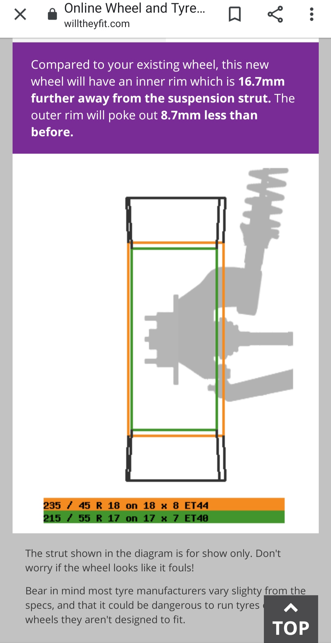

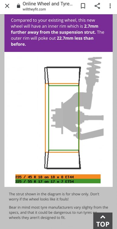

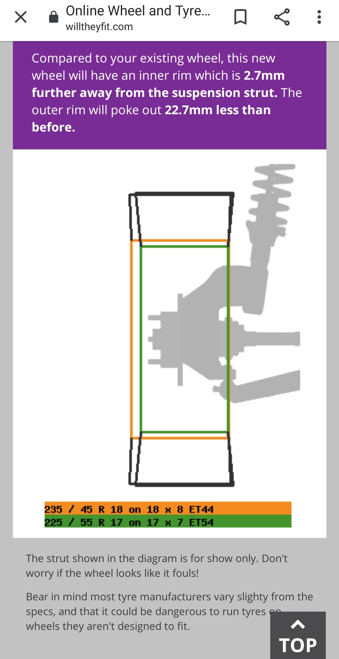

So looking at the website willtheyfit it shows that with ET54 its still showing  within the profile of  the existing size wheel. A narrower tyre will always mean that it is more inbound that before.
I can see that with an ET40 wheel it will be closer to the existing outside profile, just further away from the suspension etc.
Guess that it will fit, but wont be best suited to the car, and may cause issues?
I'll keep looking for some different wheels.
