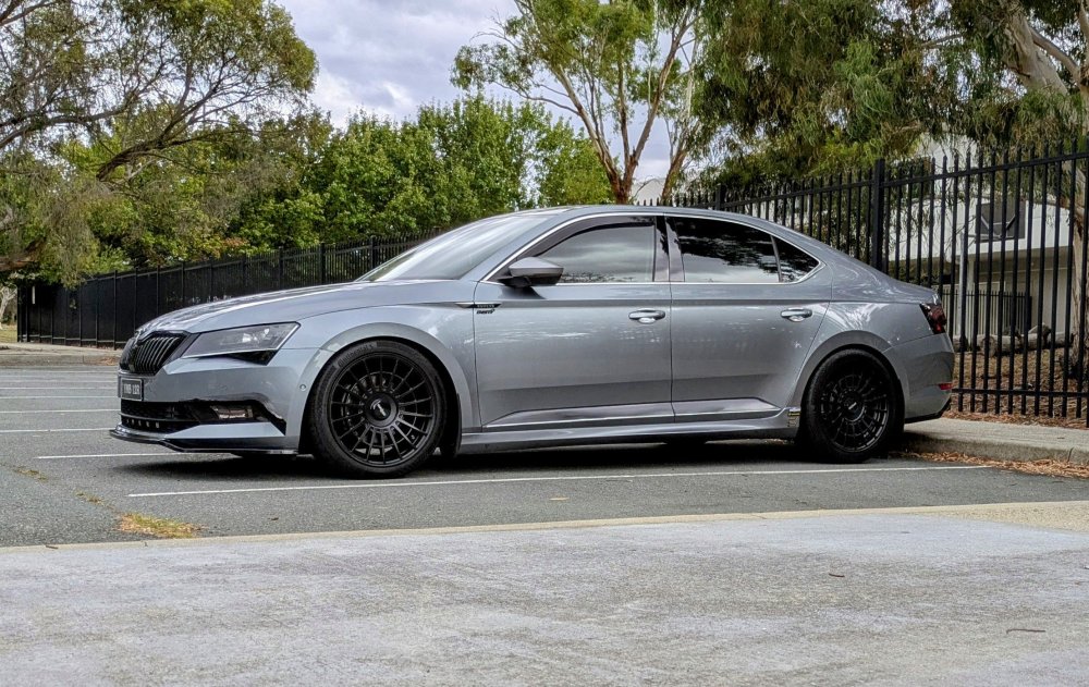

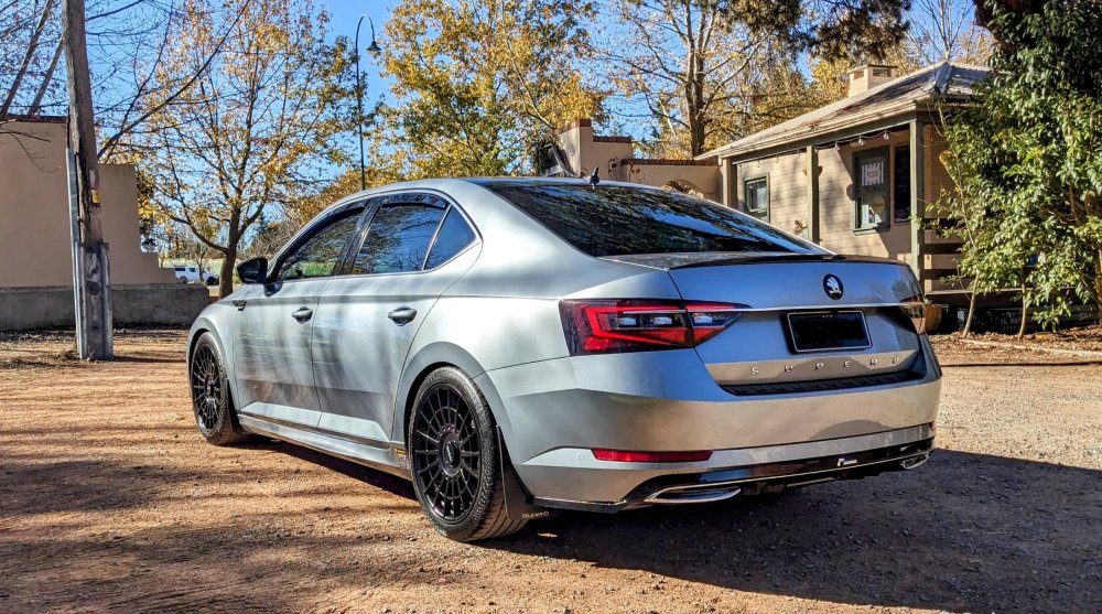

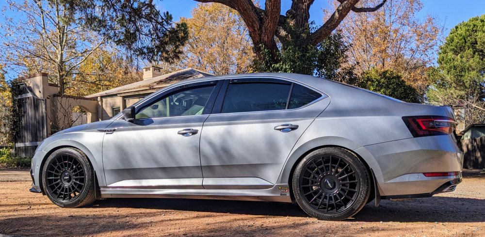

I'm running 245/40r19 tyres on 19x8.5 ET35 rims.
Lowered 25mm on Eibach Pro-kit springs, factory DCC shocks.
No issues at all.

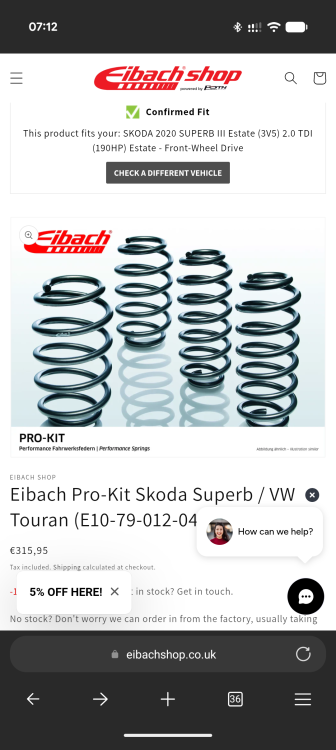

Why do you think I have a slightly different part number?
Estate / DCC / FWD 2.0 190BHP
E10-79-012-04-22 is for the AWD Wagon/Estate
E10-79-012-02-22 is the correct ones for FWD Wagon/Estate.

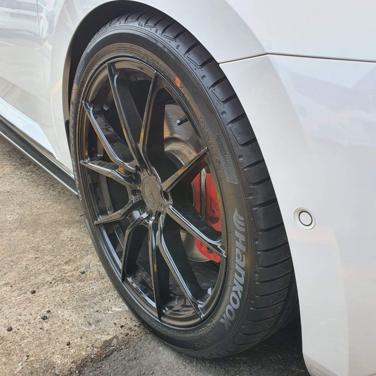

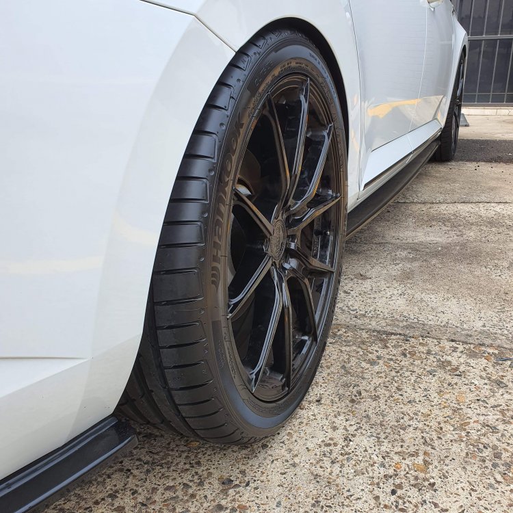

On 11/03/2020 at 12:53, JR RS said:
Many Superb owners here in Oz have made the switch from 235/40/19 to 245/40/19 with no issues, even with lowering springs.
It's cheaper n a more popular size.
I'll b making the switch too from 235 to 245 once my factory P7s r end of life.
With regards to 20" rims, u can do 255/30/20 on the 280 Superb.
But comfort will b severely compromised.
https://www.wheel-size.com/size/skoda/superb/2018/#trim-20tsi-280-eudm-276

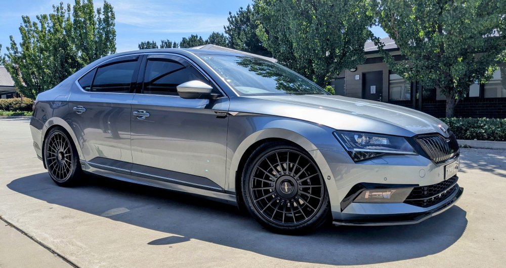

Some pics below of a mate's car with 245/40/19 and lowered springs.

I used this place to find the recommended.
I also noticed E10-79-012-03 version. I wonder what the difference is?

I myself have 19x8.5 ET35 rims with 245/40r19 tyres.

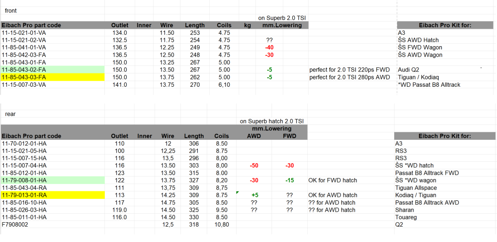

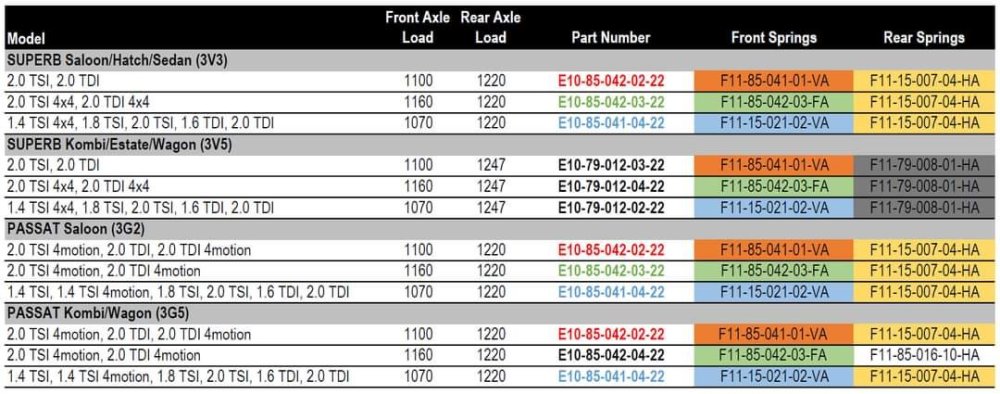

79-012-03-22 has a higher front axle load weight than the 79-012-02-022.
1100 vs 1070.
That would indicate 03-22 is for the heavier DSG variants.
1100 vs 1070.
Thanks, are you sure that chart is correct?
There appears to be a part number difference between Saloon and Combi even though there are the same part numbers on the individual springs?
In Saloon the 02 is for FWD, 03 for 4x4, 04 for DSG ?
On the Combi 03 is FWD, 04 is 4x4, 02 is DSG.
Assuming DSG is the last line
Is the DSG box that much heavier?
yes, the chart is correct. u should have a closer look.
saloon (3v3) and estate (3v5) share the same front springs. because saloon and estate front end is same same, just different variations based on engine and transmission type.
saloon and estate have different rear springs. because wagons r heavier. nothing to do with engine or transmission type.
hence, the overall part number will b different between saloon and estate, because the rear springs r different.
Edited by JR RS
