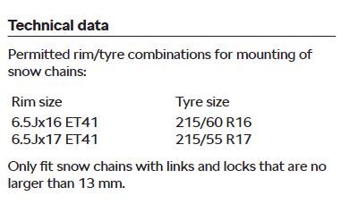

Skoda doesn't approve any rims bigger than 17" for the fitment of snow chains to the Superb MK3. Skoda only approves 6.5Jx16 ET41 with 215/60R16 and 6.5Jx17 ET41 with 215/55R17 for the fitment of snow chains. The details are in the owner's manual.
Therefore, if a 280PS needed rims bigger than 17" to clear the front brake calipers, no one with that car could go on a skiing holiday to the Alps...as I've heard snow chains are compulsory to get to the slopes.
The Superb MK3 can be fitted with 16" rims on all models except the 272HP/280HP 4x4 models, which need at least 17".
Also, if I remeber correctly you are not required to use snow chains if you have winter tyres. I may be wrong on this one thou.
I do not mind 6.5J on winter tyres , as there will be more rubber to protect rims. Summer wheels are 7.0Jx17 ET40, so 1mm offset per side is nothing.
Only frustrating thing is that Skoda does not mention anywhere in their User's Manual what wheel size I can use with 206kW and I have to seek help on such a "silly" thing on the forum.

Snow chains aren't an alternative to winter tyres, they are in addition. In many European countries it's compulsory to fit winter rated tyres in the winter. If there was a road sign in the Alps saying that snow chains were compulsory along that section of road, saying to a policeman that you were exempt because you had winter tyres on would not cut the mustard.
Your Skoda approved tyre and rim sizes will be on the CoC (Certificate of Conformity), not in the owner's manual. The Skoda approved tyre sizes might also be on the inside of the fuel filler flap.

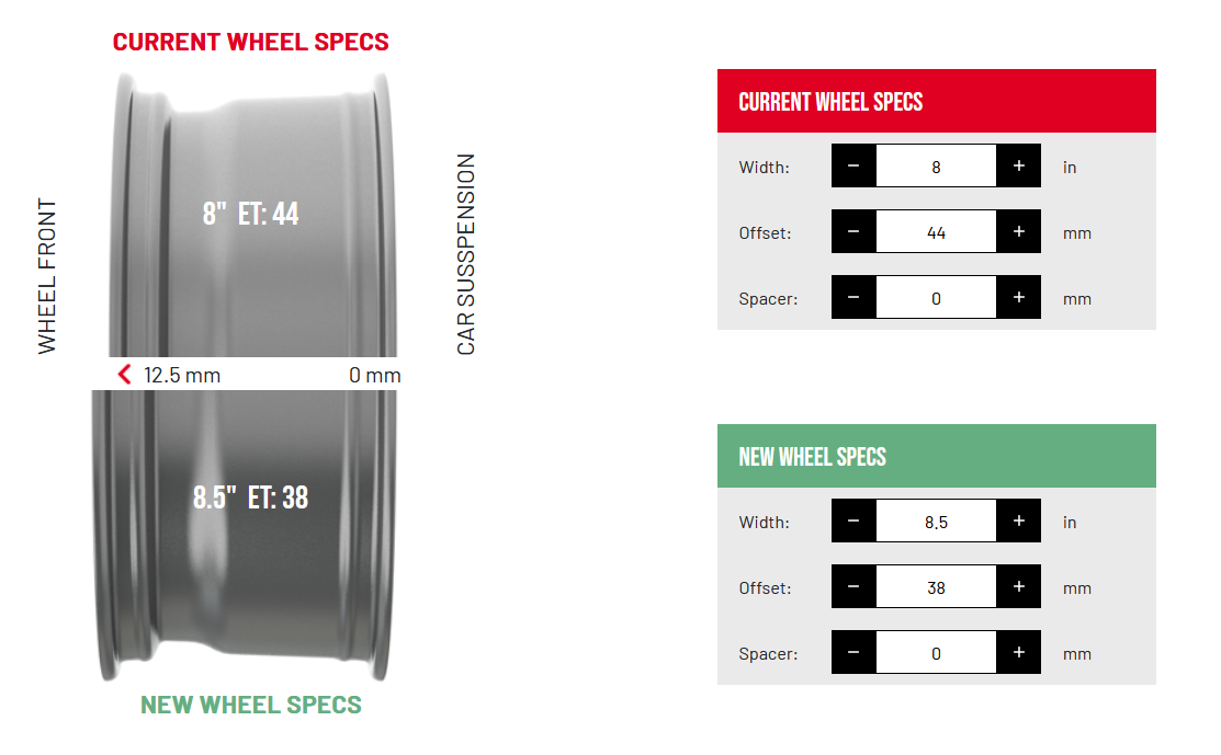

What are validated ET values for 8.5J x 19 rims? According to the calculator if I would want to keep the same distance from the suspension as with 8J x 19 ET44, the recommended ET for 8.5Jx19 would be ET38. How much lower ET values can I go without sacrificing anything and being inside law restrictions?
This is exactly the setup I went with on my new rims.  Still could have gone a little more aggressive, around the ET35-ET33 mark, but as I tow a jetski I didn't want rubbing issues (I'm on Eibachs) on the rears so stuck with the above.  I might look at putting some 5mm spacers on the fronts.
