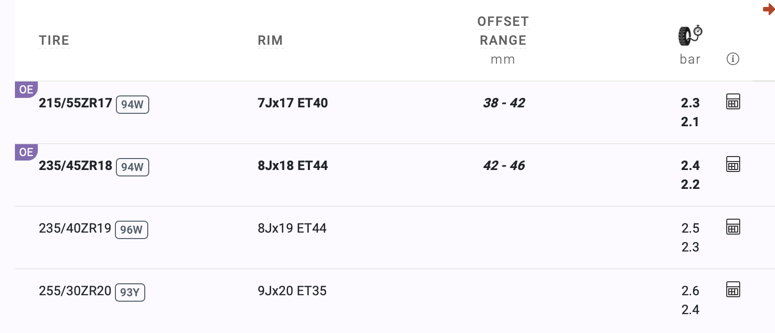

A bit too large, I suspect.   This is the list of OEM sizes for your car.   I suggest going here and comparing your existing wheel and tyre setup with any new ones.   https://www.willtheyfit.com/

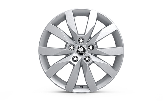

Anyone knows can I fit Octavia mk3 rims 6J x 17 et48 on my superb mk3 2.0tdi? I have tyres 215/55/17 which are 6,5J but my concern is on ET cause on superb its 40, and this Octavia rims are 48. Cheers.

On the Superb MK3, the 215/55R17 tyre size is usually fitted to either 6.5Jx17 ET41 or 7Jx17 ET40.
So compared to 6.5Jx17 ET41, the 6Jx17 ET48 rim is 0.5" narrower and the offset if 7mm greater.
This could be useful if you drive in an area with lots of 2 metre width restrictions because the front and rear track if measured on the outside of the rims is reduced by 26.7mm when changing from 6.5Jx17 ET41 to 6Jx17 ET48 rims or 41.4mm when changing from 7Jx17 ET40 rims to 6Jx17 ET48 rims. When changing from 8Jx18 ET44 or 8Jx19 ET44 rims to 6Jx17 ET48 the reduction in front and rear track if measured on the outside of the rims is even greater at 58.8mm.
With a wide car like the Superb MK3 on standard rims, it can be very easy to damage the alloy rims when going through these narrow width restrictions.
For even more ride comfort, also consider oversize 215/60R17 on these rims. The front wheel drive Karoq also fits its 215/60 tyres (albeit 16") to narrow 6J rims.
6Jx17 ET48 5/112 57.1 alloy rim CRYSTAL (from Octavia MK3)
Alu kolo Crystal 17" Octavia III
https://eshop.skoda-auto.cz/cs_CZ/alu-kolo-crystal-17-octavia-iii/p/5E0071496A+8Z8
Edited by Carlston

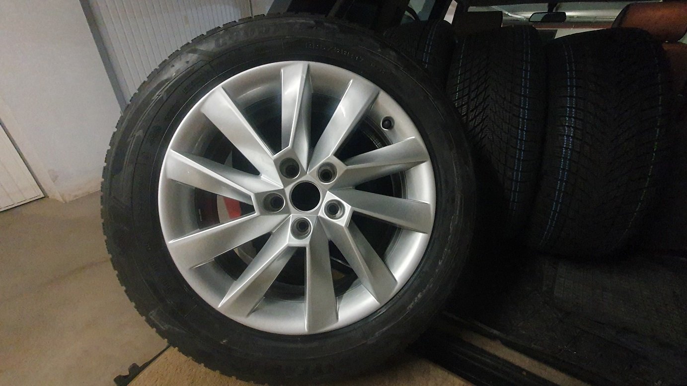

I got a good deal on a set of Goodyear UG Perf 3 on 225/55-17 and this is what I will use.
Hope to gather also relevant feeling about how the 280 performs with a 'downsized' from the summer 19s, which are at the end, so I will think what to do for next year, whether to downgrade to say 18s rims or to keep the 19s.
