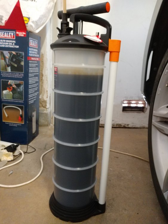

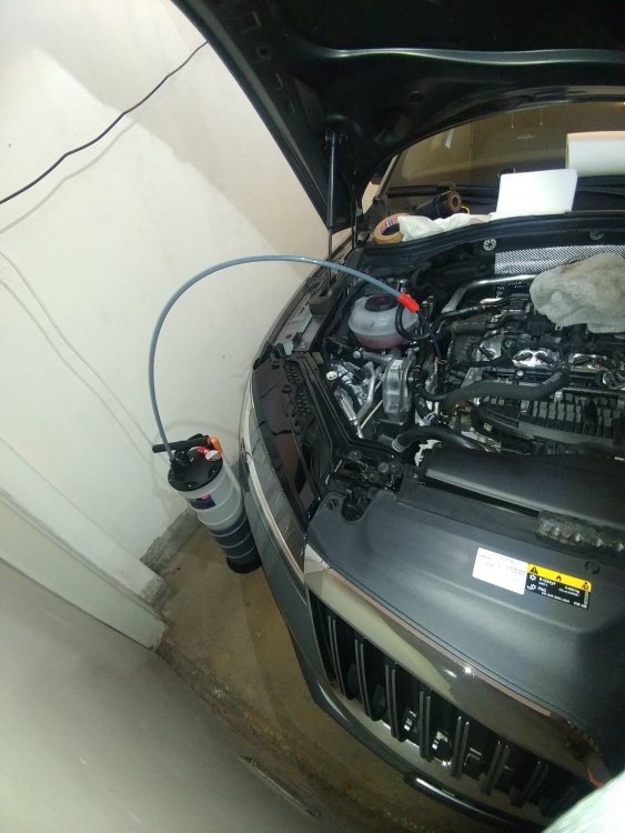

I own a Superb 2.0Tsi 190hp with engine DKZA (GPF) that have 5000km on the clock and the engine was filed from the factory with the 0w-20 50800 oil specification.
I just want to share something that it shocked me when I made my first oil change on my new Skoda superb facelift, the oil looked like it was driven 15000km! I remember that when I made the first oil change (5000km) on my last superb 1.8Tsi 2018 the oil was much much cleaner.
I suspect that the addition of GPF is the prime source of this problem, I wonder how the oil will look like after 30000km?!
I recommended to anyone that have GPF in his/her car to stay away from the QI6 flexible service.
I attach some pictures of the oil color.

Could you please explain why you think the GPF might be affecting oil degradation rate? It's early in the day, but I'm struggling to imagine a link.

The quality of the oil at the same mileage used to be far better on my Superb 3 EA888 prefacelift without GPF, I believe the major changes they made on the latest generation EA888 is to add a GPF and change to Budack combustion cycle, that's why I suspect the particulate filter.

I suppose the engine could be mapped for a less efficient, cooler burn in order to lower NOx output, knowing that the extra soot produced won't make it past the GPF. Seems like a horrible compromise though.

That does look quite dirty. I just had mine 2019 MY (220 hp) serviced at about 5000 km, and the oil was nowhere near that dark. More of a slightly dark golden color.

Oil colour does not reflect it's quality or its ability to lubricate though.

Agree. Only way to find out more is oil analysis.

Does that oil pump well? Looks very neat. If so do you have a link for it?
Maybe the additive package in that oil is so brilliant it has managed to keep all the dirt from your engine is suspense therefore actually doing a better job of getting the dirt out and not leaving it in your engine.

I know that the color doesn't mean that the oil is bad, but I was just comparing the oil color between the EA888 3b and EA888 gen3.
I thought about that too.
When I looked at some specialized engine oil forums I didn't find much info about the new 508 00. I will see if I can analyse the oil, I think there is a company in Germany that can do it for a reasonable price.
But still, I can't swallow that that color is normal at this early stage.
Yes it does pump well on the EA888 because of the flat oil sump but don't buy it if you have a diesel or a EA211 because it won't suck all the oil. I bought it from a UK website, I don't know if I am allowed to post links but you can search for Sealey tp69 I believe i bought it for GBP 53.

@joeyx Dirty oil may be due to the budack cycle or increased use of in head egr using extended valve overlap timing. At least it shows the detergent in the oil is doing its job in cleaning the engine and holding the carbon in suspension.
