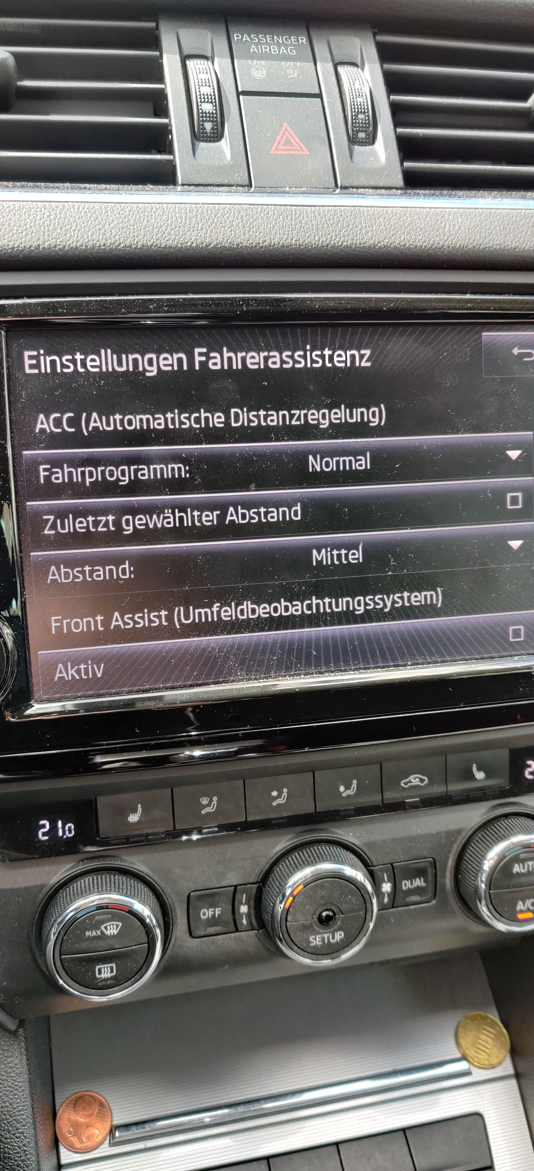

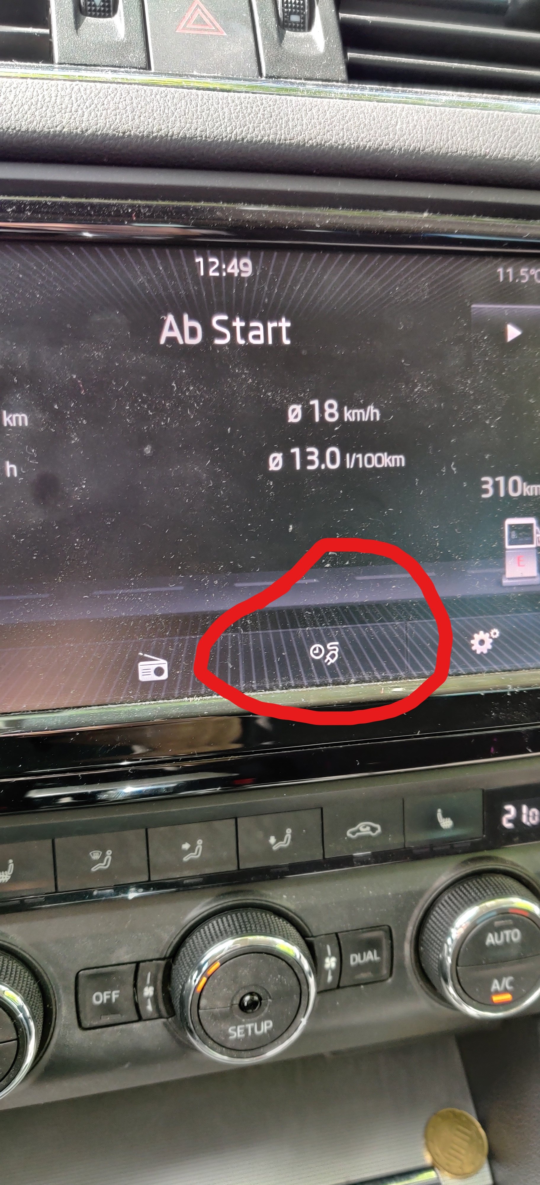

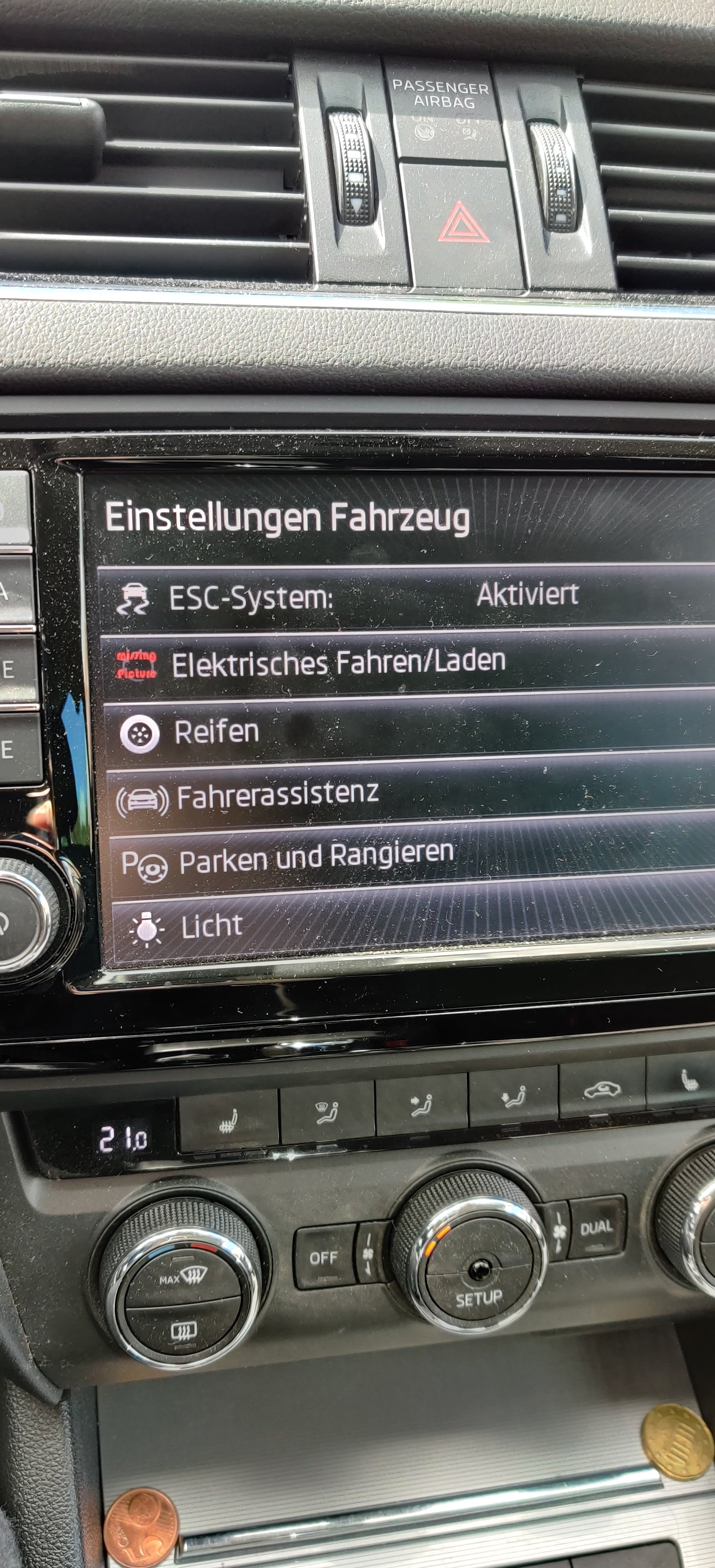

Hello,
after a Battery change my car thinks he is a fully equipped Hybrid car.
My car has only Lane Assist and the Canton System.
The main problem is that i don't have any Sound in my car and can't see any PDC information's (Because my car thinks i have a Camera)
I borrowed vcds from a friend but i'm not able to fix it.
The only Error report i got is in German i hope that is not a to big problem.
Informations about my Car
- Columbus MIB1 Radio
- Canton System
- Lane Assist
- Back PDC
- Octavia 3 150hp TDI from 2014

Can’t help with the hybrid stuff sadly without seeing another MIB1 Columbus scan to compare it to but check Byte 11 in 5F and check the long coding helper to make sure it’s set to sound system external for the CANTON. Can’t remember the hex value off the top of my head.
