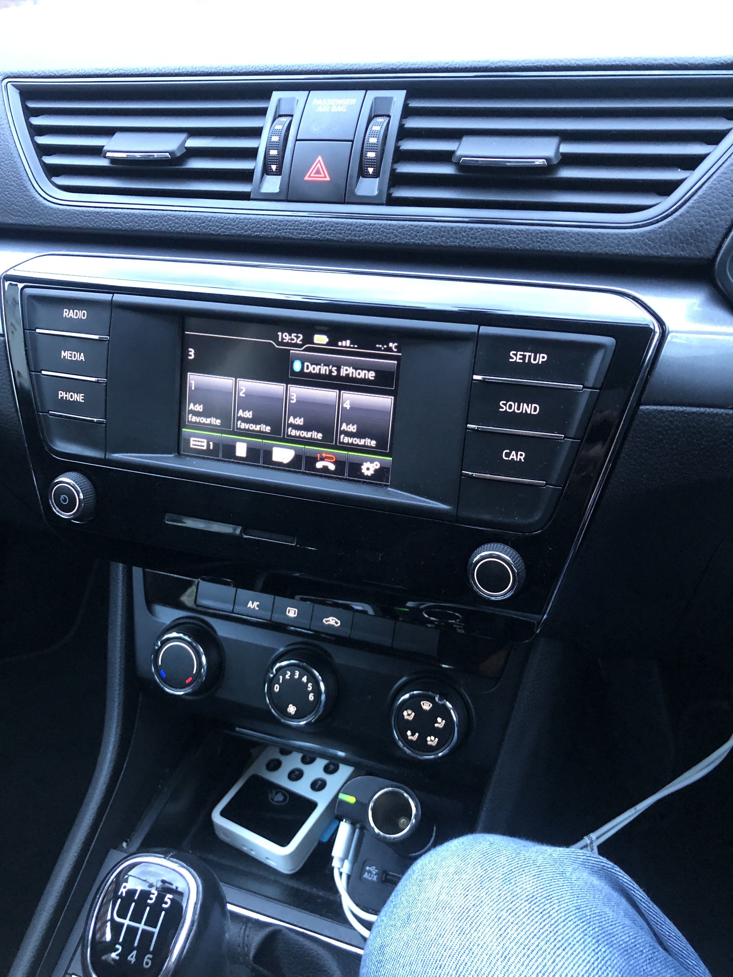

Can anyone please let me know where can I upgrade my display unit for my Skoda superb 2017. I’ve bought a bigger one of eBay but don’t know where can I get it replaced?
I don’t have a head unit in the glove box, head unit is attached at back of this screen.
many thanks
Sorry to say, I don't think there is an easy option to increase to screen size.
You're going to need a display, a headunit to fit in the glovebox, a wiring loom and possibly new trim etc...
Then it'll be coding, component protection and finally applying FEC's for the various functions :/
Thank you very much, I shall sell the new display I’ve just bought then. Many thanks for reply
