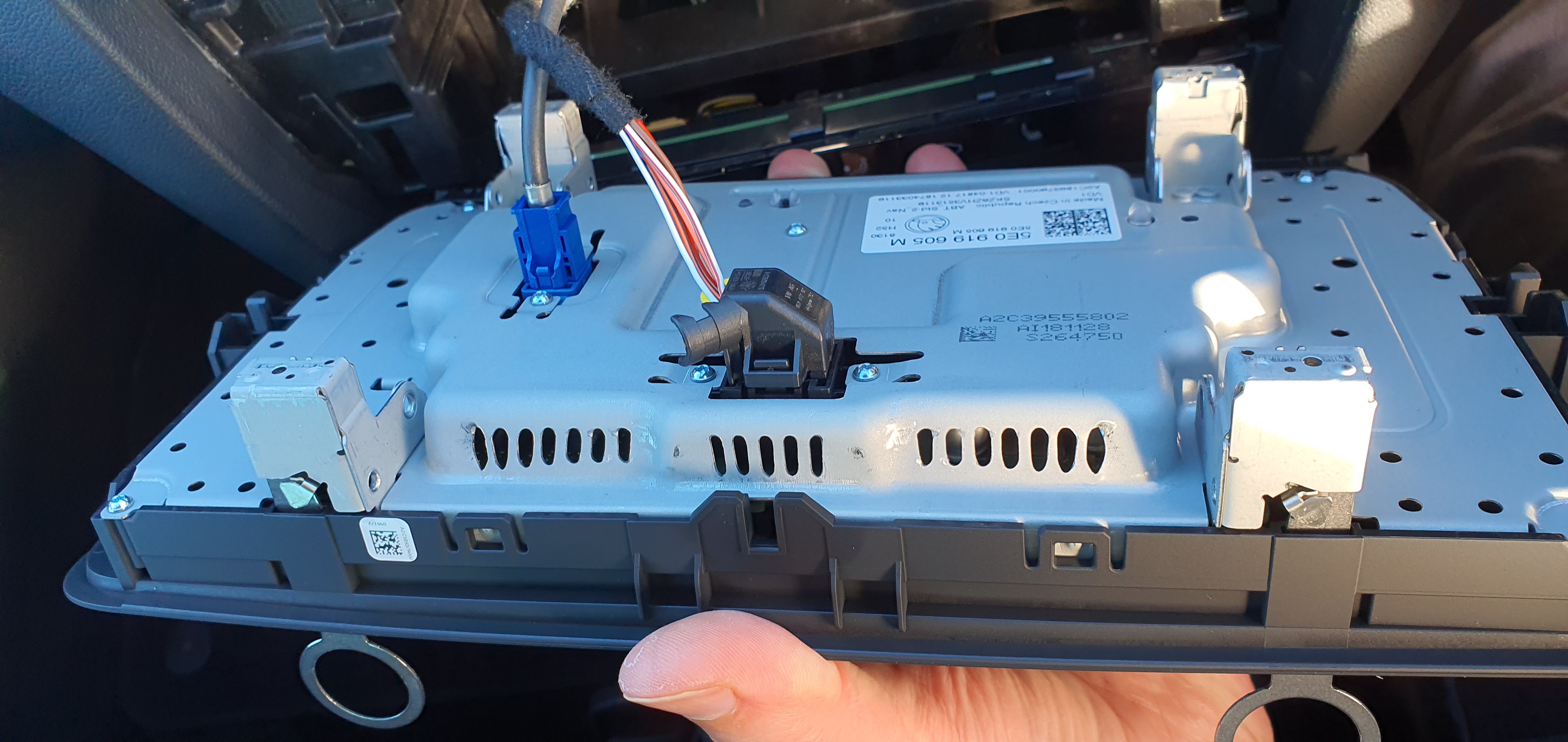

My radio removal keys say - top left and top right.  Put a top left in the top left slot and the next top left into the bottom left slots.  Put the top right into the top right and the next top right into the bottom right slot.  You want to push home until you hear a 'click'.  All 4 keys are engaged and connected in.  The screen should just pull out (pull straight directly towards you).  You will now be presented with two cables at the back of the screen.
To disengage the two connectors at the back of the screen, press the release tag on the black connector and push the release tag on the top of the blue connector.

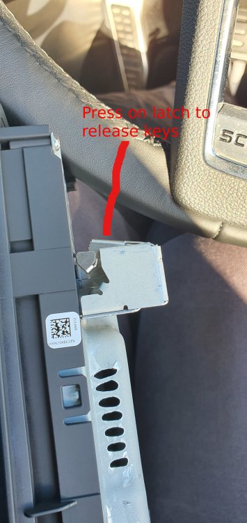

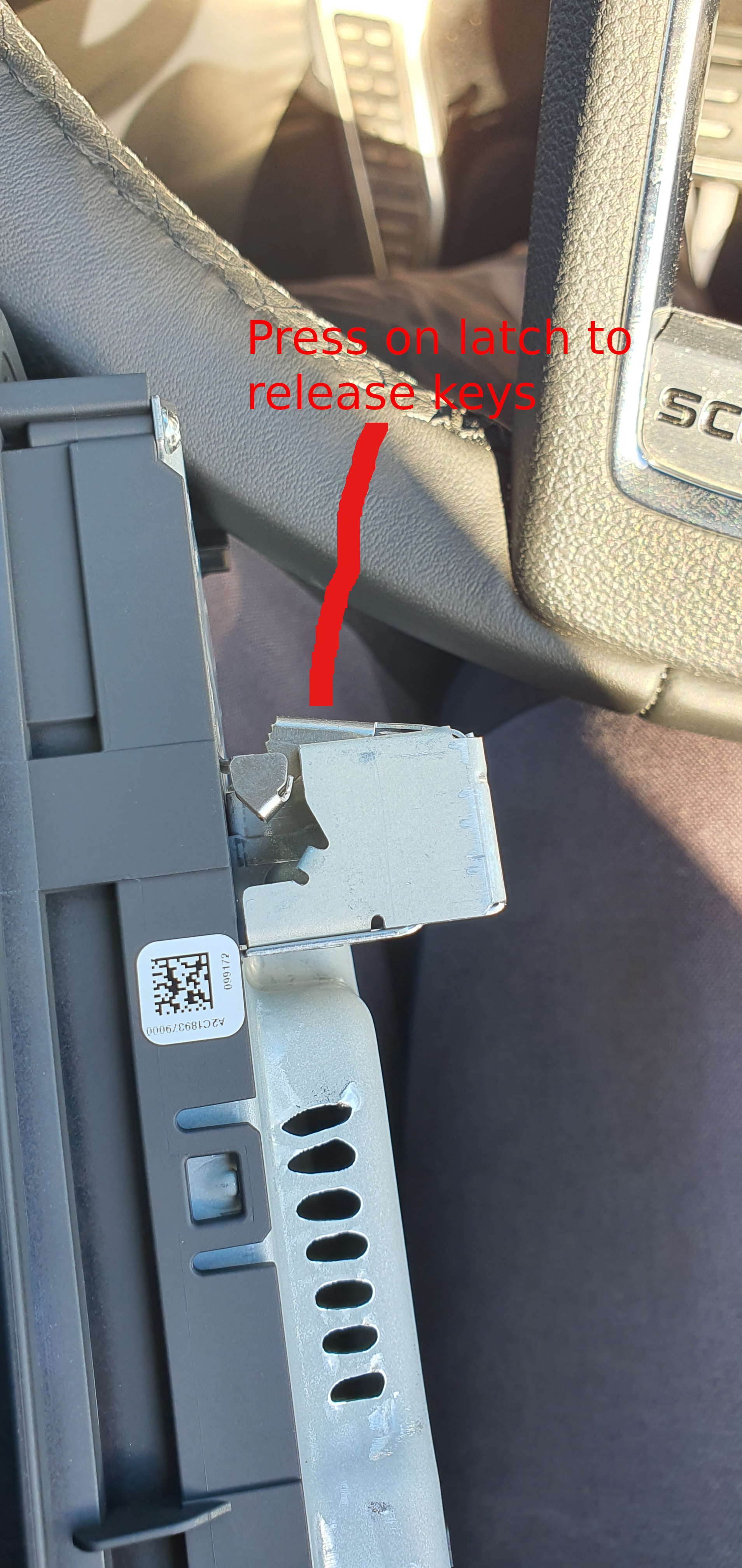

Carefully put this screen to one side.  To disenage the keys from the Screen, press and outer side of the locking mechanism.

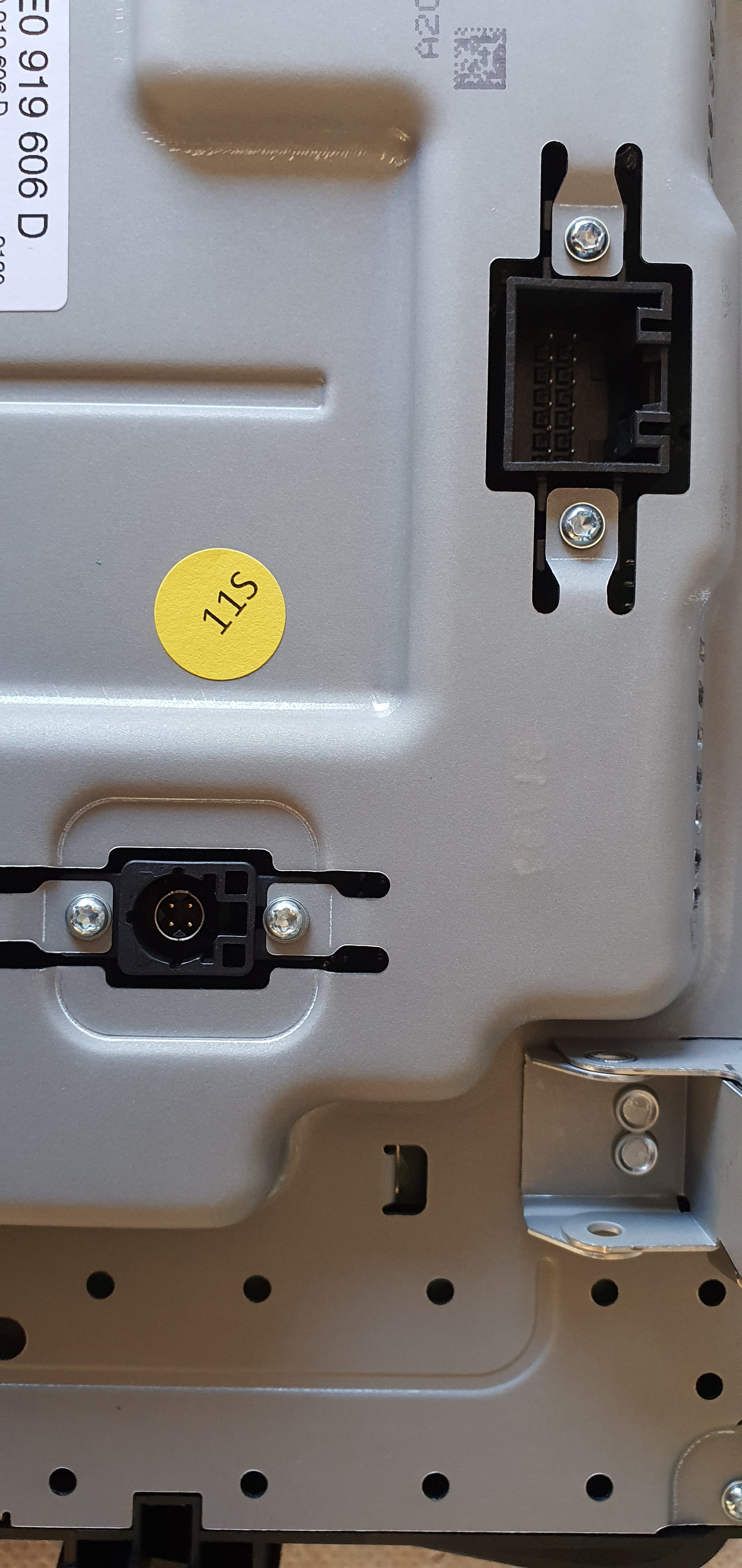

We need to do some minor modifications on one of  the connectors.  If you look at the back of the Columbus screen vs the Amunsden Screen, you will notice that the one connector is BLUE and the other is BLACK.
Columbus Screen
Amunsden Screen

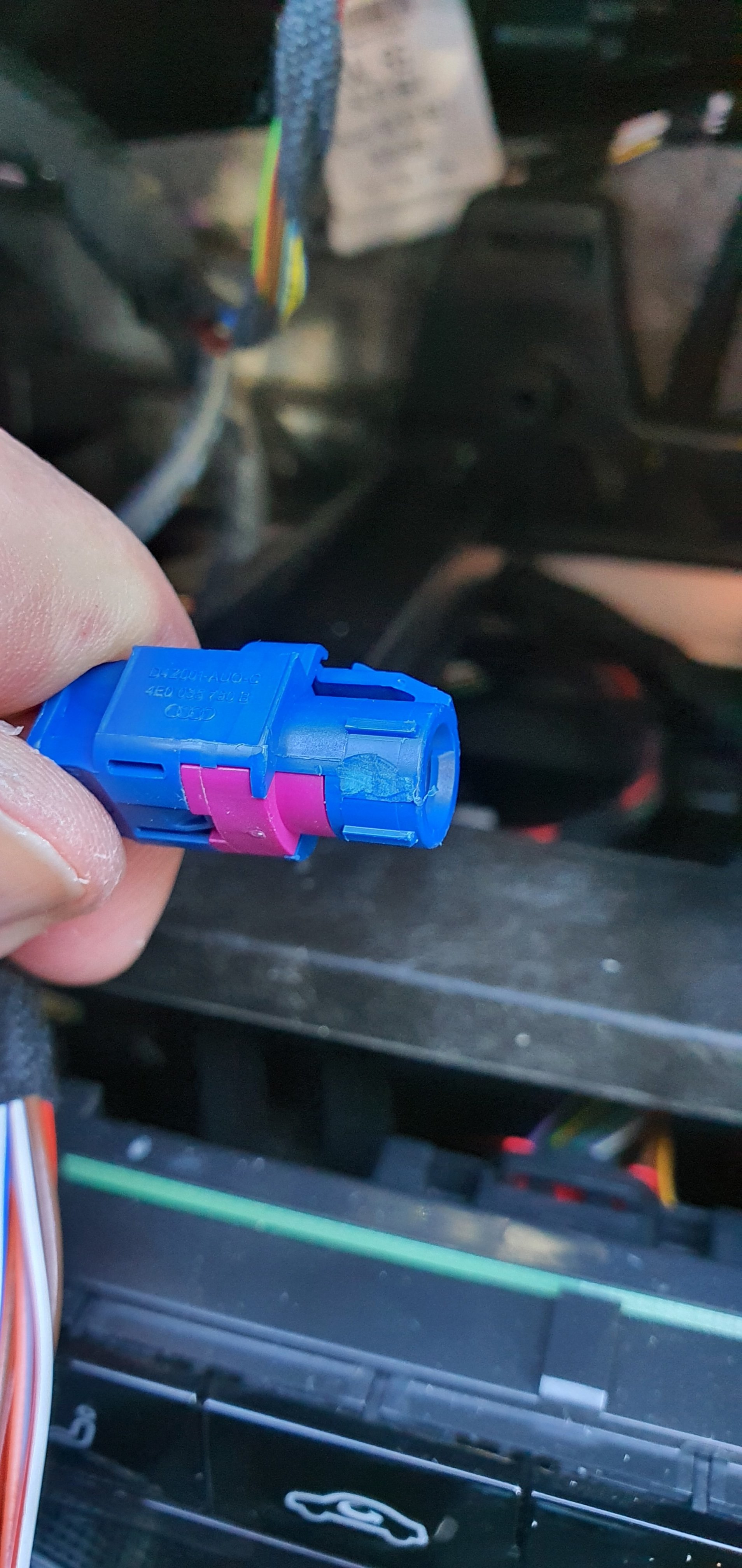

You will need to modify the connector slightly with your sharp penknife.  It involves one side tab of the Blue connector to make it fit.
This photo shows the blue connector post modification with my Swiss Army Knife.
Now the Blue Connector will fit into the black socket and the Black Multiway connector will also connect up as previously.

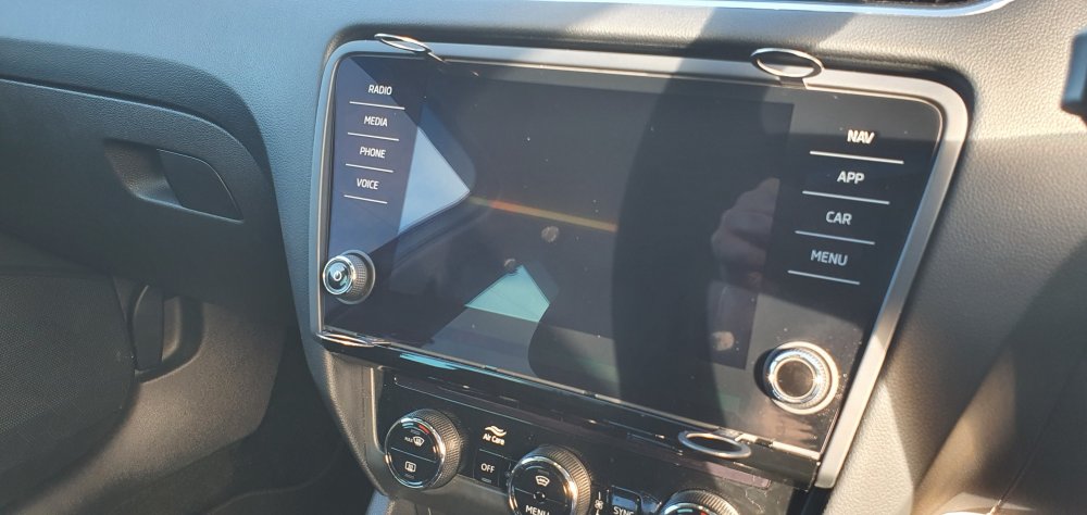

Insert the screen back into the slot - no keys are needed- it just clicks into place.

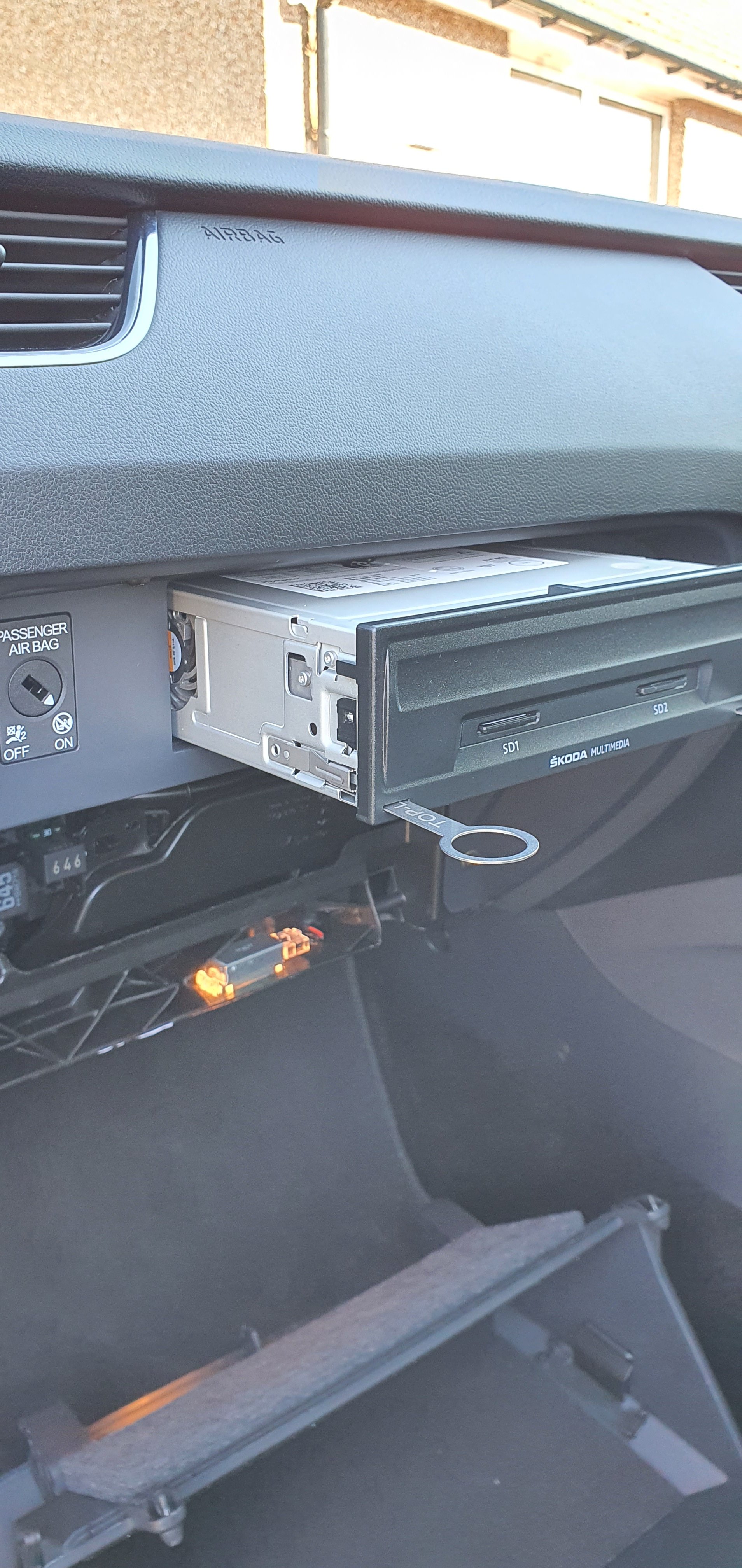

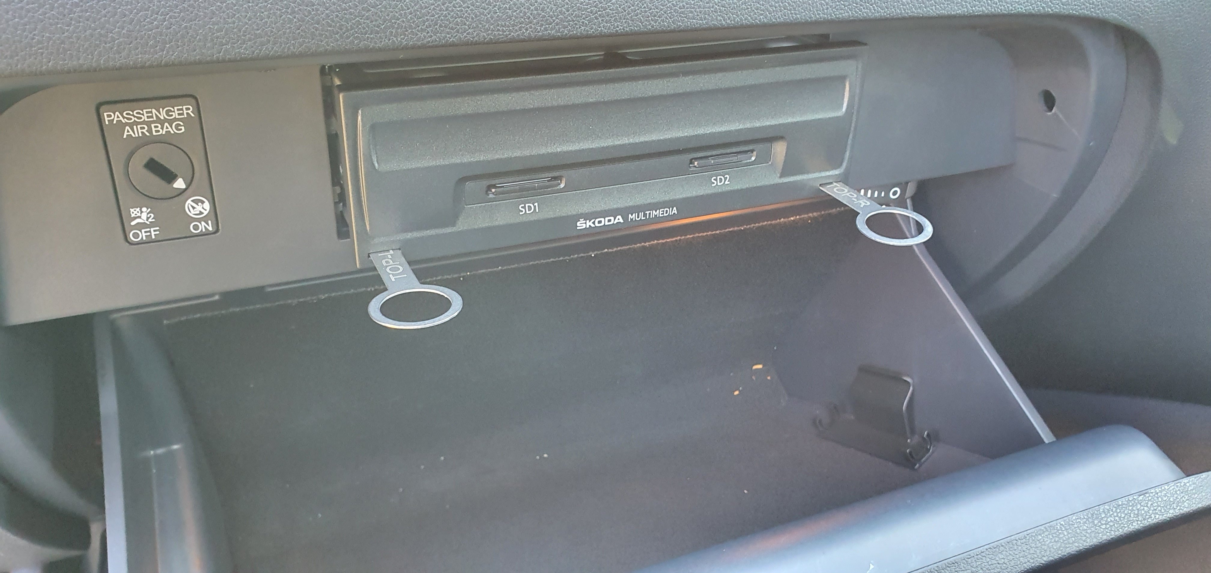

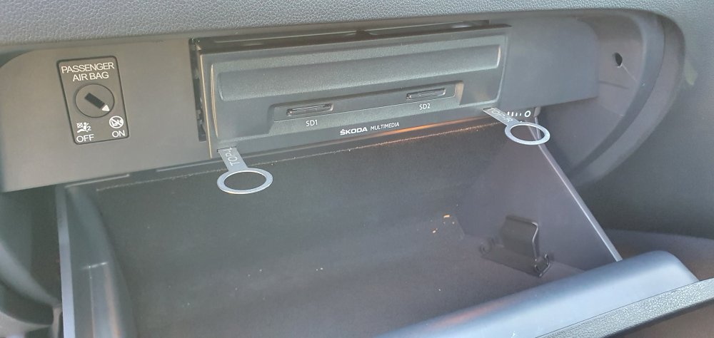

In the Glove Box, you will need to take out the Glove box completely.  This will become obvious soon, because you will need to gently release the MIB cable loom at; this cannot be done with the glove box installed.  An overview is unclip from the bottom, unclip the soft-touch lever arm on the left hand side and gently drop out the glove-box.  There are better instructions elsewhere on Briskoda or on Youtube.
You will need two radio removal keys for this at the bottom of the MIB system.
(ignore the fact that I hadn't removed the glovebox at this point - hasn't realised you needed access to the loom at the back of the MIB unit).

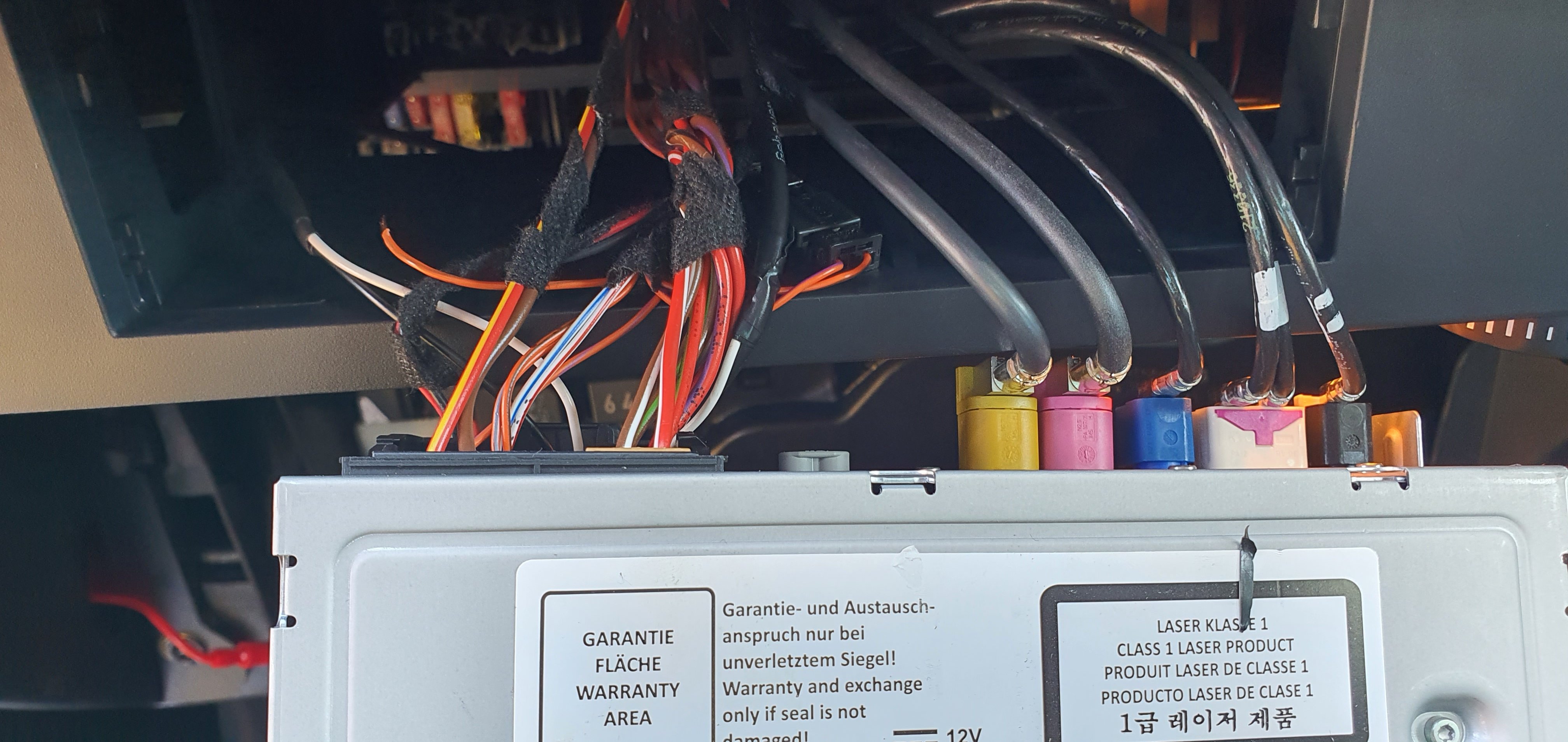

VERY VERY gently pull out the MIB unit.  You will need to get your head under the back of the glove-box area and you will realise that the cables are tightly bundled into the back of the dashboard.  Its feeling where the loom is and gently unbundling it and you pull out the MIB Amunsden system.

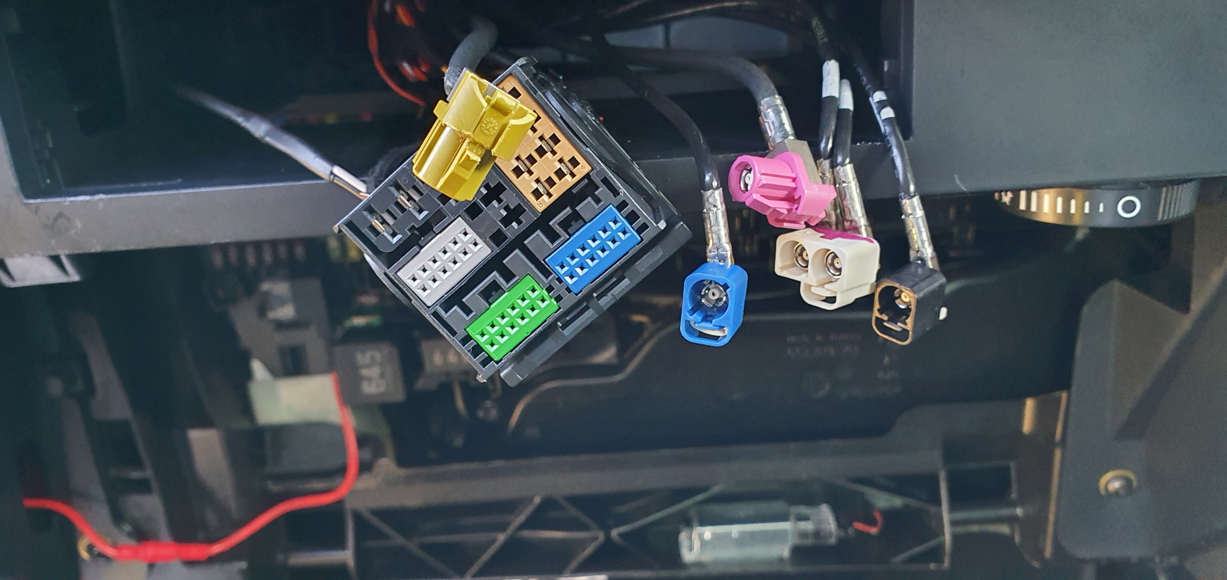

There are multiple connectors on the back of the Head unit;

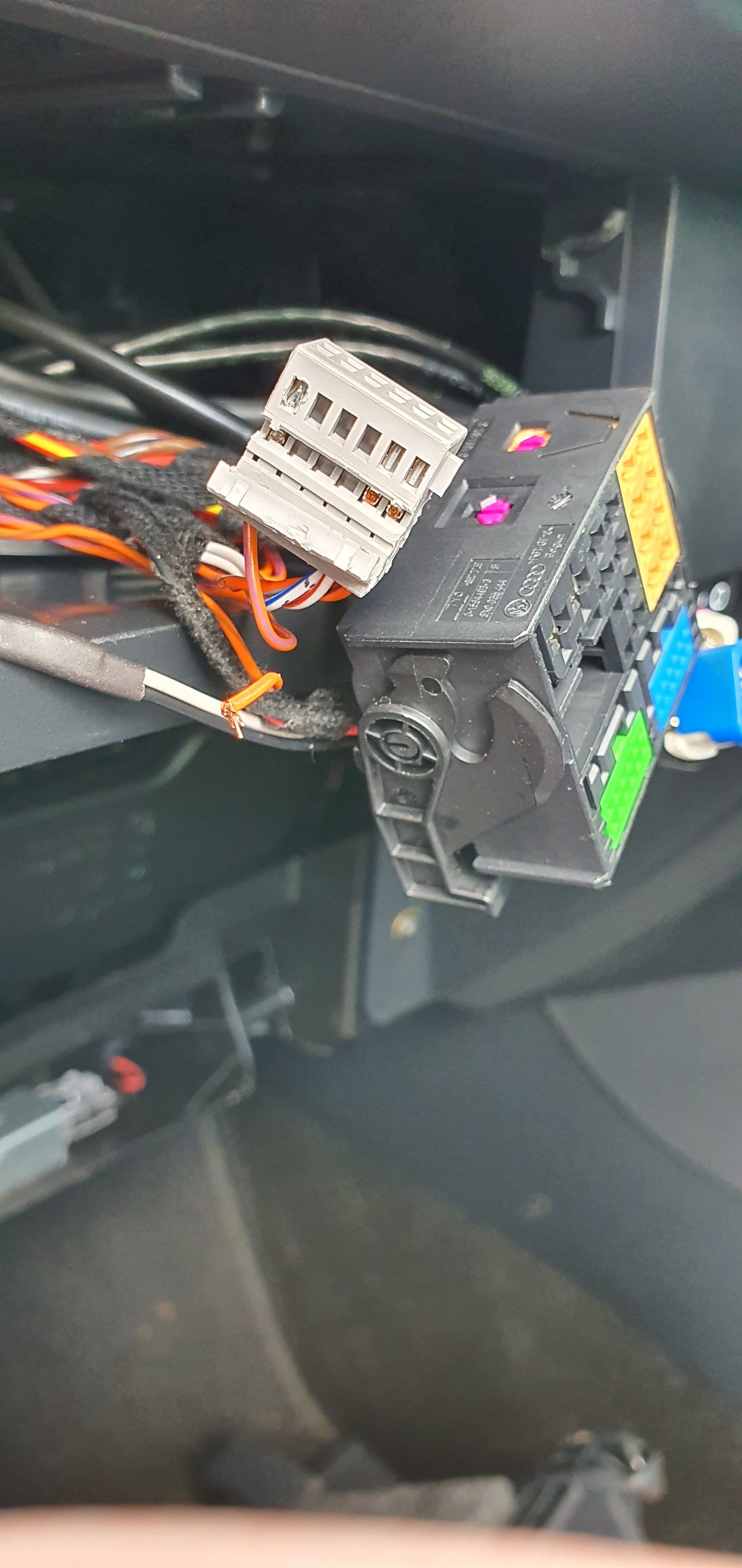

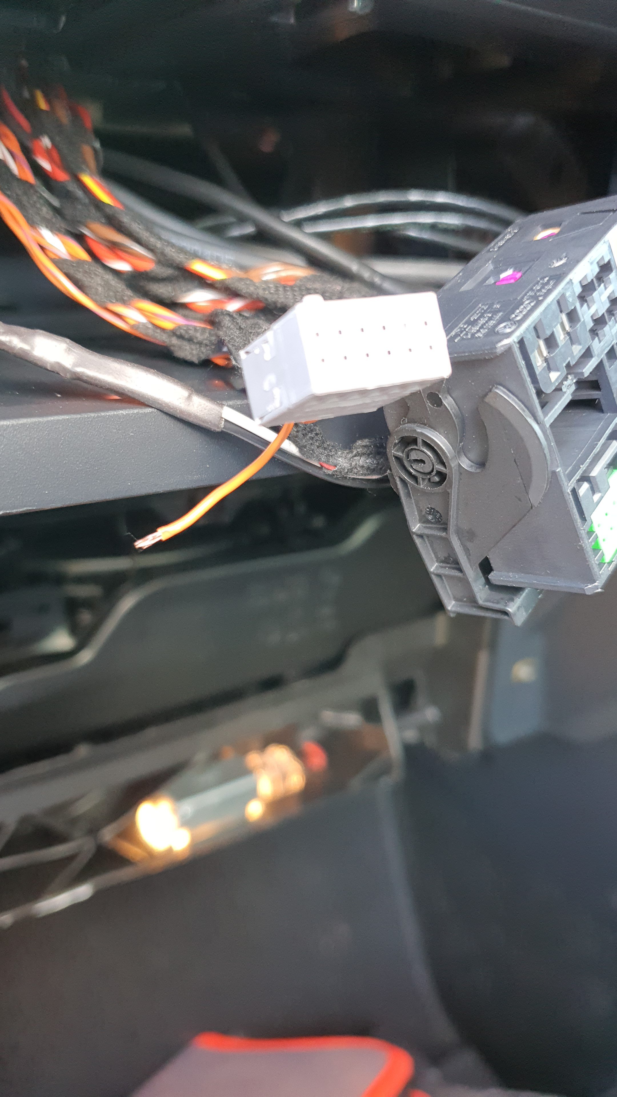

Some background here - the lovely Sasha had retrofitted a reversing camera into my car, so there were already modifications to the loom;  I gently removed the MIB headunit and discovered that I had broken a wire.

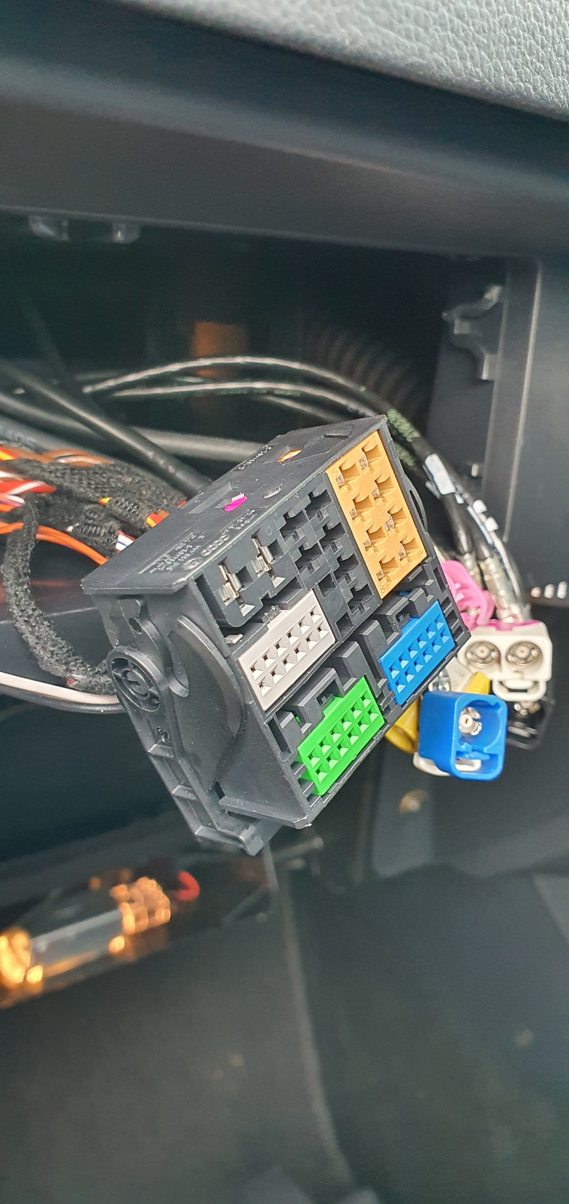

Did you spot the problem in the previous picture - have a look again on the left hand side and you will see an orange wire that is dangling loose.  I continued though - because I figured out I would have to try and fix it (which I did).  To remove the Black, White/Pink & Blue connectors, you need to pull the locking tabs out (my blue tab lock fell apart and went under the seat, but was easy to reinsert).  The Pink and Yellow connectors - finger nail  / Spugger time - gently tease them out until they come apart.  DO NOT BE FORCEFUL - patience required.  Finally, the big black DIN connector unlatches at the bottom of the connector.

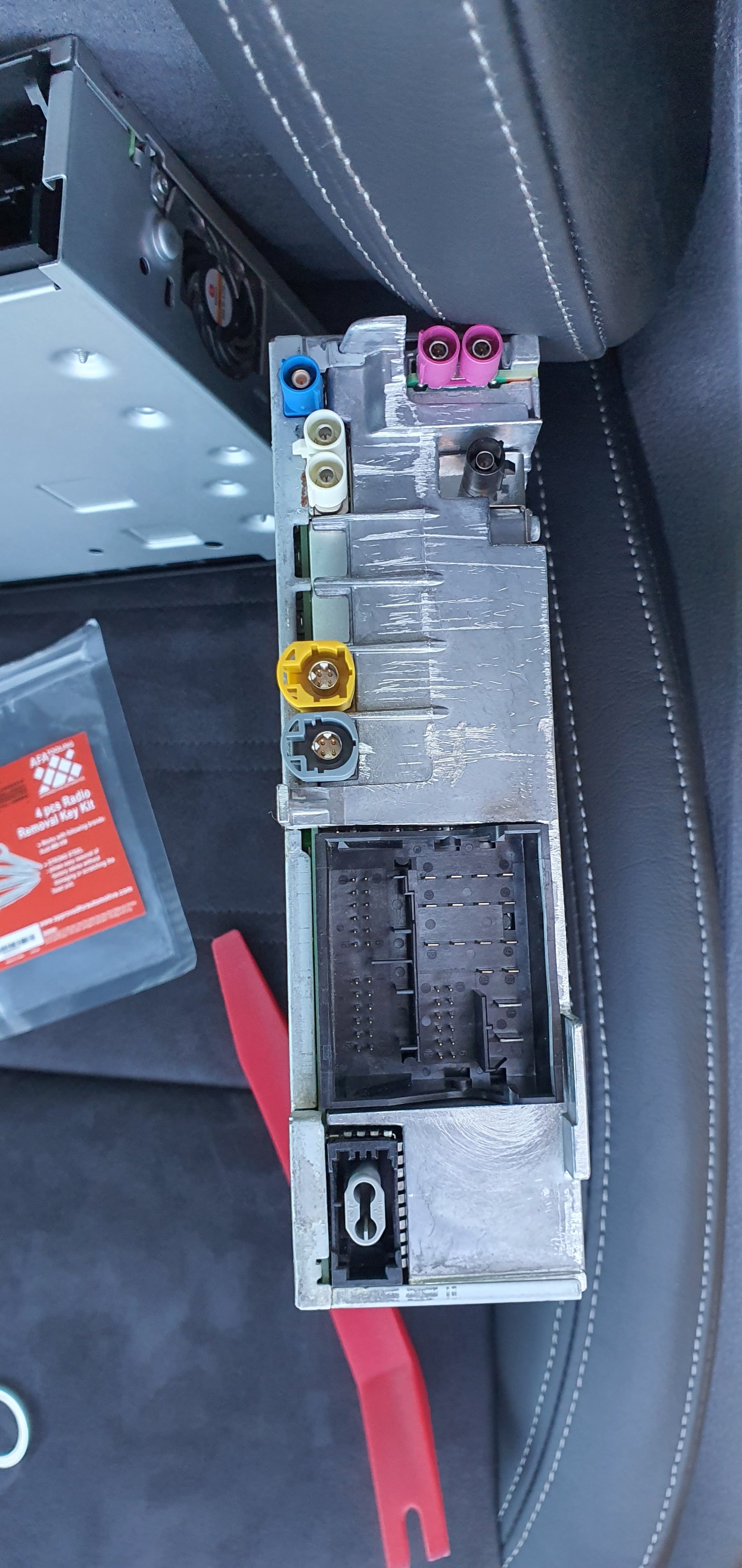

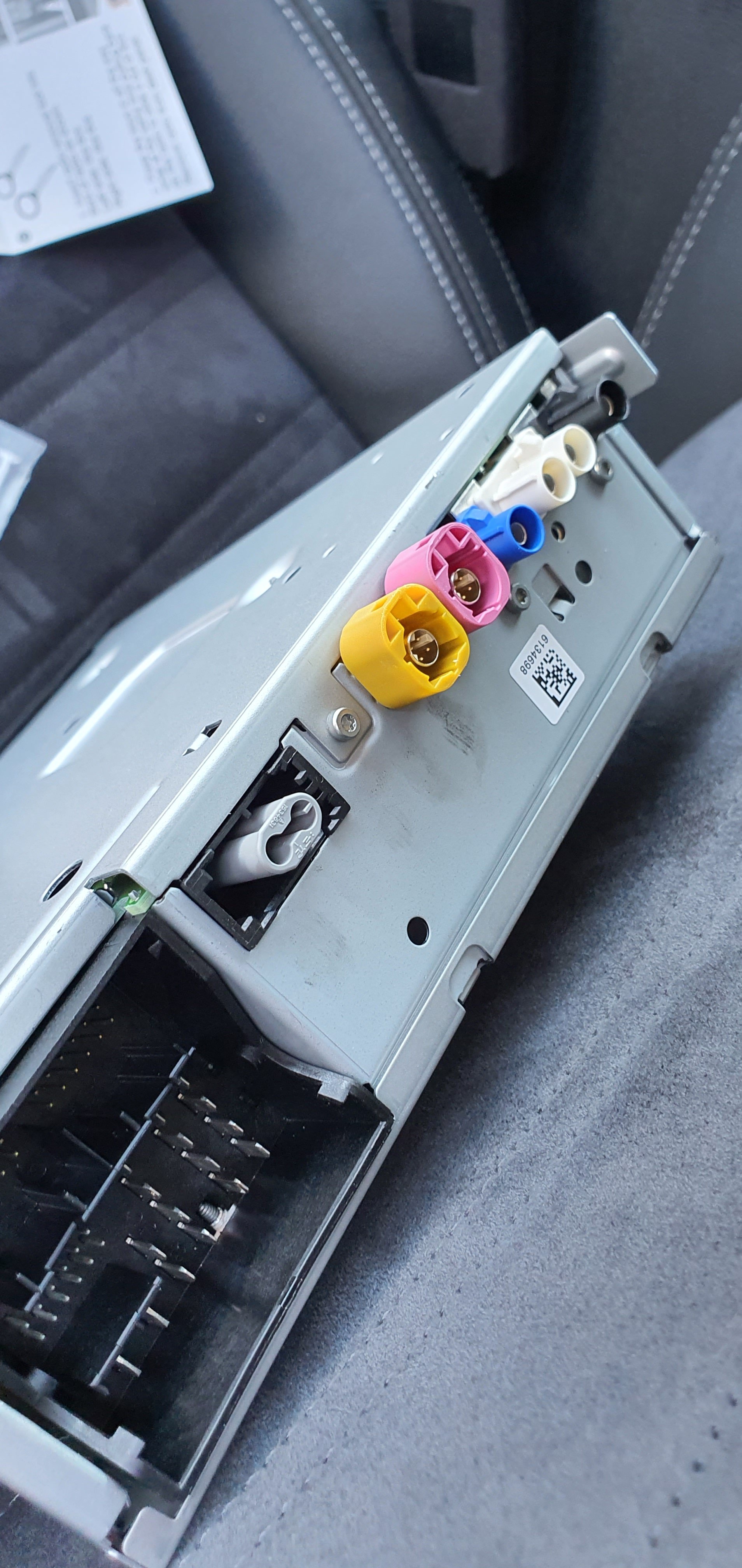

Its worth examining the back of each MIB Headunit now.
Amunsden
Columbus
The only attachment I moved across - was for the fibre optic port.  This is the grey Oval connector - which I put onto the back of the Columbus system.
In terms of socket colours, here is a table of what is what:
Amunsden -> Columbus
Black -> Black
White double -> White Double
Blue -> Blue
Yellow -> Yellow
Pink -> Grey - you need to perform the same wizardy with the connector and remove one tab part of the connector (with your pen knife)- same as you did for the blue connector for the screen
Black DIN -> Black DIN
Fixing the Wire

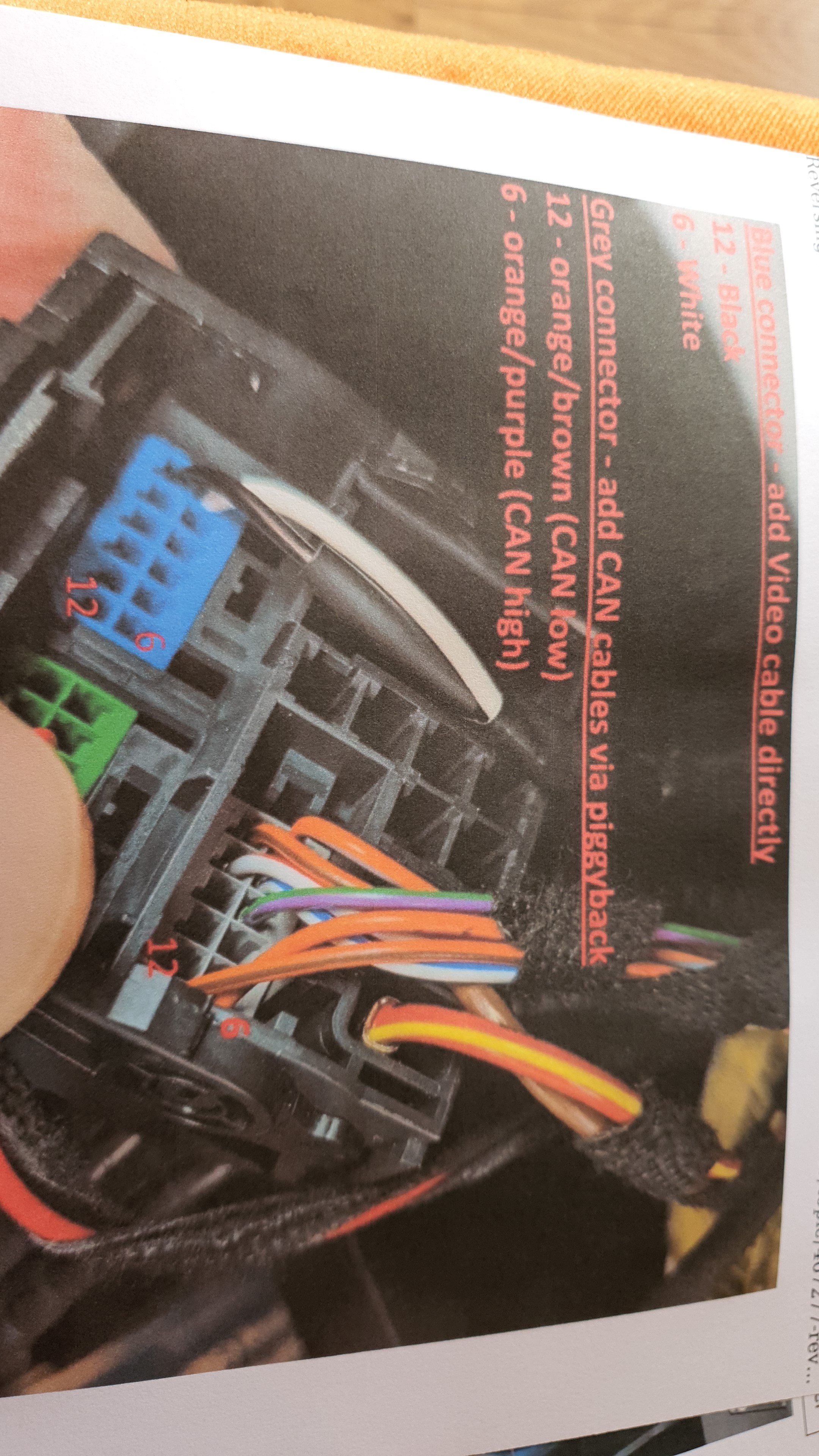

Do you remember that orange wire; turns out this was the Orange/Brown wire for the Can LOW connection on the Gray part of the DIN connector.
It is Wire 12 that needed to go back in and be reattached:

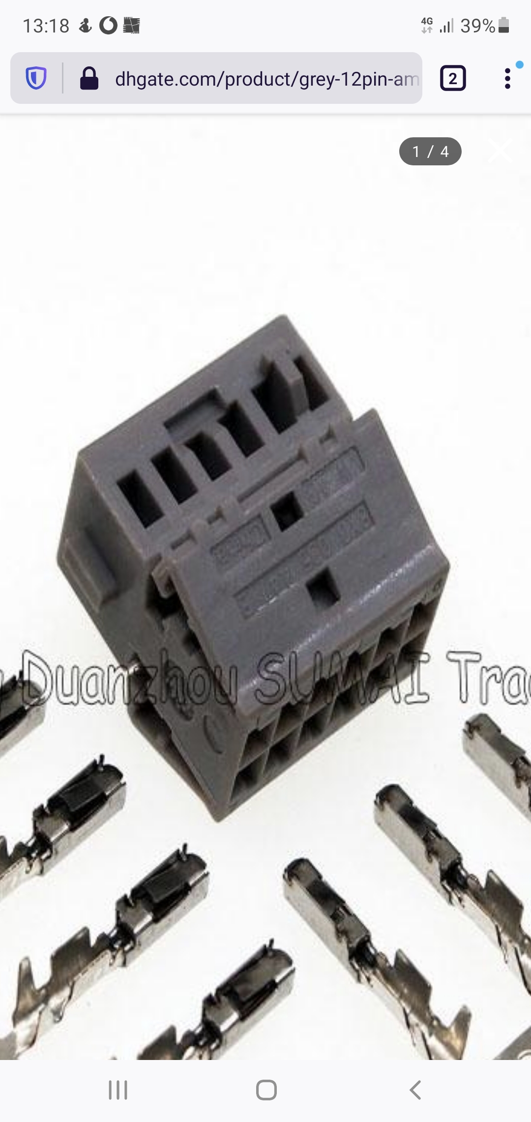

To take out the grey connector, you unlatch it gently using a small screw driver from the main black DIN connector.  Speaking with Sasha, trying to figure out what to do, I had to try and get the pin out from the connector.
Trying to look at this connector (its called a AMP connector), it took me a while to figure out how to get the connector apart - then I found this photo on a chinese auction website:
I therefore got a screw driver into the side of the wayward connection and levered up.  It popped open.
I then used the paperclip to push back AMP/TE connector pin - back far enough - to allow it to show its rear connector.  The pin is designed to be a one-way fit with a metal latch to stop it coming out of the connector block.  I got just enough space to gently open up the rear of the pin, put the orange/brown wire back in and reattach.

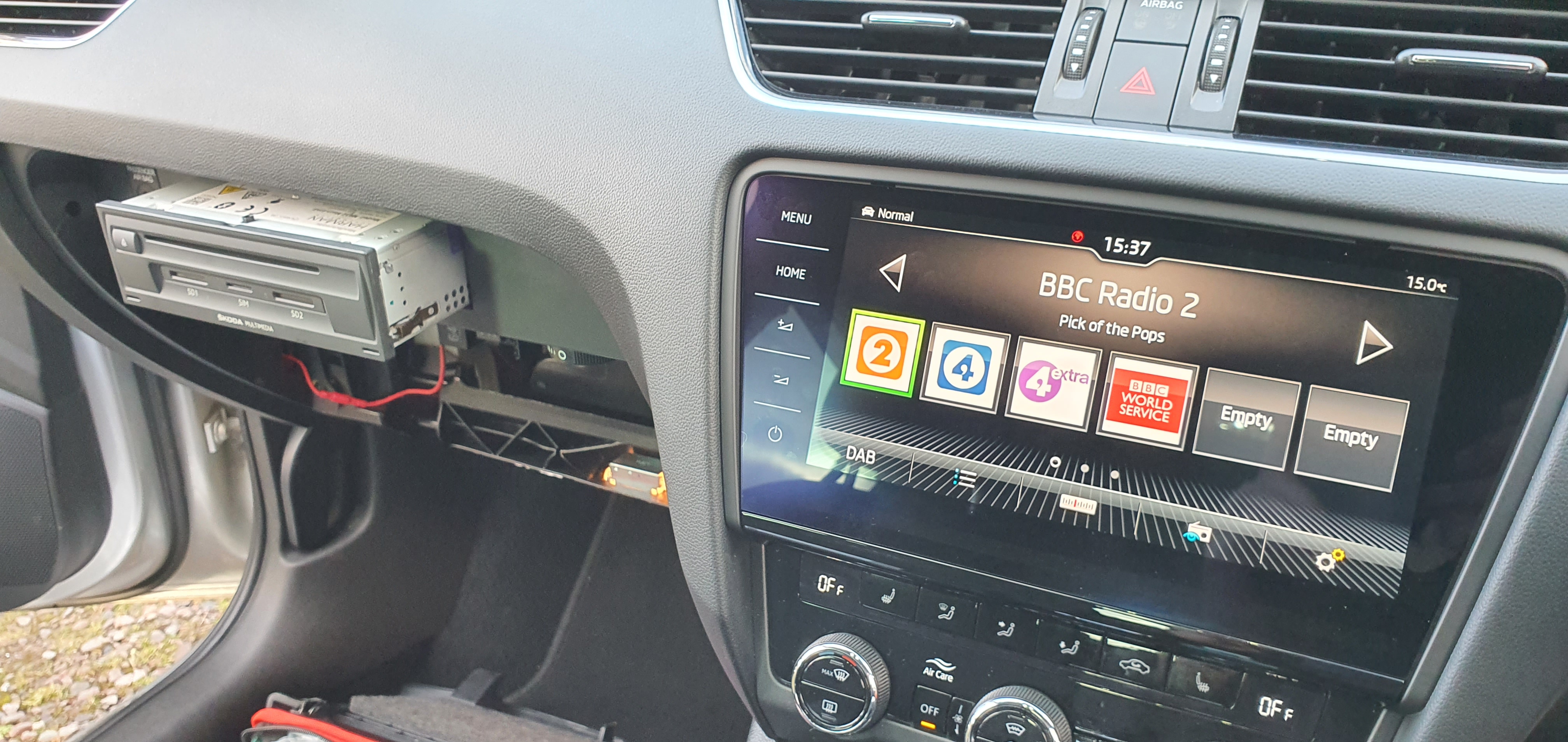

I then started putting all of the connectors onto the back of the headunit.
I gently push back the headunit into its slot - making sure the wiring loom at the back was not caught up - and then held my breath:

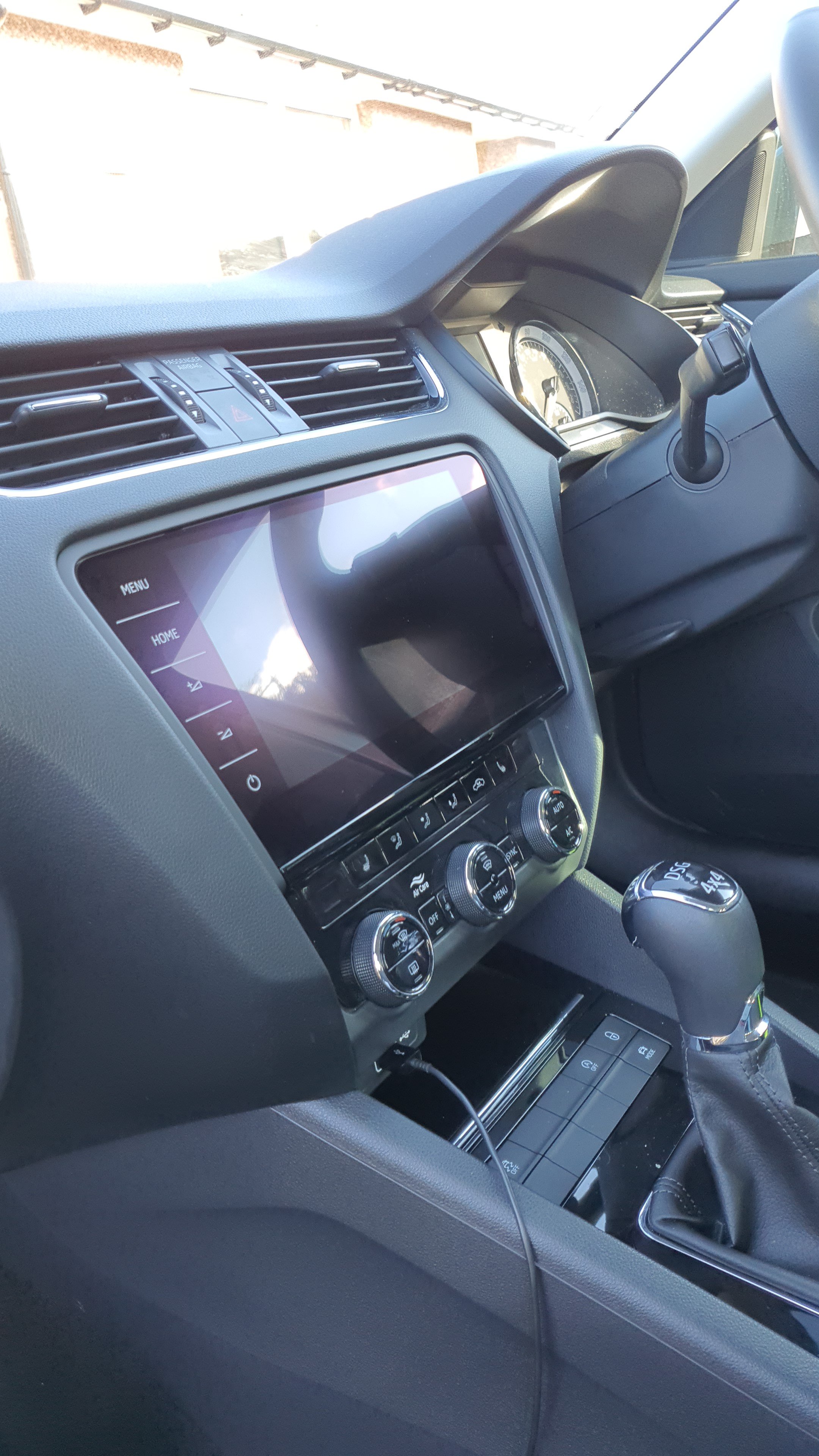

IT WORKED!!!!!!

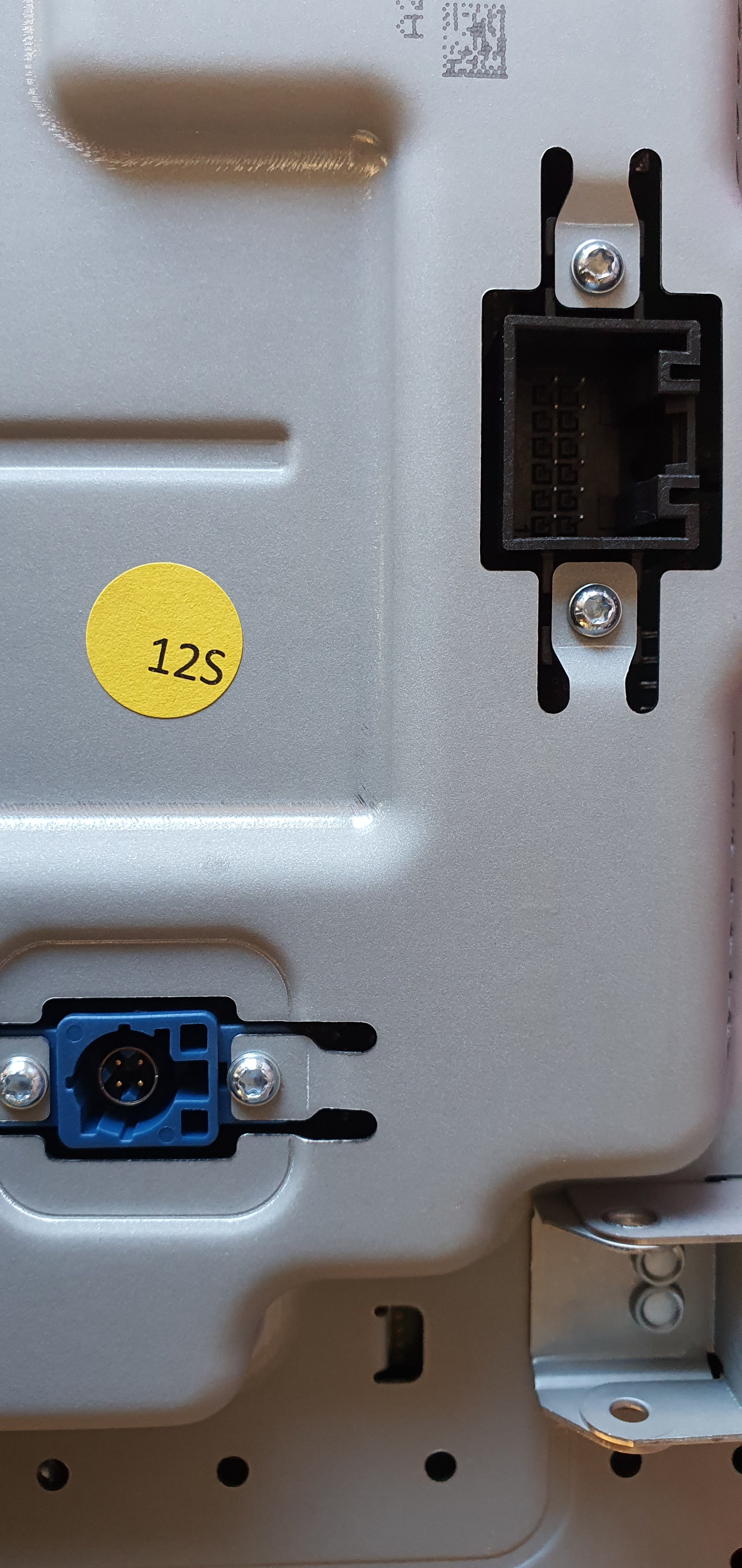

To have SIM working you need to add 2 LTE antennas that are factory installed inside rear bumper - 5E0035497 (left) and 5E0035497B (right). Then you need 1m long waterproof cables hat goe from bumper to the trunk and then regular coaxial cables to connect to infotainment unit. I don't remember part numbers now for the waterproof cables but can check it later.
Alternatively ypu can get aftermarket antenna from aliexpress which is very cost-effective.
Thanks @pab567.  I've already got a connector plugged into the double white/pink connector.  Is that connector used for GPS?
No, this is double Fakra purple connector
