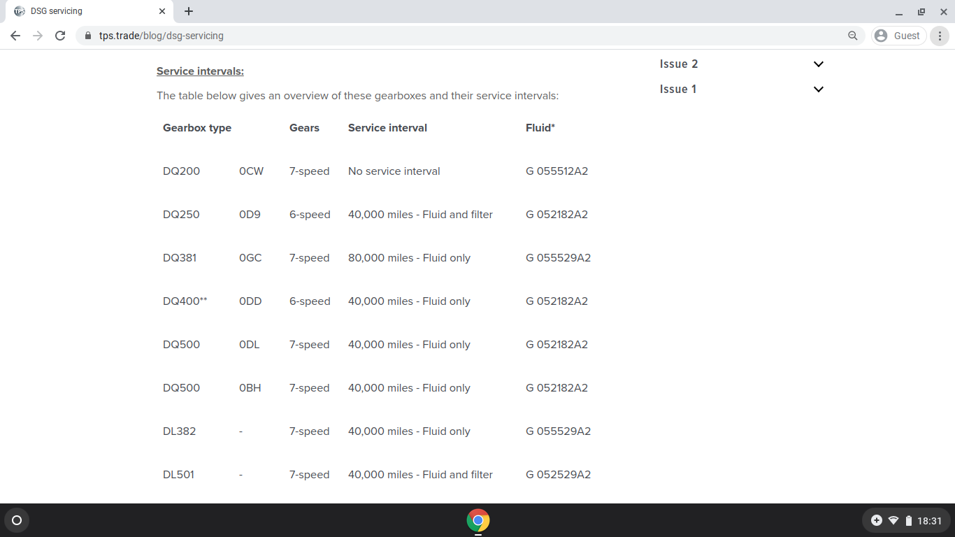

Just checked the service manual - if it’s 6 speed then oil change at 60000km (40k miles more or less).
If it’s 7 speed then as, e Roottoot says, no oil change required, sealed for life, there is no filler plug or way to check the level.
The 6 speed manual gearbox, which I have, also has no maintenance, other than to check it isn’t leaking. I won’t be changing its oil.
Mine is 6speed..doea it mean that my car required gear oil changing! But SKODA dealer says not required!!! How and where can I get the genuine info?
@classic
Obviously there is a filler plug for a DQ200 DSG.
There was a World Wide Recall in 2012 which excluded Europe which is out of the world, it got a Service Campaign.
That was to change the Synthetic oil to mineral using the drain plug and refilling using the filler hole, and there was a software update. '34F7'.
Then 2013-2015 some DQ200's had the Service Campaign '34H5'.
But there is no level checking when you change the oil doing it correctly and filling to the quantity required as some here have done themselves.
@automass  Are you talking about a 1.4 TSI & saying you have a 6 speed DSG, so a wet clutch DSG?
