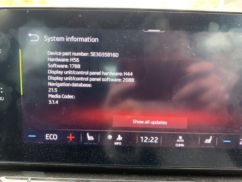

Seems all very strange as mine went in two weeks ago and it changed form this:
To this:
It seems to (so far) fixedthe SOS and the dealer did so dont worry its a well known issue and easy fix... Fingers crossed!

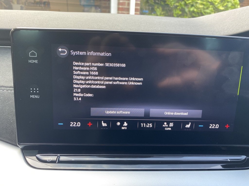

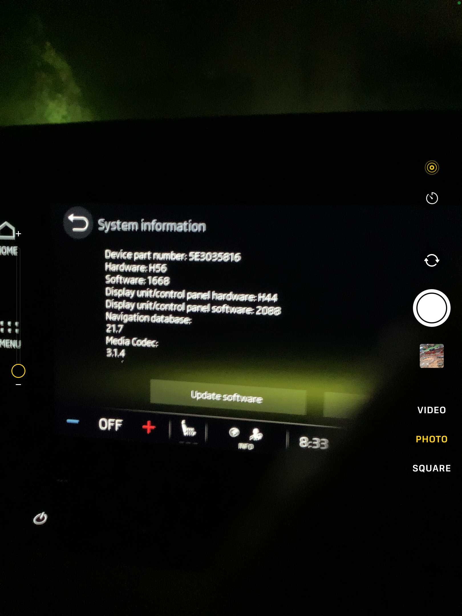

S/ware is 1668 and Device Part No. does not have a suffix/revision letter
Nav Db is 21.8

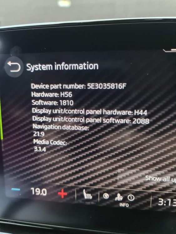

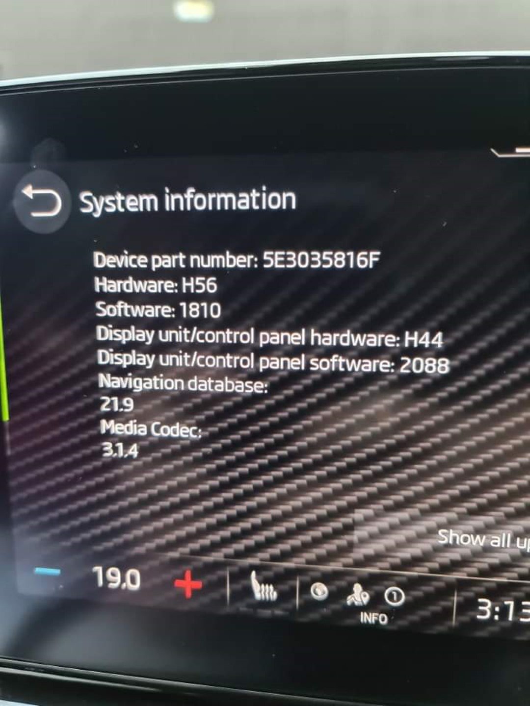

I haven't trawled through all of the posts but I'd like to see if anyone is aware of the updates shown in the attached picture, it was on Facebook last week.
Sorry if this has already been posted!!!

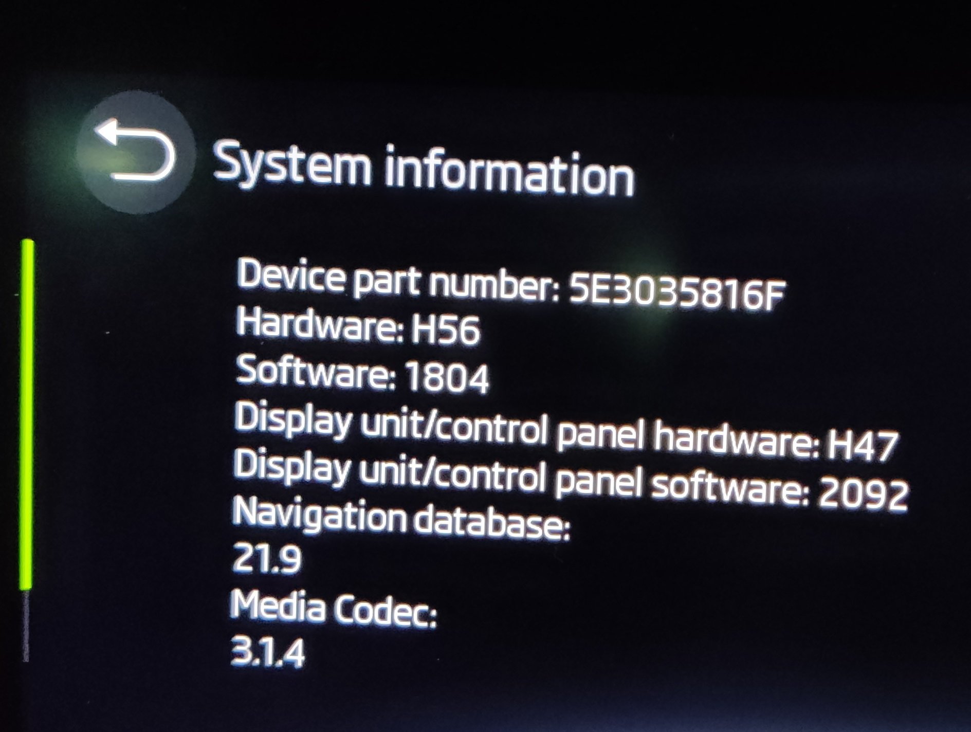

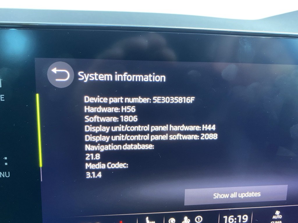

That's the same versions that I posted last week in the km/h mph thread. My SEL 1st Ed went from no suffix to F and 1810.
I have Octavia 4 SEL FE Combi, like yours and mine went in for a software upgrade in September. Mine came out with this?  Anything I should know?DE1BEFF0-D66A-4815-9E17-59489FD01204.thumb.png.f445346b33de63f0fd2cba1ae602d360.png

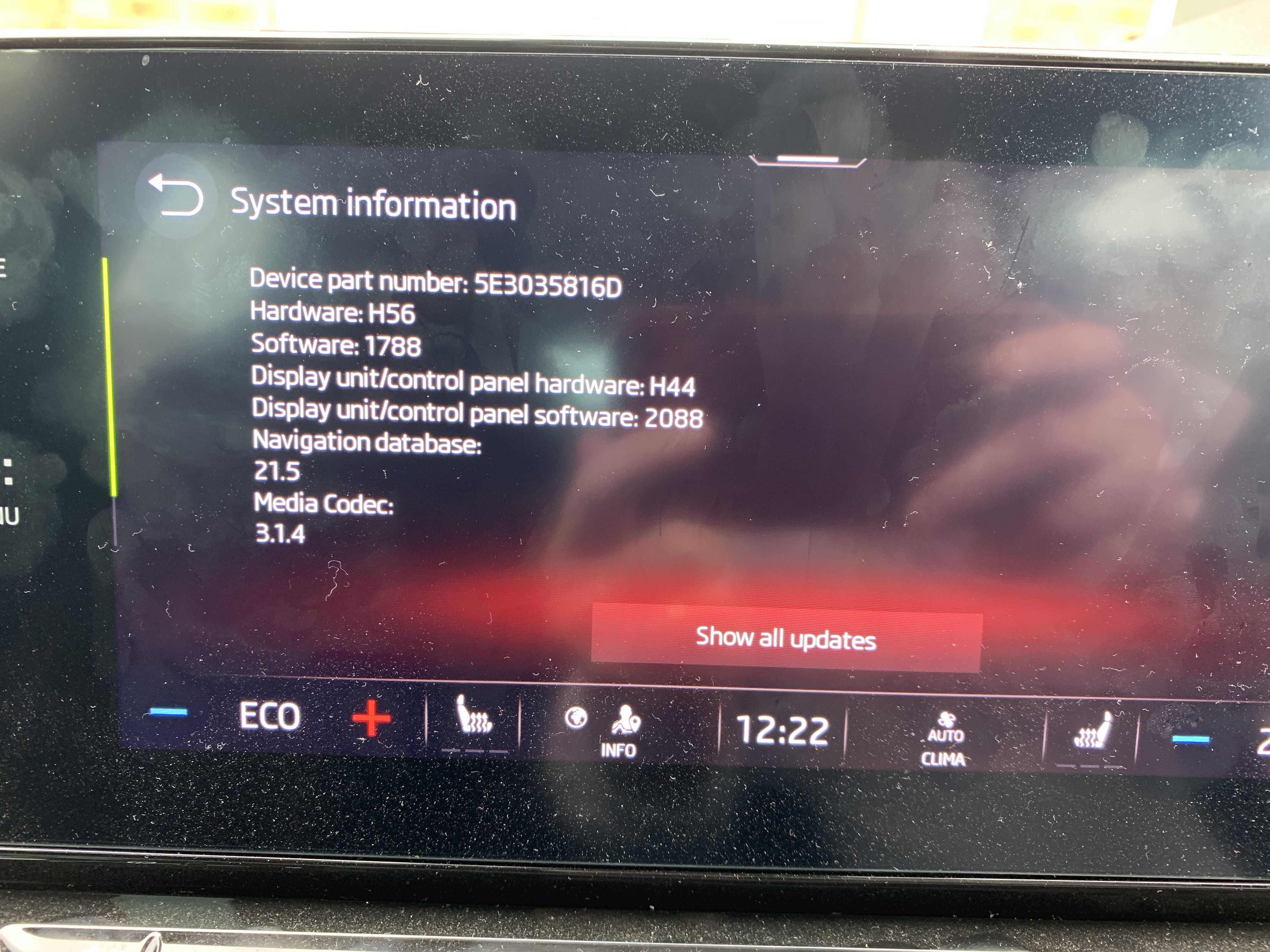

I picked up my Octavia iV VRS at the end of October and it came with the following. They claim there is no newer software yet I have the KPH issue with the road signs being shown in KPH and if using ACC I've had the car jump to 80 in a 30 by itself. Luckily I've been quick enough to brake before I got a speeding ticket.
Why can't they just admit that there are issues and fix them.
