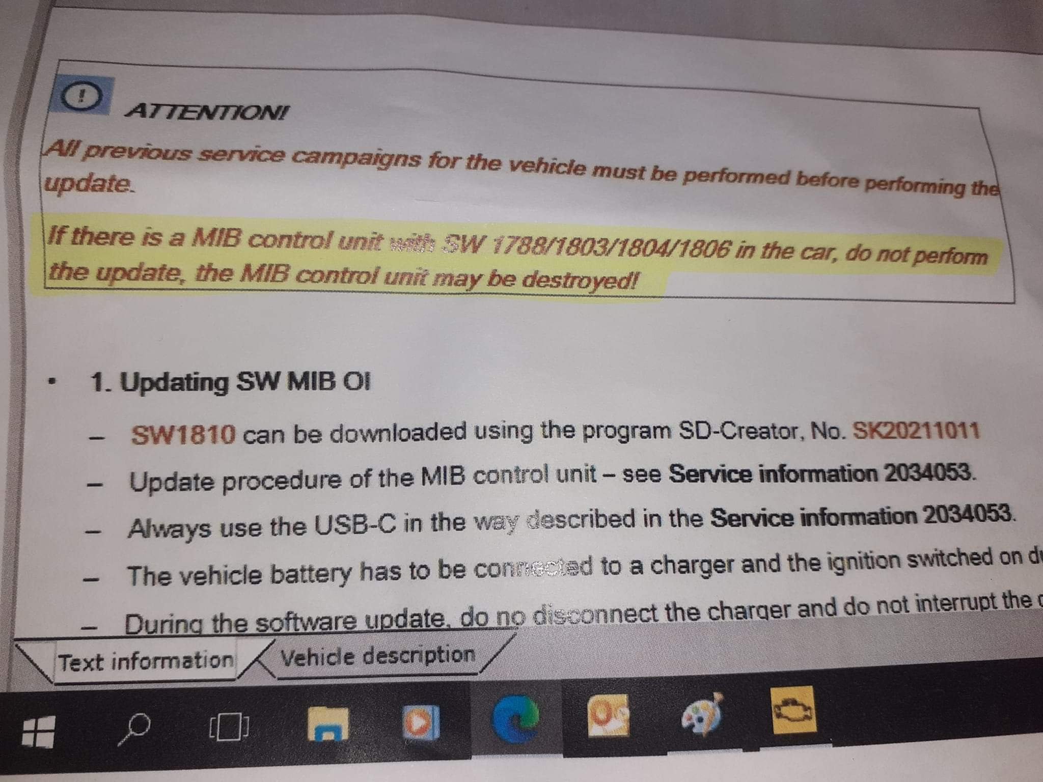

On 20/11/2021 at 17:14, weehappypixie said:
I found the image here on a different Octavia site so it's not my picture so credit to the person who posted it originally.
Looking at this and it look's like there may be bigger issues here. I have 1804.
John
My experience has been as such.  Car booked into the local service centre in early Nov to try and sort the litany of problems as described by many and reported to them, Infotainment/satnav/climate/Skoda connect.  Probably the most annoying and dangerous being the adaptive cruise control issue and SOS fault.
They had the car half a day and called me to say they couldn't do any software updates and had to order a new E Call Control Module which was on back order and could be a few weeks.  I collected the car to find it was now stuck on the loading settings screen and I no longer had access to the sat nav, radio or android auto!!
It's now had the module changed on Monday and I was given some feedback that supports the above picture from @weehappypixie after I questioned them about the lack of obvious updates
Hi,
I can confirm that we were aware of the listed issues as per your email and these were recorded on the job card.
The SOS warning lamp and the clicking from the E Call speaker and the intermittent fault with the ACC have been rectified by replacing the defective E Call Control Module and updated the software for this unit to version 0142, which was causing numerous ethernet communication interruptions and putting various control modules into emergency operation.
We are aware of the different software levels for the MIB3 (1788 / 1803 / 1804 / 1806 ) but installing any other software is not recommended by the factory for your particular vehicle and media unit updating to a version different than the current version installed may cause software incompatibility with the rest of the modules and the software levels installed in your vehicle.
Some of the vehicles may run on MIB 301 Unit with software level 1804 / 1806, but this does not mean these software levels would be any good for your vehicle configuration.
The next software that is compatible with your vehicle would be 5E3035816D 1888 and is planned for release by the factory in Quarter 2 year 2022.
I hope this helps.

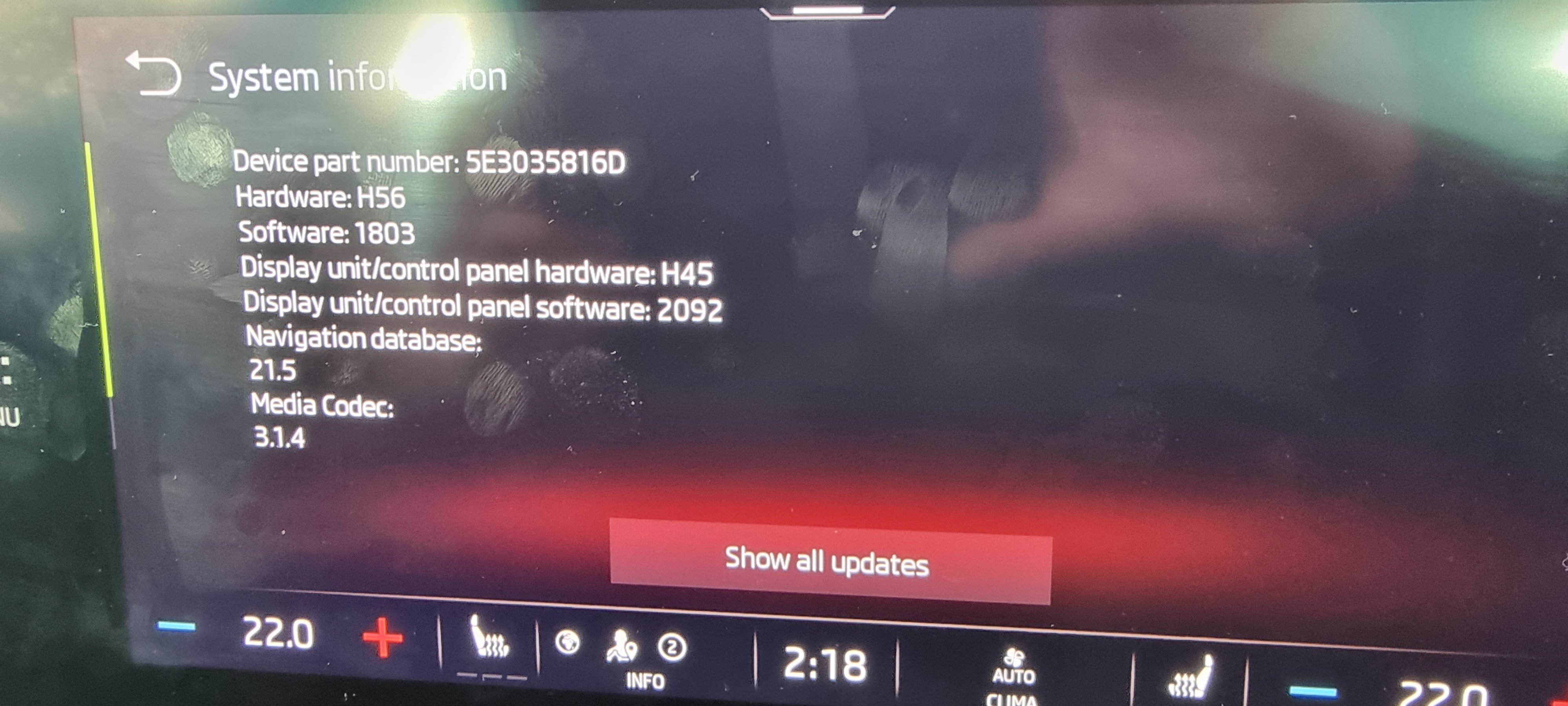

I'm on 5E3035816D, hardware H56 and software 1803, H45, 2092
If the AAC situation is resolved then that's a big plus for me, on a journey on the M3/M35 and M4 yesterday it performed correctly but time will tell.  So roll on Q2 2022....
Hi,
I hope this helps.
