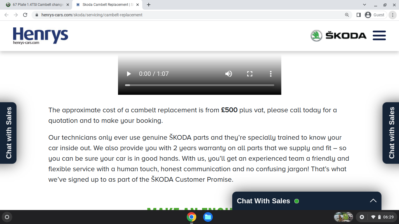

Price includes VAT. Consumer pricing must always include VAT in the quoted price. Only b2b can exclude VAT but it must be shown as an additional figure on the final invoice.
@FrankNicklin
Somebody need to tell them at HENRYS  or their Website designer or whoever published it then.
From £500 plus VAT is from £600.
Edited by roottoot
