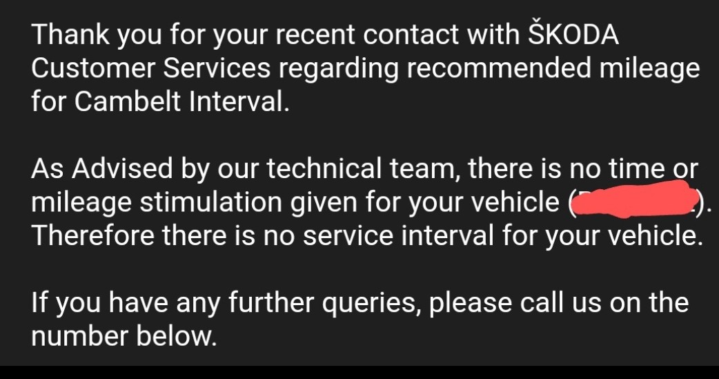

I called Skoda....the helpful customer service desk sent me email below (told me the recommended intervals were removed July
2 minutes ago, Toothache said:
885288747_Screenshot_2023-07-07-13-56-33-719_com.google.android_apps.photos2.thumb.jpg.c88d668eb4f9291f5f299af059c2cfaf.jpg
Sorry I have an Octavia 3, 2018 reg, 1.5tsi act
So no recommendations at all on the replacement schedule. How does that work.
