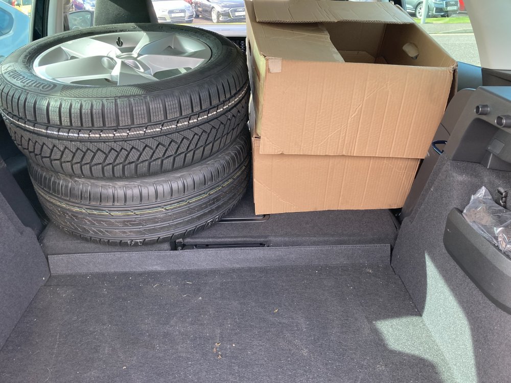

Full size wheel / tyre combos will be 30mm taller in the boot than a space saver - but maybe I can live with that.

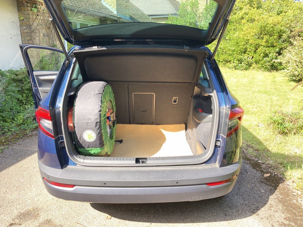

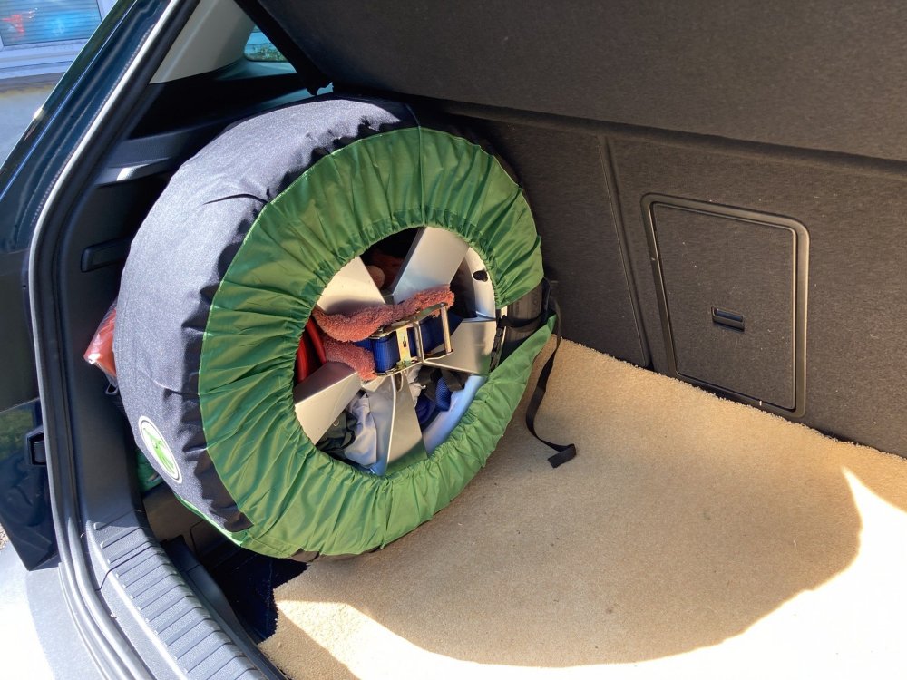

One of my previous cars was a Subaru XV, and, on asking about a spare it seemed you had to place a special order for a factory fitted alteration to the floor. Even then, the luggage floor was balanced on top of the spare, which was full size, and steadied with rubber strips to hold level. If a space saver was obtained elsewhere, the spare had to go on the back - a right palaver if the puncture was a front tyre - like playing musical chairs!
You will need a space saver on a 4x4 - the Haldex unit is under the spare wheel well and takes the space a full size wheel would need.
There are ways of fitting a full spare in the 4x4 boot.  Not orthodox but works for us. 👍
😲   Looks like the parcel shelf won't sit flat? Doesn't a raised shelf block the view thru the rear window?
Edited by kodiaqsportline
It’s pretty flat, with the hatch open the RHS is still a little raised.  But once the tailgate is closed it holds the load cover in place nicely and no view through the back is lost. 👍
Oops, meant LHS.

Has anybody fitted a space saver bigger than 125mm thick (wide)? Does this lift the floor?
Cheers,
Just had look in my boot - I'm sure a 145 80 18 wouldn't fit (diameter) in the well and yes, it'd lift the boot floor as the 125 sits flush with the floor of the boot.
You can fit the 135/80R18 space saver tyre to a 3.5Jx18 ET25.5 5/112 57.1 steel space saver rim. This rim is normally used with a 125/70R18 space saver tyre and was originally used with the Octavia MK3 or maybe earlier cars than that. The 125/70R18 tyre closely matches the outside diameter of tyre sizes such as 195/65R15, 205/55R16, 225/45R17, etc., that the Octavia MK3 uses...but Skoda supplies this wheel (tyre and rim) less appropriately for cars such as the Superb MK3 and Karoq. In my view, this is a bodge to save Skoda money by reducing the number of different spare wheels that Skoda dealers need to keep in stock, etc.
You might think that a 135/80R18 tyre is 10mm wider than a 125/70R18 tyre, but the actual inflated width of a tyre not only depends on its nominal size (the nominal size is marked on the sidewall, such as 125/70R18, 135/80R18, etc.) but on the actual width of the rim to which it is fitted. The actual inflated width (measured from sidewall to sidewall at the widest point) of a 135/80R18 tyre when fitted to a 3.5J rim is only about 7mm wider than a 125/70R18 tyre fitted to the same 3.5J rim width.
So the question is...is there enough room in the spare wheel well for a space saver tyre that is about 7mm wider than the 125/70R18?
