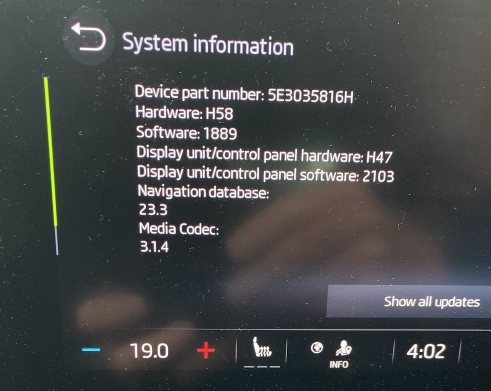

I attach pic of current configuration .
You can try to update to 1896.
However, mine started to reboot after the update so I am not sure that this will resolve your problem.

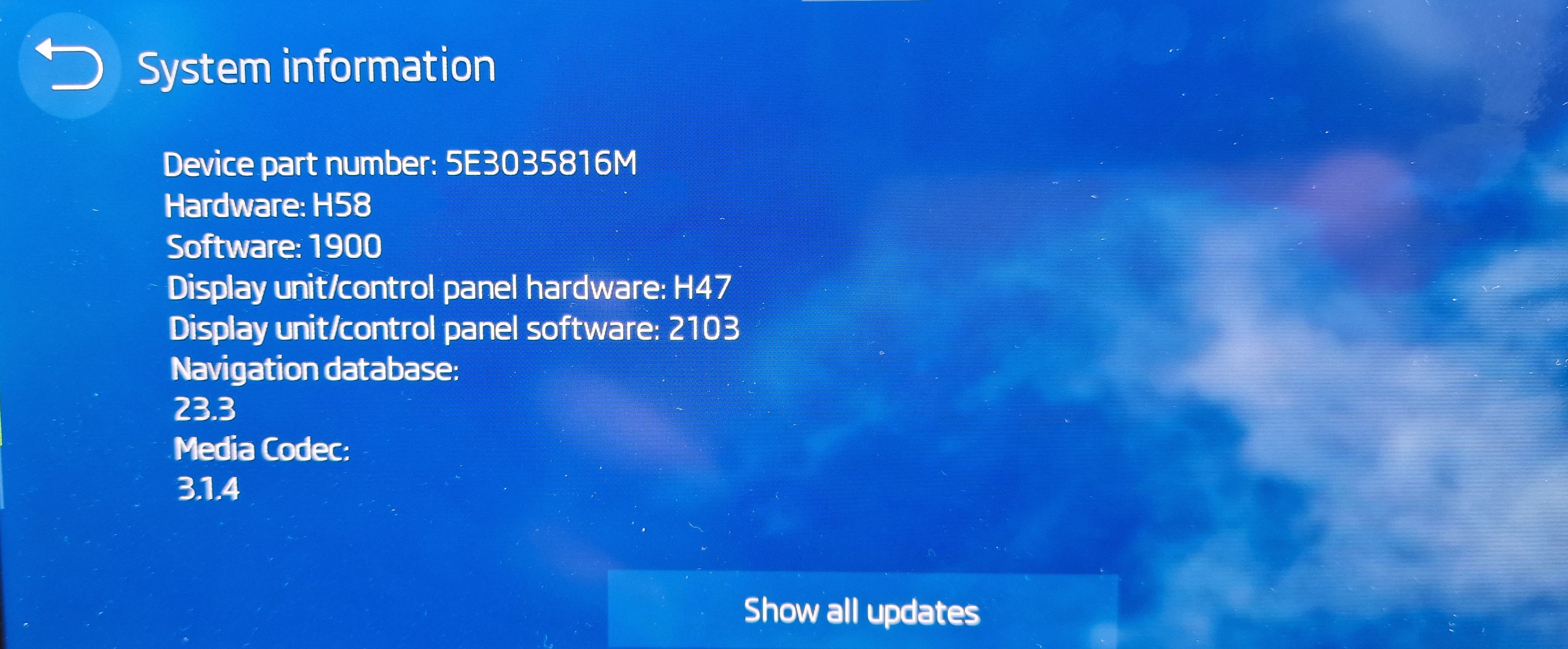

See what happens if you can get revision 1900.
That's what mine is on, it has already done several updates, but I don't know what they are but the car has settled down nicely and no faults so far. 🤞

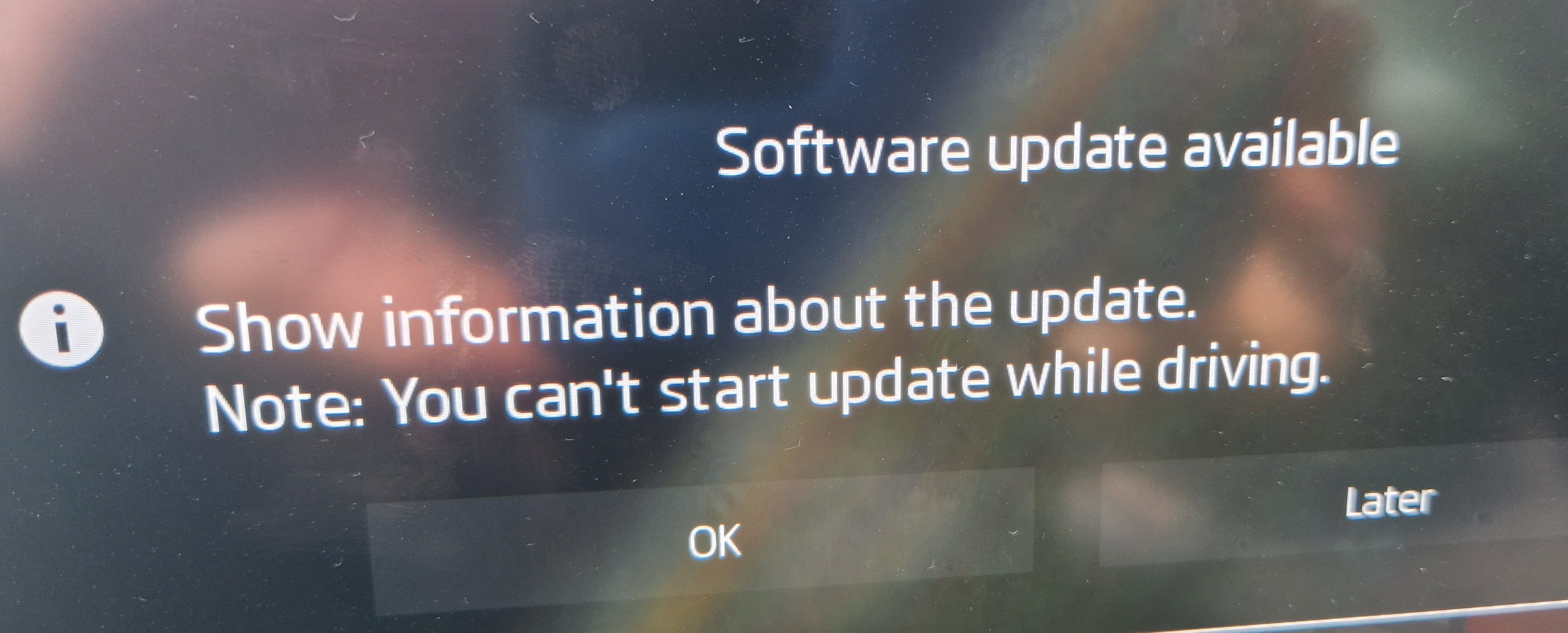

Some kind of update will be installed, we will see what will change 😀
Yep, had that today too. It did list what it contained but very unhelpfully AA decided to obliterate the message and so I couldn't read it.
I take it, the system downloads it and then updates it when the car is stationary/engine off for a considerable amount of time for it to update itself.

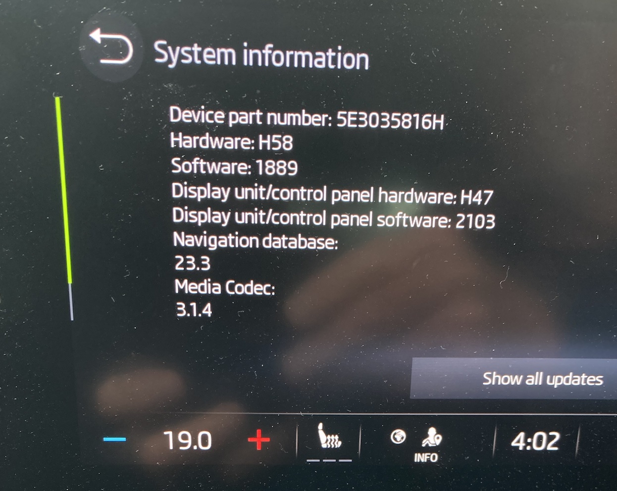

Well it finally finished updating or upgrading itself today, don't know what its done to itself, but this is now what I've got on my car.
