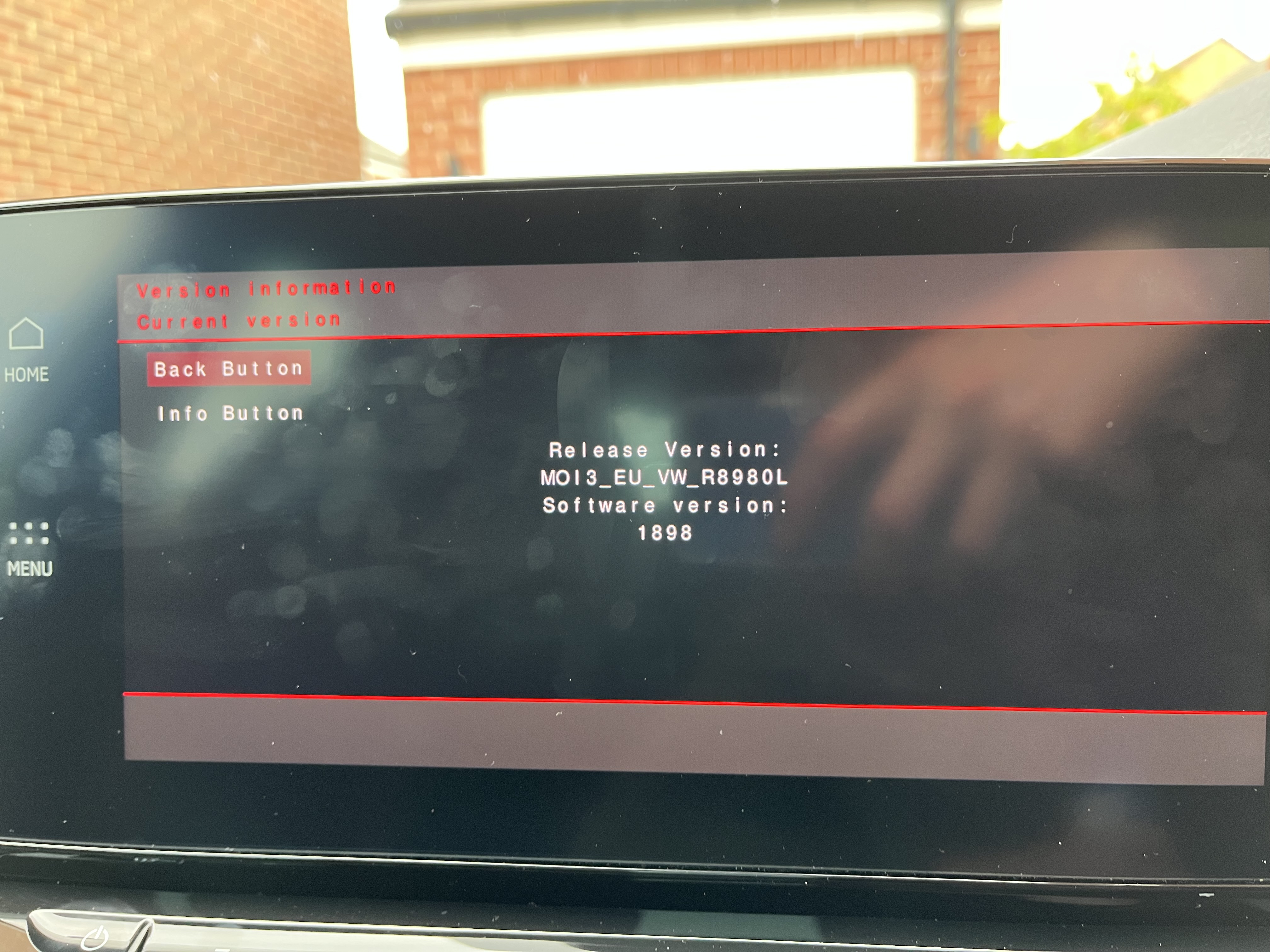

1 minute ago, djmartzian said:
@varooom, Why @Andy585's  car is running on VW SW? Is this a mistake or this is how the new SK models will be delivered from now on?! Thx
Skoda have not yet released a standalone update so that we can check what SW Train they have used for Skoda, but I don't think they would use VW.
Maybe we need a few more people on 1900 to show their SW Train to compare?
The last release for Skoda as a standalone was 1896, after they used OTA to update to reach 1900 currently.
Skoda a lagging behind SEAT and VW, release could be any day, or a few more weeks.

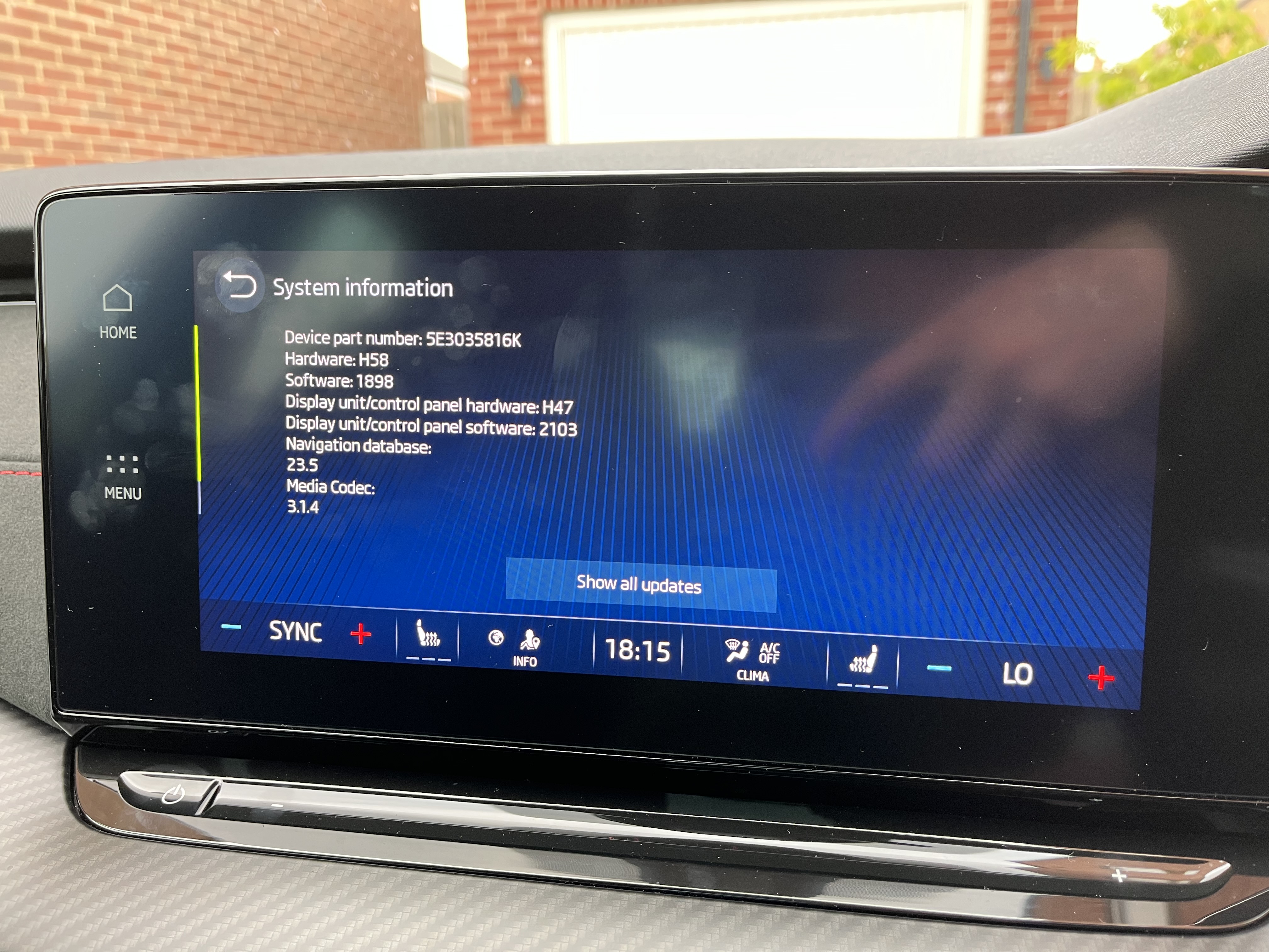

Here’s mine but not on 1900…
Car is 2022/23 delivered jan23.

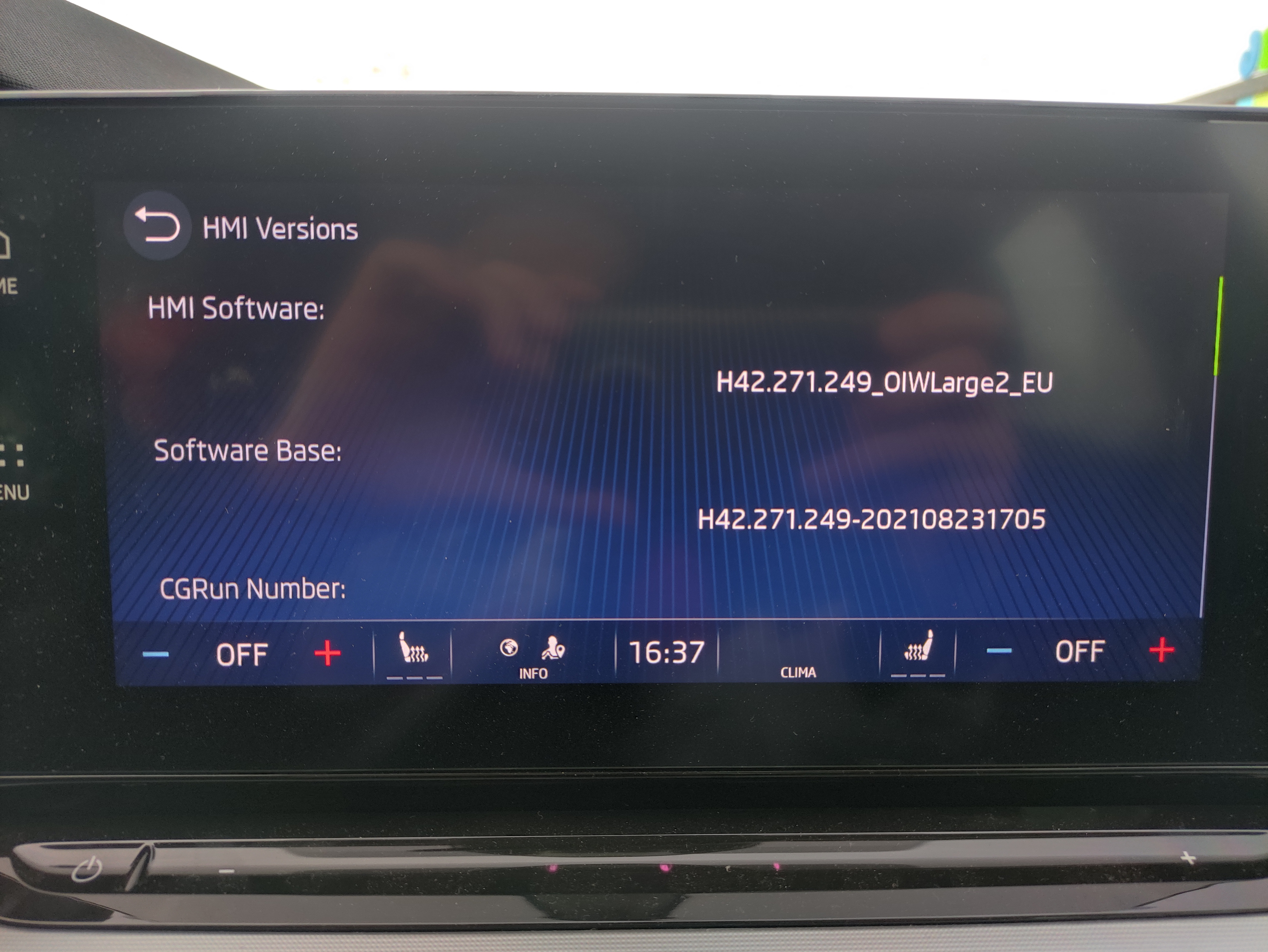

Hi @Towline,
How did you get into the Hidden Menu to get the actual version information? I would like to check mine, also.
Thx
56 minutes ago, djmartzian said:
Hi @Towline,
Thx
hold the menu button down for a few seconds 👍
Thx. I did that, but how did you manage to get the Red Hidden menu? Apologies if my previous questions wasn't too clear.
If I select "Software Versions" from the Hidden Menu I only see(different to your above screenshot):
Edited by djmartzian
Try holding it down for 10 seconds, that's the usual value

As you are here @TheWanderer and you are running 1900, can you dig out your Software Train value from your Engineering menu (10 second press on Menu iirc)
Just wanted to know if yours reads SK for Skoda or VW for VW of course.
As @Andy585 is showing a VW value on his.

Don't rush, more for curiousity sake to work out what VAG are up to with their OTA's.
Seems odd he has a VW value in a Skoda 🤔

I have seen this release land a few weeks back "MOI3_RECOV_R9900L" that is a tiny file, version 1920.  But I have no information on what it is for, but the filename is not looking good!
I am wondering if there has been some errors I am not aware of yet, that has caused trouble we are yet to encounter.
It could be the OTA update that has changed the Software Train from SK to VW for a few people.
