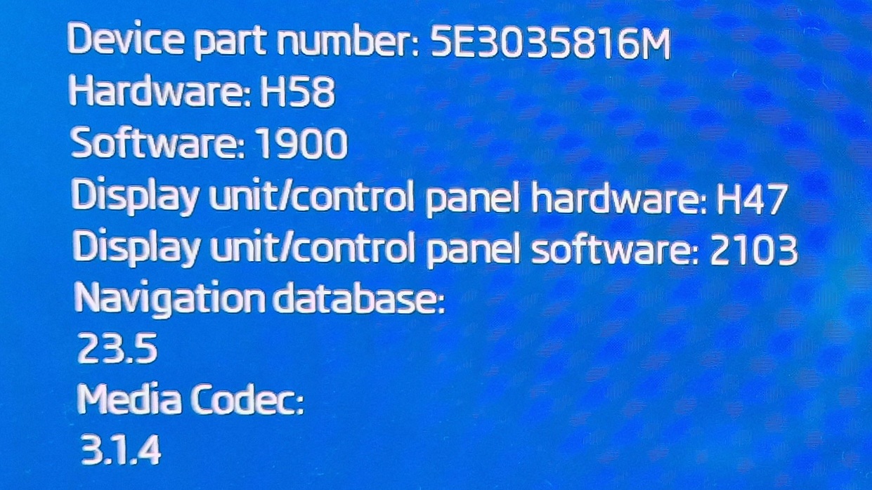

What is your current software version
1900

This is what's on my system. 20230605_144028.thumb.jpg.ba0943b83384580f93157322b990f521.jpg
