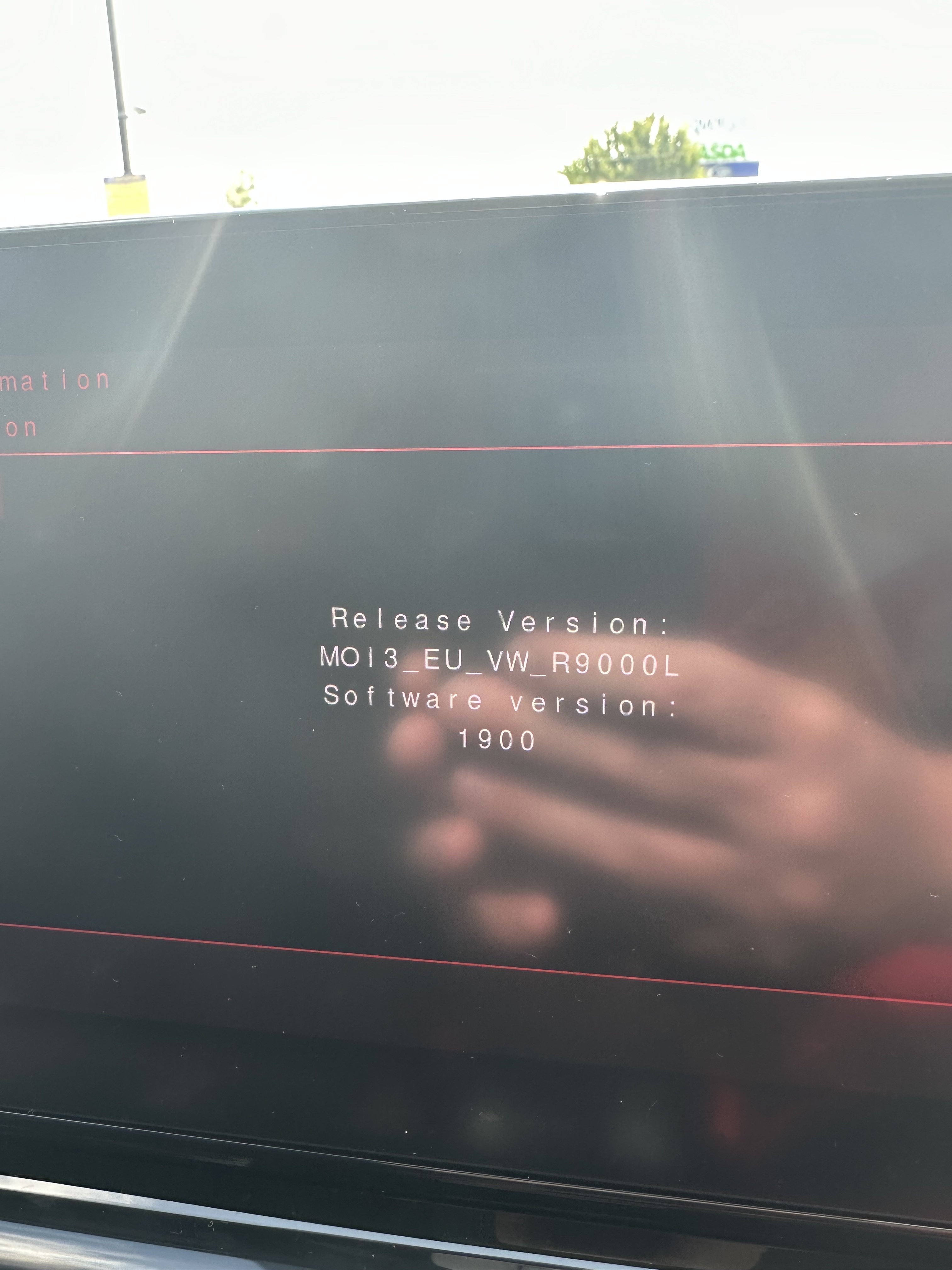

Am on the software version1900 and am constantly getting reboots

Drove 8 miles 4 reboots in that short journey that’s the version I am on
As you are on a VW SW Train, you should be able to go to 1941 in theory.
I should add to this, you really shouldn't be on a VW SW Train of course.
Edited by varooom

I think I would be asking them why your car is on a VW SW Train, they won't know... but they can push this off to technical to find out.
@djmartzianWhat has got you confused and groaning?
@varooom, Why @Andy585's  car is running on VW SW? Is this a mistake or this is how the new SK models will be delivered from now on?! Thx
