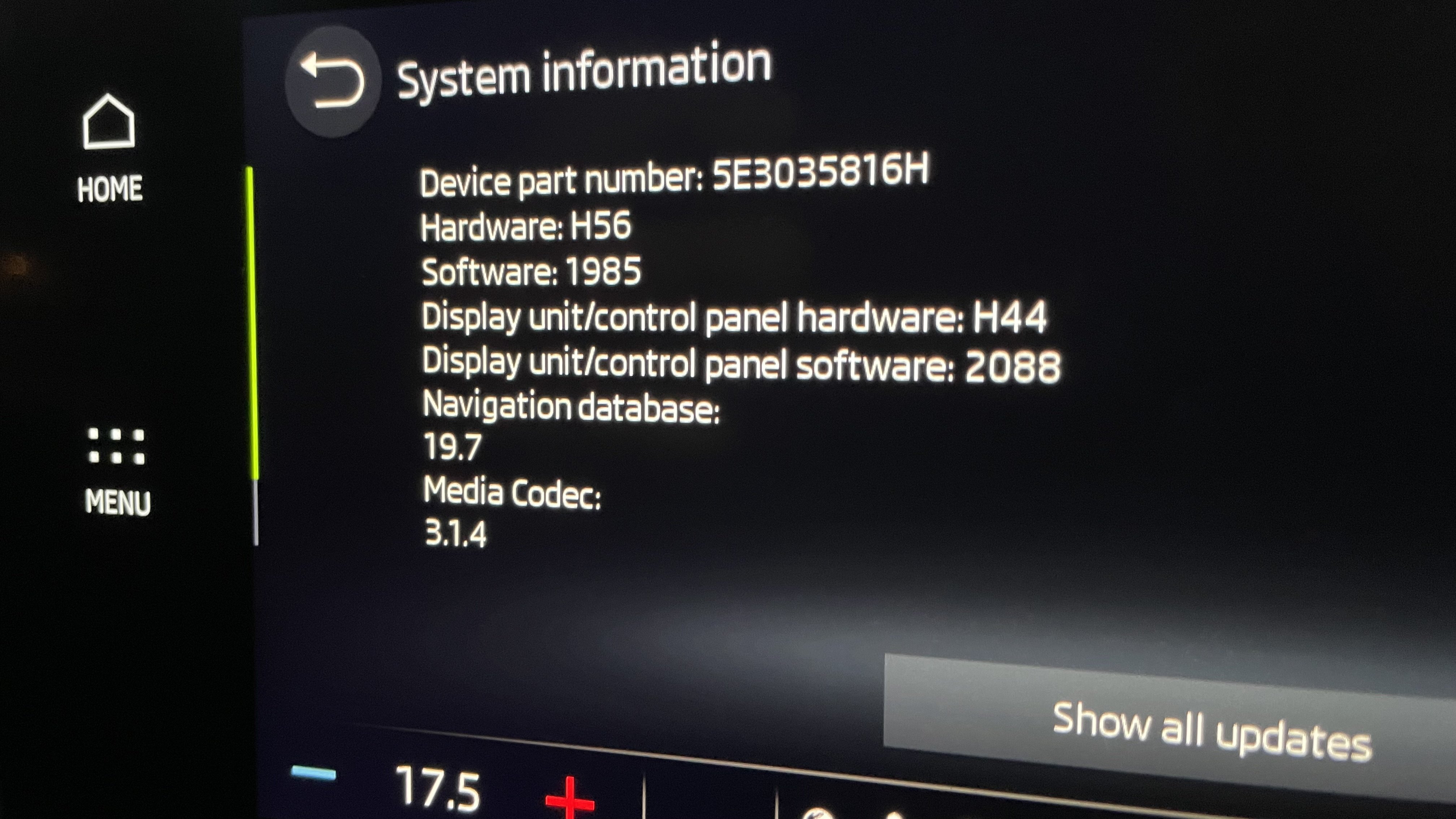

If it helps at all, here’s the System Information window. At about the same time I got a video of the radio turning itself off and on when the car was empty and locked from the outside ☹️
