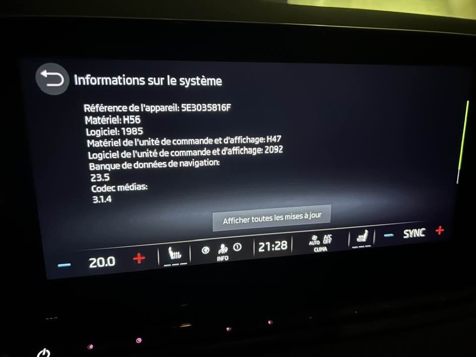

1985 OTA update for my RS 2022 (in France)

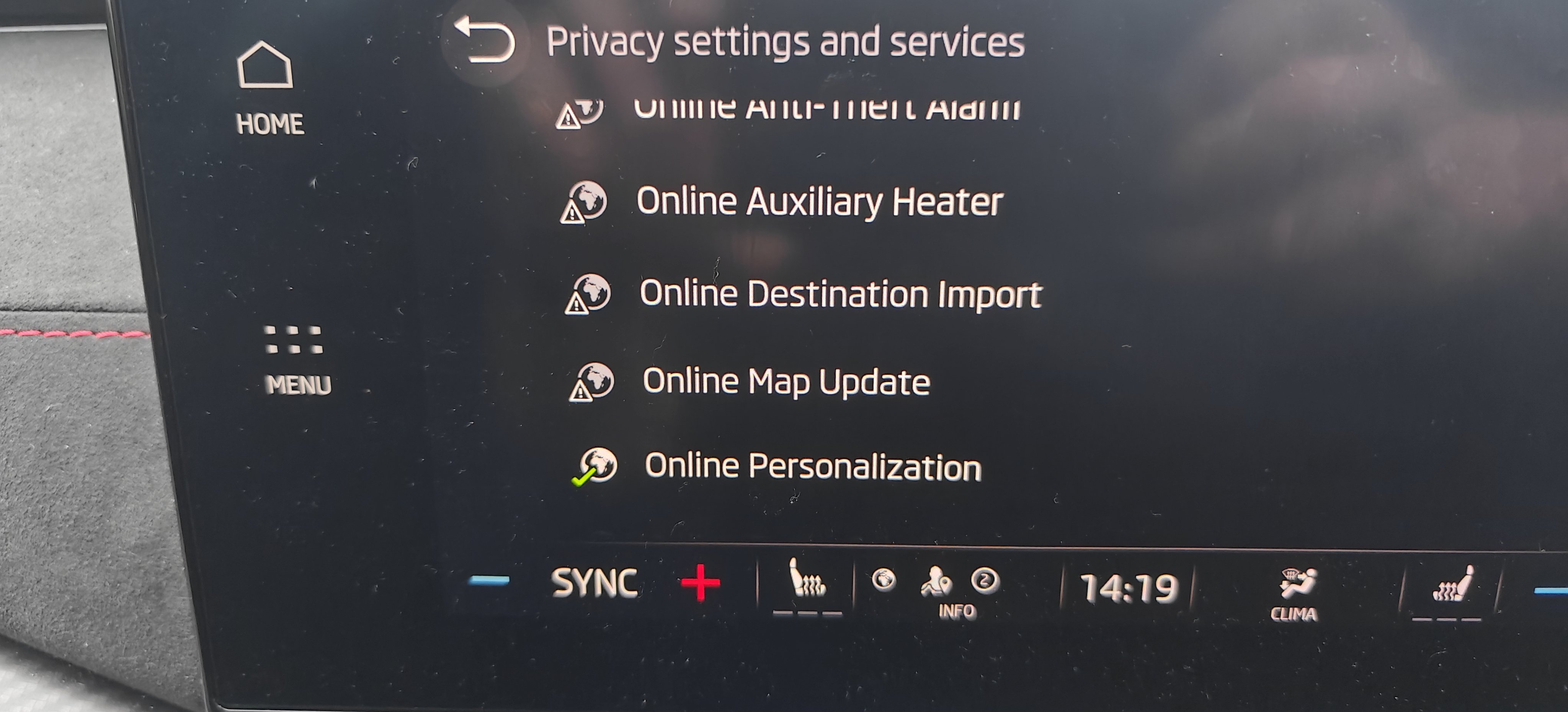

On 13/01/2025 at 11:29, Novascape said:
Online Mode enabled: Online Mode must be enabled in the privacy settings
When an OTA update is available, the vehicle's infotainment screen will notify the user. The installation can be started from the goodbye screen after turning off the vehicle.
Hopefully I'm looking in the wrong place as I don't have Online Mode as an option under Users / Settings. I want to see if 1985 fixes my infotainment unit issues before another trip to the dealer.
Looks like you've got a couple of notifications... tap the area I've highlighted in the attached image to see what they are. I find these are normally notifications for app updates. When the notifications first arrives it will appear on the infotainment screen for a few seconds before disappearing.
2025-01-23 14_27_13-Infotainment System Restarting endlessly - Page 64 - Skoda Octavia Mk4 (2020 _ ).png
I thought / hoped you had cracked but but unfortunately not. Messages were 'Pay to Park can be installed..." & "Installation of manual has been completed".
If I do Settings / System / Check for Updates, it shows as nothing available. Frustrating...

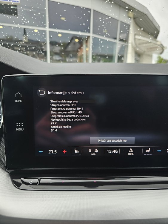

I recently had 1941. Opened up all my settings until the green light above my head beside the SOS call button was green. I then went ahead and connected to my houses wifi while parked in the drive. Less than 12 hours later, an update for 1985 appeared. Took a while to download and install over the next day or so, but it’s done.
Since the 1985 version, are you still having problems with infotainment?
No problems no.

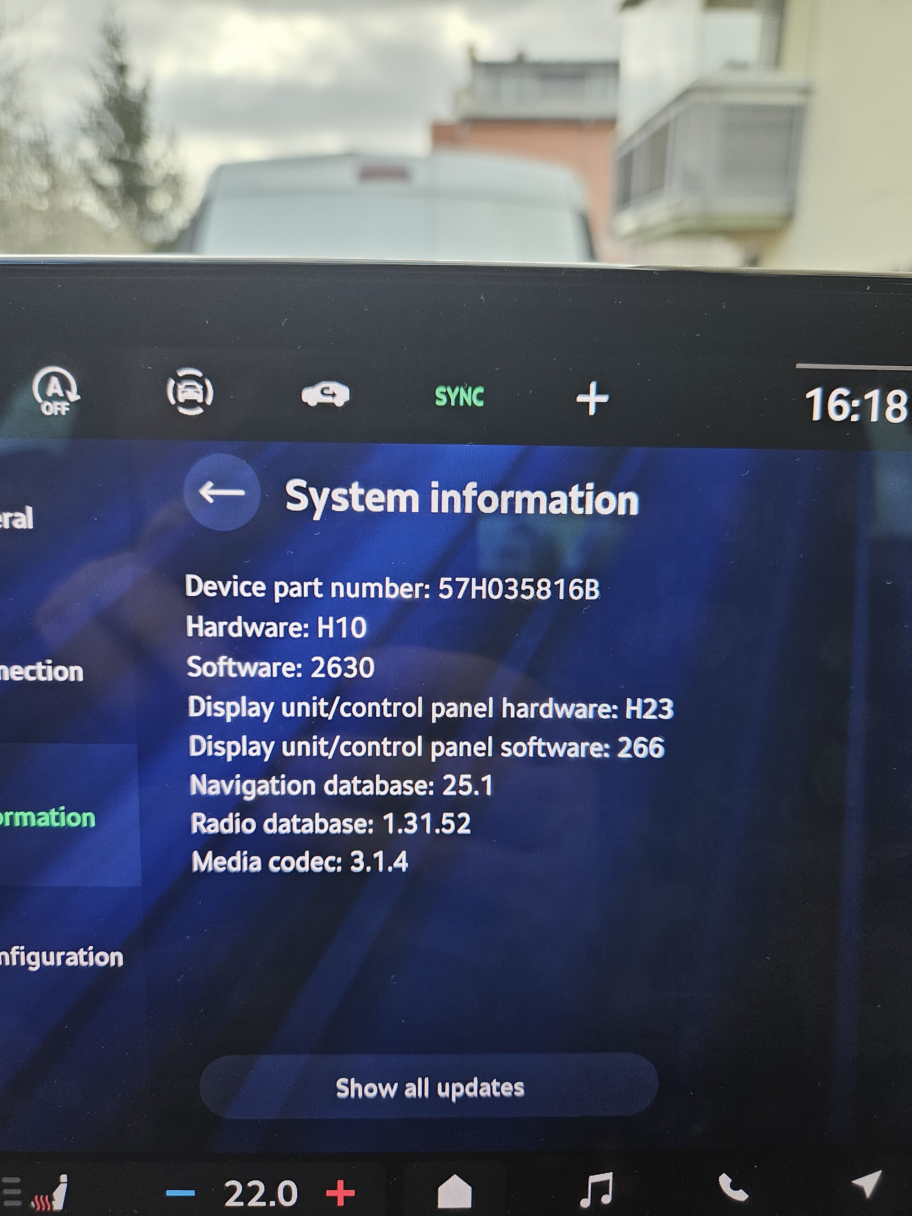

Isn't the face-lift supposed to come with a much higher version? Mine is 2630.
Edited by DarthMaul40
I dont know. They said facelif is 0166 and 0196
Ah, I didn't notice you have the 10" version, so different hardware.

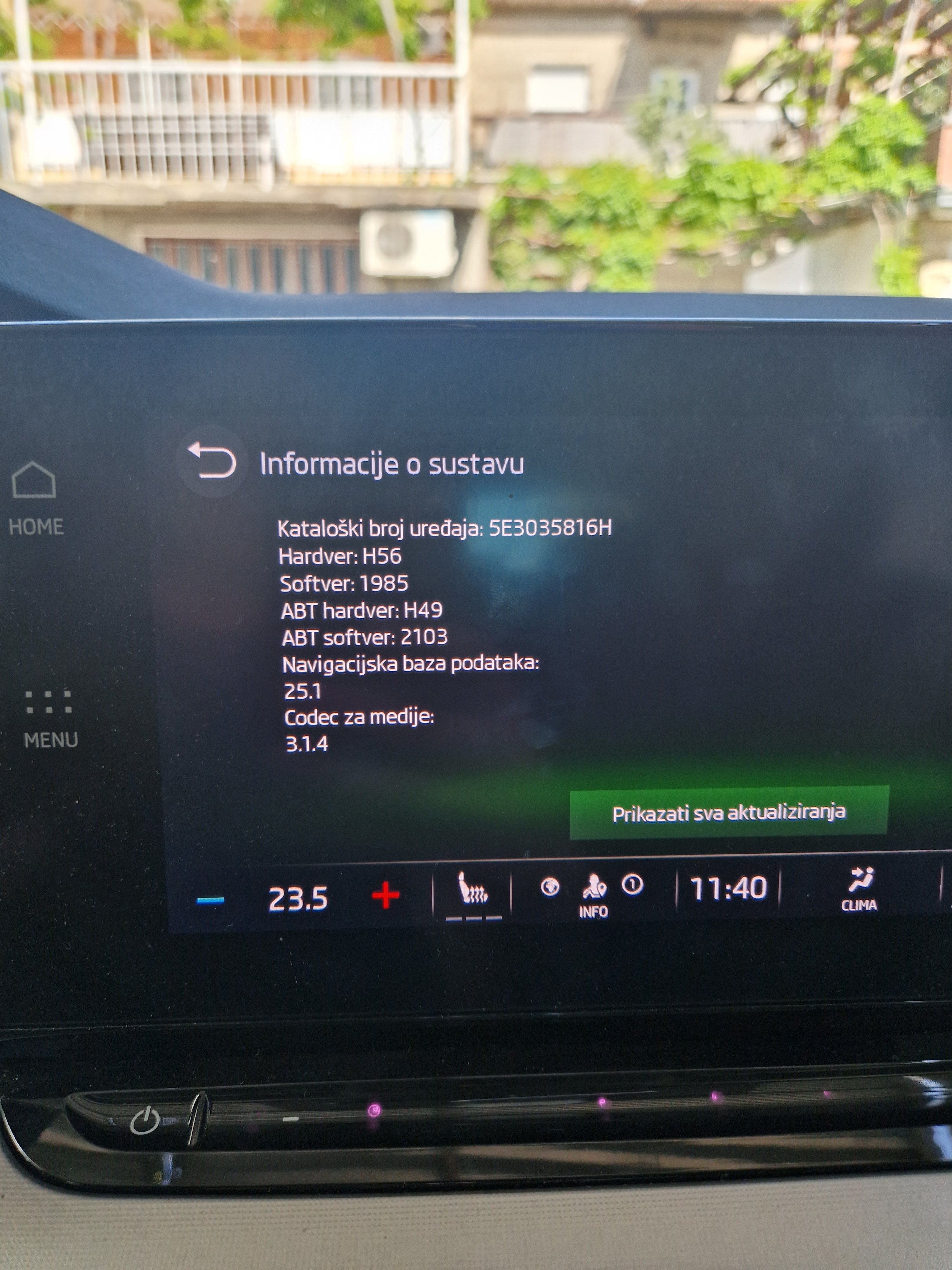

Last week the software was updated to 1985 After that the restarts stopped. Hopefully the problem is solved.

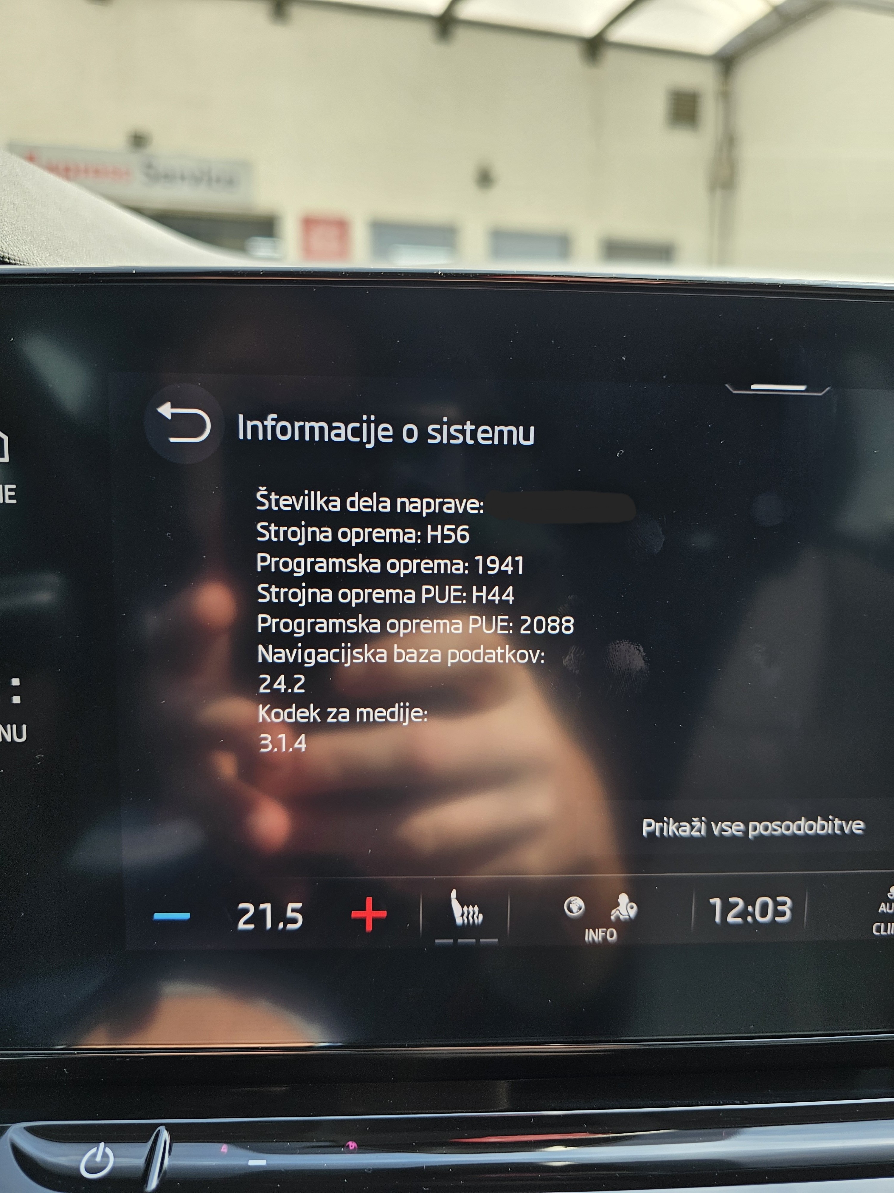

On 22/04/2024 at 20:04, PrimozAmbrozic said:
Hello everyone,
Better late then never. Last week my problem was finally fixed after two visits at official service in Kranj. At first appointment they updated (TPI 2065556/14) system software on my infotainment (1810 -> 1896 -> 1941). Everything was working fast and smooth way better then before but sadly after 1-2h I got the same issue. I went straight back to the garage and there was no errors on the computer. They sended some pictures and videos to factory and they got instructions to replace the infotainment screen. Two days later my car was back in their garage to change infotainment screen and after that there is no more any problems. I'm adding pictures of system information (before/update/later) to see changes.
Here are all the problem I had last week:
  • Touch was not working
  • Unknown clicking with ''click'' sound
  • Endlessly restarting
  • Infotainment screen turning on/off when car was locked
  • Radio/Multimedia sound was muting in pausing
  • Maneuver parking currently unavailable
  • GPS location was wrong (old location when car was turned on)
I hope there won't be any more problems. Fingers crossed!
