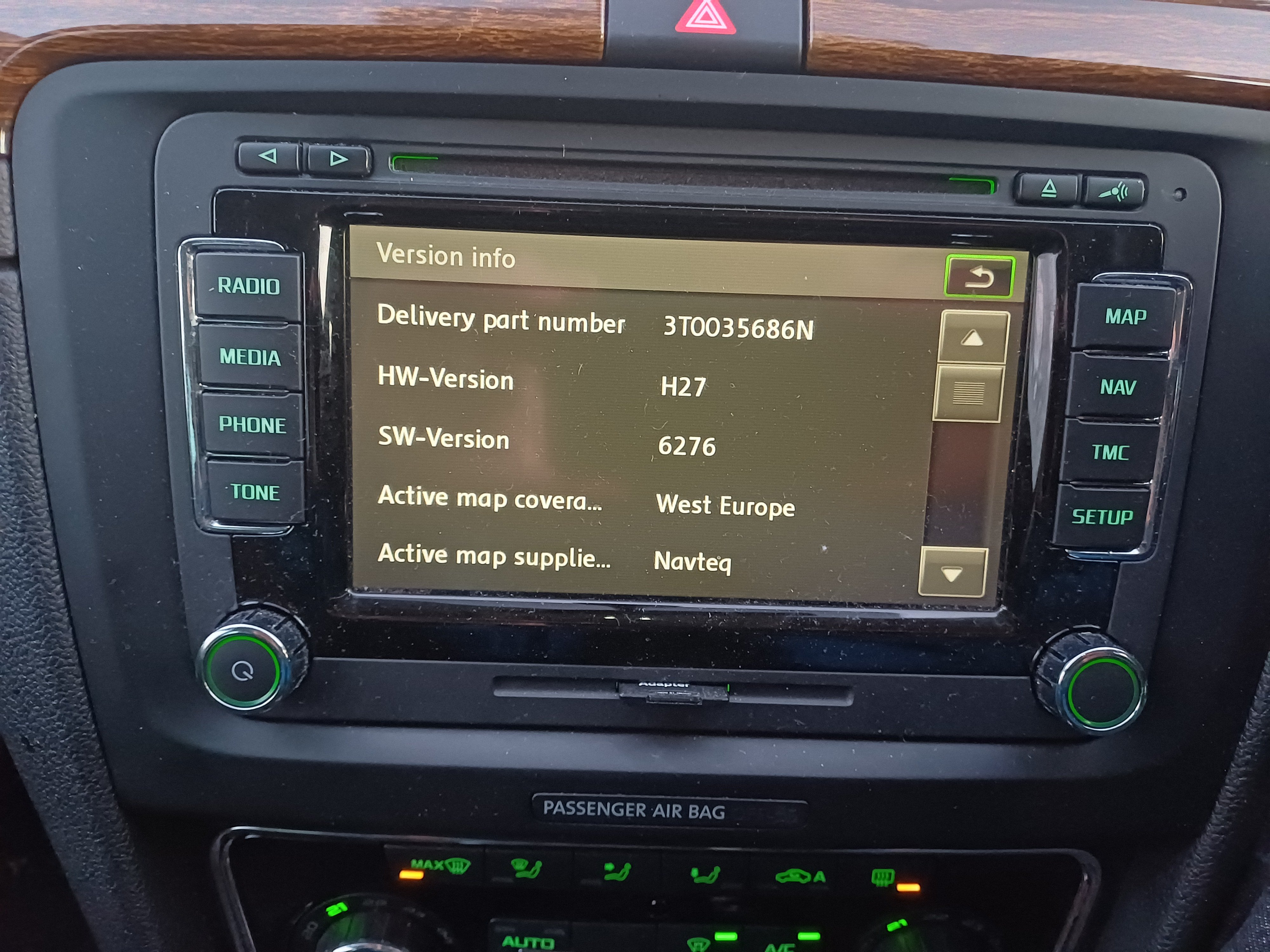

unfortunately I don't know anything about the fixes in this version, photo found on the web

How did you manage to find this photo?

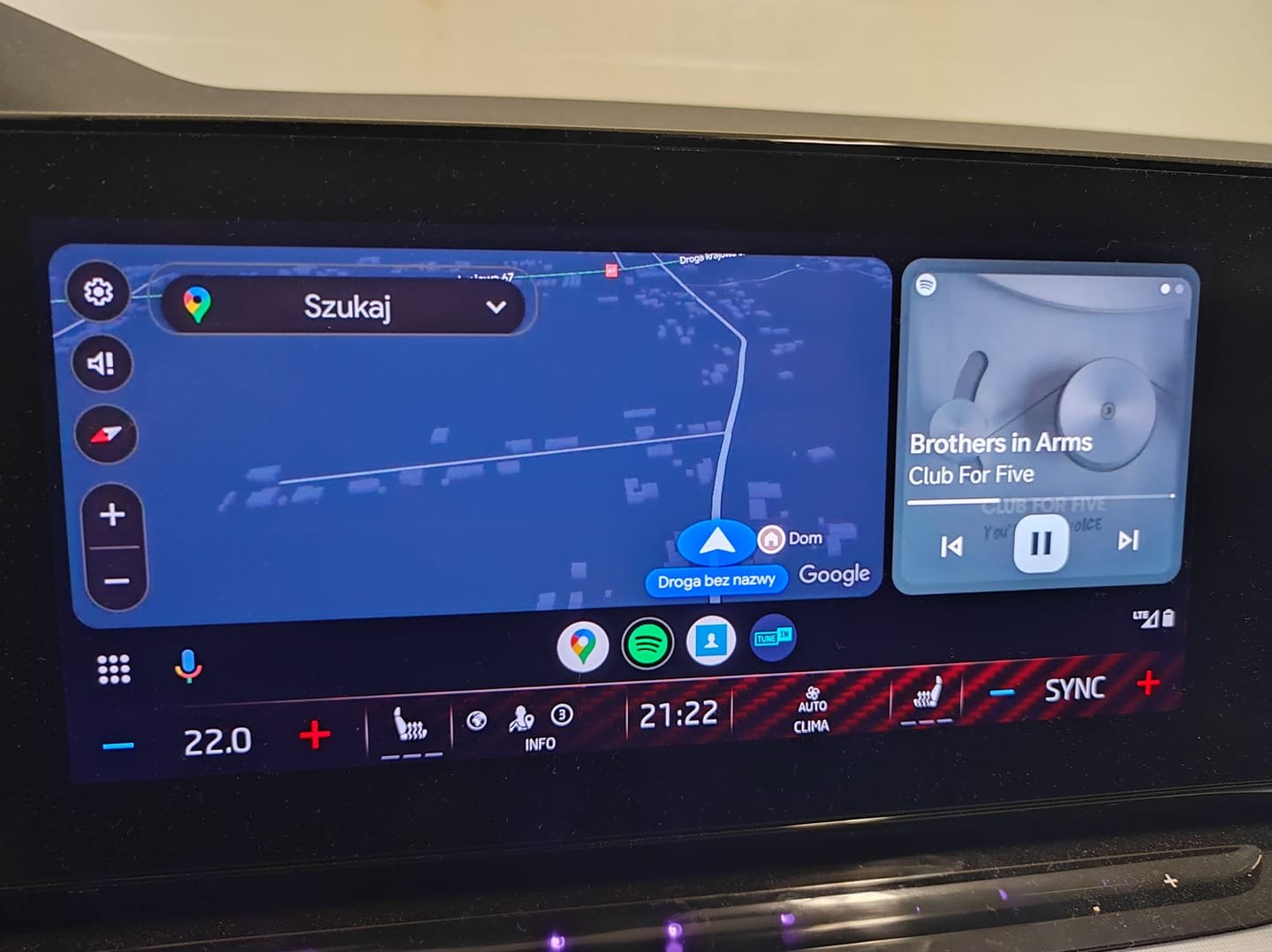

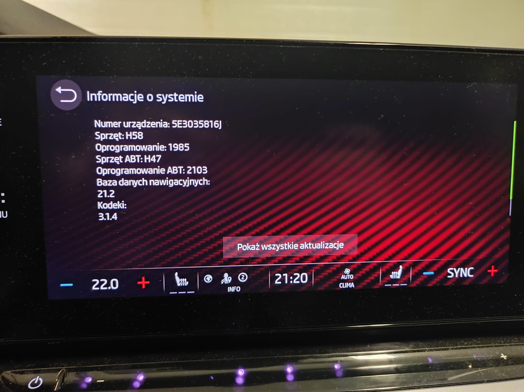

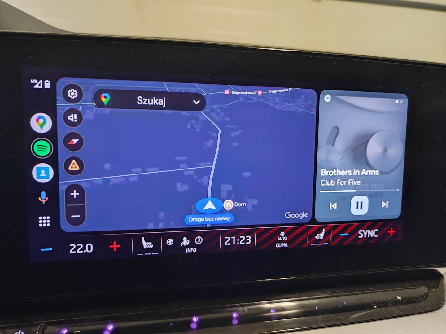

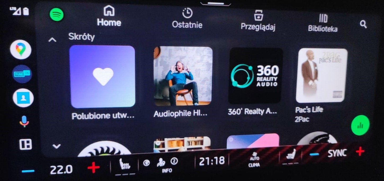

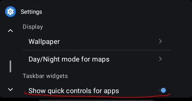

1985 works fine ;)
1. Spotify can be displayed in full screen]
2. "show quick controls for apps" works fine now for AA [AA not as widget]
Edited by jacekben76

8 hours ago, jacekben76 said:
1985 works fine ;)
What you’re showing here are Android Auto specific features. This has nothing to do with your infotainment’s software version.
Yes, I know, it's an AA option. But before installing this version it didn't work for me. Only when AA was added to the home screen as a widget, but then the screen was reduced.

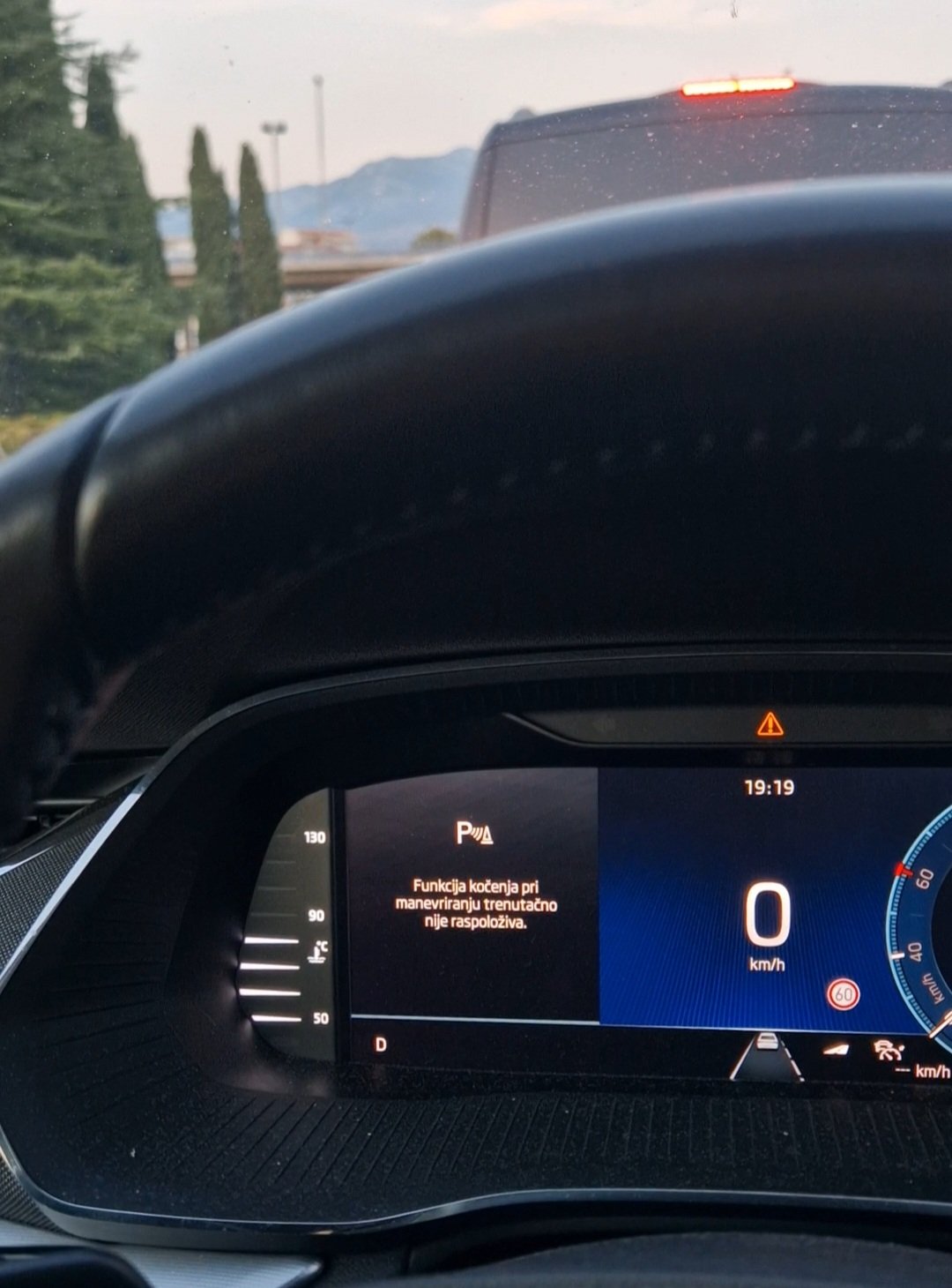

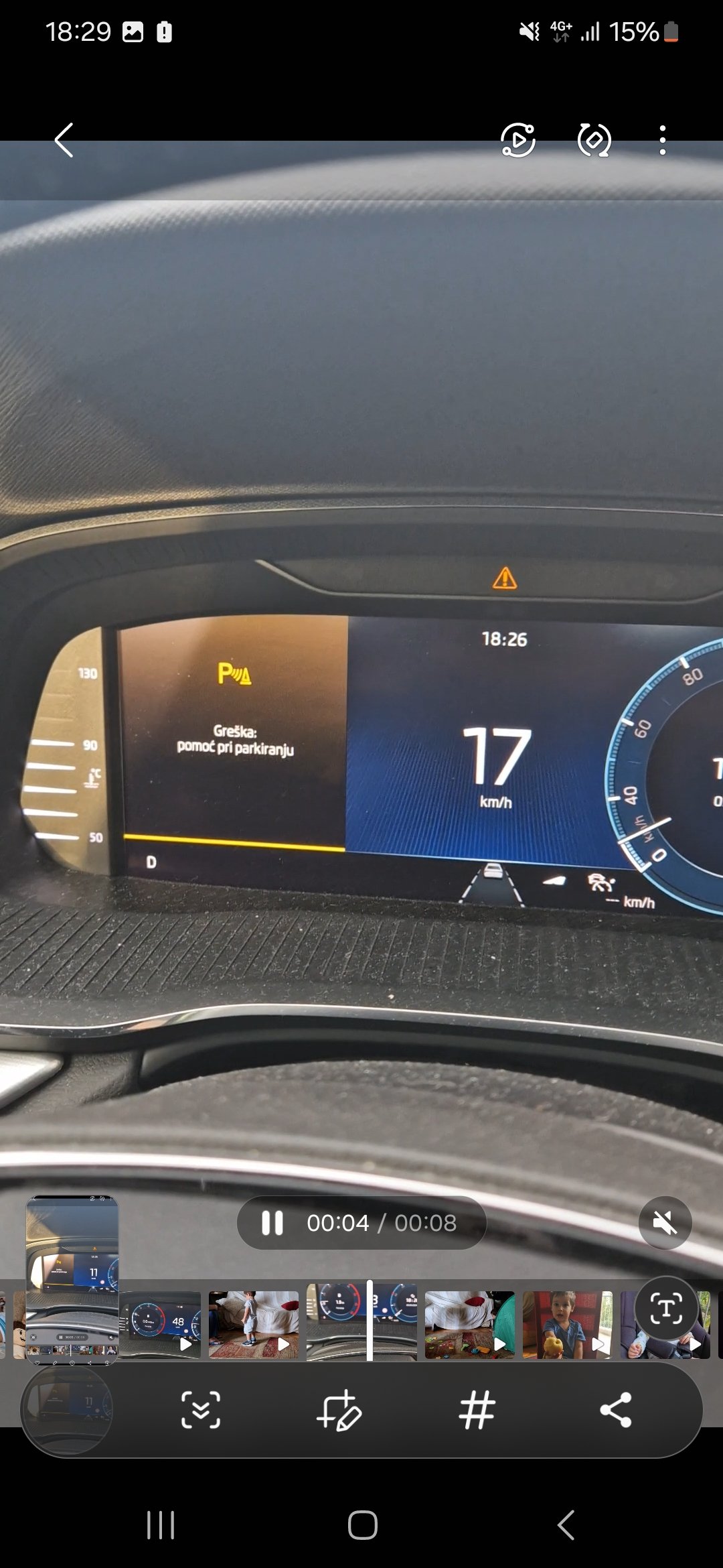

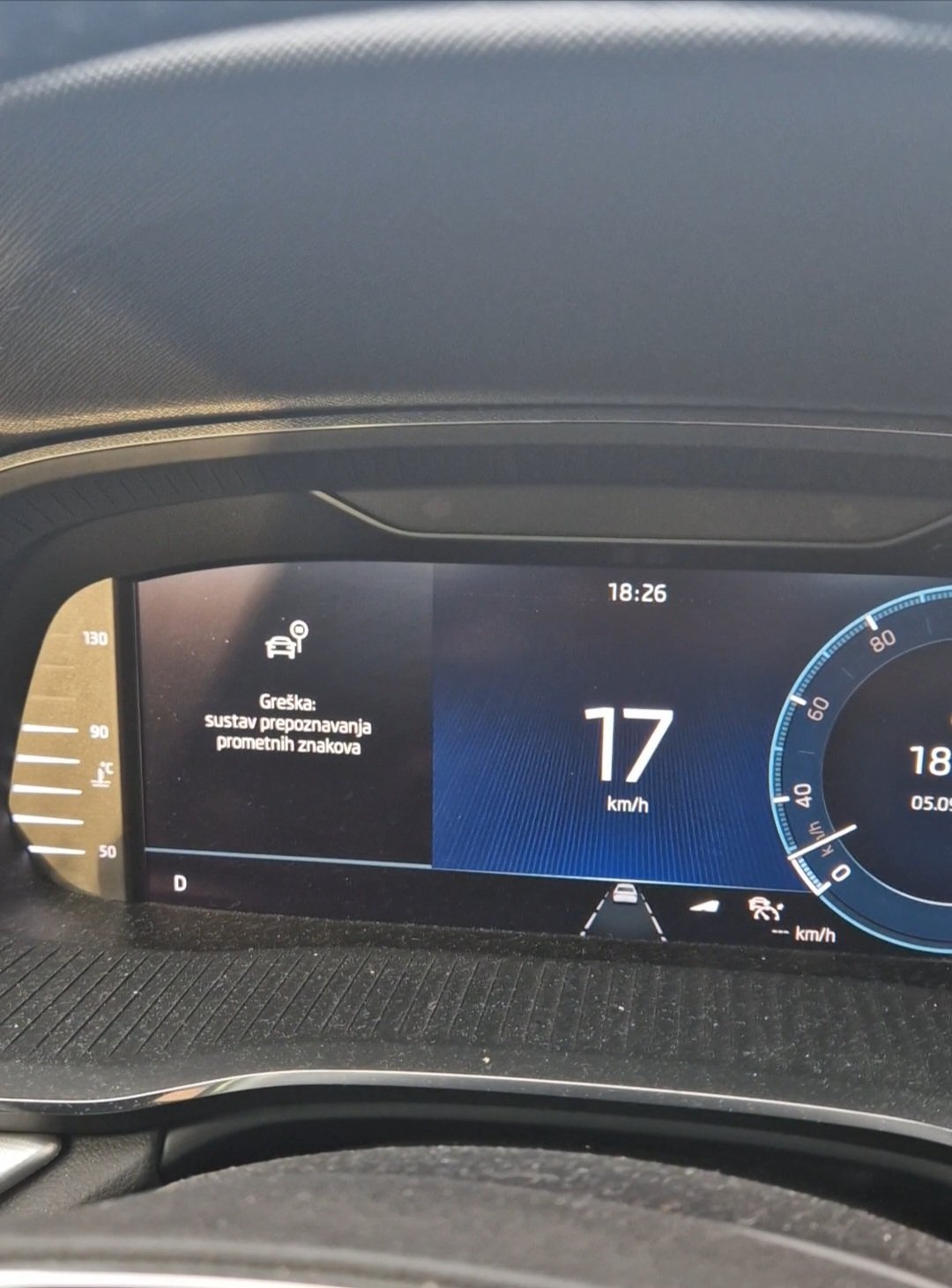

Skoda octavia IV first edition 2020 2.0 tdi dsg
 screen resets, traffic sign recognition error reporting, parking function not available, braking in maneuver not available while driving
2 times updated software (current 1941)
Replaced the control unit
The same errors still occur
The next recommendation is to replace the complete control unit electronices - a repair of €5,000
Has anyone had a similar problem and managed to solve it?
second owner

Can you post which version, of screen you have?
I have updated version from skoda dealer in Slovenia to 1969.
Also screen replacment than solved all issues.

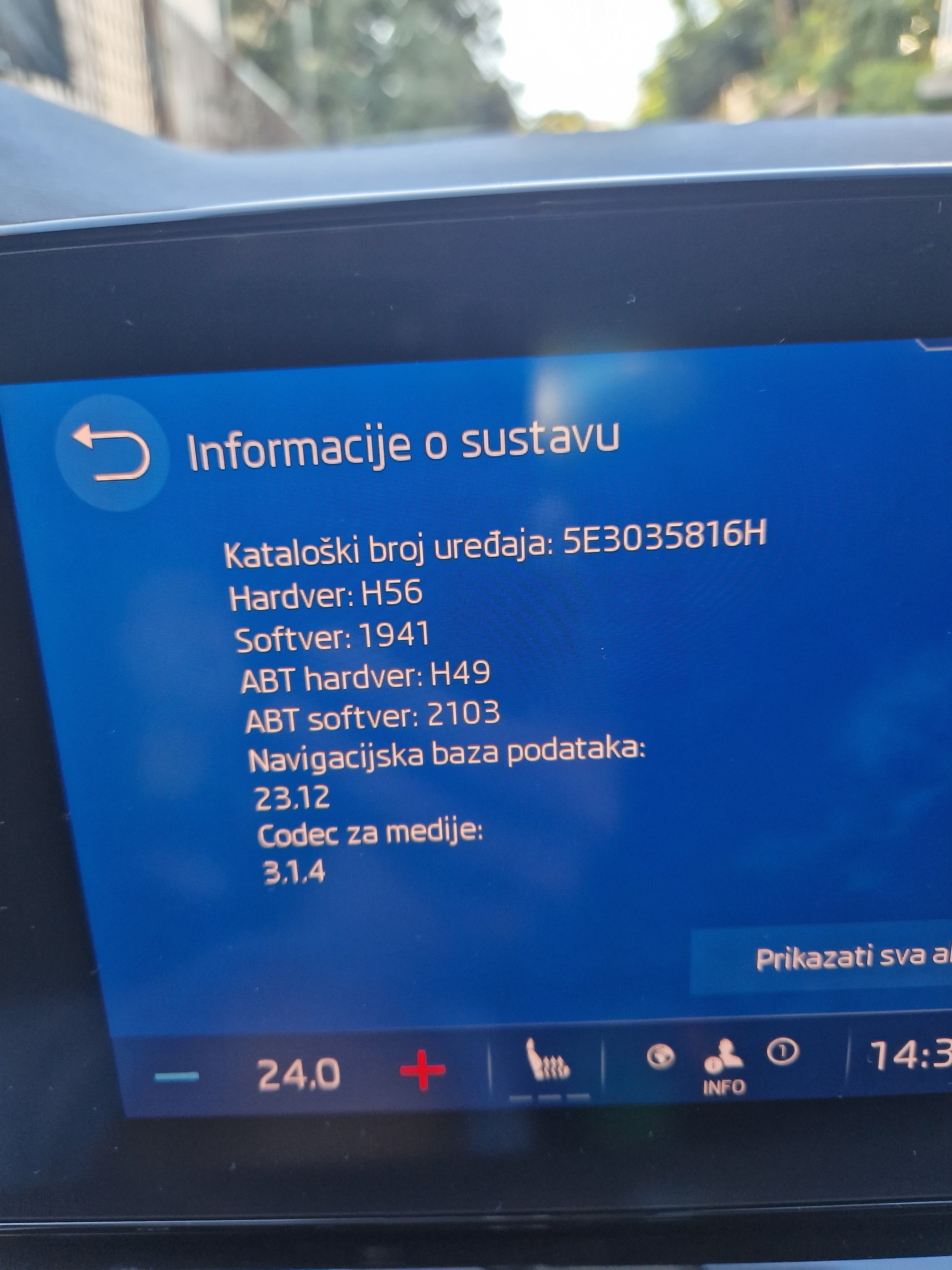

where can I find which version of the screen is built in... I have a receipt that says 5E3919605 CZH but I'm not sure if that's it
Go to settings and find informations about software and hardware information.
I dont know exactly which options is but i know its more on botton.

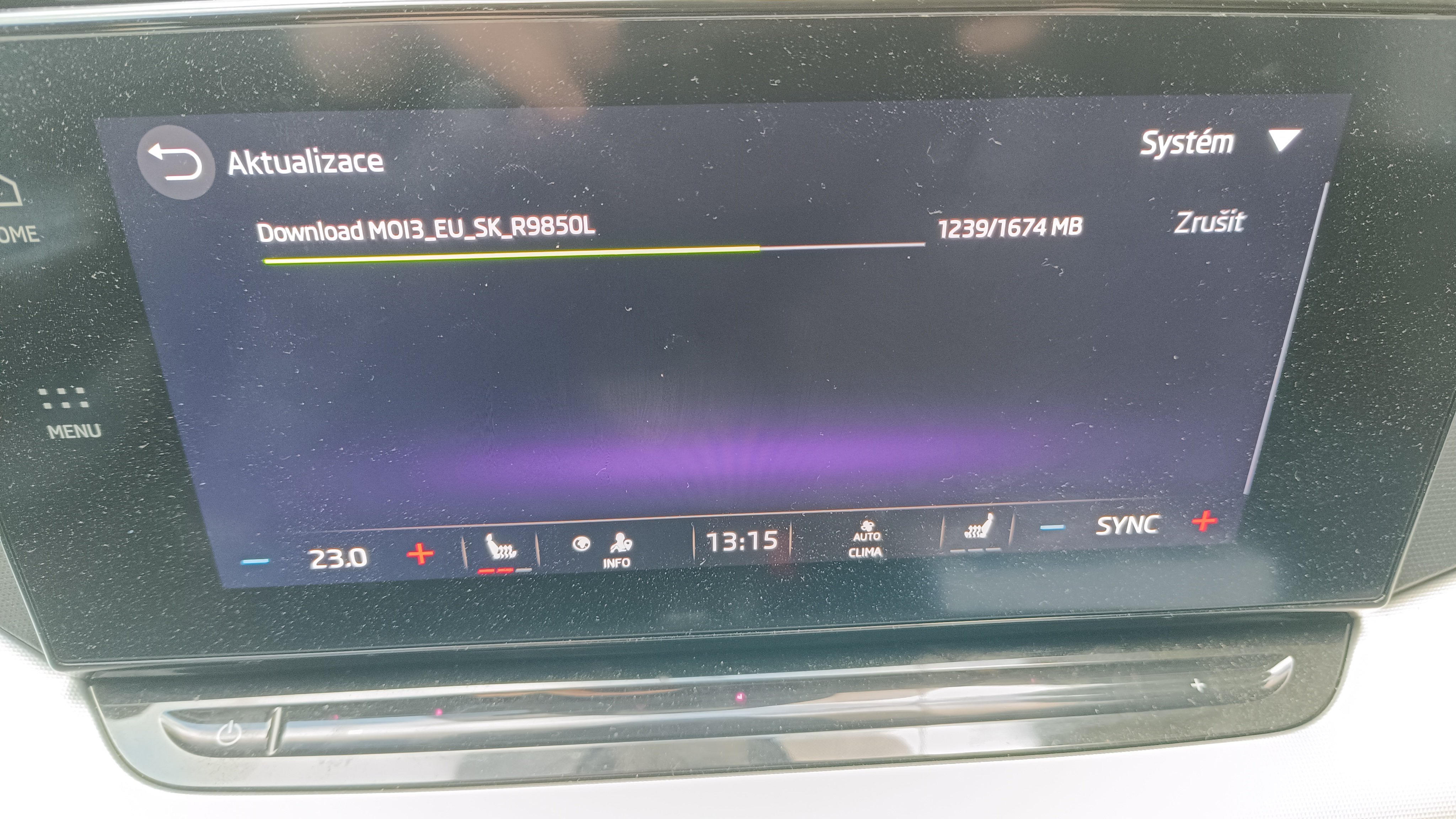

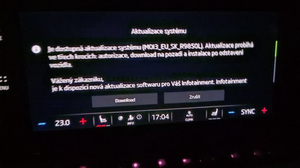

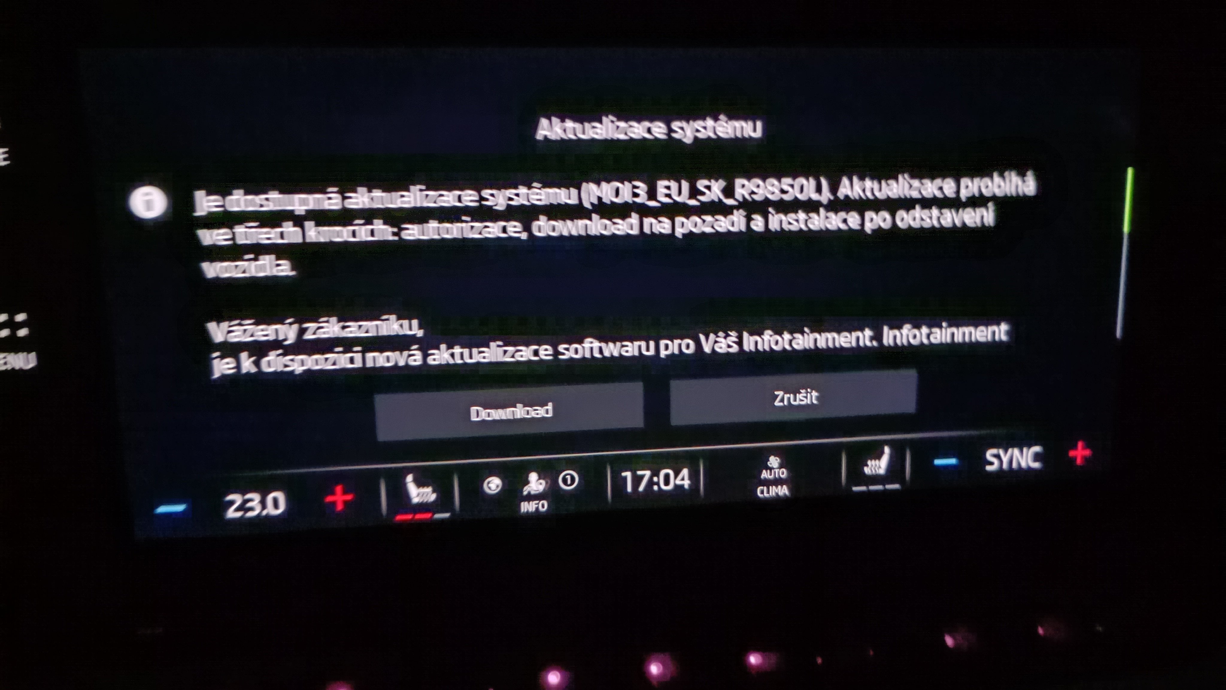

Hi,
The new firmware version 1985 has started to be distributed via OTA (Czech Republic).
My current version is 1941, but last evening I received a notification to update to version 9850L.
Of course, I accepted it, but nothing happened. Today, the System Update check shows that the download is still in progress.
Please see the attached photos from last night and this morning.
WiZi
Edited by WiziPok
Yep, that's what I got earlier albeit the English version of it, so I don't know whether it'll continue to download it overnight or not. The mobile signal where I am isn't great, so it may take quite a few days to achieve a full download.
The download only happens while the car is running. So if you do short trips, it may take a while to download it.
Hi, thank you for your quick reply.
During the drive the download progress was displayed on the screen. Surprisingly, the download started and finished while driving. However, to complete the update, the car needed to be parked with the engine turned off. After about 20 minutes, the update was successfully installed.
One immediately noticeable change is that the application windows can no longer be easily swapped. The navigation is now fixed on the driver's side, and its position cannot be changed by simply clicking on the second window.
Do you have a list of changes included in this 19850 version of the firmware?
Thank you in advance!
