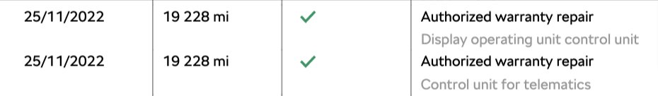

Signed up for a free trial of Skoda Connect and D/L'd a copy of my digital certificate, made for interesting reading (see attached)
Could it be the Octavia I've bought has already had it's telematics done and unit replaced? 🤔
I would say that’s a pretty positive indication, I believe Skoda initially did replace Telematic units on earlier models but eventually developed a module firmware fix to solve issues.  If the car software works glitch free then all well and good.  Might be good to get the infotainment software up to 1941 or 1969 but, again, if you aren’t getting any issues then no hurry for that either.
