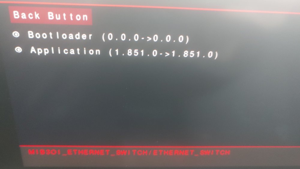

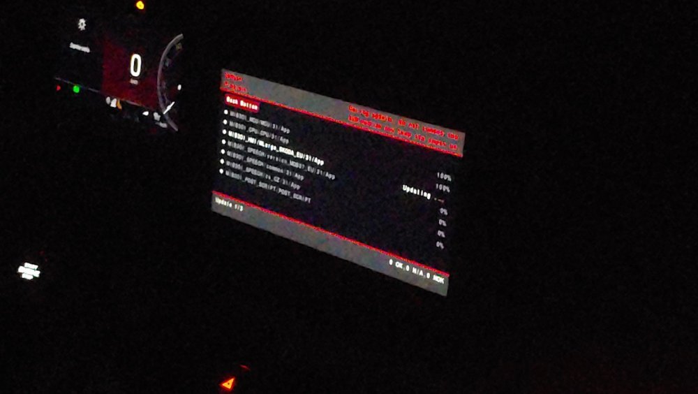

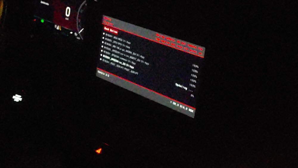

Hello, Multimedia in the loop, and screen not working after using MOI3_RECOV_R9900L_5FA919360AS
How to force it to take this "5FMIBOIRECOVER" from USB
Also 5F have following error )
Event code SAE code Event text Active
01010 [4112] B18C8F5 HDCP authentication error, Signature on LVDS 1, display unit 1 connection

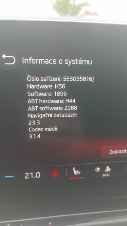

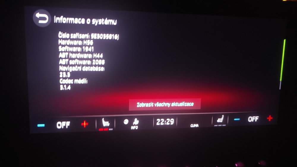

Hello guys,
I am a new owner of used Skoda Octavia Mk4 from 2020 (yet outside of warranty). Couple days ago it started with crash loop with MIB3...it happened from time to time as info from previous owner, but now this is constant!
I wonder if someone has update to send me and what version would you recommend...I want to install on my own if you advice it is safe to do so and try to resolve this frustrating issue with keeping money in pocket...hopefully not end up with a new display unit....
Here are details...
Thanks in advance!

Hi Joma,
I got mine up from 1889 to 1941 and already for 1 month works splendid.
Unfortunately, I cannot send you a Personal message, because I am the new user.
Kind regards,

Anyway, thank you for your respond and good intention! Hopefully someone "experienced" on this forum will reply...
I did a read a lot this topic, but all links I've managed to open were dead...
