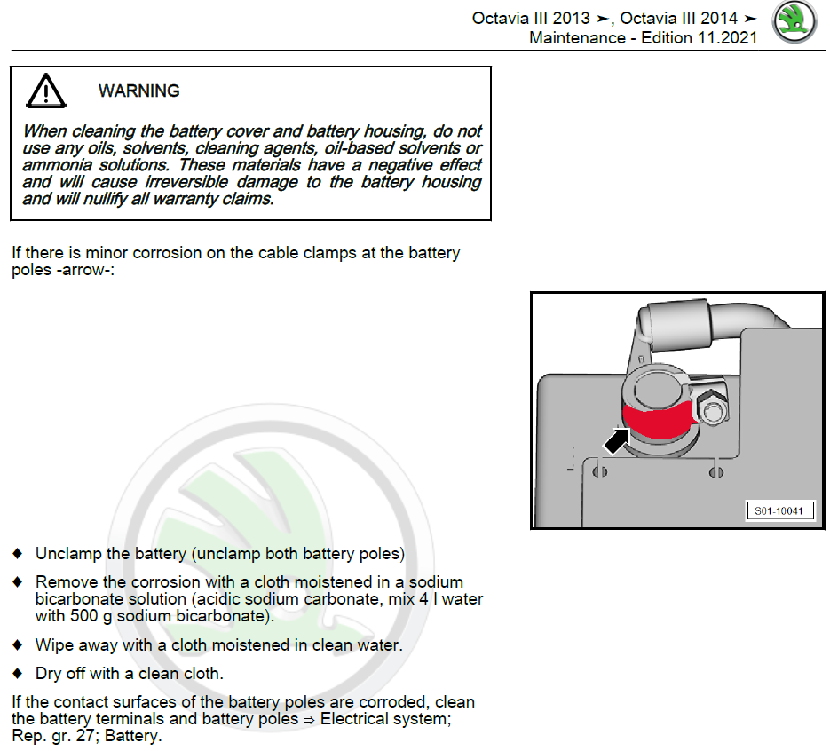

You may need to clean up your terminals, again can recommend in a bit.

The cleaning process here for your terminal(s) as they seem crusty.
