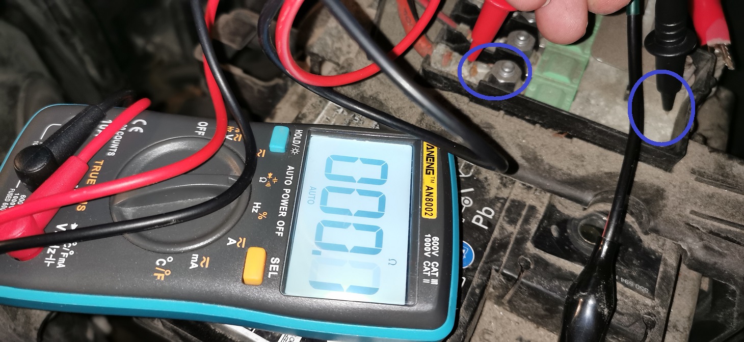

First check would be the battery terminals are clean and tight.
Second would be worth a quick continuity check of the main fuse links connected on top of the battery

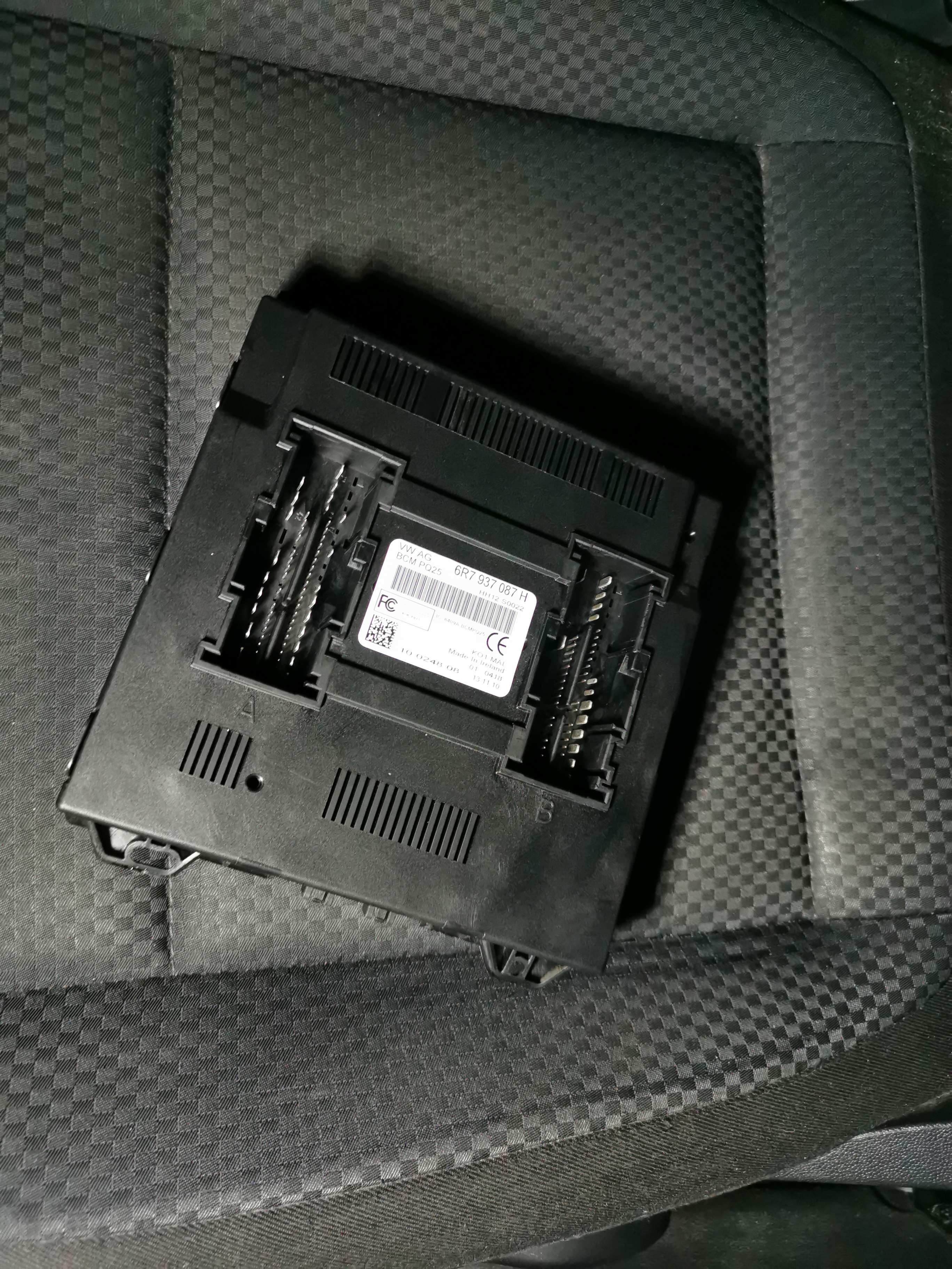

If both of those are good........ then it sounds like possible water ingress to the BCM under the dash................thats what controls pretty much everything and for you to loose all those electrical items,
it must be related, it's located up behind the interior fusebox on the drivers side by your knees, hence putting a heater there fixes it.
Thank you for your advice. I also suspected a loose connection to the BCM. I started with the easy part, removed the earth terminal from the car, and then removed the BCM, by releasing two connectors, and after released the BCM, and it slided down.
It looks really really clean, and no surprises there, since it's never parked outside in rain.

Next to test is to see if the plus battery terminal is clean as per your suggestion, and also measure continuity of the (big) fuses on the battery. The 5amp fuse looked fine, tested previously.

I have now measured Continuity, at all 6 Fuses, (one did not have a cable), all showd 0.1 (measurement error from my multimeter, it never show zero).

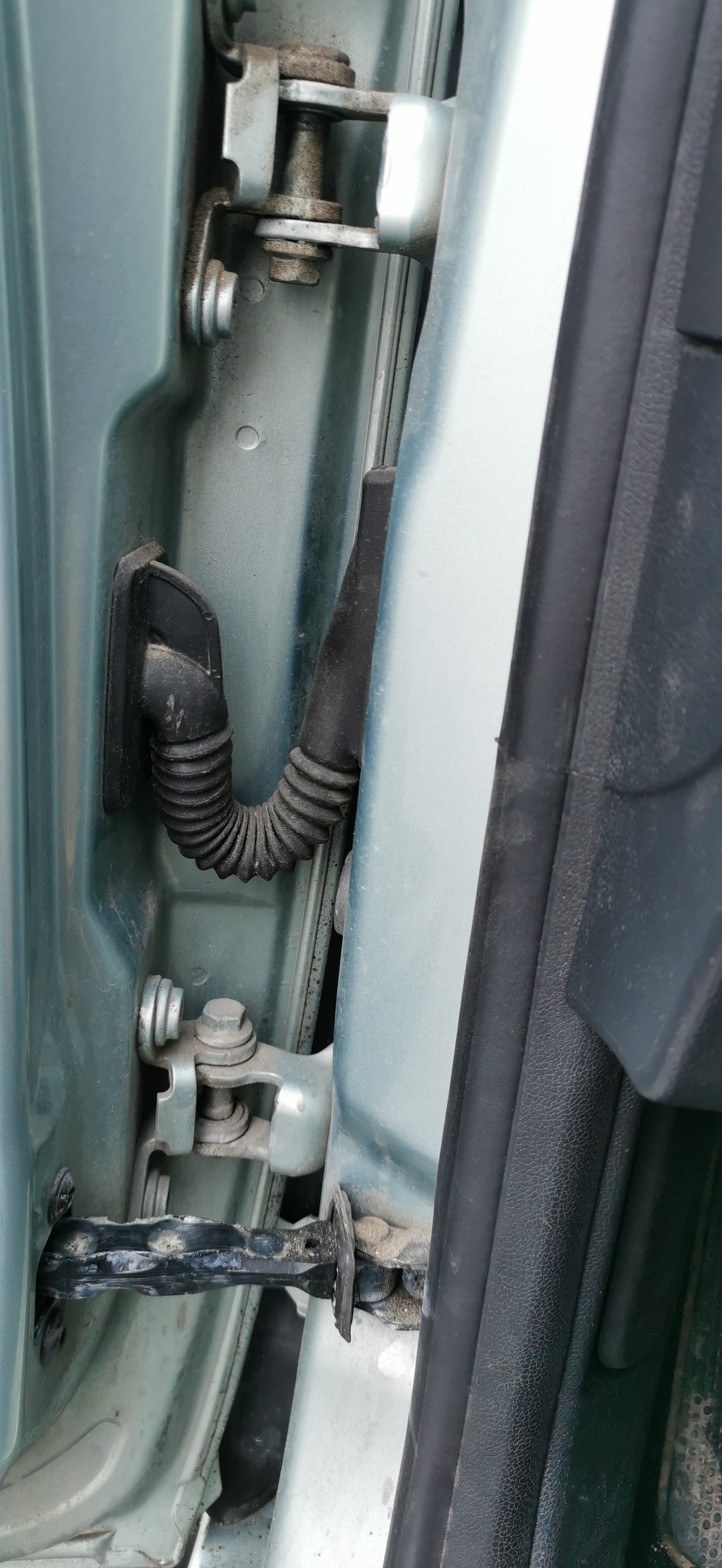

Ok, so next port of call for me is to check the door loom between the drivers door and the A pillar has no broken wires ( in the rubber bellows)
This a common break point on the Fabia 2 and although you have what I would call "excess" symptoms, they are all related to potentially when the car is "woke up" which is when the BCM "should" get both a remote unlock and "wake up "signal, it's "possible" that one or more broken wires is causing spurious messages / short to grounds or both, who knows how that BCM is wired on the inside, the clicking relay and flashing light points to something either failing in the BCM OR it's getting mixed messages..............overall DEF worth a look at the door loom in my opinion, if not to just rule it out.

 😞, good idea, I will try checking it next month, although I purchased the car 2020-Januari, from a private person (only owner).
On the way home I noticed that no WINDOWS could be opened, the side mirrors could not be adjusted, no heated mirrors, I called him and he probably lied and said he had not noticed. Saw at least one complete broken cable, and several on their way.
I bought a completely new lhd door loom and fitted it in Feb 2020. Everything startted to work after that.

The wires in the loom look OK, and as you can see i have fitted a custom made loom, since the old design was bad:-(

In your photo of the BCM on Thursday morning,  the connector pins don't appear to be very clean. I expect it is just the light/contrast/reflection of the picture, as you say in words that 'it looks really really clean'.
Do have any other photos that maybe show connector pins more closely?

That photo was taken in a semidark garage and fast:-).
Mayby I should use electronic cleaner before I mount it again 🙂
Visually it looked clean, no corrosion nor grease on the contacts 🙂

I have today cleaned every single pin in the BCM, with a small cloth and 99.8%Iso propanol. (they seemed sturdy, and not wiggly).
It's now in a "oven" at 37 degrees Celsius, so it will dry completely.
