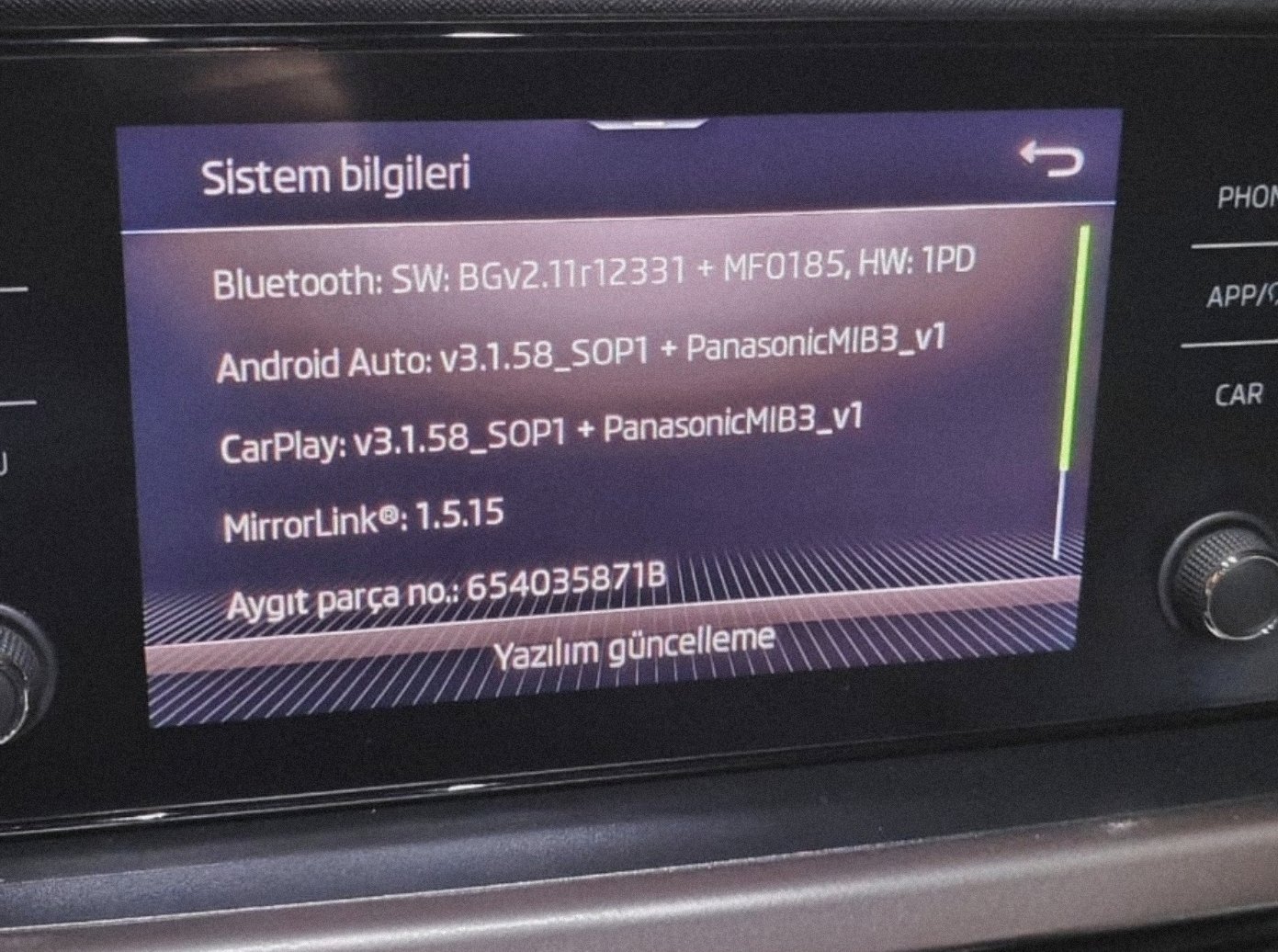

  • There are these updates, but not sure if the higher number will apply to your system.   MEN3_EU_SK370_P0113P_0469 MEN3_EU_SK370_P2135P_0742   MEN3_EU_SK370_P1185L_1760 ME
@varooom @Rainesh do you have this version - 469, MEN3_EU_SK370_P0113P? thanks

I couldn't understand you. I need the 469 version file. Did you mean there is a hardware obstacle?
no
you need 469 because you cannot update directly to 741+742
then 741+742, as this is the latest sw available for this unit.
