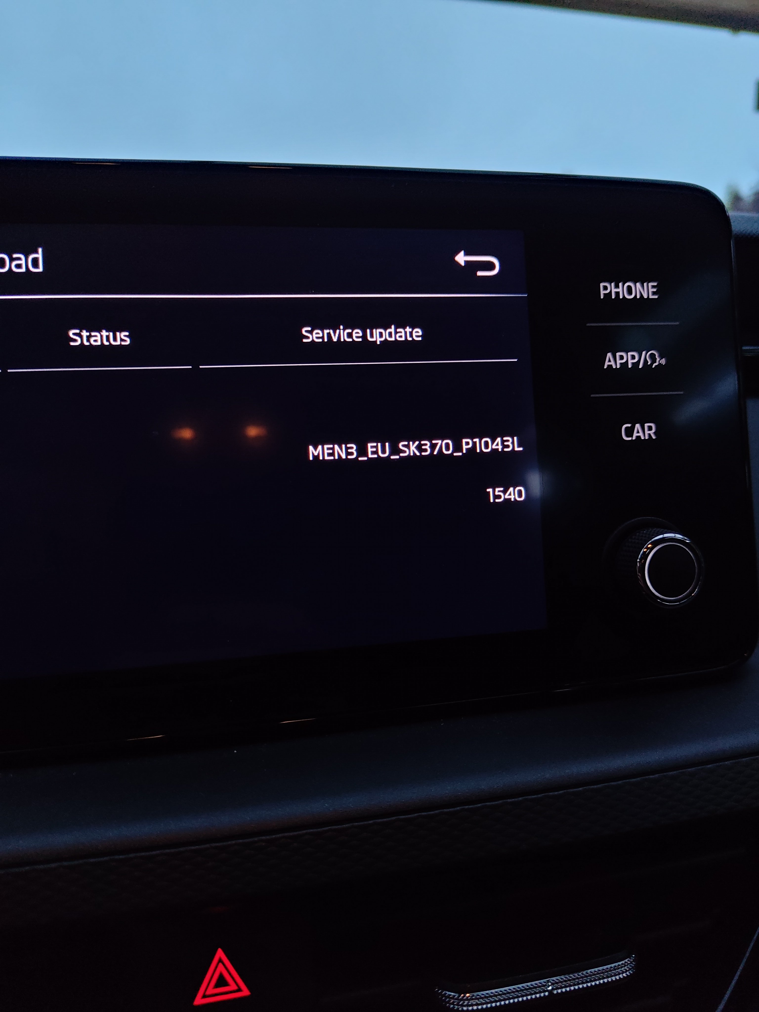

On 30/05/2024 at 21:09, Madols said:
Hi guys and @andreiro221 @Rainesh
I am driving a Skoda Scala 2021 1.5 TSI.
I currently have MEN3_EU_SK370_P1043L, MU 1540.
Can I go directly to MEN3_EU_SK370_P3355L, MU 1800?
 Or do I need to go through MEN3_EU_SK370_P1185L, MU 1760, first?
Hi guys, an update from me with the almost "unknown" 1540 software variant.
I updated the radio and went through MEN3_EU_SK370_P1185L, MU 1540 -> MEN3_EU_SK370_P3225L, MU 1798-> MEN3_EU_SK370_P3355L, MU 1800.
Everything worked just fine, even though I am not sure that I needed to do the 1798 update to get the 1800 up and running.
It was, however, a bit fiddly getting the error code out afterwards, but I managed by calculating and getting a 5 digit XOR code in the OBD; then it worked.
Thank you for all of your help in this thread!

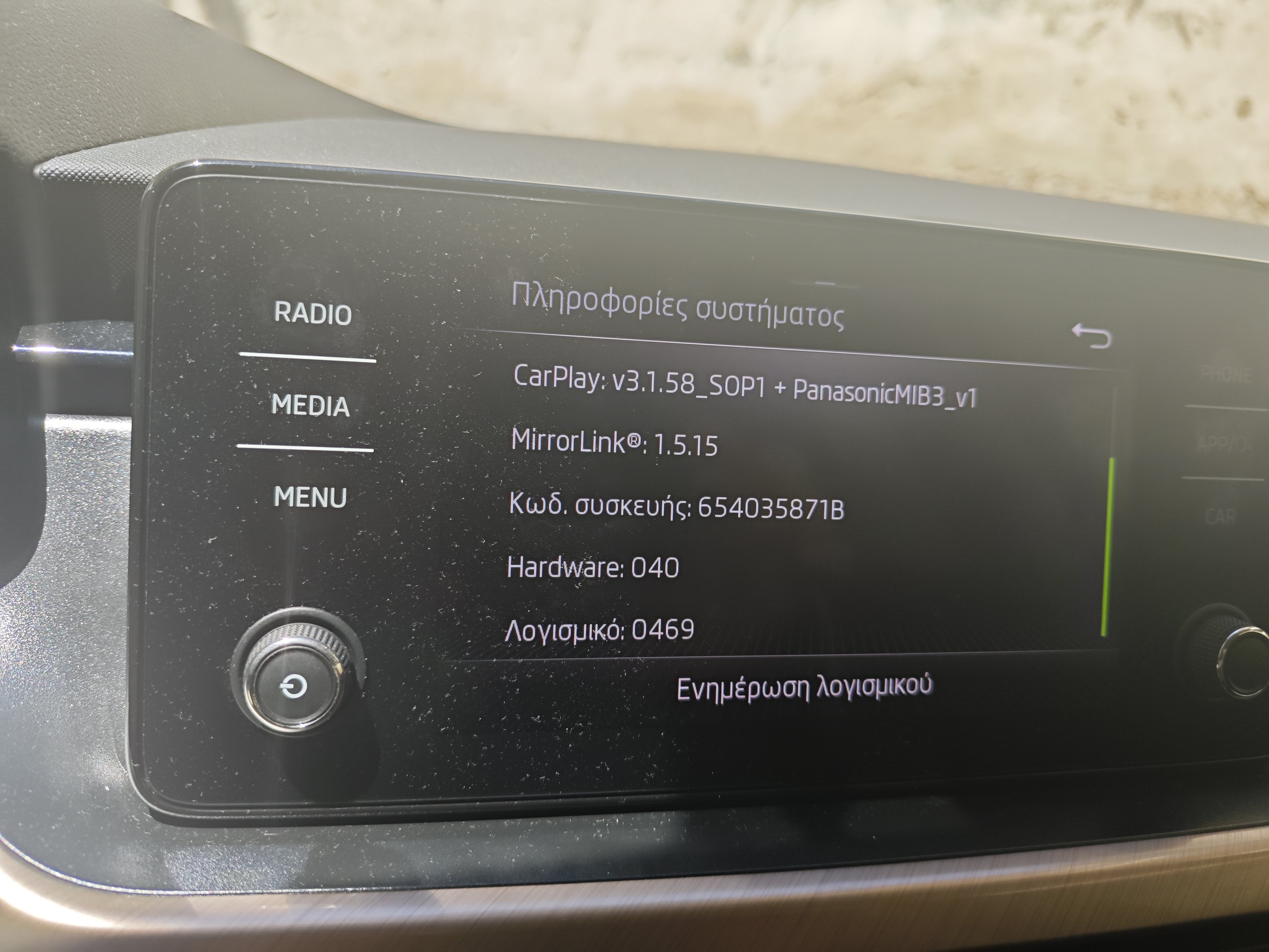

Hello,
I just bought an android phone with Android 14 and its impossible to connect Android Auto with my scala.
I have try more than 7 cables and still nothing.
Will a update solve this problem? Here its the software update i got now. I think the 0469 it's old.
58 minutes ago, GiannisTs said:
Hello,
On 11/05/2024 at 11:49, andreiro221 said:
no, if you have 469, 742, there is no OFFICIAL update to 17xx/1800
only at your own risk

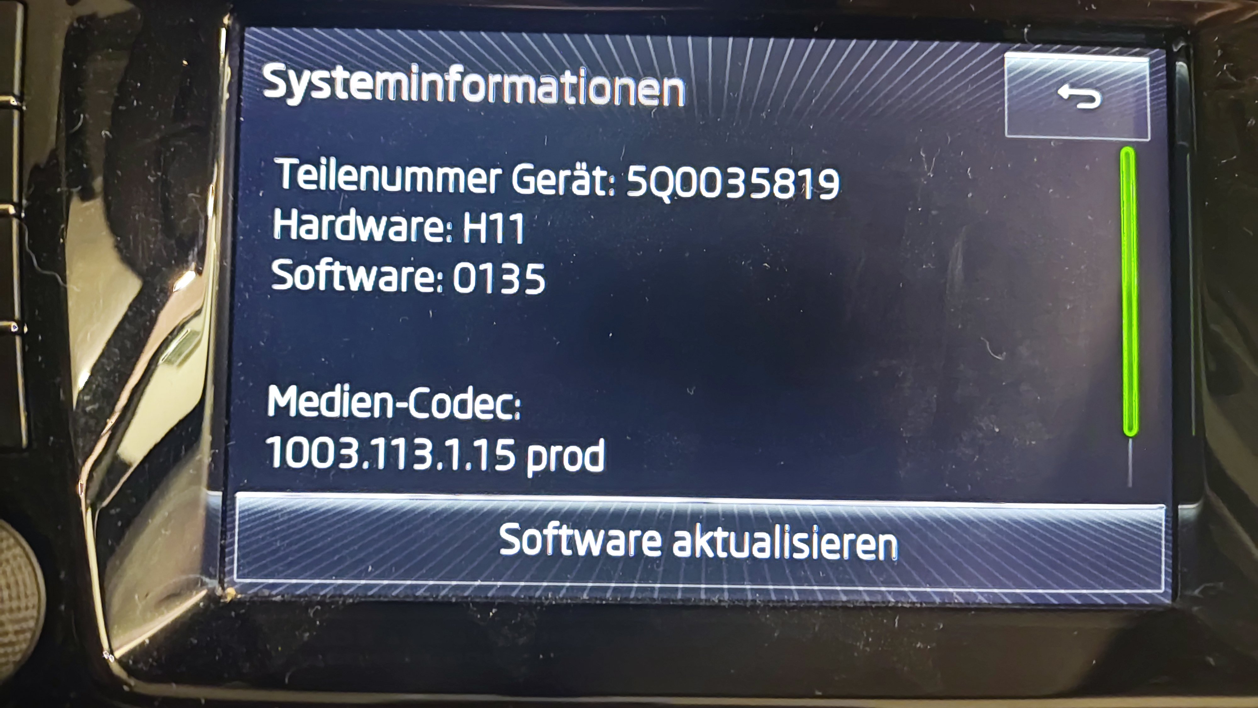

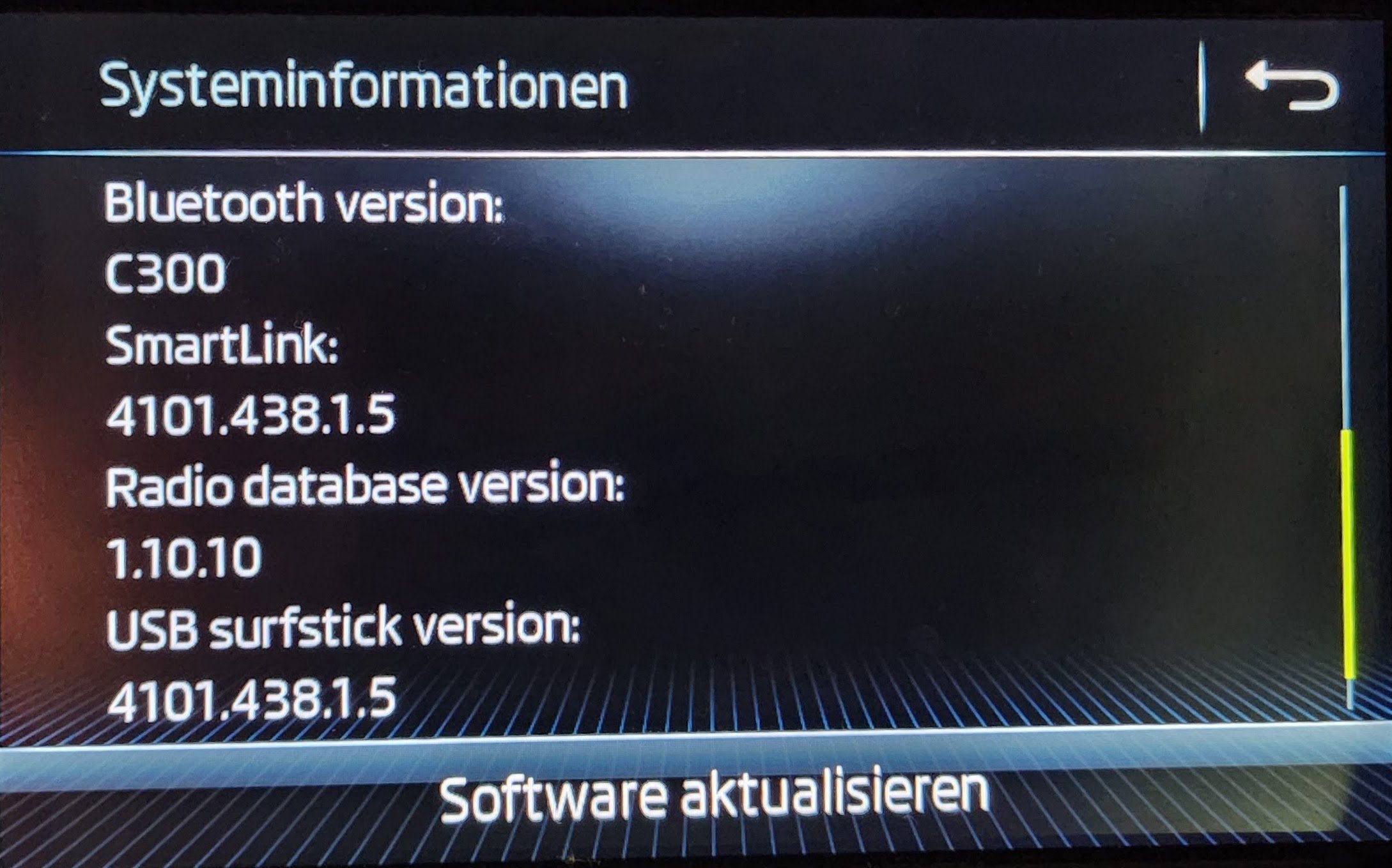

Hi Giannis, It looks like the only upgrade path is to the 0471+0472 (0471 is apparently only a partial software). Otherwise, search through this thread to find out where to get files and how to flash them.

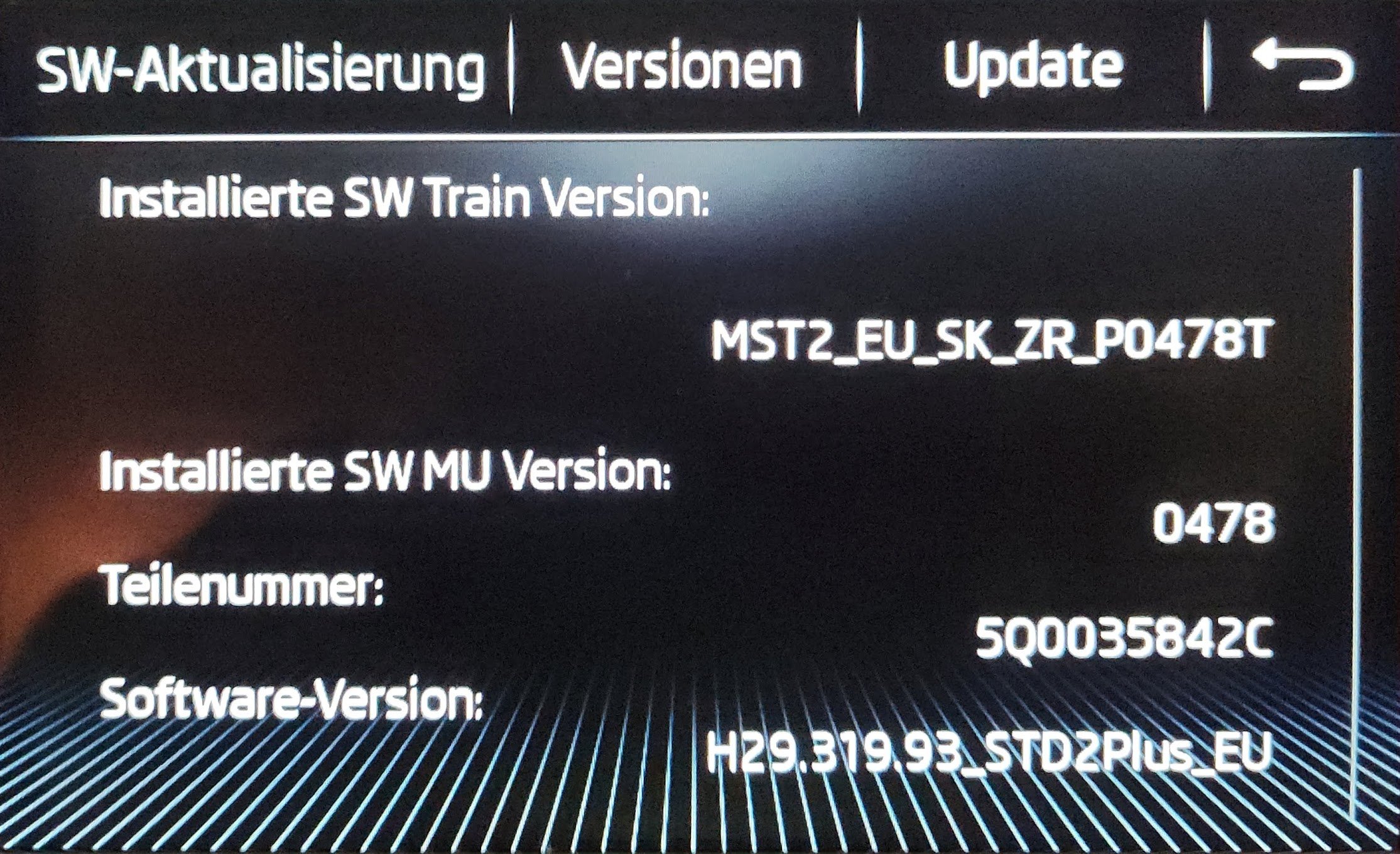

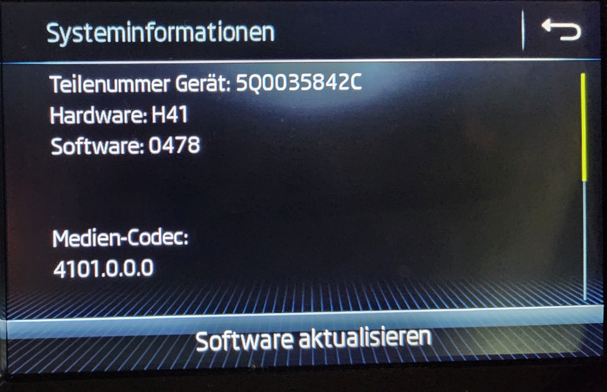

Hey, this is my first post here.
Since switching phones I have constant issues with android Auto, no matter which cable I use.
So, perhaps updating will help?
The car is a 2017 fabia III Combi (CHZC),  the relevant PR-number I found were I8E and RAF (Bolero).
the info in the car says Part Number: 5Q0045842C; Hardware: H41; Software: 0478
See also screenshots.
Is there a way I can update this myself?  The local skoda partner will mnost liekly charge a fortune.
BTW: there is no way to get this radio work with wireless AA, right?
Typo in the Part, its 5Q0035842C.
And I found the SW Train Version: MST2_EU_SK_ZR_P0478T / H29.319.93_STD2Plus_EU
Looks like you can update to MST2_EU_SK_ZR_P0480T - it can be found here: https://mibsolution.one/#/1/9/MST2 - TechniSat Preh/Firmware/SKODA_ZR/EU
Please read back the other pages for a guide on how to flash the software.
On 18/06/2024 at 14:20, GiannisTs said:
Hello,
Hi Giannis, this guy says you can go from 0469 -> 0742 -> 1798 -> 1800.
I haven't tried it myself, so it will be at your own risk (as always) https://www.drive2.ru/l/650934799095051499/

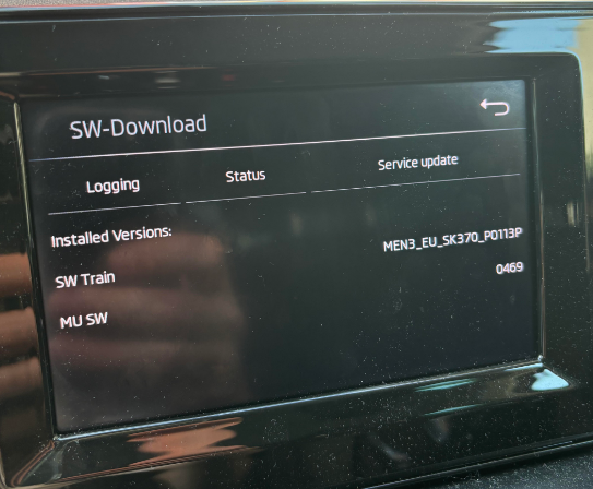

On 15.03.2023 at 16:32, varooom said:
Bu güncellemeler var, ancak daha yüksek sayının sisteminiz için geçerli olup olmayacağından emin değilim.
ERKEK3_AB_SK370_P0113P_0469
MEN3_AB_SK370_P2135P_0742
MEN3_AB_SK370_P1185L_1760
MEN3_AB_SK370_P2345L_1790
Denemek için önerebileceğim tek şey 0742 (uyumlu değilse yüklenmez)
Eğer yüklenmezse, o zaman 0469 sizin güncel sürümünüzdür ve satırın sonudur.

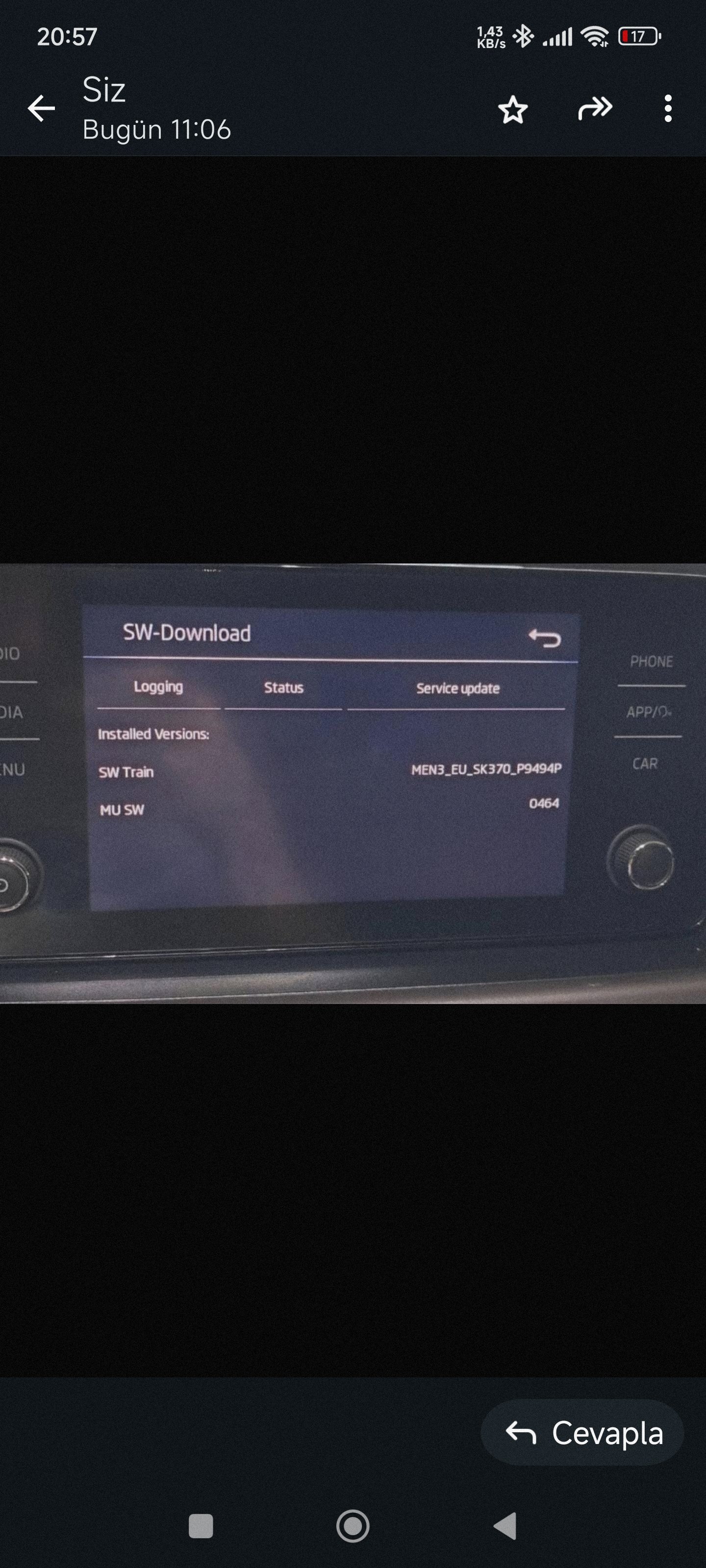

Hello, where can I get the file to switch from 0464 to 0469 in my current version? I think P0113P I need this upgrade file. The attached file is my current version.
On 05/07/2024 at 21:45, RaydenRO said:
multumesc, unitatea merge bine cand vrea ea..sunt momente in care se blocheaza..nu se mai aprinde si implicit nu mai merge partea de comunicare cu serviciul de urgenta...am fost la service, iar cei de acolo mi-au zis ca e boala lor, asta si cu amortizoarele fata, care troncane la fiecare denivelare/panta...dar care sunt in parametrii (cf testerului de amortizoare)
poti face update la 469 >741+742
dar trebuie si tester capabil sa ruleze functia de Replace pt unitatea media.
trebuie vazut si erorile legate de OCU, cel mai adesea trebuie inlocuita antena din unitatea de OCU, daca ai eroarea B200049 in unitatea OCU
also 469 > 741+742
but you also need diagnosis to run Replace function for the media unit.
Edited by andreiro221
