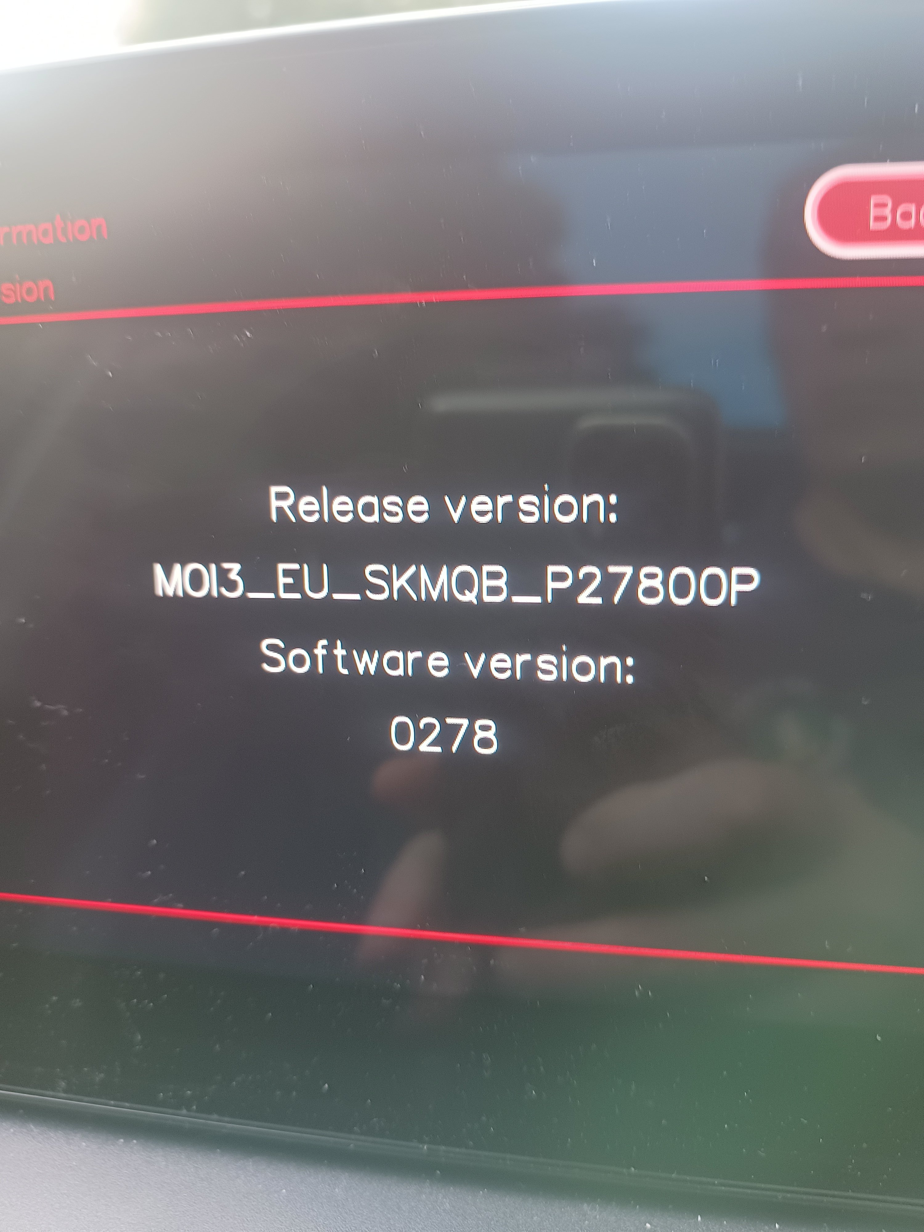

How do I establish what version of s/w I have on my 2019 Scala SE L TSI please.
TIA.
Hold in on the Menu button for 3-5 seconds - then you'll get the page saying Software update. There you'll see it

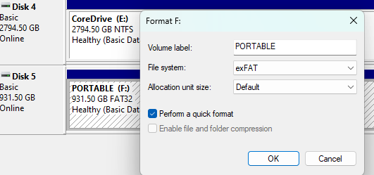

Wanted to take this opportunity to give a big shoutout to :emoticon-0157-sun: @varooom & @Rainesh for all the above and beyond assistance provided in this thread. I recently purchased a Skoda on a 22 plate which wasn't compatible with my Samung s23 Ultra when using Android Auto.
Based on the information kindly shared in this thread, I took the challenge and upgraded from SW train 1760 to 1800. My Samsung S23 Ultra is connected immediately after upgrading with Android Auto :handshake:.  Very happy with the outcome... I did connect the battery to a charger, too as I was paranoid of bricking my system :o
It took me a few attempts to prepare the USB drive so that the car could see the files on it, as I initially had the wrong folder structure.
If anyone is unclear, I copied the unzipped files from 'MEN3_EU_SK370_P3355L_1800.zip' to the drive (Important to note, this is the version for my SW Train)  with the folder structure (One main folder and two subfolders)
/MEN3_EU_SK370_P3355L_1800/Meta
/MEN3_EU_SK370_P3355L_1800/Data
To prepare the USB drive, plug into drive into a windows pc, open 'disk management' and format the USB drive with 'filesystem' 'exFat', and unzipped as above.
Thanks for all the helfpul comments..
