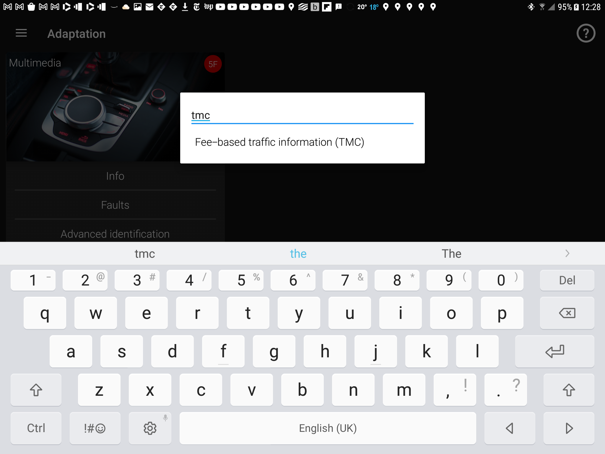

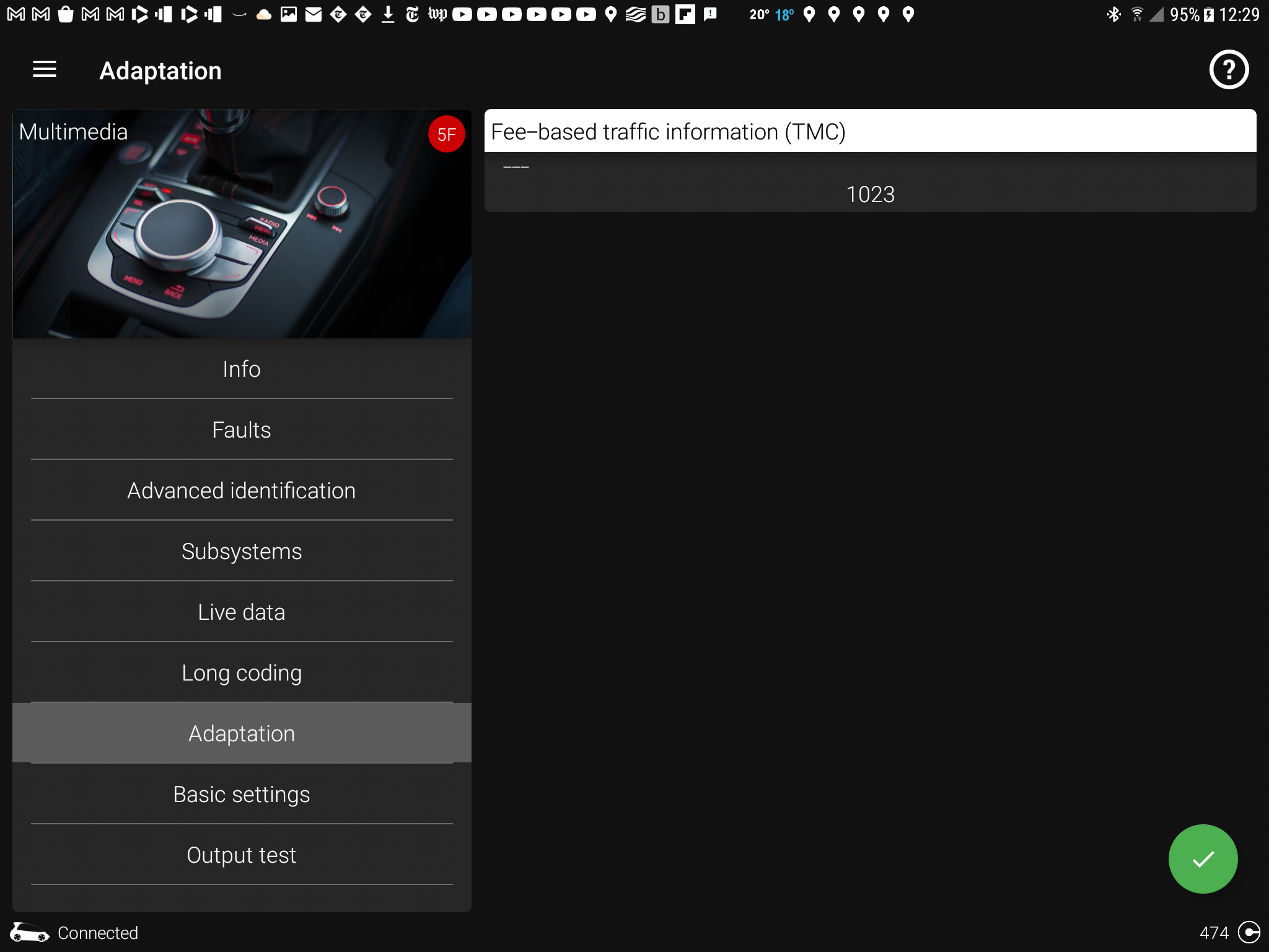

4. Check/configure FEE BASED TRAFFIC INFO is set to 1023 using VCDS/OBD11.
Give a big thank you to @bigade1 for working out the correct TMC config and doing the testing on his MIB2STD. 👏

The bit I'm not sure about is:4. Check/configure FEE BASED TRAFFIC INFO is set to 1023 using VCDS/OBD11.
I don't have access to VCSD/OBD11 so guess I'm still screwed?

Sets 3, 4, 7, 15 and 32783 have all been left using the now defunct TrafficMaster.
TL;DR:
If your current adaptation is set to 21 or 1023 you won’t need to do anything with VCDS.
If it’s set to 3, 4, 7, 15 or 32783, you’ll need to change it to 1023.

You definitely need to code 1023 into it. Was able to get the car backed out of the garage, obdeleven plugged in. Step 4 isn't really a check, it's you must do it. In obdeleven 5f module adaptations, search:
Change to give:
Reboot the unit to get it to take it.

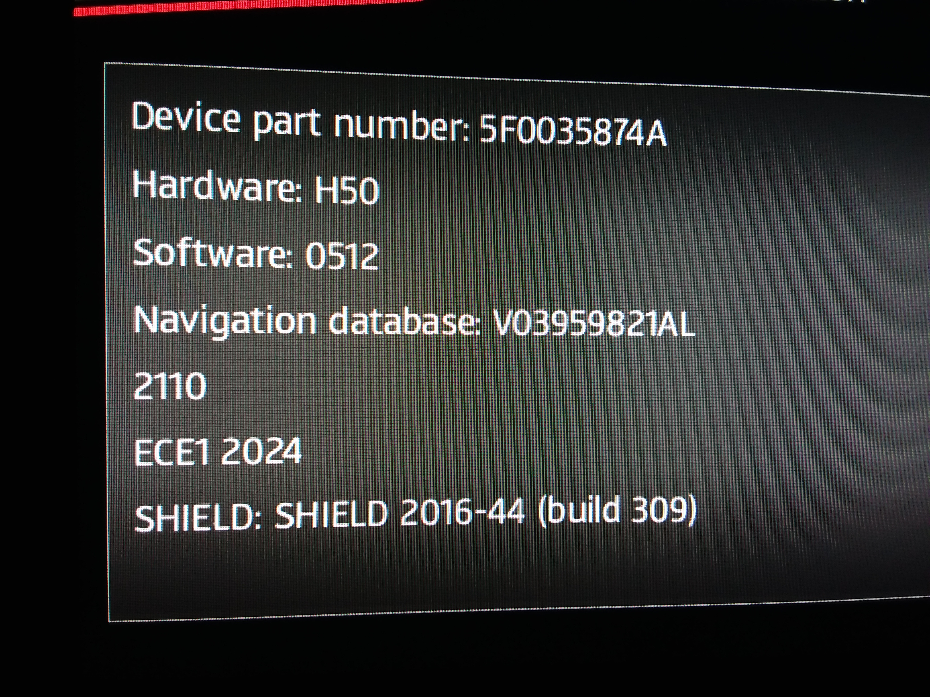

How up to date are those maps compared to the current ones on the VW portal.
The latest maps are V18
V18 dbinfo file:
ApplicationSoftwareVersionNumber="2110"
PartNumber2="5NA919866DP"
PartNumber3="V03959820MP"
PartNumber4="V03959821AL"
PartNumber5=""
SystemName="ECE1 2024"
V12 dbinfo file:
ApplicationSoftwareVersionNumber="1430"
PartNumber2="5NA919866AR"
PartNumber3="5L0051236BR"
PartNumber4="6P0919866BK"
PartNumber5="7CE919866BC"
SystemName="ECE AS 20/21"
(18-12)=6/2=3 years (2 releases a year)
or on the year mark although VAG slid six months... so yes 3 years give or take 6 months.

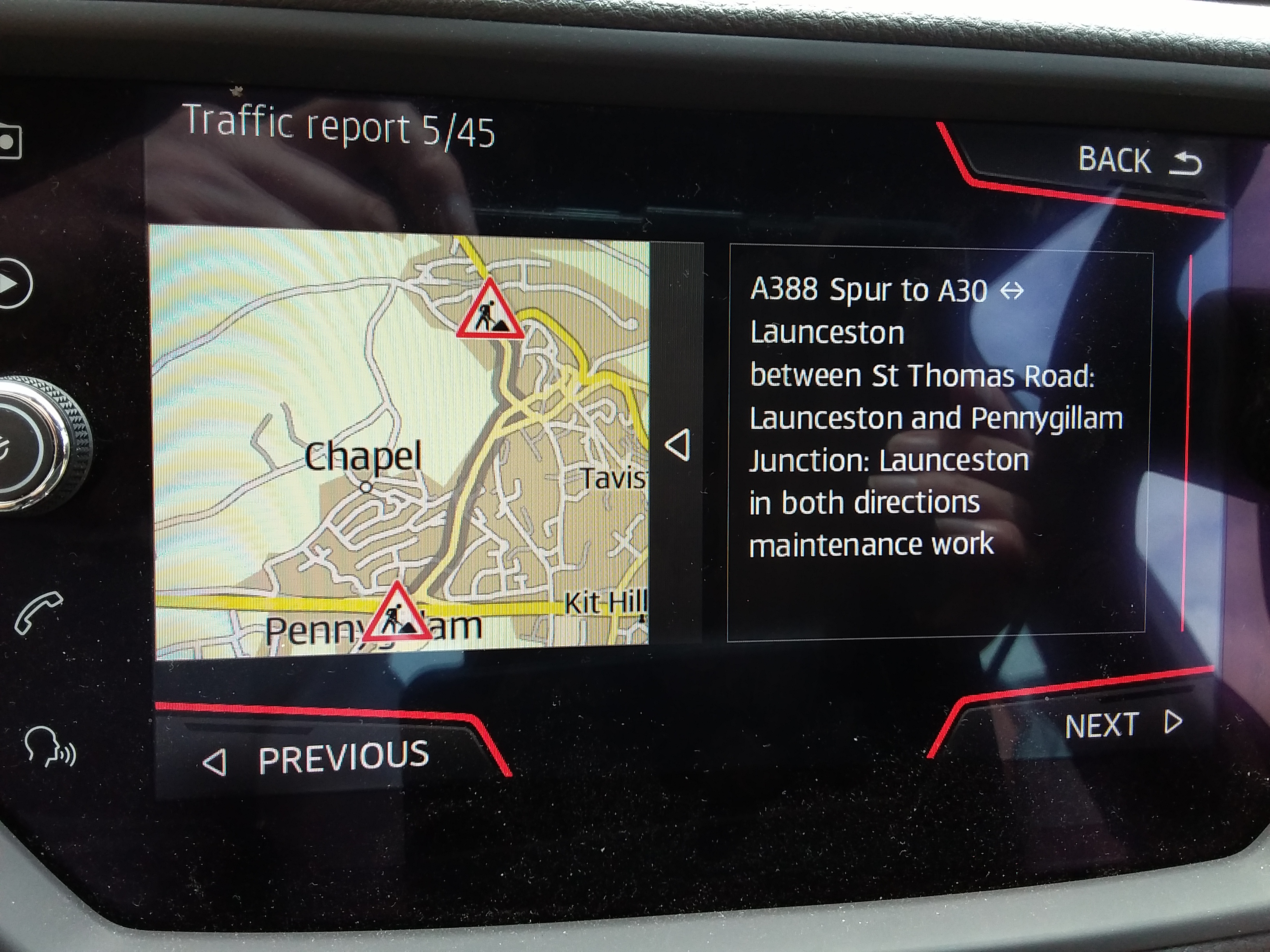

Success works fine on the default TMC value of 15.
I put it on demo mode having found a road closure and did a test drive towards the closed road. It spun round and took a different route. Minehead at the minute.👌 Tested to destruction.
So that's good no coding is required.
