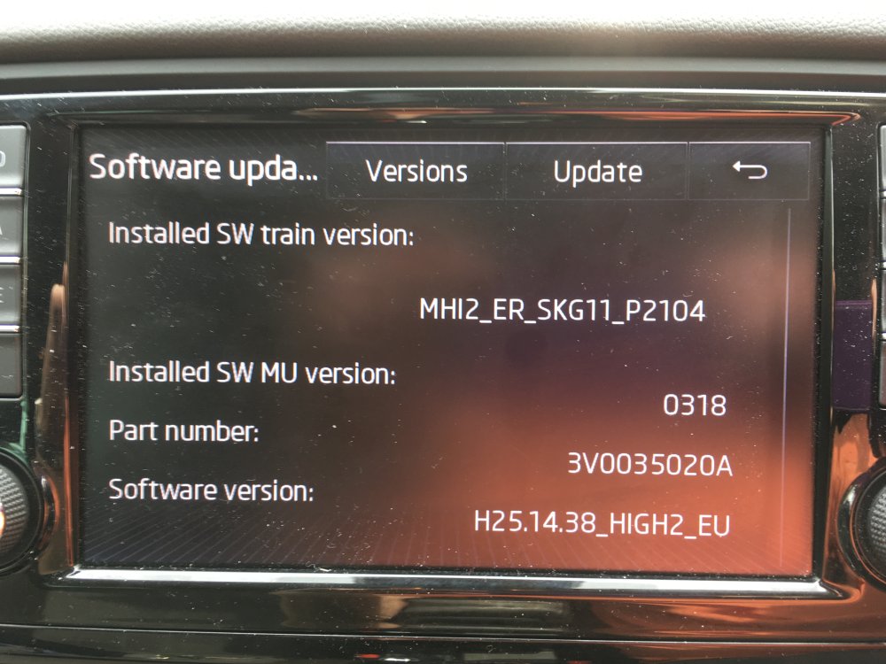

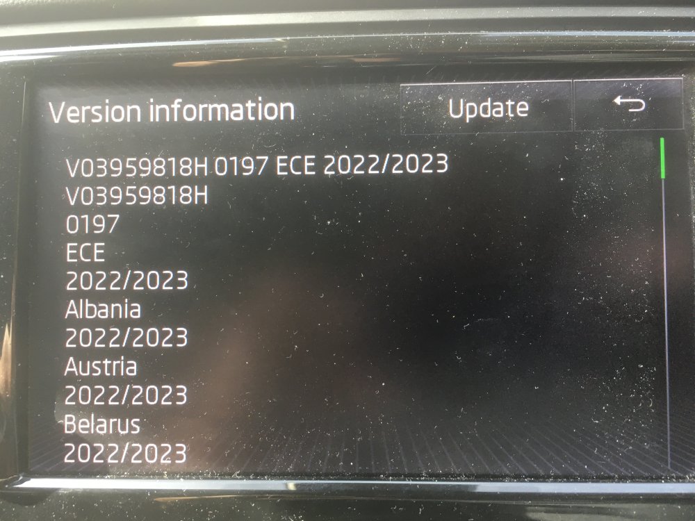

I have a Octavia 2016, I thinks its a Amundsen (MIB2), SD reader in glovebox
I've attached a photo of build details.

If you don’t want to, or can’t, change any coding, then…
Step 3 you need the updated β€œDiscoverMedia2_EU_AS_1430_V12_TMC_Update_V2.7z” I posted a link to later.

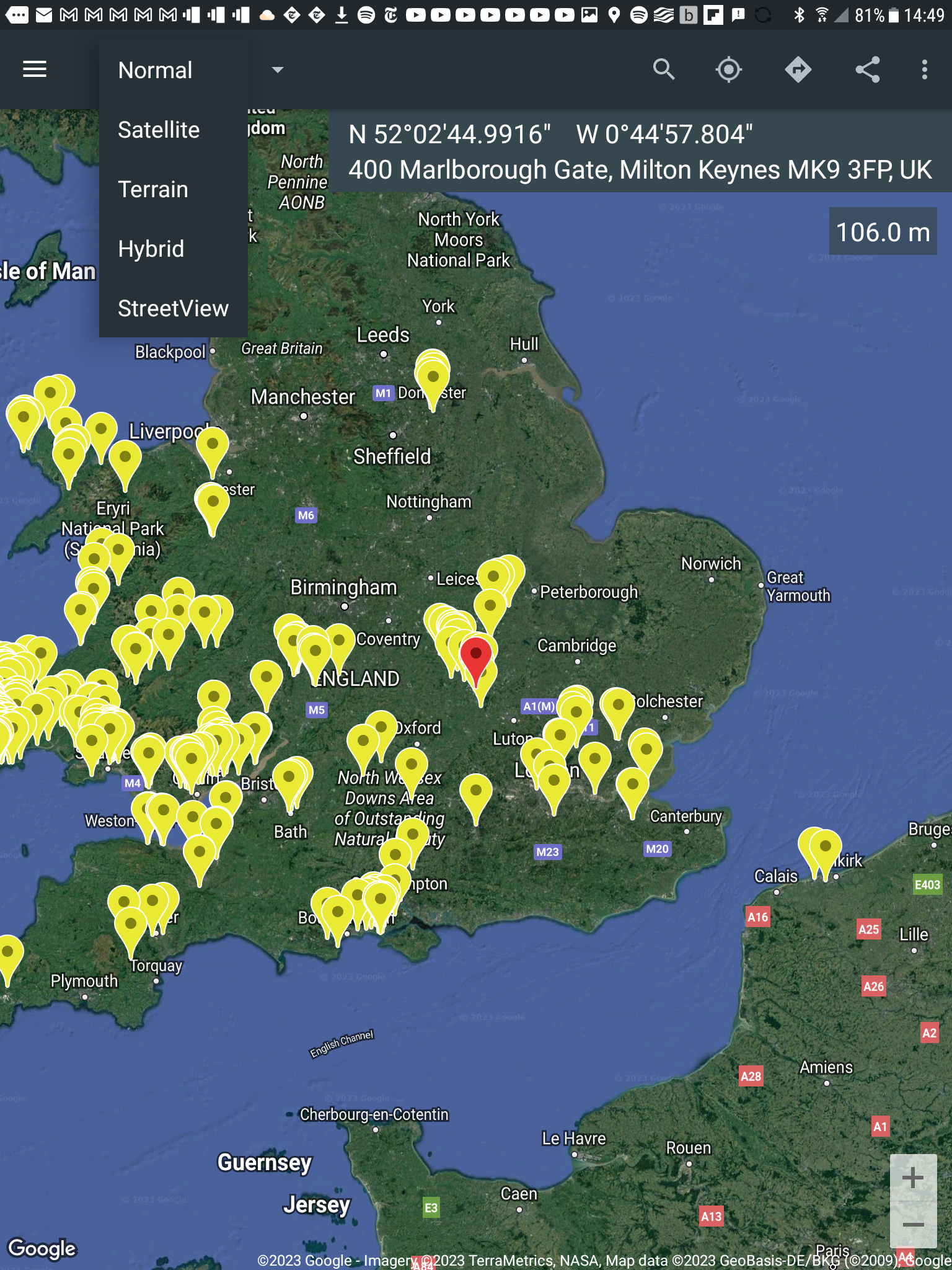

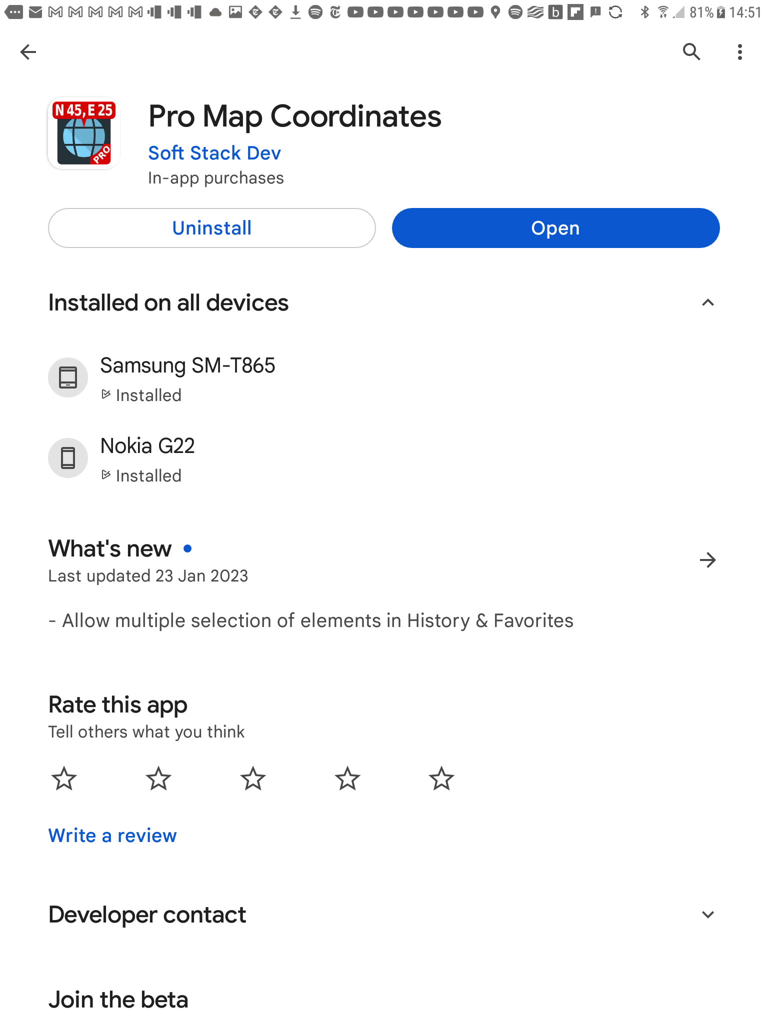

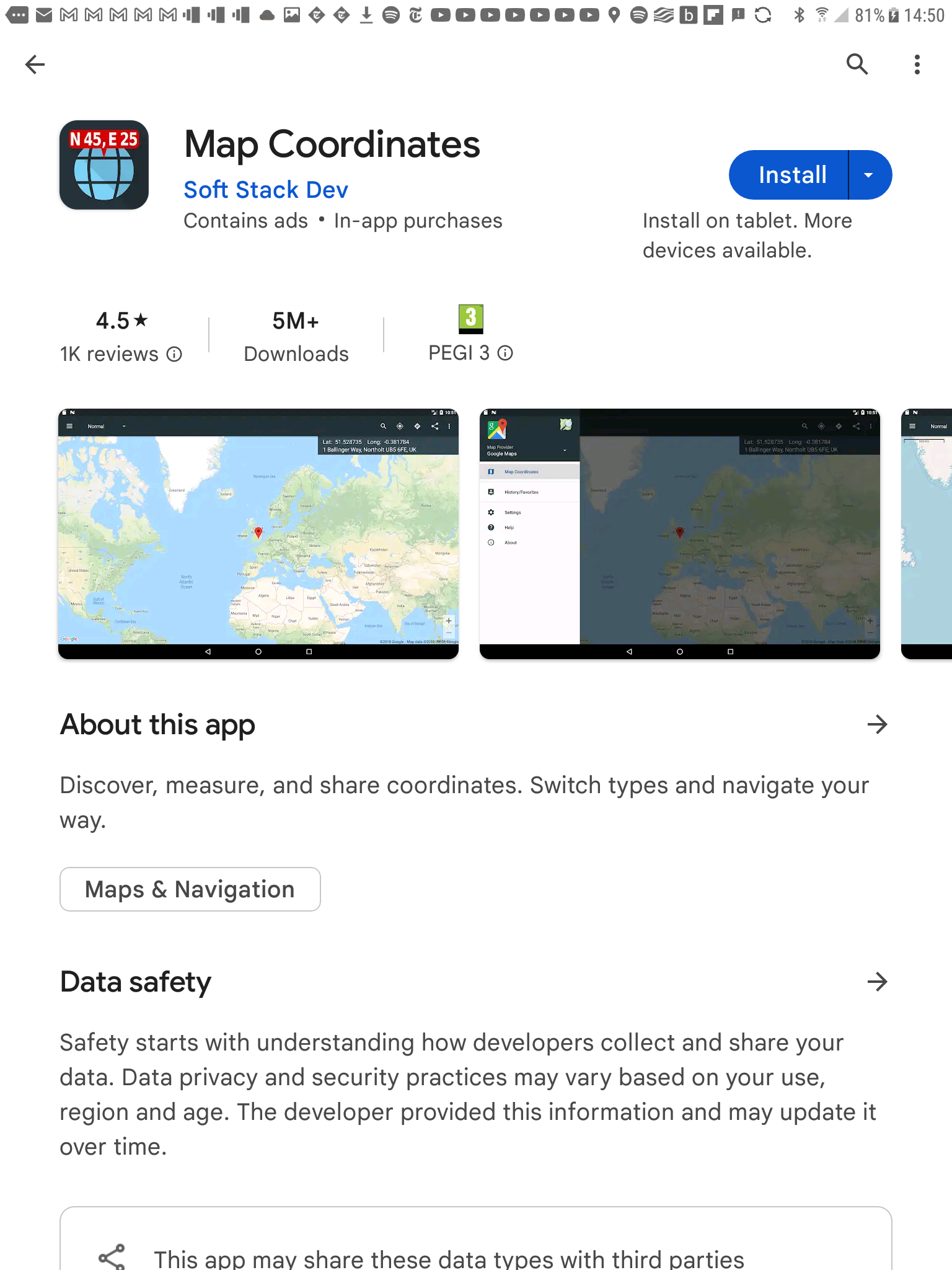

I use the Playstore N45 E25 app to peak a boo into Google Maps it will generate the DMS coordinates that the destination on map uses option uses (the thumb control entry). You just dial them in. Also gives you a Street View so you can look at the location for car entrances. Google POIs can be hit and miss so manual check and dial in is more accurate.
Β
You can save favourites
Β
Β
It's also generates standard sat nav coordinates as well as the DMS Vag use in Mib2. You can just click go and it kicks off Google maps. Really an adjoint to Google Maps but produces useful functionality in the DMS entry for the car if you want to use the built in satnav.
Β
Being old school use Poinspector and N45, E45 to generate the decimal degrees and minutes. Then imports as POIs into the car, then store as destinations. You then get the blob on the map. This was a Skoda trick to get POIs into the destination memory that I was told about. Useful trick but that was the time when the VW import POI was available. Now once Poinspector is set up you can do speed cameras plus destinations. It makes the cars navigation system on screen look like a traditional sat nav.
