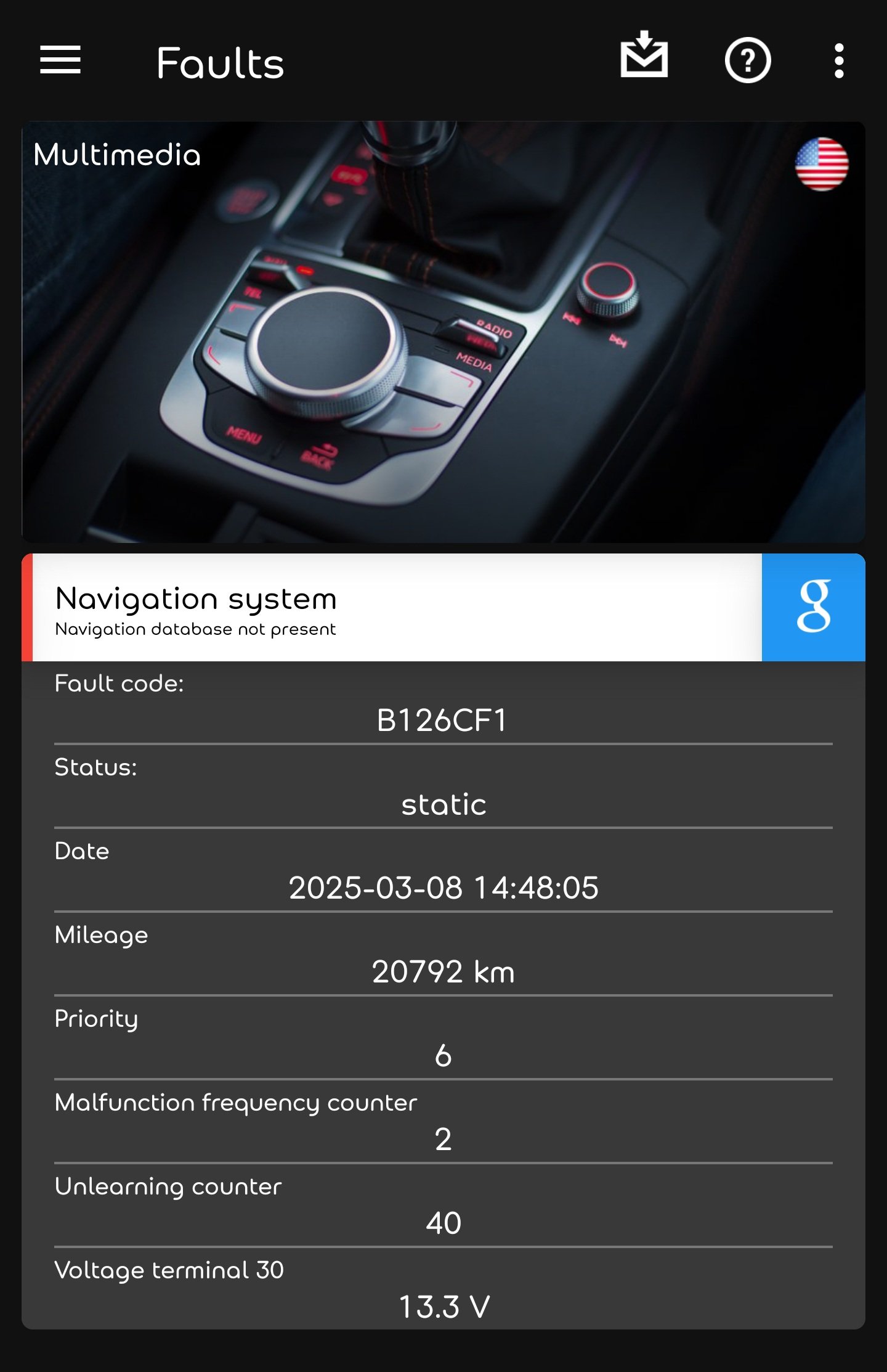

Update: also i found that wifi or Hotspot both are anable to turn on
And also i m new to this issue and didn't found anything regarding my nav database version missing.
My OBDELEVEN says the same thing
Update- i also found that wifi-hotspot also not working its their but cant turn it on (not greyed), so will this issue connected to the navigation database version missing issue?

My Columbus MIB3 "system information menu" does not show the Navigation database version its blank.
also, navigation stuck at starting navigation...
also, i found that Wi-Fi/hotspot not working (not greyed can't enable)
For complete reference and understanding of my issue:
please refer https://www.briskoda.net/forums/topic/524268-mib3-map-update/page/2/#findComment-5927232

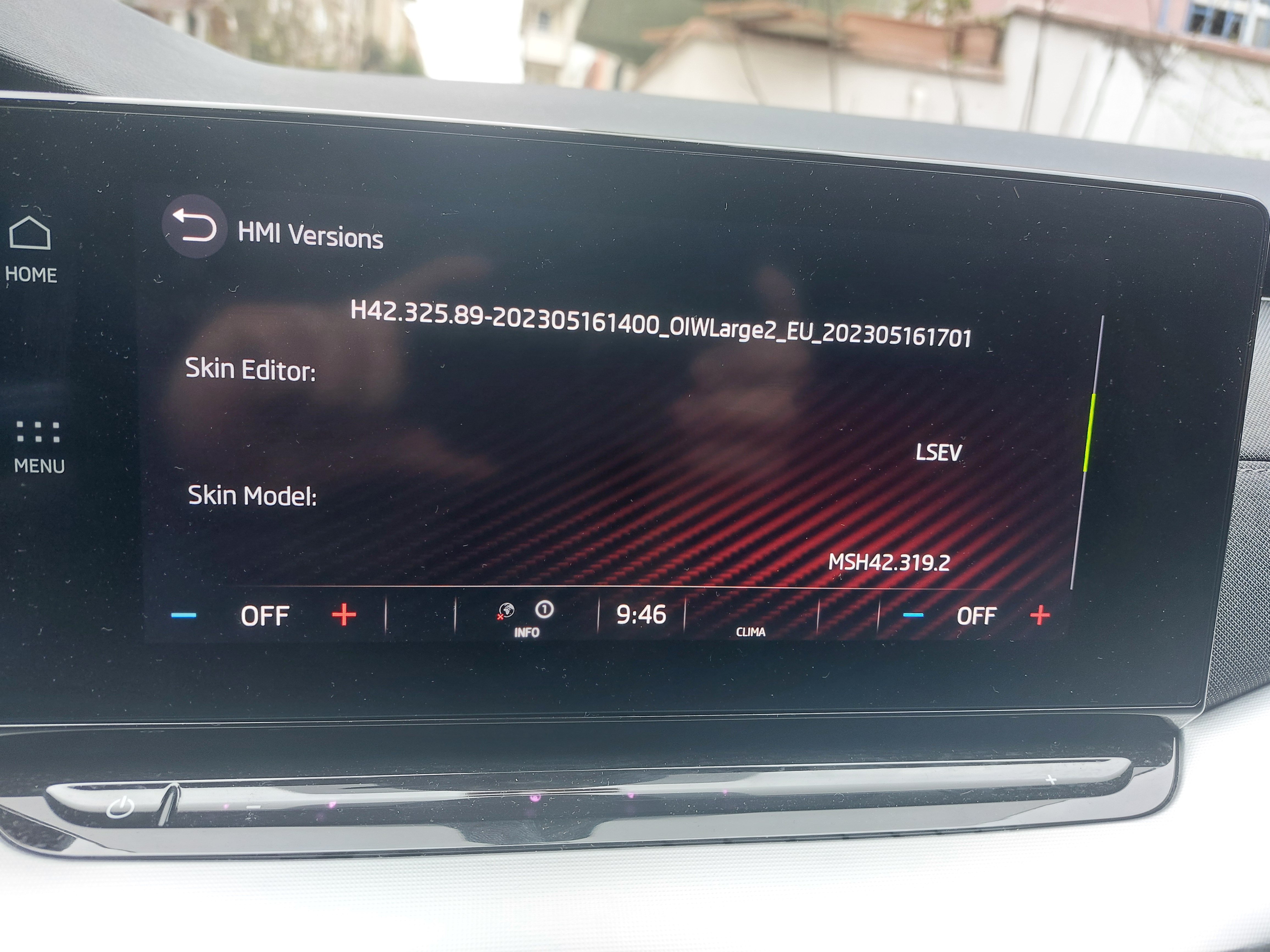

I live in Turkey.
Skoda Octavia 1.5 etsi premium 2024.

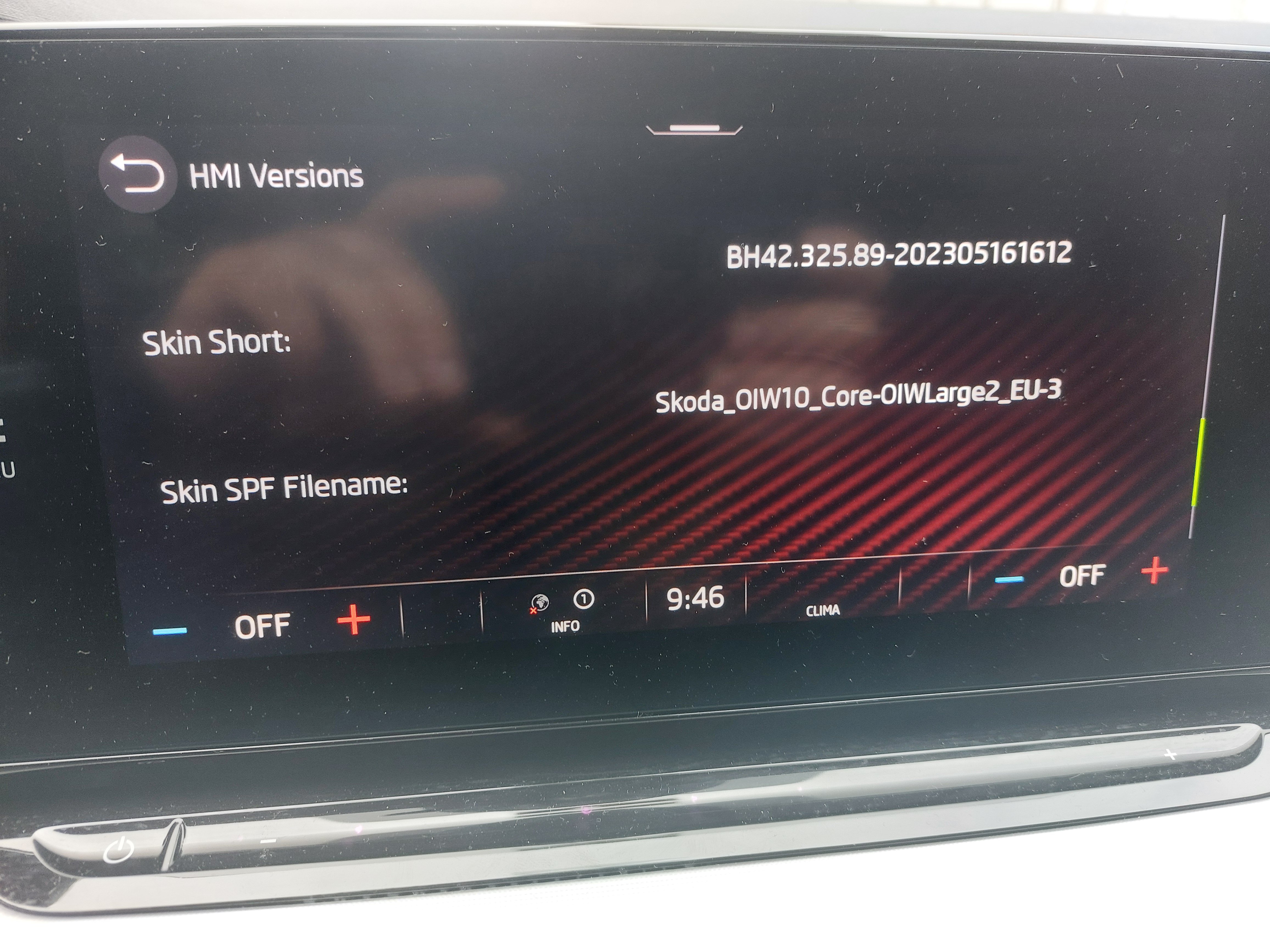

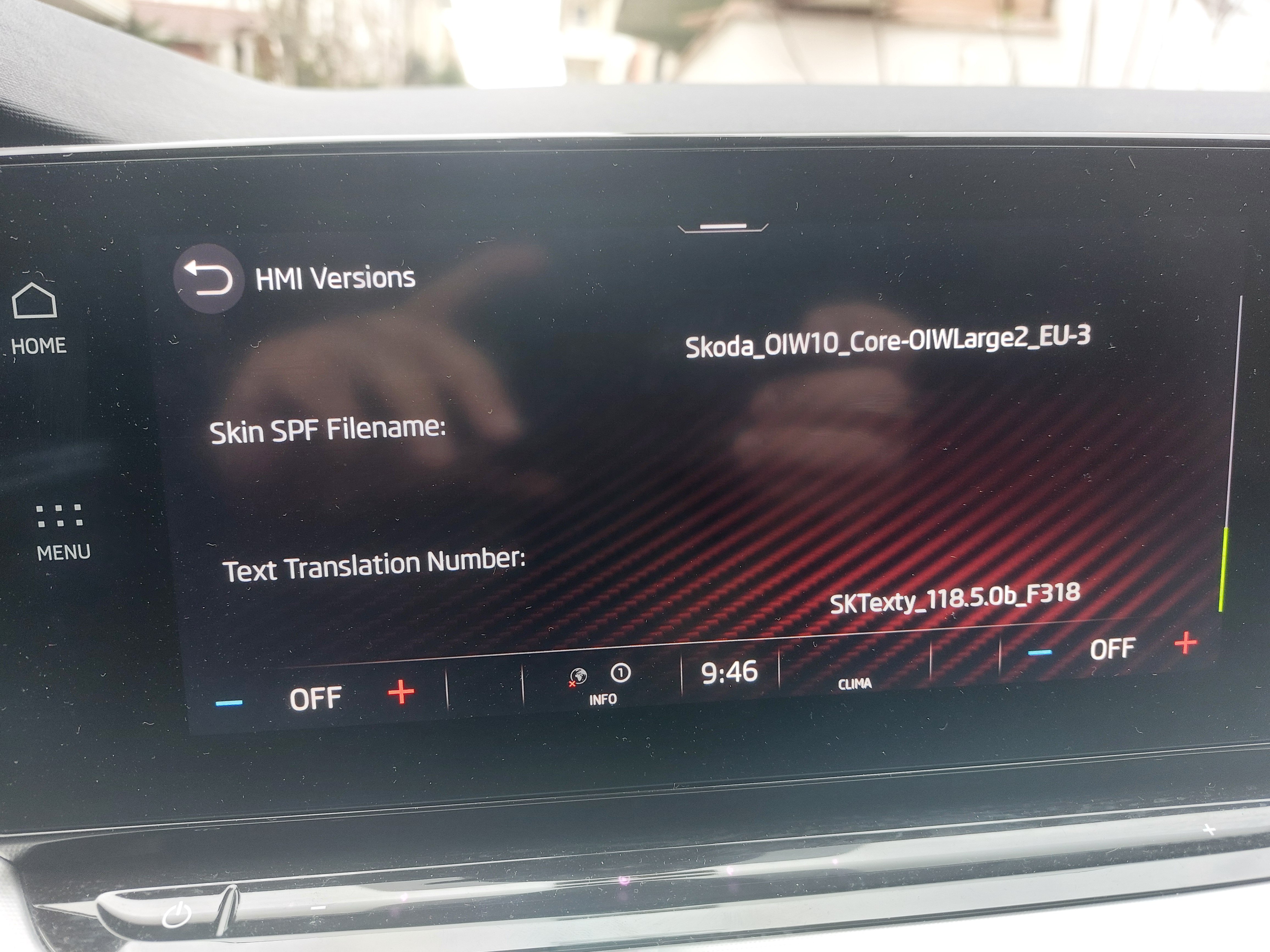

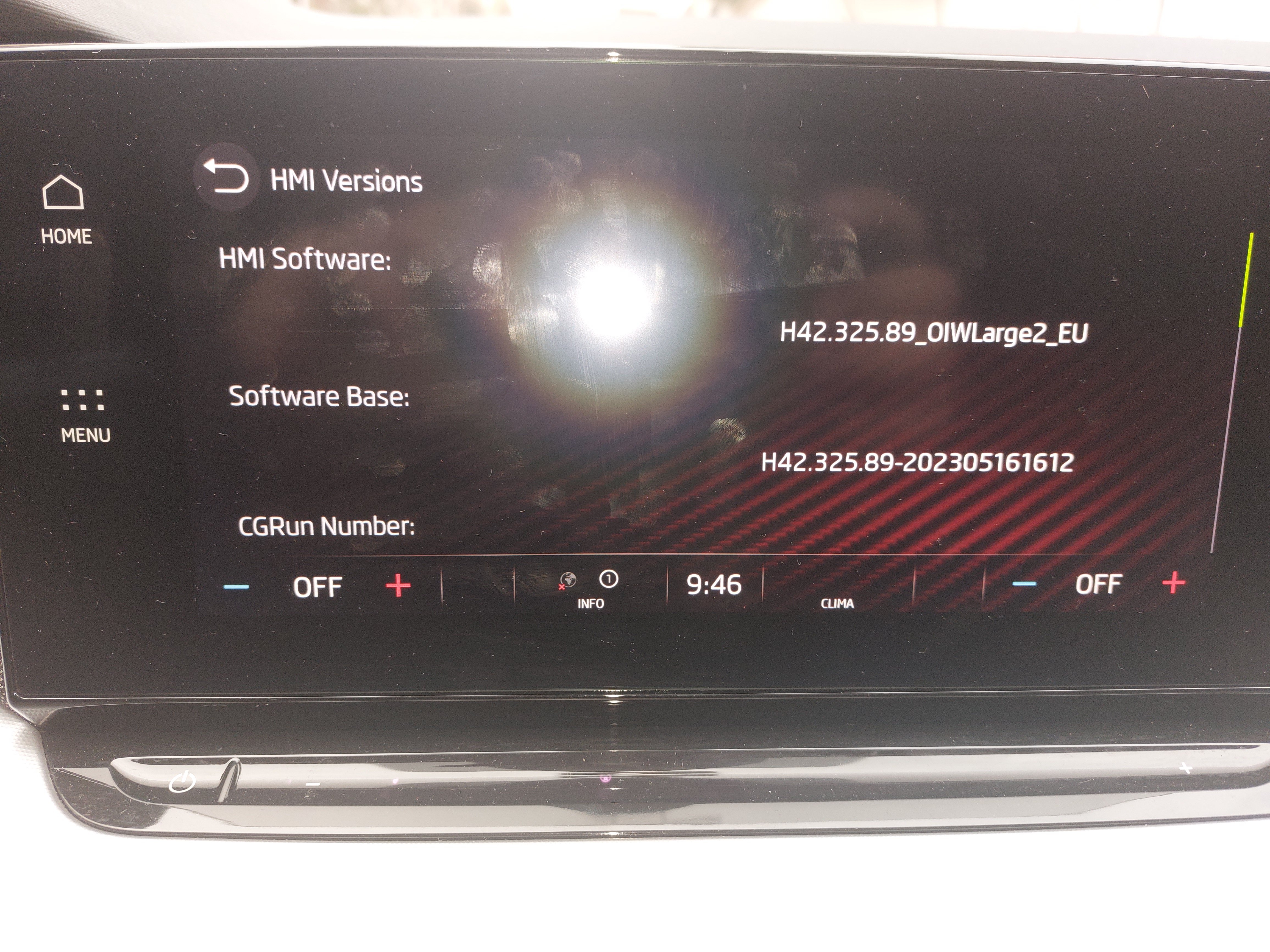

On 12/03/2025 at 05:26, YashD111 said:
Which country are you from?
What is your vehicle's name and model year?
What is your infotainment system name? or simply share photo of it

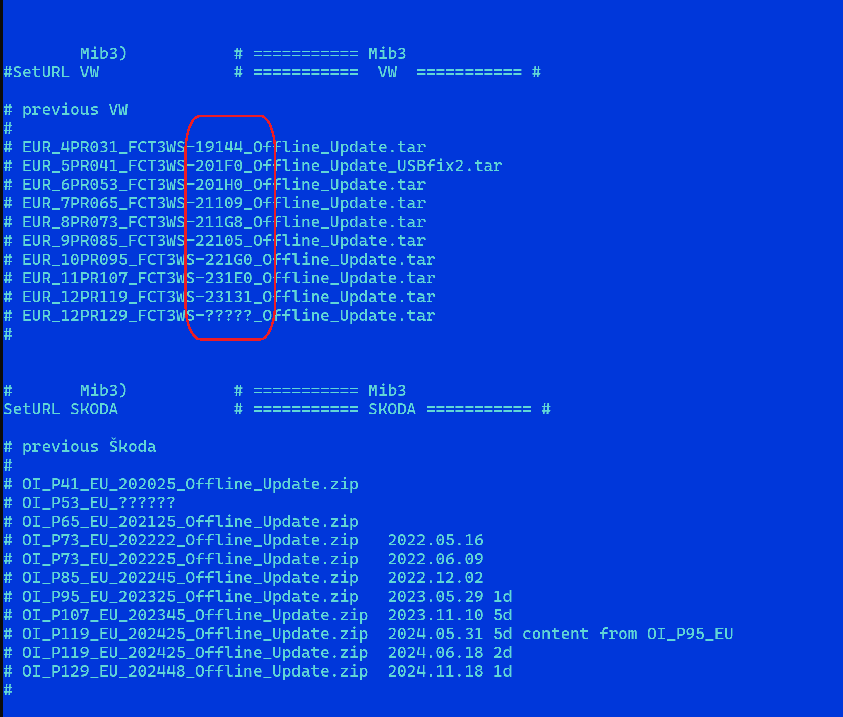

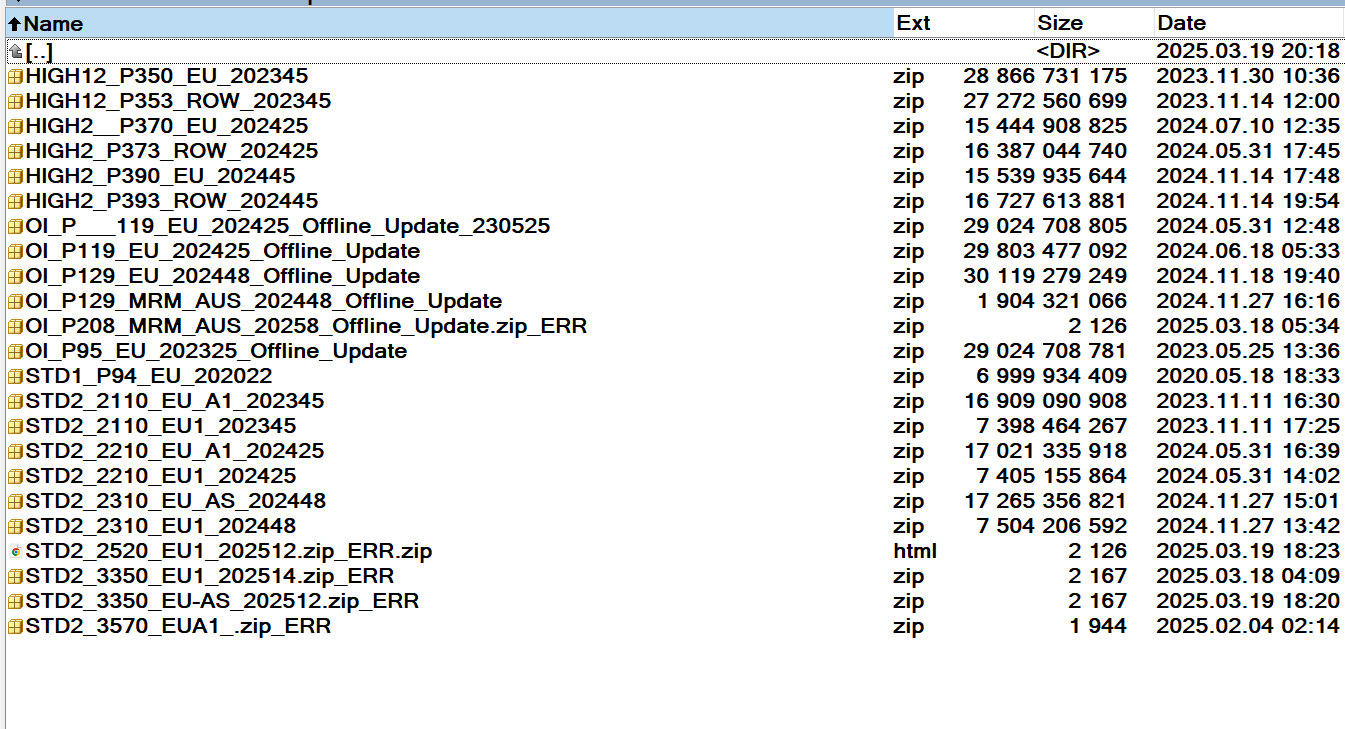

@MartiniB it's come to pass that the Skoda link for the Golf region has a CRC zip error in it using 7zip to unzip.
# Gulf Region    1.9 Gb
 VW portal:   https://navigation-maps.volkswagen.com/vw-maps/MRM1_AGCC_12PR119_CT3W-23131_Offline_Update.tar
                         2.8 Gb
Škoda portal:   https://infotainment-cdn.skoda-auto.com/base/maps/OI_P129_MRM_AGCC2_202448_Offline_Update.zip
I have advised that they use the VW older link. There isn't a revised Skoda one under a new title file by any chance ?.
@Tell
i haven't downloaded them all, as backup i can share only these
Thanks. I think they can try the one 6 months before that you had listed and may be circa June there will be a new one. Hopefully.
It was the Golf states that they were after. I wonder in anycase whether it's a used import European car and if so it would be the holly grail of changing the navigation FeC, so the maps wouldn't be much good without that changed. That's currently a job for a retrofitter.

Why I was asking @MartiniB incase his methods had found another file updated but I guess, when and if it's corrected it will have the same filename. So hasnt been corrected. The file sits on Skoda servers and they have a history of messing up the manufacture of zip files. They probably sorted out the European one but haven't got round to this one. There is the VW one to try that's listed. All being well come June, Skoda or Vag will have the summer release. Have to wait and see.

latest known is 24.6 P129
new VW's portal have lost section of offline maps download even for registered users
but how to guess filenames of next releases i have no idea with such kind of naming :(
